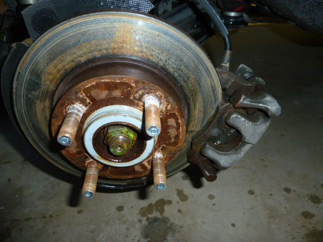

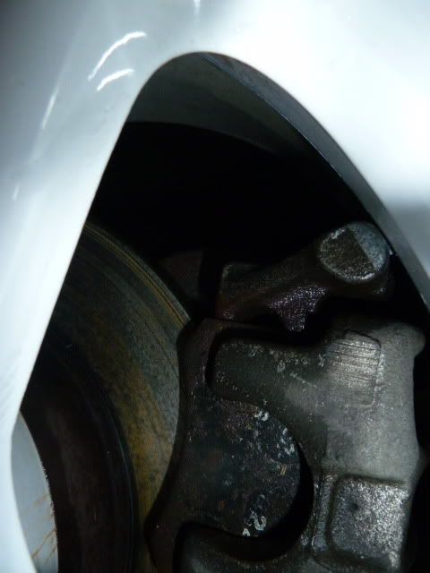

Well, as everyone already knows the Tahoe run was a success and all went well for everyone. Today i decided to wash my car and clean off all the bugs and road grime from the 400 or so miles I drove. While cleaning the RR wheel I noticed to caliper didnt look right...
Turns out the top bolt must have been loose and I missed it when i check the bolts under that car a few weeks ago somehow and it fell out. The bottom bolt was barely loose. I also checked the other side while I had the car jacked up and it was fine.

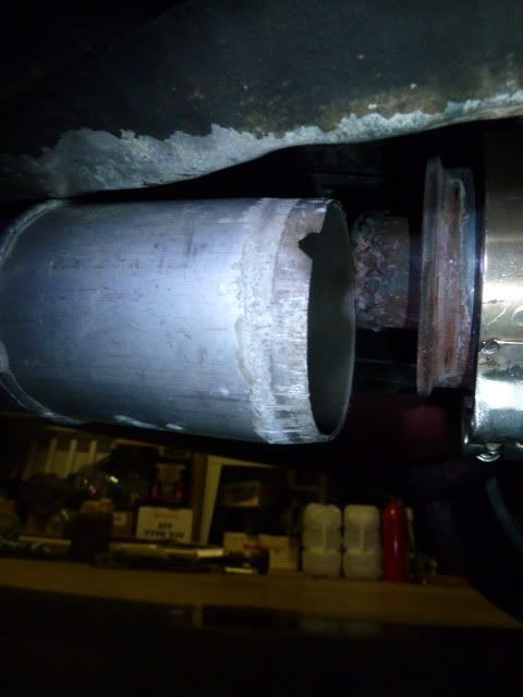

Also decided to look into the exhaust leak i was hearing after getting close to Tahoe...

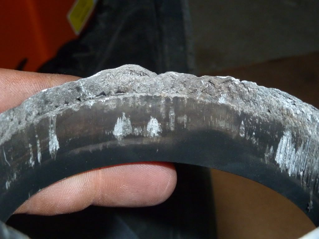

The weld on the aluminun side of the 3" Vband decided to come off. Going to pull the exhaust tomorrow and have the local welder take care of that so it will be done. Not sure if this explains the exhast "tick" that i started hearing once we got into Truckee but its a start. The ticking sounded more like a manifold leak.
So caliper fixed, exhaust will get fixed. Then I get to pull the rear struts out and check the castle nuts that hold the mount to the shock, being that the front were loose i bet the rears are loose too. Good thing I finally bought the right tool for that.

That weld looks like garbage; I'd stay FAR away from that welder in the future, as the undercut and porosity are likely culprits for failure. Welds are SUPPOSED to be stronger than the parent material.

I'm currently searching for the reciept from when I purchased that exhaust :slap: LOL! But really its not a huge deal. I'll get it re-welded and move on. I expect things like this to happen since it is all custom and who are we kidding...its an audi.

PRY4SNO, is 600 miles far enough away? LOL. Not everything can be perect and we were in a small rush to get that exhaust done so its not perfect but pretty close. I dont think it was the welders fault. I blame Obama. LOL

After seeing the exhaust in person I have to say I was pretty damn impressed with it. Okay so a weld failed (and Dan called it as soon as it happened.... he was on it lol) but I see some real potential in that exhaust for sure.... it sounds amazing too. I am sure if it is re welded it will be good to go.

It will get re-welded and will be back to normal. I need to go pull it now and take it in so it will be ready tomorrow to go back on. A revised rear section with a muffler is something that I need to get going on to bring the Db level down a bit and get rid of the horrible snarl on decel. It just needs a little back pressure created by a muffler at the end of the exhaust instead of a restrictor inserted into the flex pipe. Glad you like it Mike.

Glad you got her fixed up man! Now lock-tite those stinkin caliper bolts

Exhaust fixed! Took it to the local welder/fab shop down the street and had em weld the v-band flange back on and then I threw it all back together. Weird thing is the exhaust "tick" that sounded like it was coming from the right manifold is gone. Oh well, just one less thing to worry about I guess. And yeah, gonna put some blue loctite on all the brake bolts so nothing like that happens again hopefully. I'd post a pic of the exhasut but it looks identicle to how it did before, so nothing really to see here.
So I better annouce it. Exhaust fixed! Took it to the local welder/fab shop down the street and had em weld the v-band flange back on and then I threw it all back together. Weird thing is the exhaust "tick" that sounded like it was coming from the right manifold is gone. Oh well, just one less thing to worry about I guess. And yeah, gonna put some blue loctite on all the brake bolts so nothing like that happens again hopefully. I'd post a pic of the exhasut but it looks identicle to how it did before, so nothing really to see here.
