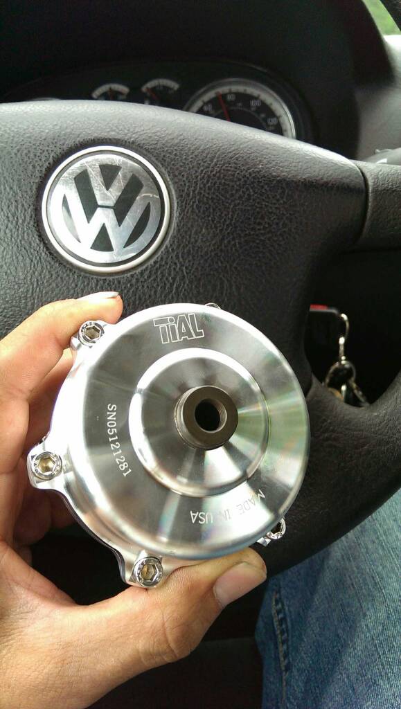

So I go get some simple silicone and aluminum pipe for my compressor to FMIC situation and I always end up walking out spending more than expected... Not a slippery slope, more like a ski diving...

That was the "funds" part... the "time" part is happening right now... searching like a mad man for undercarriage pics of FMIC piping on cars with non-stock location turbo's...trying to figure out things like:
...a) should I route behind the radiator or behind the headlight :idunno:
...b) why's everyone trending on moving the BOV to the intake side of the motor :idunno: ect...
Re: A tale of Rubí... Start up, Sperry and M3's... Pending:
I don't understand your a) question... but I chose to keep the intake piping away from the heat of the header and route it on the fender side of the frame rail. Gives you a ton of room.
b) having the BOV as close as possible to the throttle body is ideal
