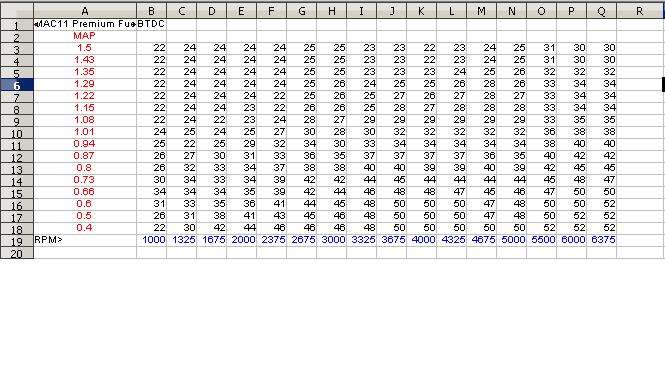

Here's an MC1 timing map (supposedly stock, as in from the stock MAC11 ECU) for premium fuel:
MAC11 timing
MAC11 timing

Holy ballsack that is a lot of timing. Obviously only up to 1.5 bar but still. I have like no timing in my car at all. Awesome.

7.8:1 compression ratio....

I would imagine that MC2 timing maps are significantly more conservative. Beware, if that's what you have.

Great, thanks... shortblock is an MC1 w/ an NF head and SS exhaust valves...
Now I have to figure out how to input/mimic those timing numbers into my 034 Ic ECU... haha. But thank you! Huge help.

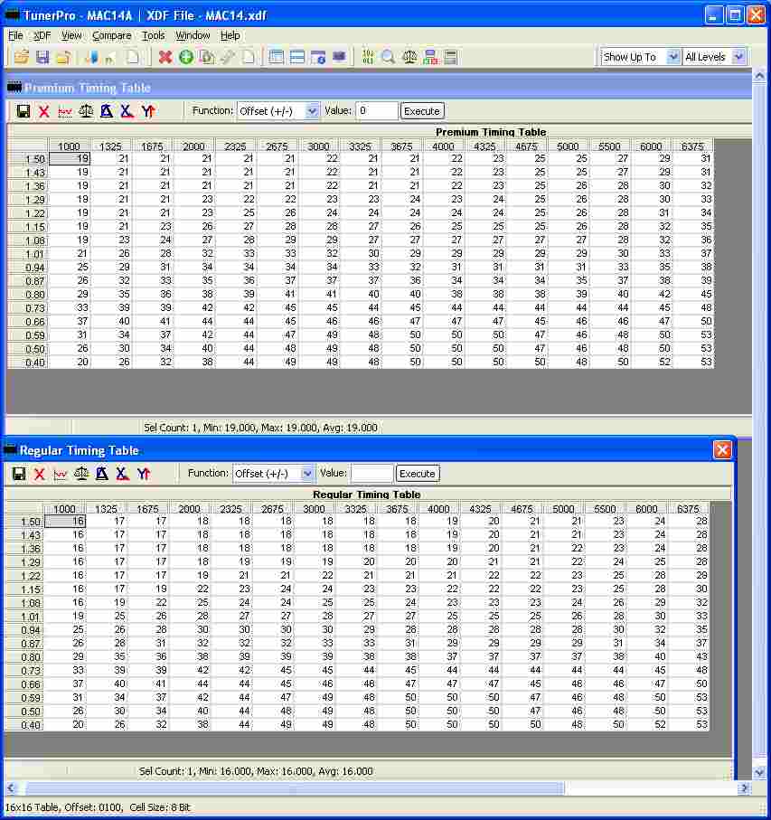

Here are the stock premium and regular timing tables for the MC2/ MAC14
MAC14 TIMING.jpg (67.15 KiB) Viewed 18144 times
