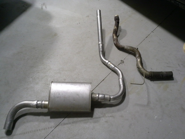

So I decided to go for it and build a new rear exhaust section and get the car back down to more civilized tones. I am pretty happy with it considering I was kind of putting my rookie welding skills to the test. There are still some little leaks here and there, but it's a relief for sure.
Thanks to vt10vt for the Cherry Bomb turbo muffler.

Exhaust looks really spectacular! your welds look fine for a gasless mig (doodle spackle always included!). If it's any consolation I am running twin 2.25" glasspacks so I feel your struggle.
