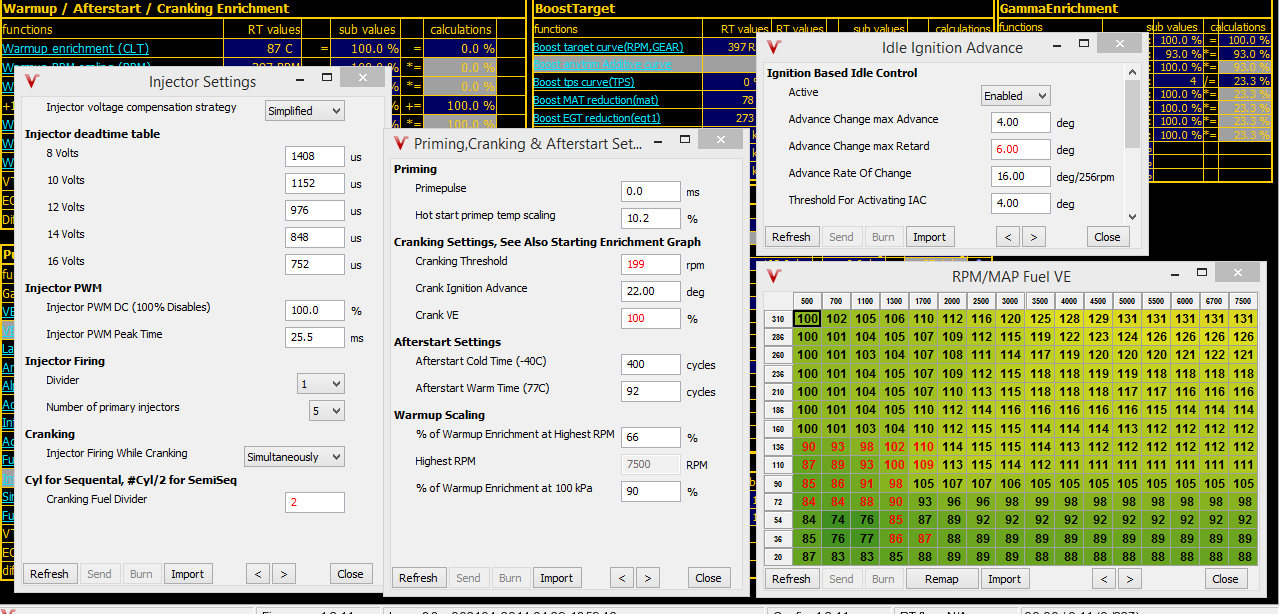

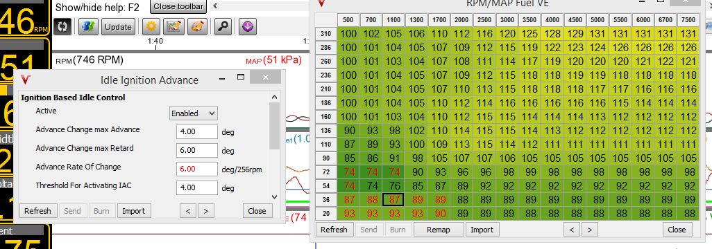

I set the MAT/TPS Table on the lower right cells a bit leaning out since i noticed the a/f become richer once the MAT ramp up.
i think i got all sorts of issue.my friend tried to remap and play around the VE table and set the ign adv rate of change from 16 to 6/256rpm.the injectors pulsewidth seems more steady than before.my Deka's PW is 2.0ms. too low?I have 5bar FPR,max
injector DC is 93% on 29psi of Boost.I will need to get bigger one for E85 soon.
Anyway,i heard some slightly knock when WOT at the top end around 6-7K RPM on E85.Too much advance on the top end?
my lambda target is 0.80.

It becomes richer because you don't need as much fuel at higher MAT temps. BUT, to keep a steady idle you might have to run it a bit richer.
Re: Idle problem on Deka's 630cc.
Your entire timing map is very advanced. +6-10* higher than mine in almost every cell. I still highly doubt you got E85 to detonate at .80 lambda though.
Being 31-33* advanced at idle is probably also causing some of your idle issues. I'm around 20* there.
