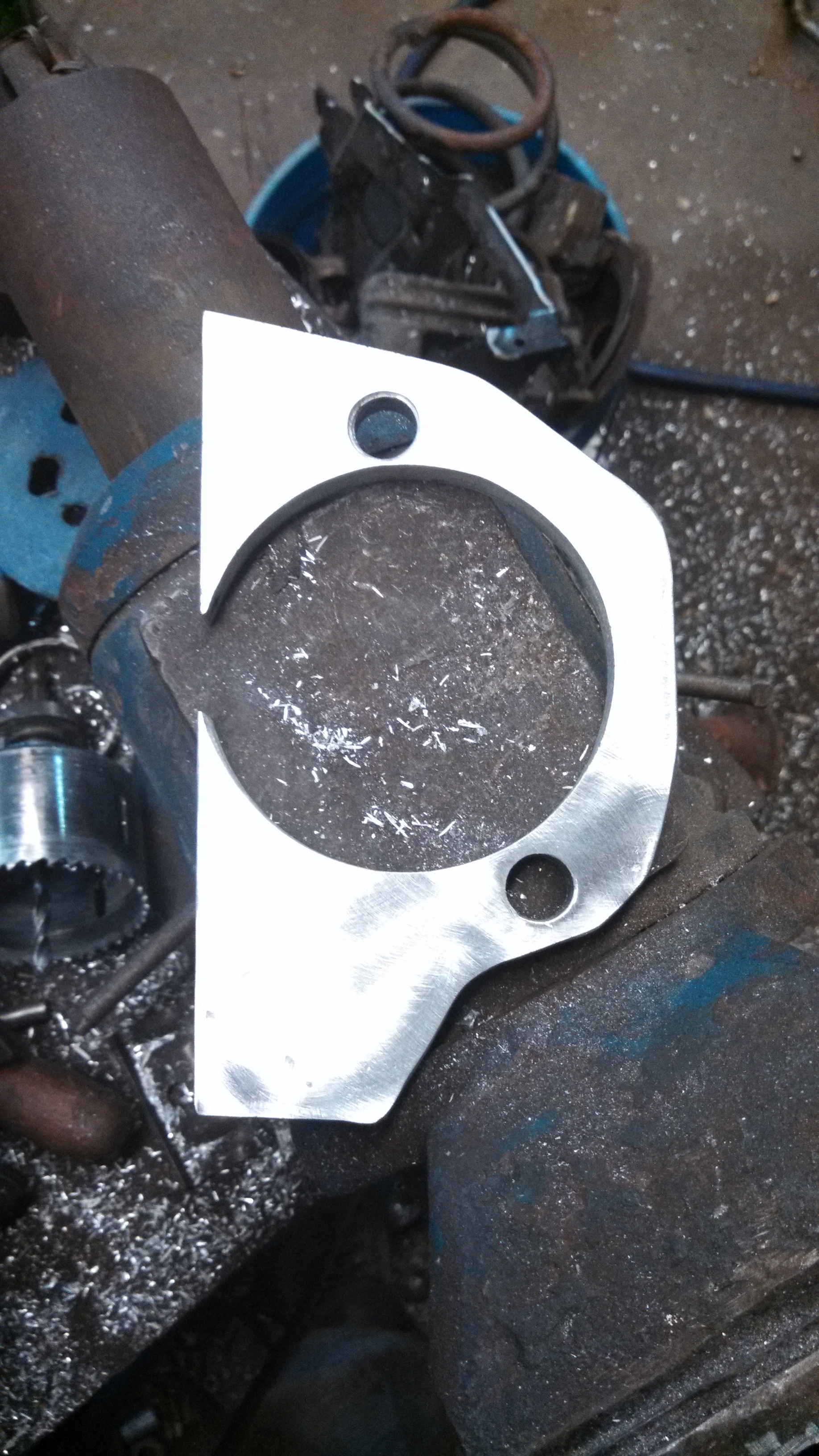

starter setup is super custom, spaced out, and with cut off and re-clocked ears

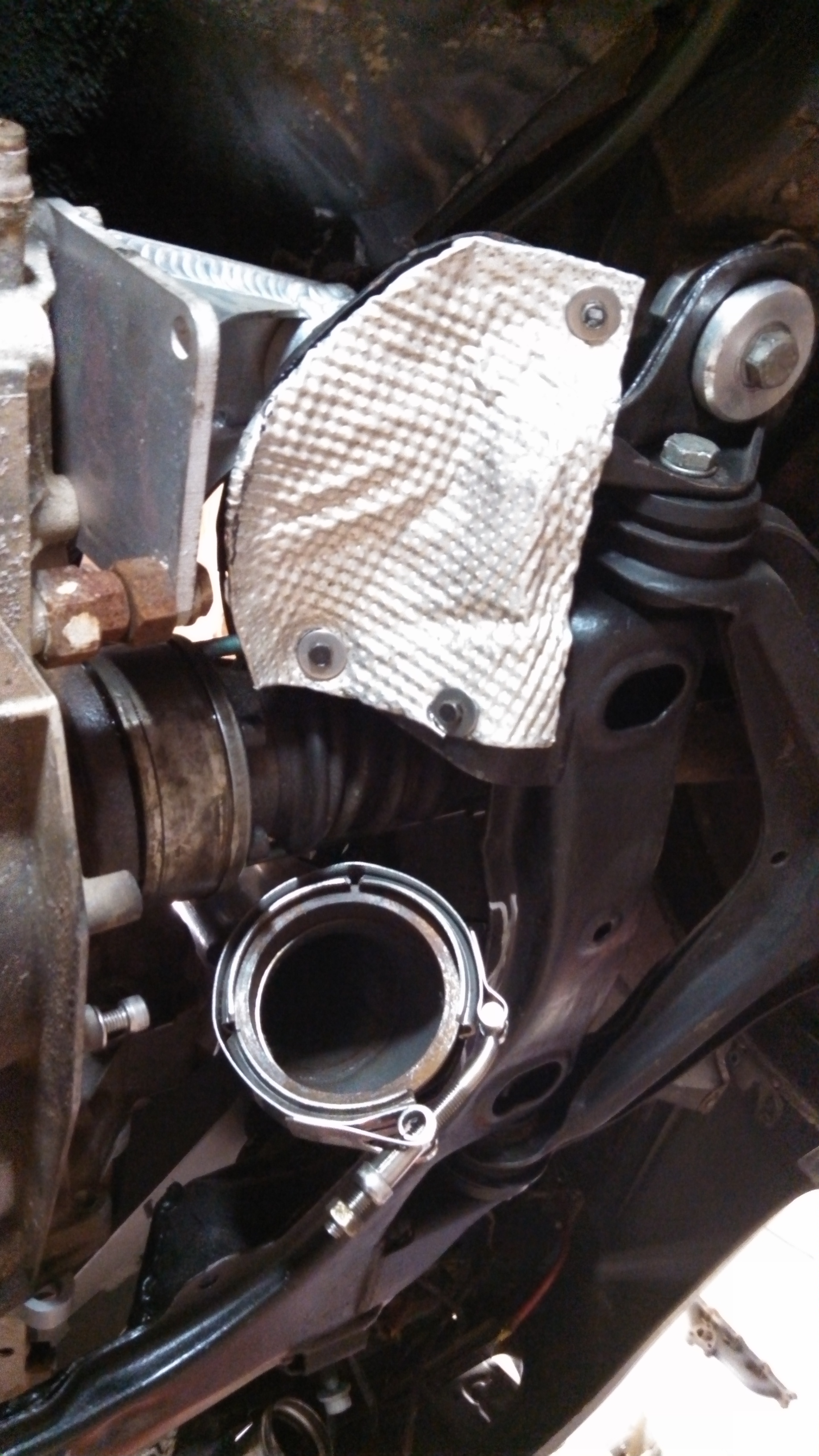

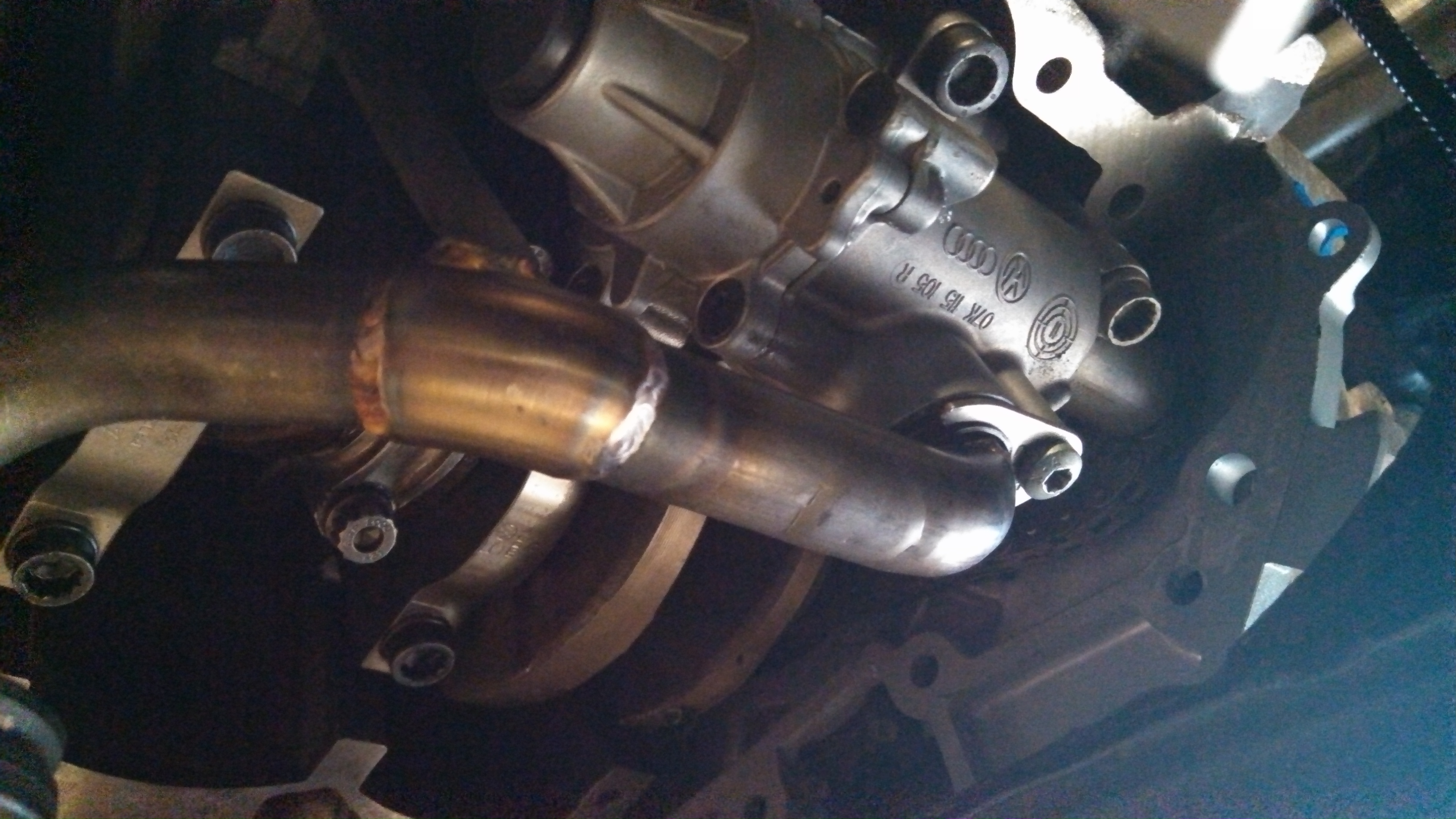

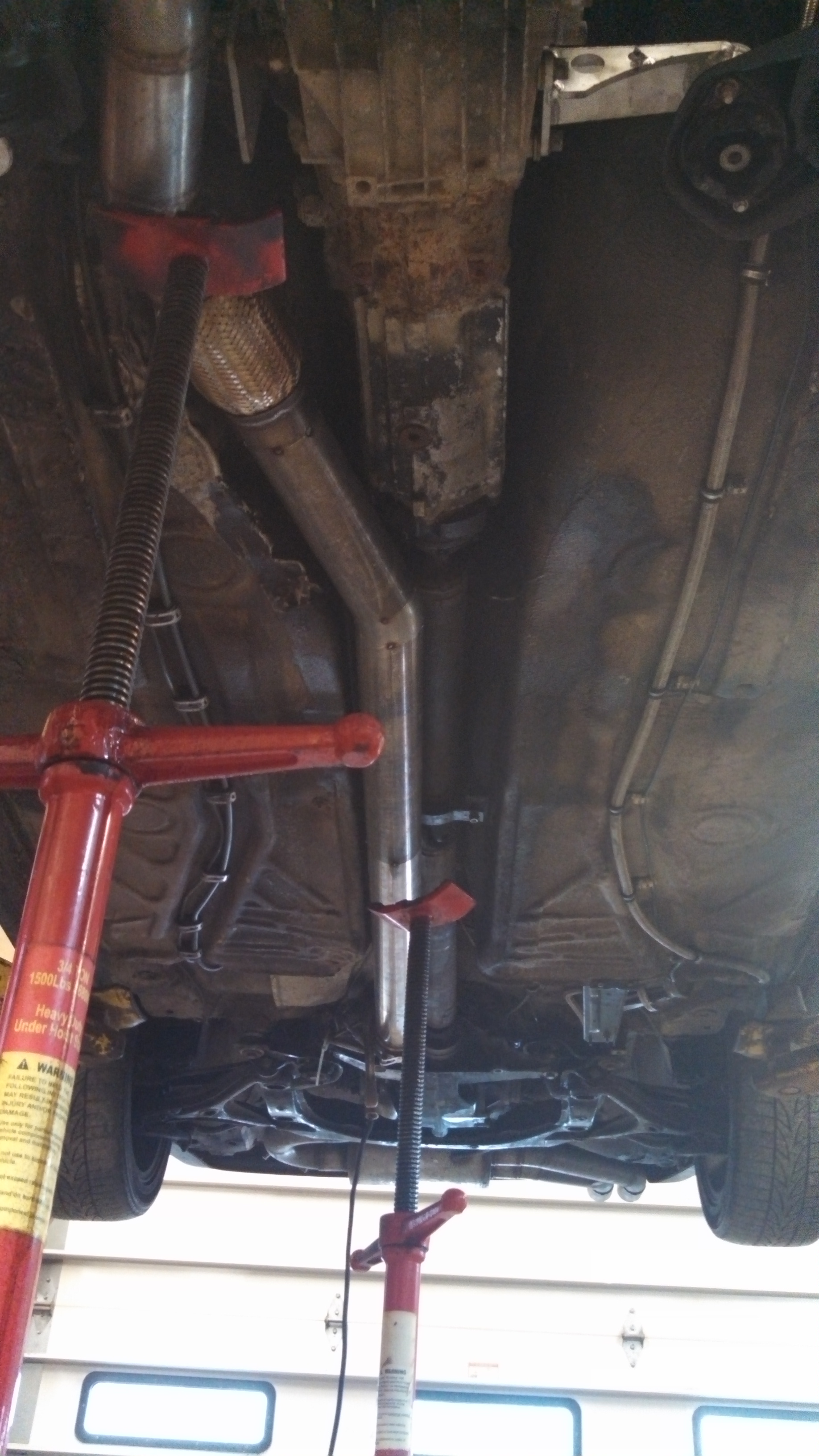

There was a 3~ foot section of exhaust we hadn't finished yet, here is that. The car is 3" turbo back with the smallest unchambered 3" in and dual 2 out. Dont recall the part number.

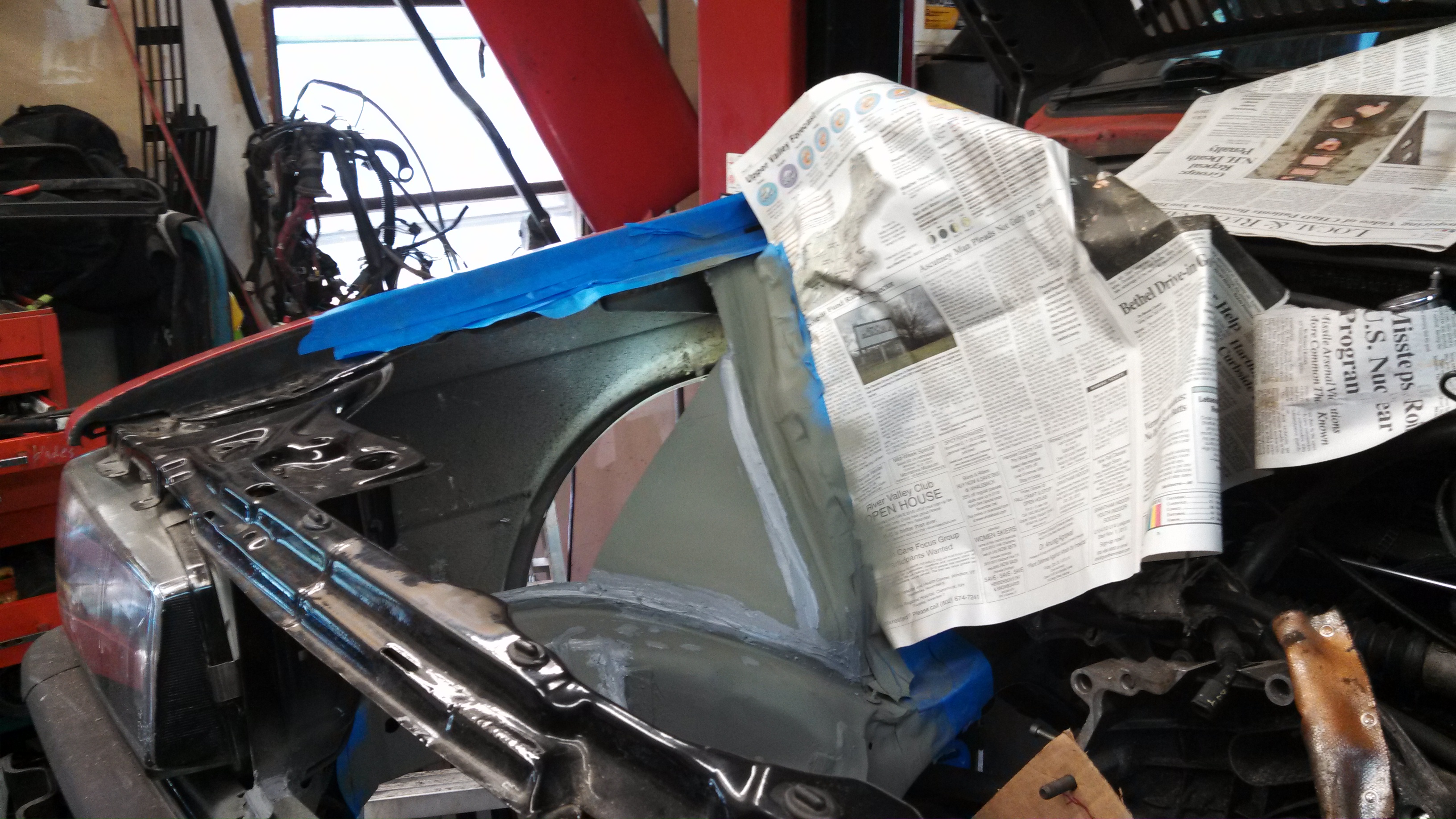

had to patch back in a bit of sheet metal on the inner fender
and a raw start of the starter adapter. I dont want to give dimension of anything til Im happy with it for a while. We also have serious time into that stupid hunk of aluminum and I know hank did too! It def had a bunch of cranking tim between at Carlisle, at my place, and Marcs.
