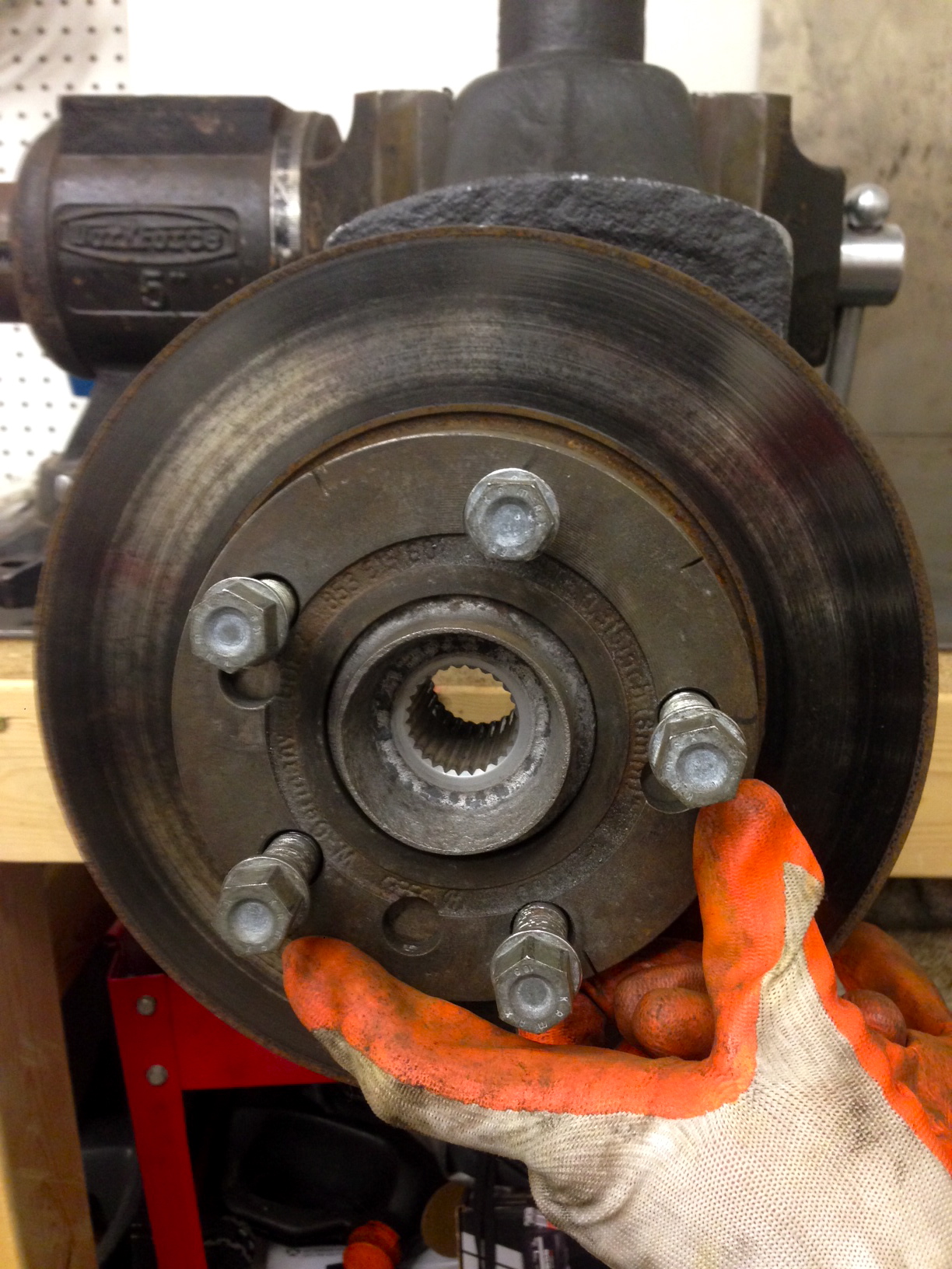

Re: 4 FOX SNAKES - 5 lug rotor redrill
I also finished up the rear end 5 lug swap. I redrilled the stock 4000 rotors and those should work just fine. The Audi 200 (auto) 5 lug hubs that I sourced from a guy in Denver turned out to be kind of messed up. My wife picked them up in Denver from a guy and after I got them pressed into the housings with new hubs, I realized that 3 and 4 of the threads on each hub were mangled from someone cross-threading them. Annoying. I'm sure the guy didn't know this? but just another hiccup. So I bought a tap set from Harbor Freight because I couldn't find a 14 x 1.5mm fine thread tap anywhere in town. Now I have an entire suitcase of every tap imaginable, I'm sure it'll come in handy someday.
I also installed SS braided Brake lines in the rear because I'll be re-bleeding the entire system anyway.
- photo 2.JPG (514.55 KiB) Viewed 39445 times
- photo 2.jpg (675.51 KiB) Viewed 39445 times

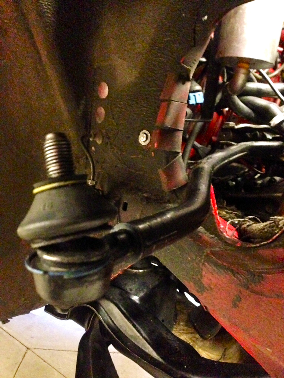

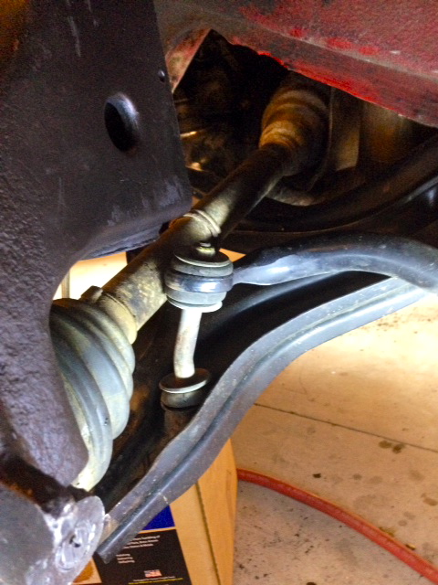

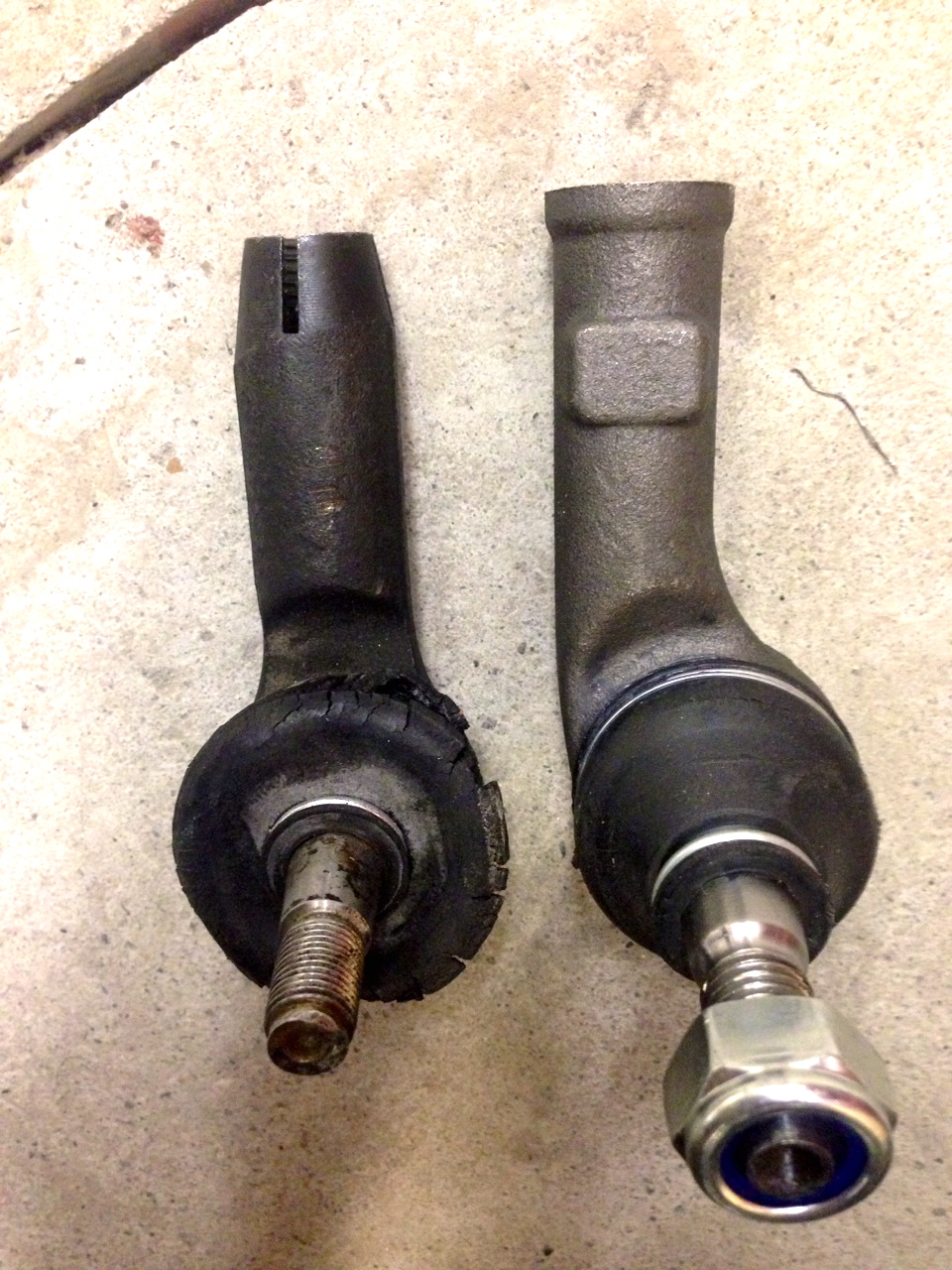

Re: 4 FOX SNAKES - right side adjustable tie rod needed ASAP
The only other thing I'm in need of at this point is an adjustable right (passenger) side tie rod. I need this to be able to use the new MK2 Golf Outer tie rod that I ordered for the Porsche BBK upgrade. The existing outer tie rod is junk anyway. It appears that the offset is ever so slightly adjusted forward with the MK2 tie rods. Anyone have a spare, right side, adjustable tie rod assembly they can offload to me?
- Stock 4000 vs MK2 outer tie rod
- photo 2.JPG (501.59 KiB) Viewed 39441 times
- non-adjustable tie rod
- photo 1.JPG (563.58 KiB) Viewed 39441 times
Re: 4 FOX SNAKES - end of an era
Hey Ross, meant to reply to this yesterday.
I had real trouble sourcing a tie rod/tie rod end. I replaced the driver side outer tie rod end (is that it in the picture? That thing literally has like 4k km on it!!!). But when it came to the passenger side, the TRE I got had female threads on it. But the tie rod end screws into the tie rod on the car. So then I thought wtf, I'll just get a whole tie rod then. So I went and replaced it only to find out that the pitch was totally wrong and way smaller. The steering arm hole was much larger. The passenger side didn't need to be replaced because it was tight so I left it in but replaced the boot and greased it. I simply wanted to replace it because I had no idea how old it was. Since it was fine, I gave up on it at that point and figured I'd have to dive into it again at some point.
So to summarize, I have no idea what that tie rod setup is. Seems really weird to me, maybe someone before me did it. Sorry I can't be of more help. Looks like the MK2 has the right size pitch on it though so that's a start. I believe I gave you the entire tie rod, can you thread the MK2 end onto that tie rod?
Awesome progress. Brakes look so sick! I'm pretty jelly you are getting that all dealt with.
Hey Matt, thanks for that info. I had totally forgotten about that tie rod that was in the trunk. I went to remove the boat anchor sub in there and found the heater box with the tie rod hidden inside. I installed that with the outer MK2 tie rod end and it seems to be the right fit! So I have the passenger side all tidied up and ready for a bleed. Rear 5 bolt hub conversion and SS lines are installed. Just waiting on a new wheel bearing for the driver side and I'll have it back together.

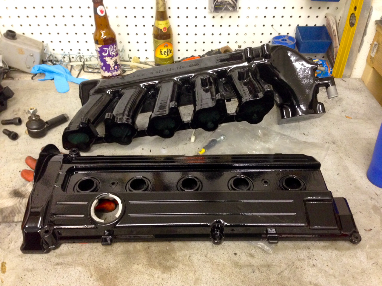

I also got the VC, fuel rail and intake manifold back from powder coat today. Finally. Looks great, I'm super happy with how its going back together. I should have that other wheel bearing tomorrow and then I'm all set. This car has been down for weeks now, I can't wait to get it back on the road and just enjoy the drive. For now.
- shiny bits

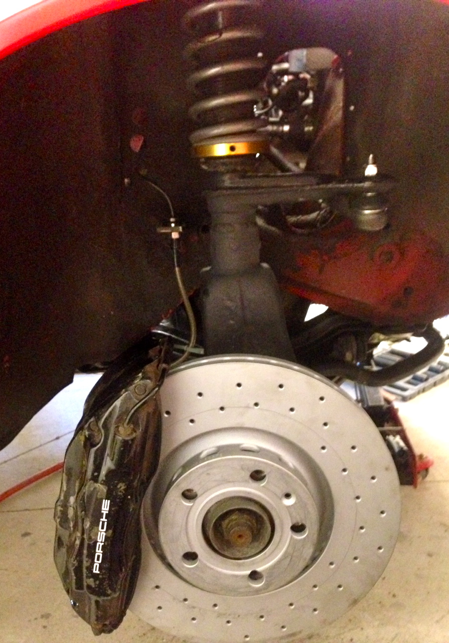

- new 5 lug hybrid upright with BIG BRAKES!
- photo 1.JPG (474.23 KiB) Viewed 39371 times

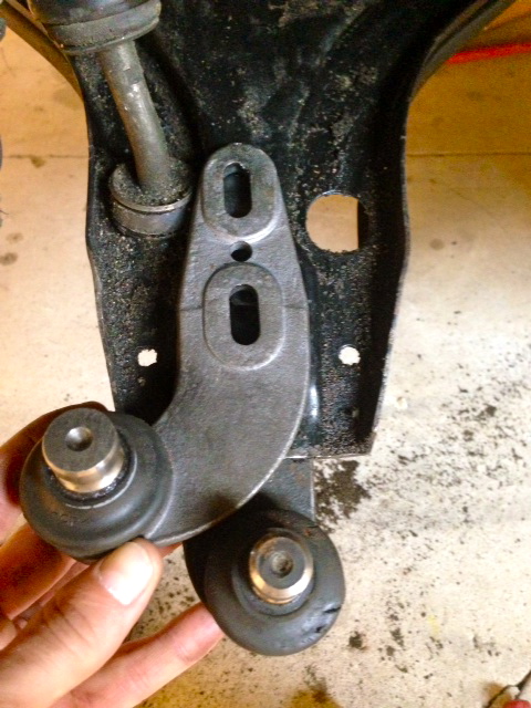

So I've run into another snag, I guess I ordered the wrong ball joints. The 19mm euro B3 balljoints that I ordered, that took forever to arrive from Europe, definitely have the wrong offset. That's irritating. When I placed the order on RockAuto I found the part number that said "AWD" and ordered it up. Turns out it throws the entire strut housing about 1" too far forward so that the driveshaft hits the sway bar mount. Fudge
I was really thinking I'd have this car back together by now. So I've re-ordered what I believe to be the correct ball joints. Part #'s (Rt side #893407366F) (Lt Side #893407365F). I didn't notice until I went to mount a wheel and it hit the back of the fender well.
Good grief. I just want to drive the car.
I was really thinking I'd have this car back together by now. So I've re-ordered what I believe to be the correct ball joints. Part #'s (Rt side #893407366F) (Lt Side #893407365F). I didn't notice until I went to mount a wheel and it hit the back of the fender well. Good grief. I just want to drive the car.
- stock 4000 ball joint offset vs wrong 19mm offset B3 Euro
- photo 3.JPG (156.74 KiB) Viewed 39329 times
- too far forward
- photo 1.JPG (145.68 KiB) Viewed 39329 times
Should have let me know what you were after. I wouldve provided you with the correct part numbers. That or just make a new sway bar mount setup. I'd be interested in those wrong balljoints too as I could probably find a way to make them work on my 4kq
Edit....wait why not just flip them to the other side and move the wheels/assembly forward for more caster or do you want less caster for quicker steering?
you probably already know, but the big brake in the photo is upside down (bleeders on the bottom).

Marc: having the calipers upside down hadn't quite registered in my small brain just yet. Maybe I would've noticed when I went to bleed them, or possibly if I hadn't installed them at 2am. That's one reason why I post so many pictures, so that all you guys who are smarter than I, can tell me what I did wrong. Pretty much every car project is a new one for me, learning lots all the time.
Taco: I actually tried flipping the ball joints around and its too much offset either way. If I run them forward they hit the swaybar mount and are too close to the front inner fender. If I run them backwards the wheel hits the rear of the fender. I thought about attempting to hack them up and reposition/weld the ball to the right orientation but I just don't trust my own fabrication skills for a crucial area like that. I'm sure you could make them work though? Let me know.
Why are you using left strut on the right side (and vice versa)?
On the typ44/C4 the caliper is on the front side not trailing.
You have your struts on wrong sides.. you might get away by swapping the ball joints from left to right to offset the strut the opposite way.
However from the start they should have been right way around.
