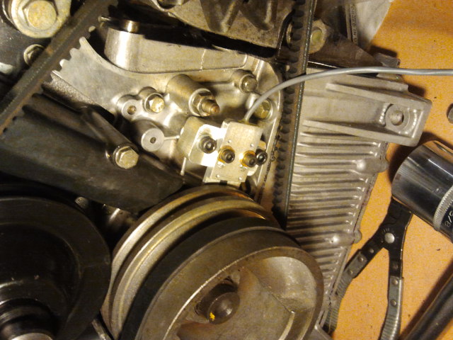

I am using a hall sensor with 3 magnets embeded in the crank pulley on my Alfa V6. I think you could do a similar setup on a 5 cylinder but you would obviously need to install 5 magnets in the crank pulley for two pulses cycle. Then just use a single window dizzy for cam sync. Or maybe it would be easier and a decent compromise to implement it on the cam pulley.
This is an SDS hall sensor with trigger magnets embedded (epoxied) into the back of the crank pulley which I am going to use with MS2. http://www.sdsefi.com/EM5E20.pdf

It won't work with 5 magnets on the crank. Calculate TDC for each piston and you'll see why.
It would work on the cam, but is no better resolution-wise than a 5 window distributor. That is the bare minimum resolution to make a 5 cylinder run.

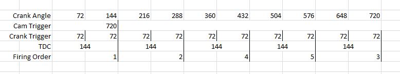

Ok, so please educate me if I am missing something and not thinking about this correctly but I think that it would work if used with a cam sensor. I also think that it would work without a cam sensor with wasted spark ignition and two injector pulses per rev.
