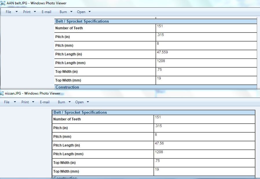

actually for the AAN you can use a nissan CA18DET gates racing belt. so atleast us AAN guys have a solution for a high grade kevlar timing belt.
Gates racing timing belt part # for nissan CA18DET=T137RB
rock auto has the belt for 48.00.
I attached a picture of the data for the AAN belt and the CA18DET belt both from gates so you can see for yourself that their pretty much indentical. companys like greddy and several other JDM companies offer kevlar race timing belts for the CA18DET. as for the 3B/7A and ADU guys im still going to work on gates to get race belts for you guys as well.

Re: Gates racing blue timing belts
Great cross reference!
ringbearer wrote:Great cross reference!
X2
