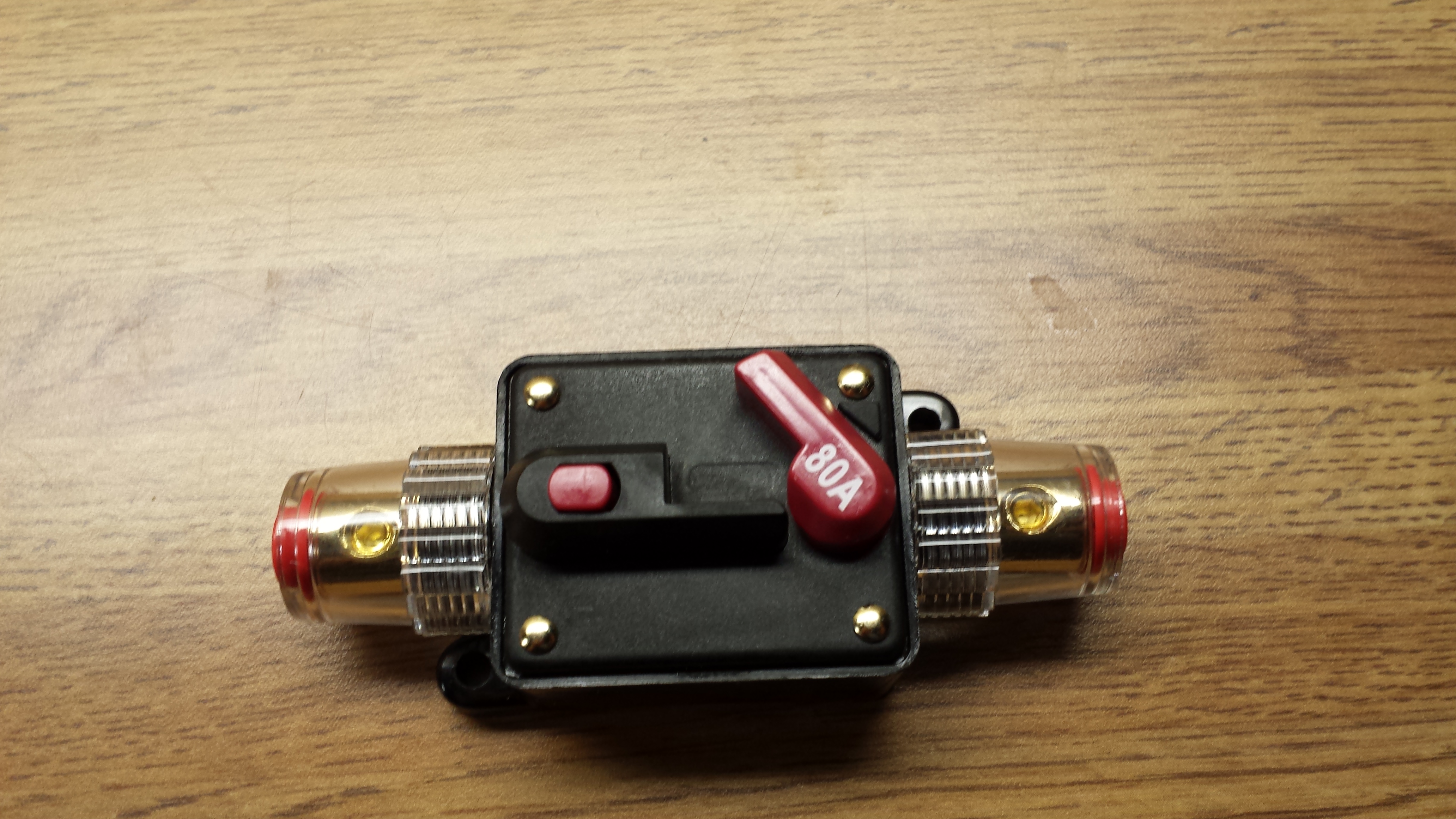

I ordered an eBay turbo blanket and got this 80A relay for the 200's coolant fan to replace the non-resettable fuse that blew once last summer. It never happened again after I shielded it from the coolant fan escape path but this will be easier to use if theres another fuse failure. 80 amp obviously.

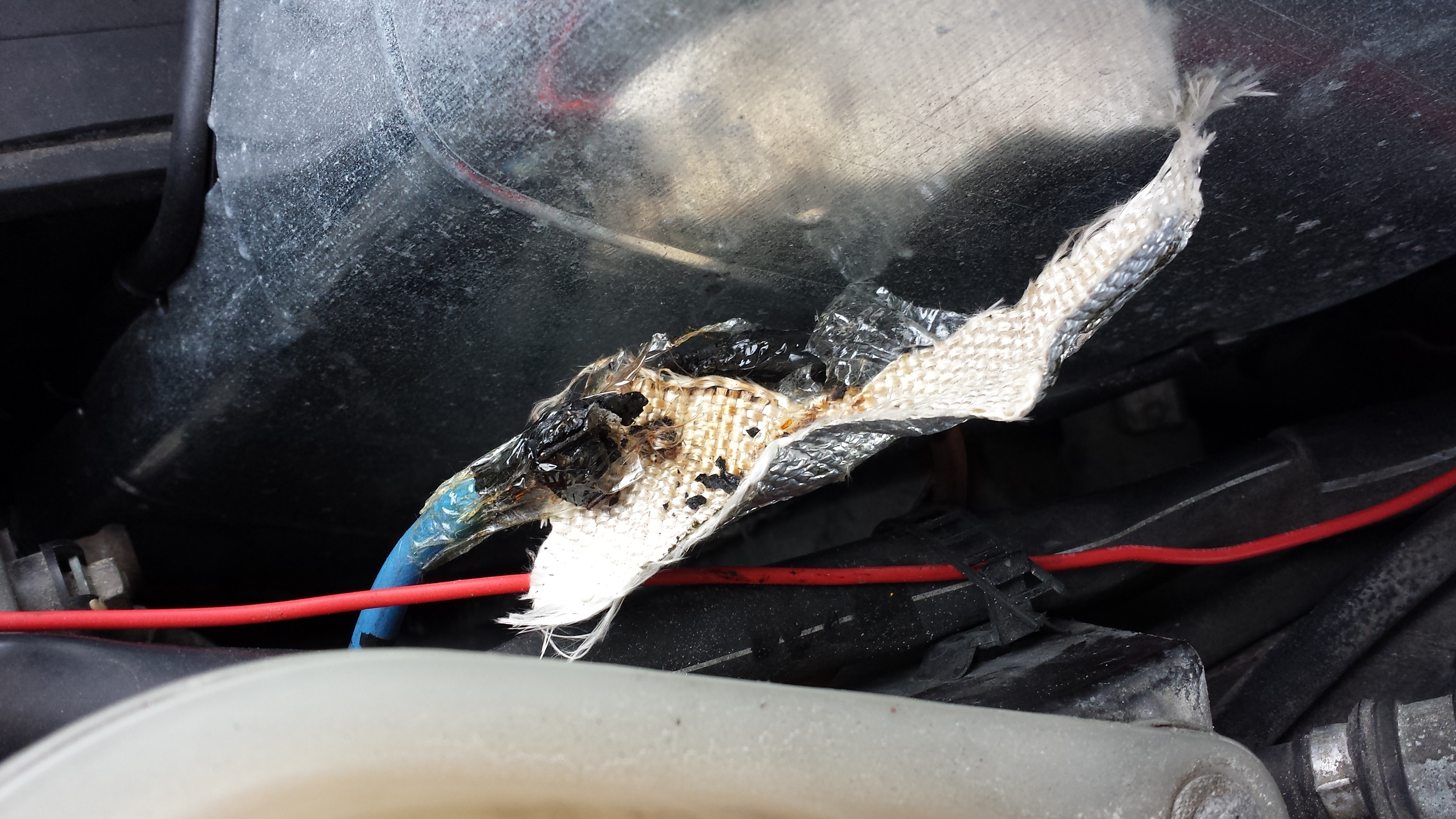

Well speak of the devil. Wonder how long that's been bad lol
For reference that's the fuse for my fan I've been mentioning

So you've blown multiple fuses for that fan? Ever thought maybe the fan or wiring is shot?
This is only the second time it's happened but the first time it was about 90 F out and the fuse was exposed to alot of heat from the fan running. I put up heat shielding tape all over it and didn't have another problem until now so that made me think it was all the heat under the heat contributing to the fuse heating up more than what it was already getting from the curcuit's amperage. I thought I read on sjm that an aging fan could blow the fan occasionally as well. Now it won't turn on even after installing the fuse thing so I guess I'm going searching.
Ya so this ebay fuse is garbage. Get what you pay for and for $10 I got a brittle plastic thing with little spinny bolt thing and metal. Broken but thank God I haven't left feedback yet. Everything works again but I put an 80 amp fuse from autozone in there until I find something better.

Small piece of copper pipe cut to size. Just write 80 amps in permanent marker on the top. Gtg.

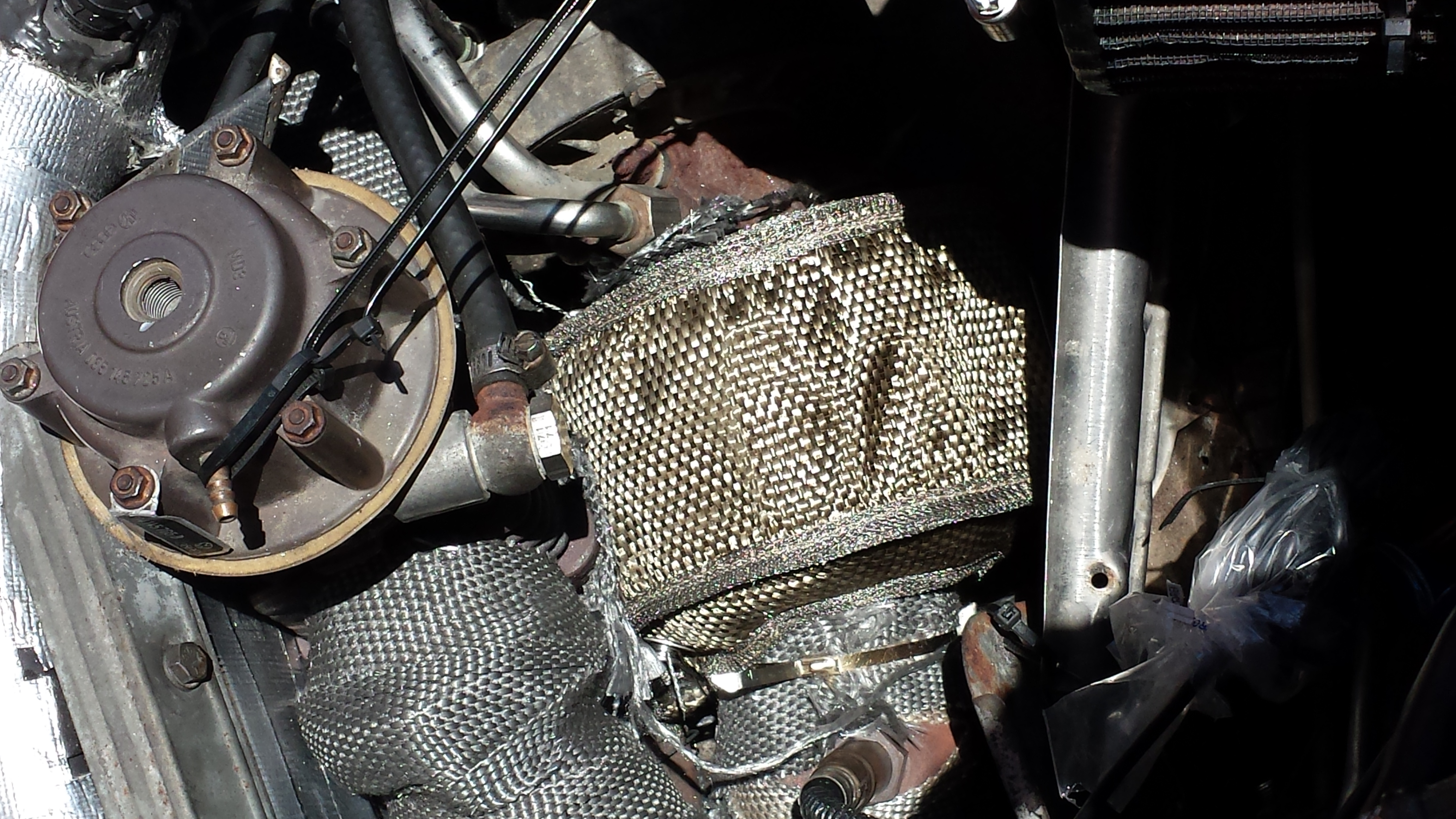

Welp my $30 ebay turbo blanket was total trash and I had a feeling I might get what a paid for lol. I paid off my VEMS ecu a couple days ago so that got me to thinking what blanket I might get if I could afford one now. Enter PTP lava T3 blanket. Exit underhood radiant heat mayhem
It is most excellent
The crap one is going on the 5k since it is still kind of in one piece. Not 100% loss I suppose.
