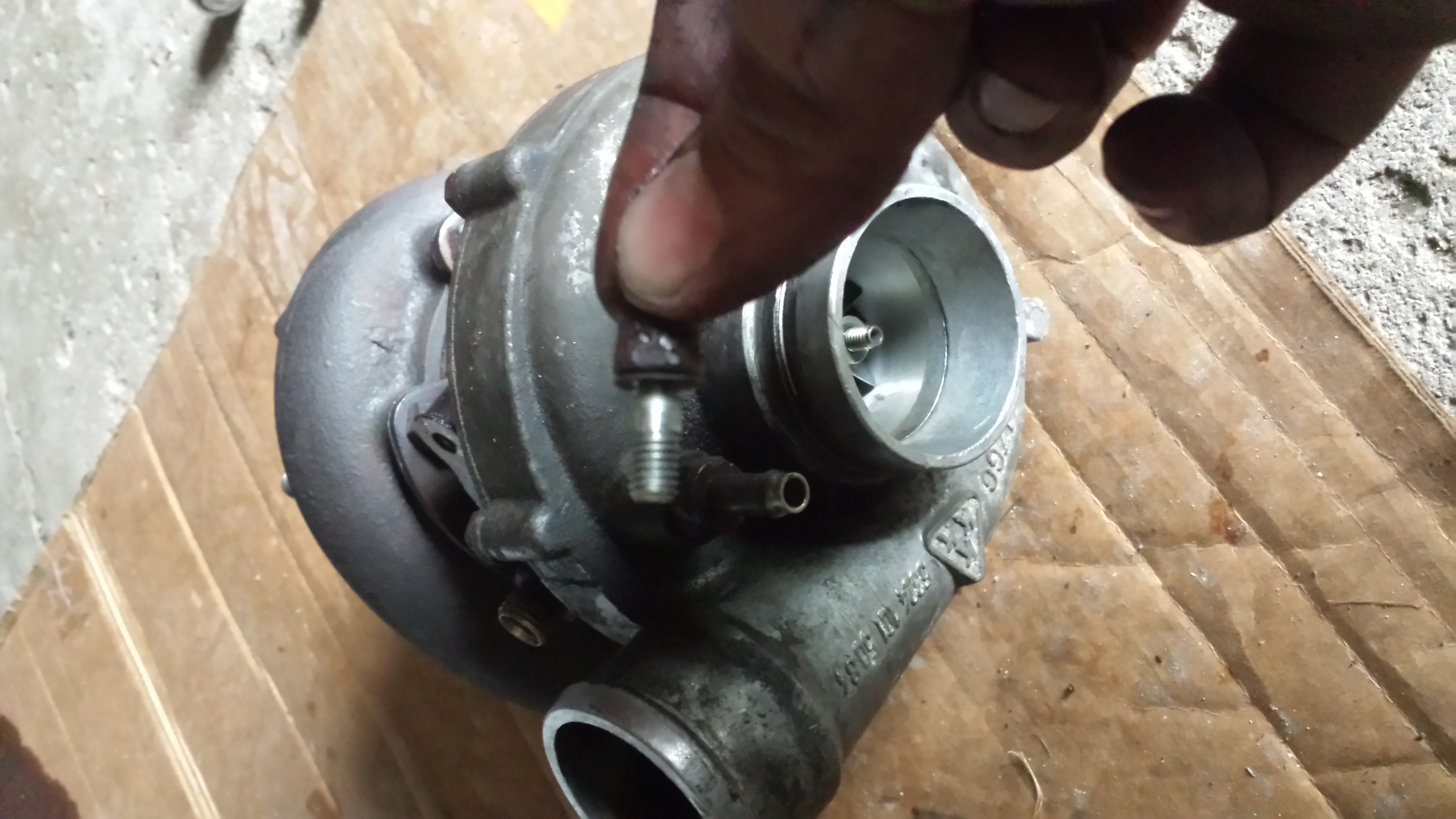

Ready to roll on this. Got the baby k24 out early and sourced updated nuts and bolts for the rust crap in there.
I think I'm seeing a threaded hole on the turbonetics housing. I'm assuming it would show pressure instead of vacuum. I grabbed the k24's in hopes that the threads do in fact exist and are identical.

It'll show pressure and vacuum unless I'm not imagining what you're talking about properly.
The port is the reference port for the N75 same as the one on the OEM turbo. Just swap the fitting to the hybrid, and hook it up as normal.
Oh interesting. Well the ports reside in different areas of the compressor housing. On the k26 it doesn't exist. On the 24, it's on the smaller portion of the snail shape lol. On the turbonetics housing it is on the straight section of the housing where the IC clamps to it. I'm having a hard time imagining what sort of pressure it will see under ALL cobditions. Looks important for internally gated turbos from turbonetics which it goes directly to the diaphragm thingy of the gate.
Oh very nice. That's cool that the threads will work. I may hack up the cobra head for stock hose ports or I'll run my catch can to atmosphere *GASP* and the same for my BPV I suppose. At least until I figure it all out. Thanks again all

88a5tq wrote:I'm having a hard time imagining what sort of pressure it will see under ALL cobditions.
When the turbo isn't turboing
that port will see near as makes no difference the same pressure as any other part of the intake tract will. If you held the compressor wheel from spinning while the car is running it would just keep running like normal. Make more sense if you think about it like that? A turbo just sort of coerces the air to pressurize rather than forcing it to the way a positive displacement pump would (roots supercharger, gear pumps, triplex piston pumps, an internal combustion engine, etc.). The turbo just gets the air going so fast in the outward direction (think of it like centripetal force) that the pressure increases if there is a restriction on the other end. Your engine is that restriction.-Chris

Here's a little info I remember from a while back about the reference port on the comp housing. I'm not entirely certain but I think even at idle there is no vacuum at that port.
I skimmed that but I will read it in etirety at some point. Looks very interesting. Thank you for posting it up

Hmm yes, if the port is at the base of the housing that could cause some differences. I hadn't even considered that. That makes for some good thinking! I was more referring to a tap near compressor outlet.

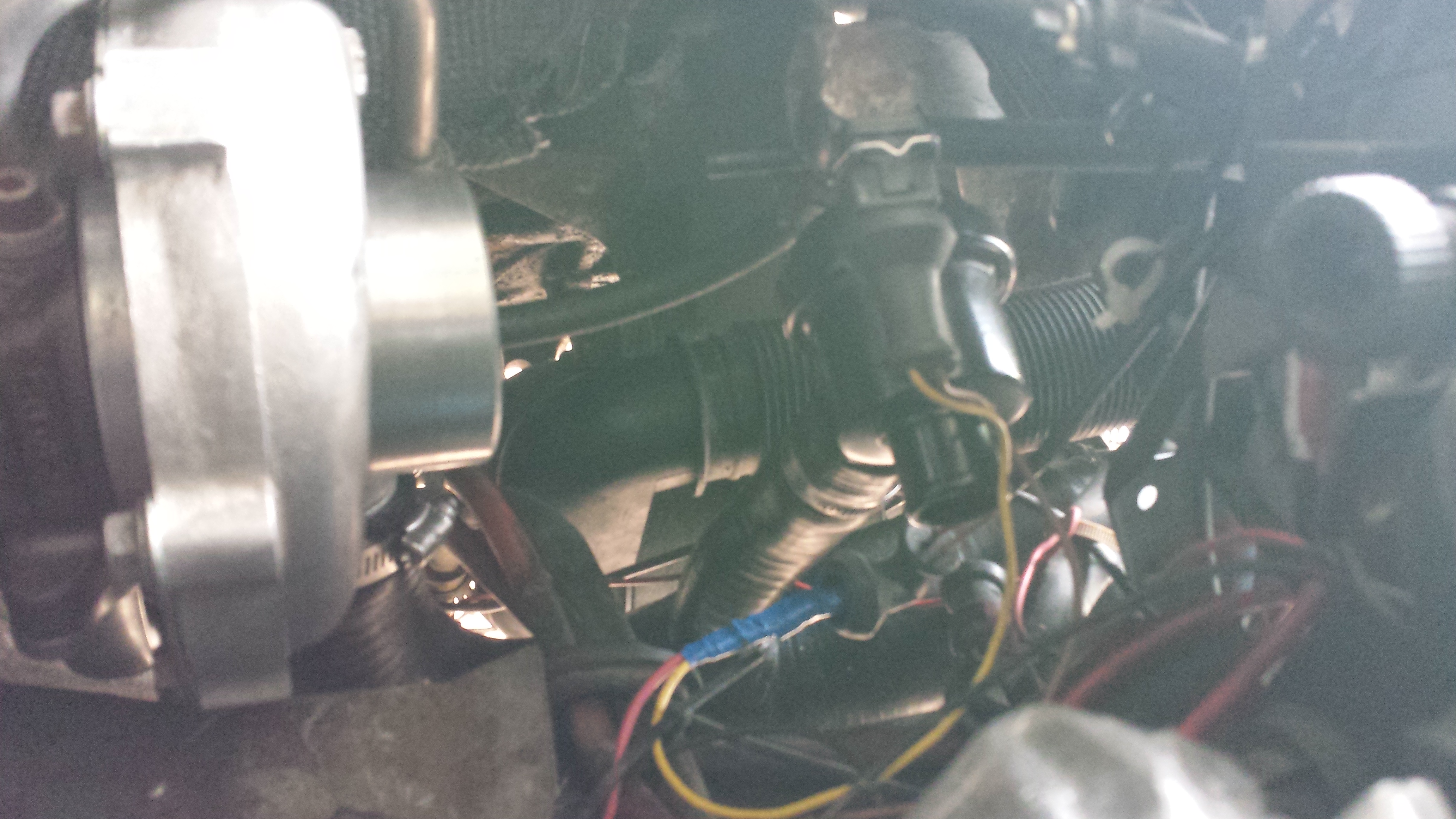

I'm trying not to butcher the cobra head just yet. Anybody know if I can run without a filter on my 034 BPV if I don't reroute to turbo intake boot? Put in 5 hrs carefully reassembling with the turbo. I don't wanna suck in a bird or anything through the BPV at idle after all that
Current form...

Shouldn't the BPV naturally be in a closed state?
