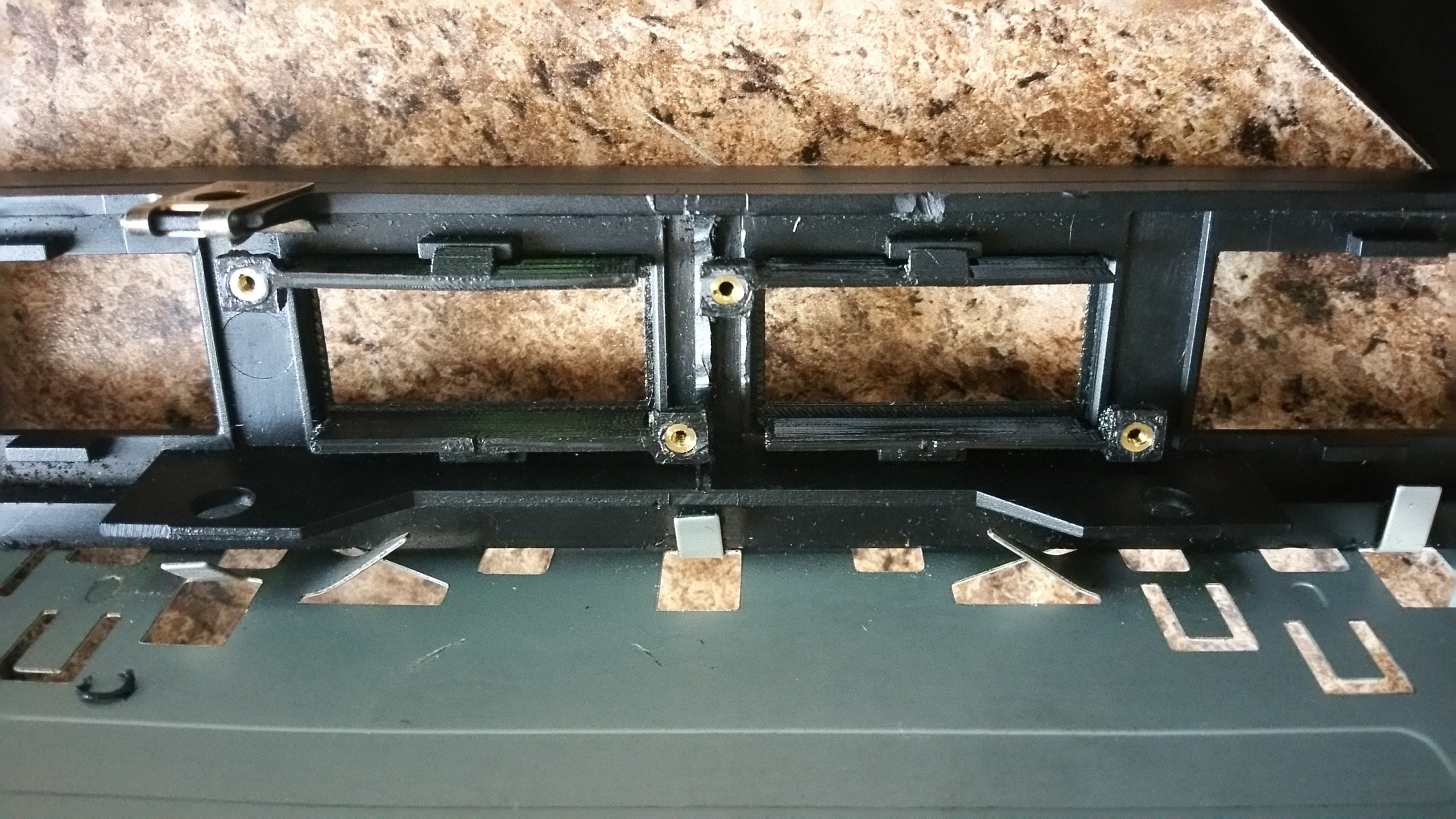

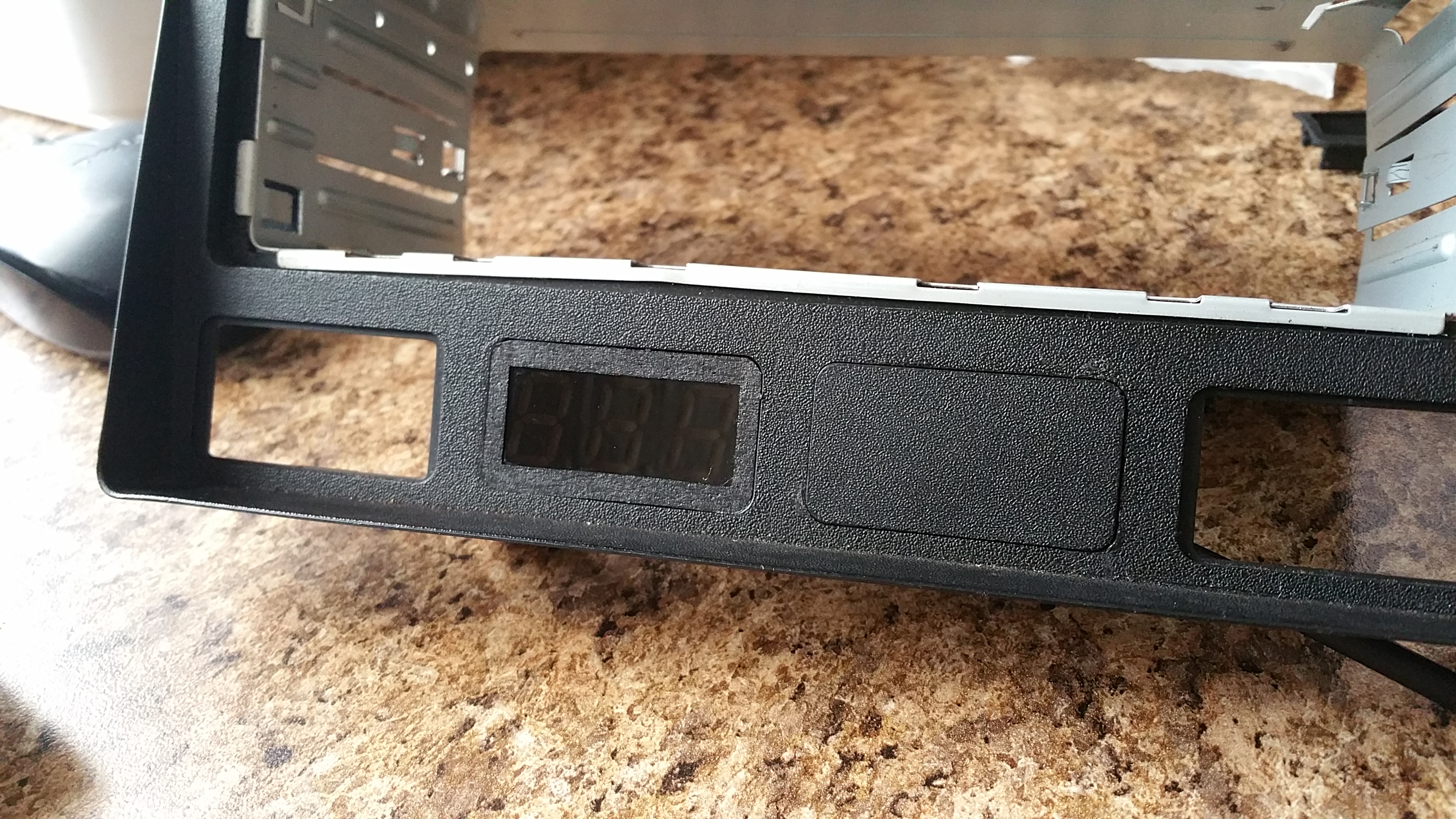

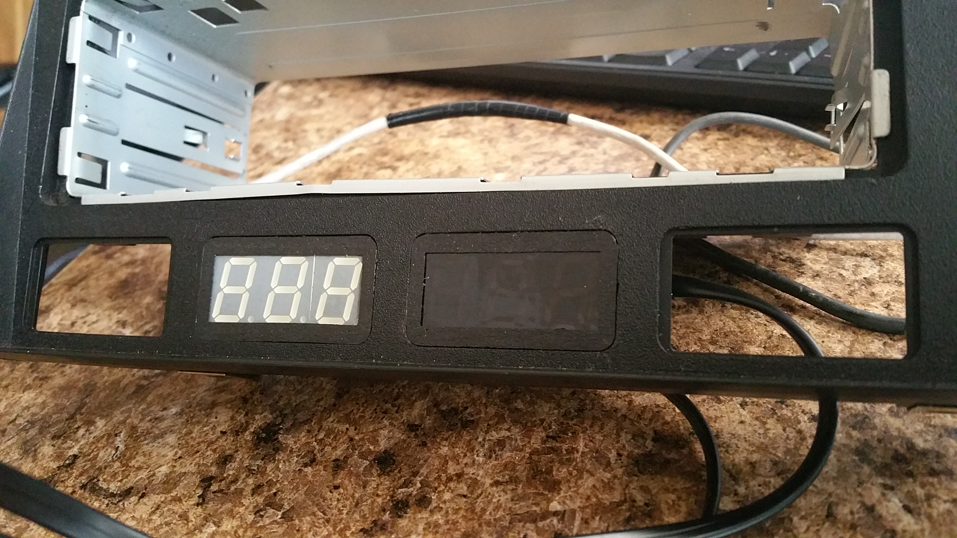

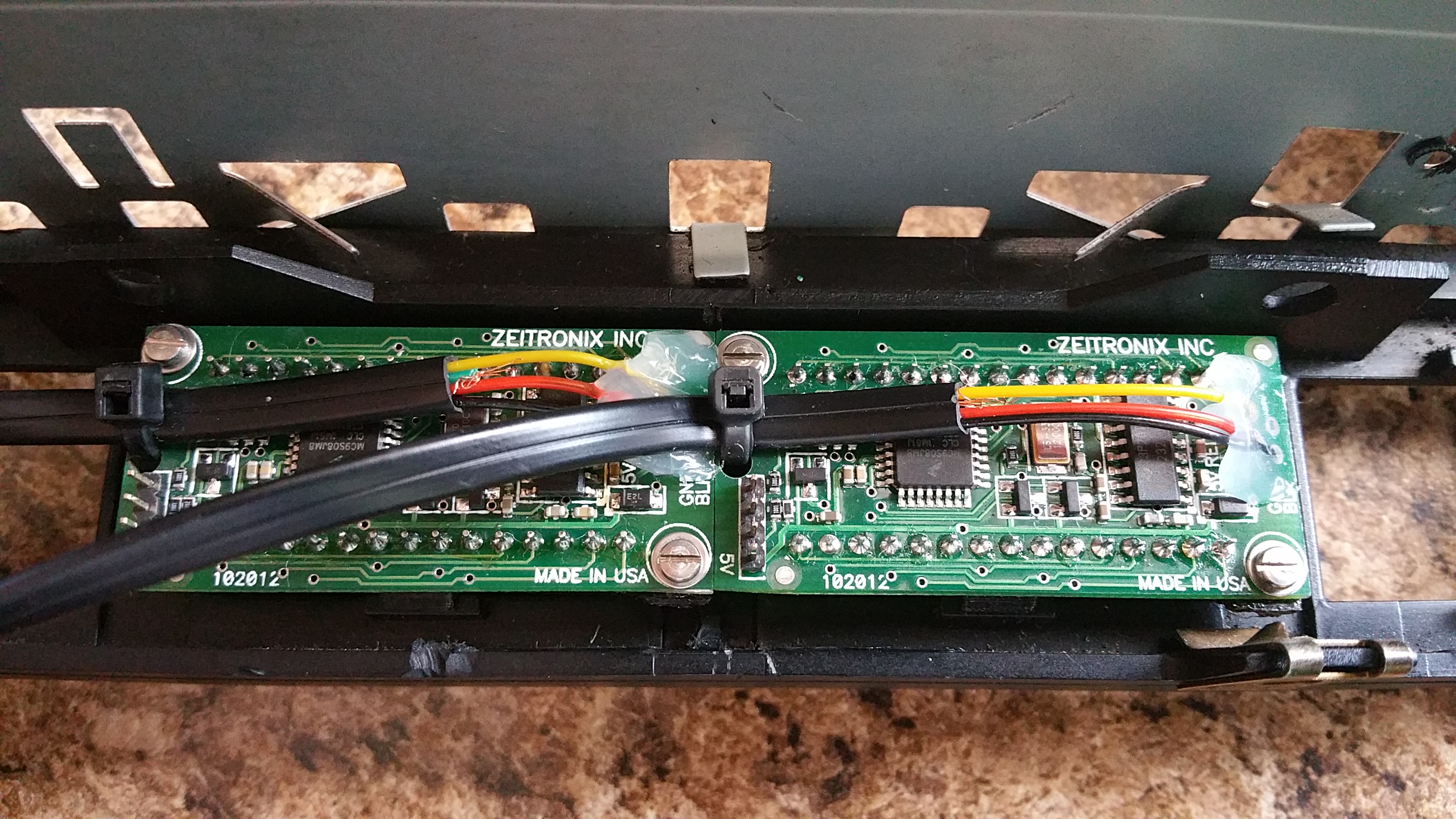

A few more pictures of the wideband display for documentation purposes, and also a few pictures of BMWs from last weekend because why not.
(The toys are all out!)

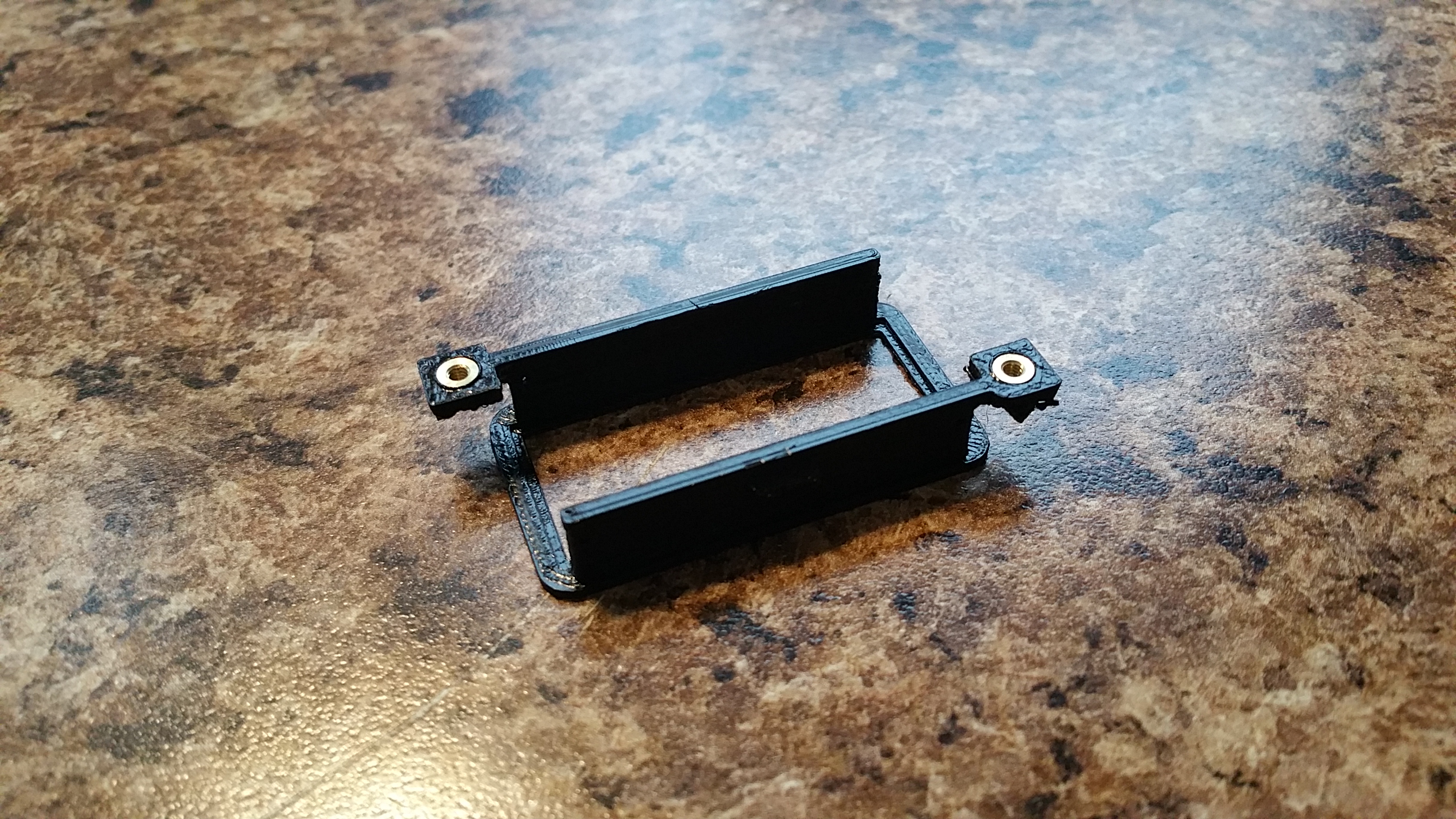

Just wanted to show the finished product of my zeitronix wideband panel blanks for 80s and 90s BMWs. I'm not sure exactly which cars has panels like this in them, but I know they work with e30s and e24s at least which probably means they work in e28s and early 7 series as well. Maybe there are others too.
I was compromising in some areas before, but now I've got a design that I really like and don't feel needs any changes. The panel itself mounts in the dash with two clips. Then the display mounts to the panel blank with screws and brass inserts. When the number display is inserted into the panel, it makes the panel impossible to remove providing for very secure mounting.
Mounting is flush and with fitment comparable to the stock panel blanks. The finish is textured. It isn't exactly the same as stock texture, but it is as close as I can get with this method of manufacturing currently and at the price I can produce them for and it still looks pretty good. It is only noticeably different in how it reflects light at certain angles of incidence. The blank panel next to it is OEM.

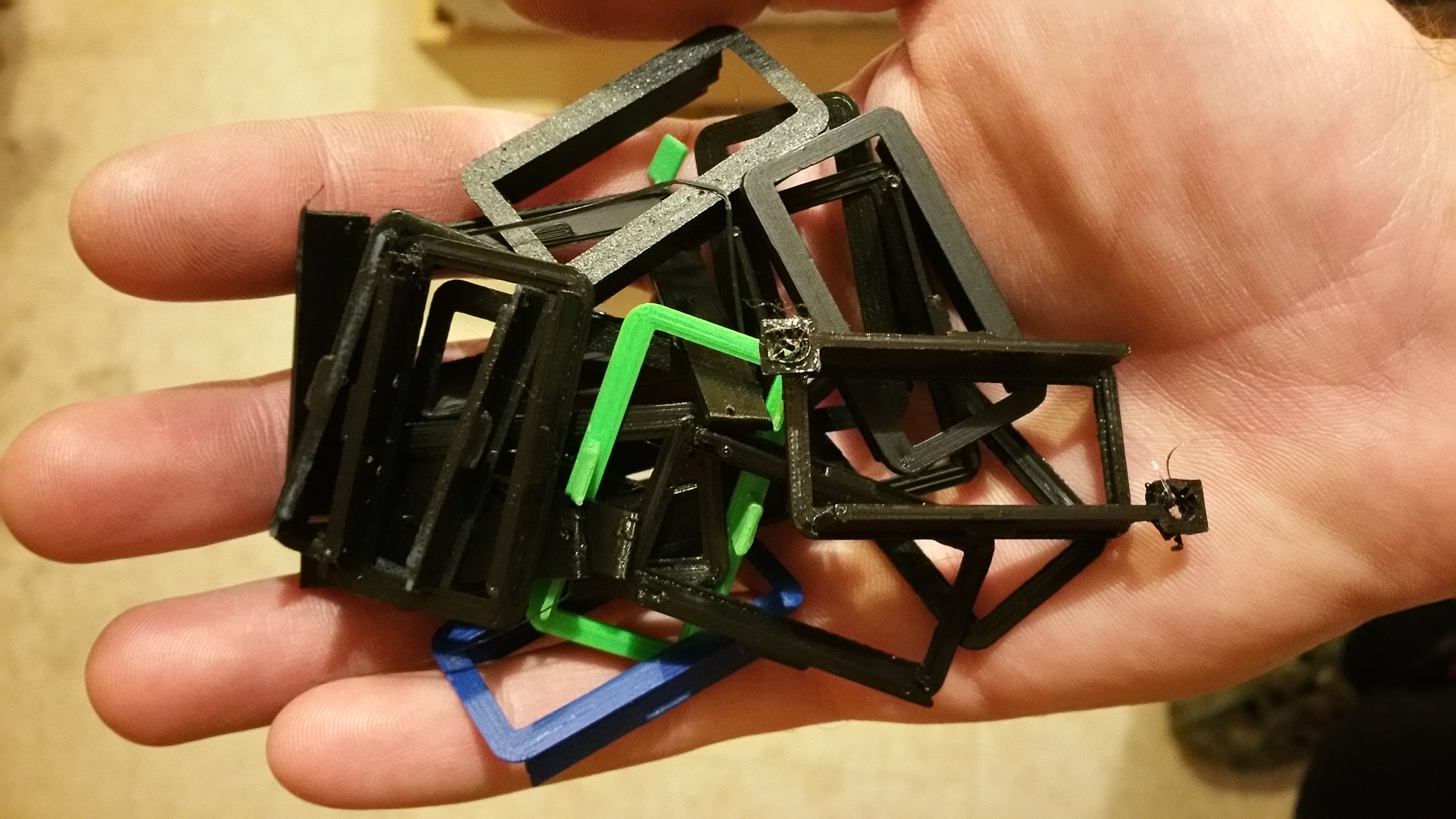

Here are a few more pictures
Failures lol
Failures lol
