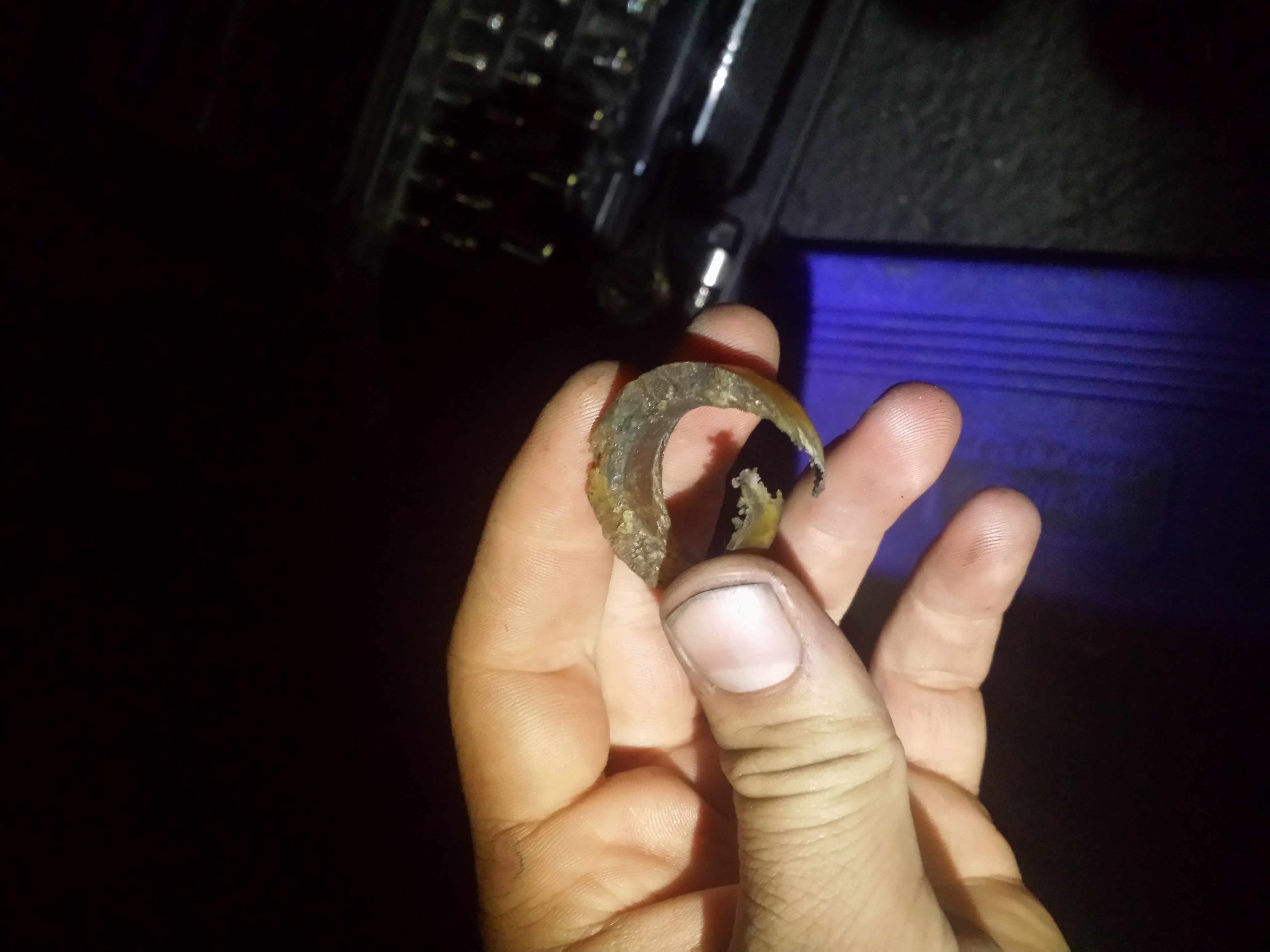

Yeeaaahhhh this project was HORRIBLE! My arms are on fire from rubbing against everything possibly abrasive under this car. I had to try installing it 4 times with 2 of those tries involving removal and uncrimping the bushing to remove and trying again with the bushing hovering over the linkage it presses into. Had no freakin idea the trans "ball" thing couldn't be pressed into the bushing with everything installed in the linkage beforehand.
I have everything done now except I have to figure out how the hell to crimp the bushing with it still installed. I'm afraid to check, but I may have even shit myself struggling and wrestling with this garbage...
Leftovers?
Leftovers?
