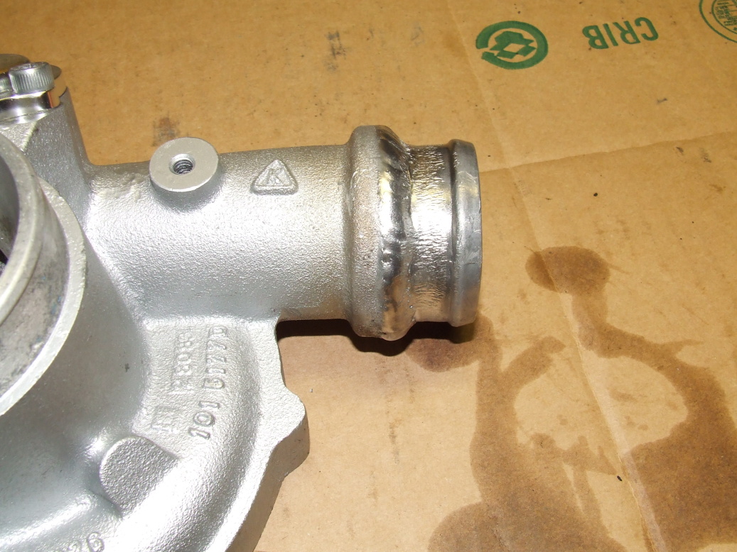

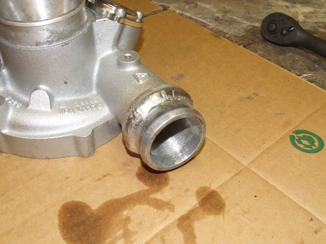

Ive cut the v-band off the volvo turbo and welded the stock k24 outlet
¯\_(ツ)_/¯
project 2226
Re: another S2 conversion
Weld looks great - nice thread!

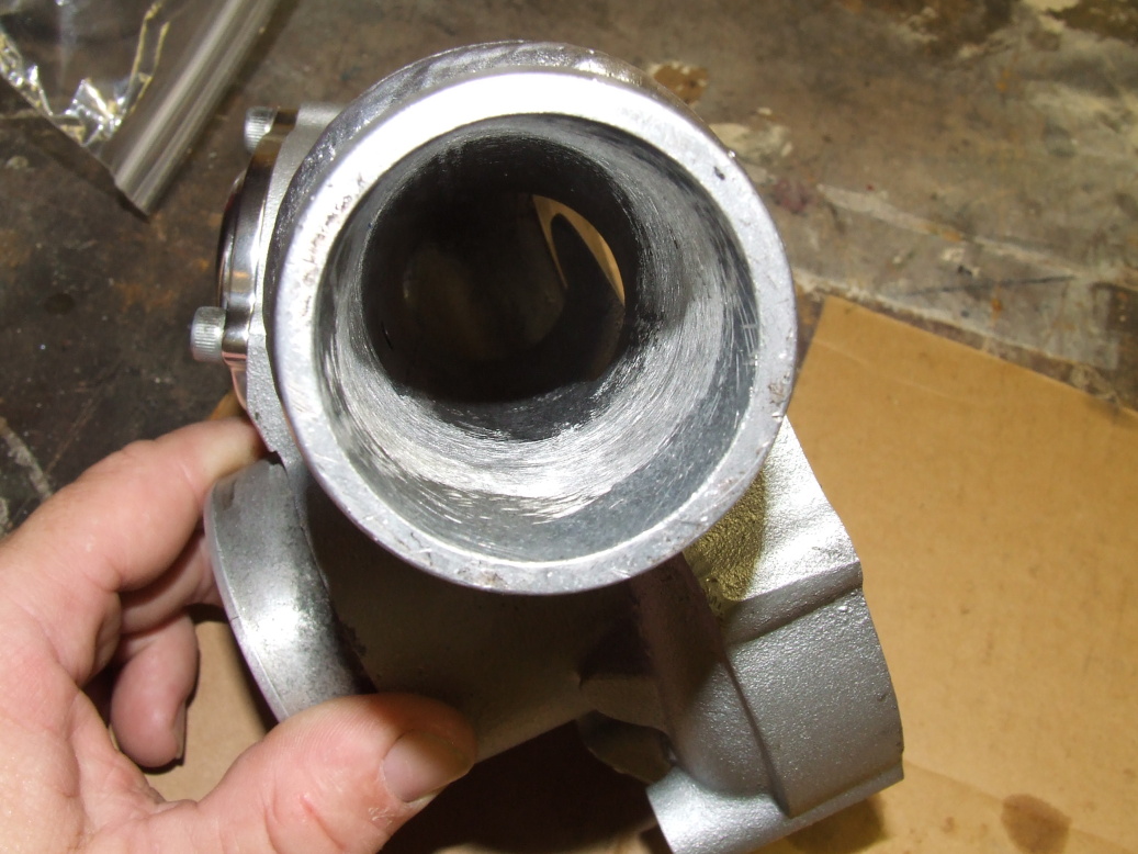

made some progress:
i had to play a lot till that cobra head was fitting
however i ordered some low profile mushroom filter, i think i will go with that.

I would go cobra head and real filter like the aem dry over those crappy mushroom filters. They suck and tend to fall apart
Posts: 2142
I have run a lot of cobra heads and they work great. No restriction.
When Eric was installing his Volvo K24, he had me turn down the inlet so he could use a smaller cobra head to clear everything.

DE80q wrote:When Eric was installing his Volvo K24, he had me turn down the inlet so he could use a smaller cobra head to clear everything.
yes, i've read that, but its too late now. i wont remove it. maybe later

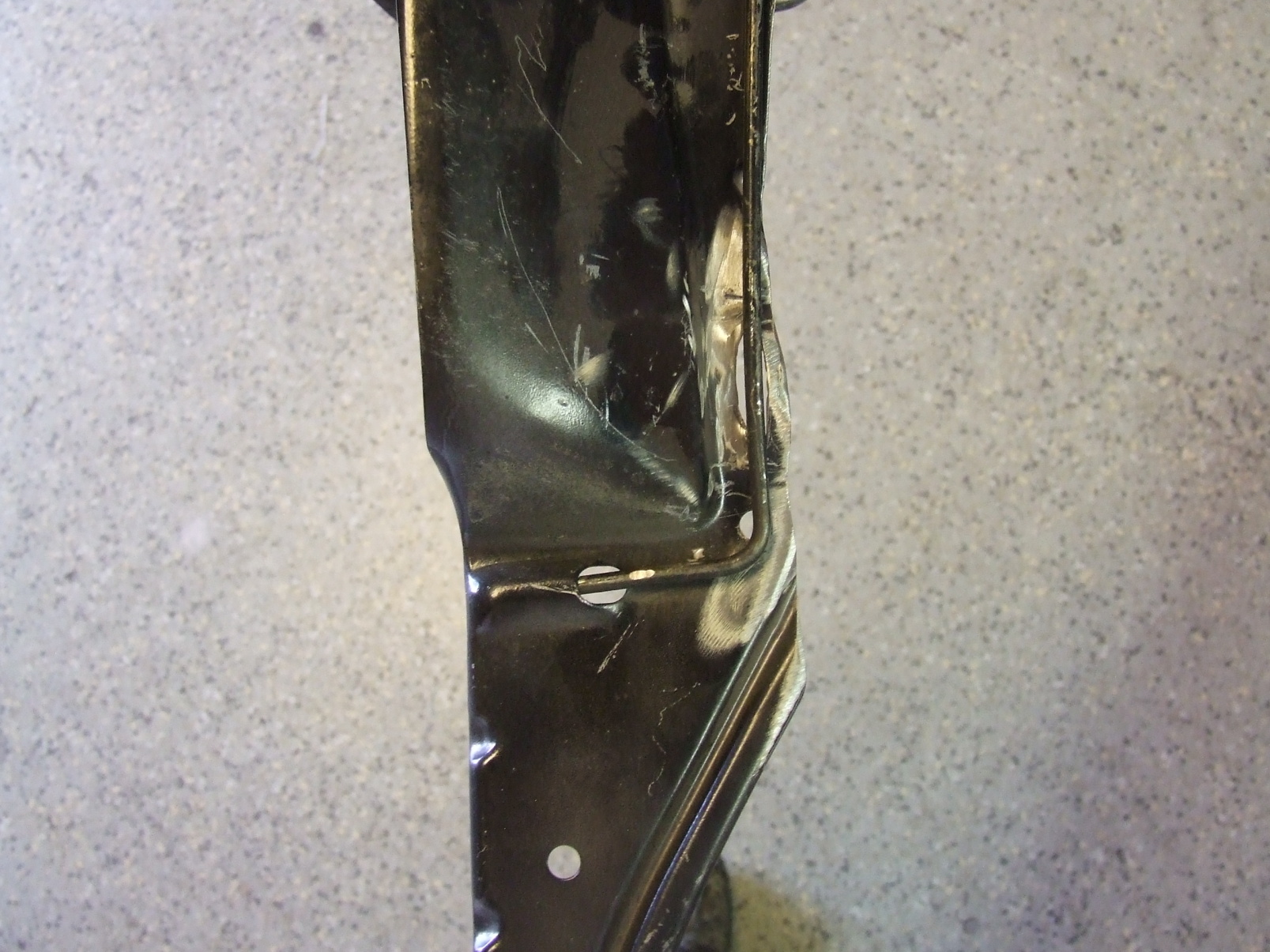

the interesting thing is, David had the same turbo, exhaust manifold, and cobra head, and he had no problem. mine was an inch longer, i had to trim from the cobra head and from the passenger side frame

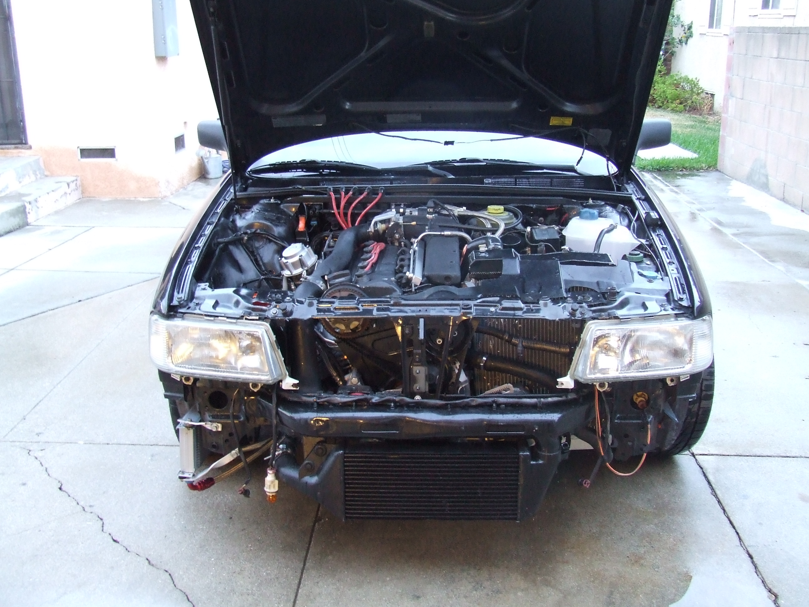

Few more pictures, and I think im done with the car for a while.
Car runs and boost well (hitting 26psi), few minor things to be fixed (i have a new set of rubber moldings, door seal, etc) but only after the moving, maybe at the spring.
oil seal was replaced
I am debating the get an other valve cover and machine it for the red coils... I like Dave's setup
S6 seats are very comfortable
and the s6 wheel's offset is great for the cq
I have a set of fusch with a brand new winter tires, so im ready for the winter
In mid January i really wanna go back to Hank, and have him tune the car on the dyno.
