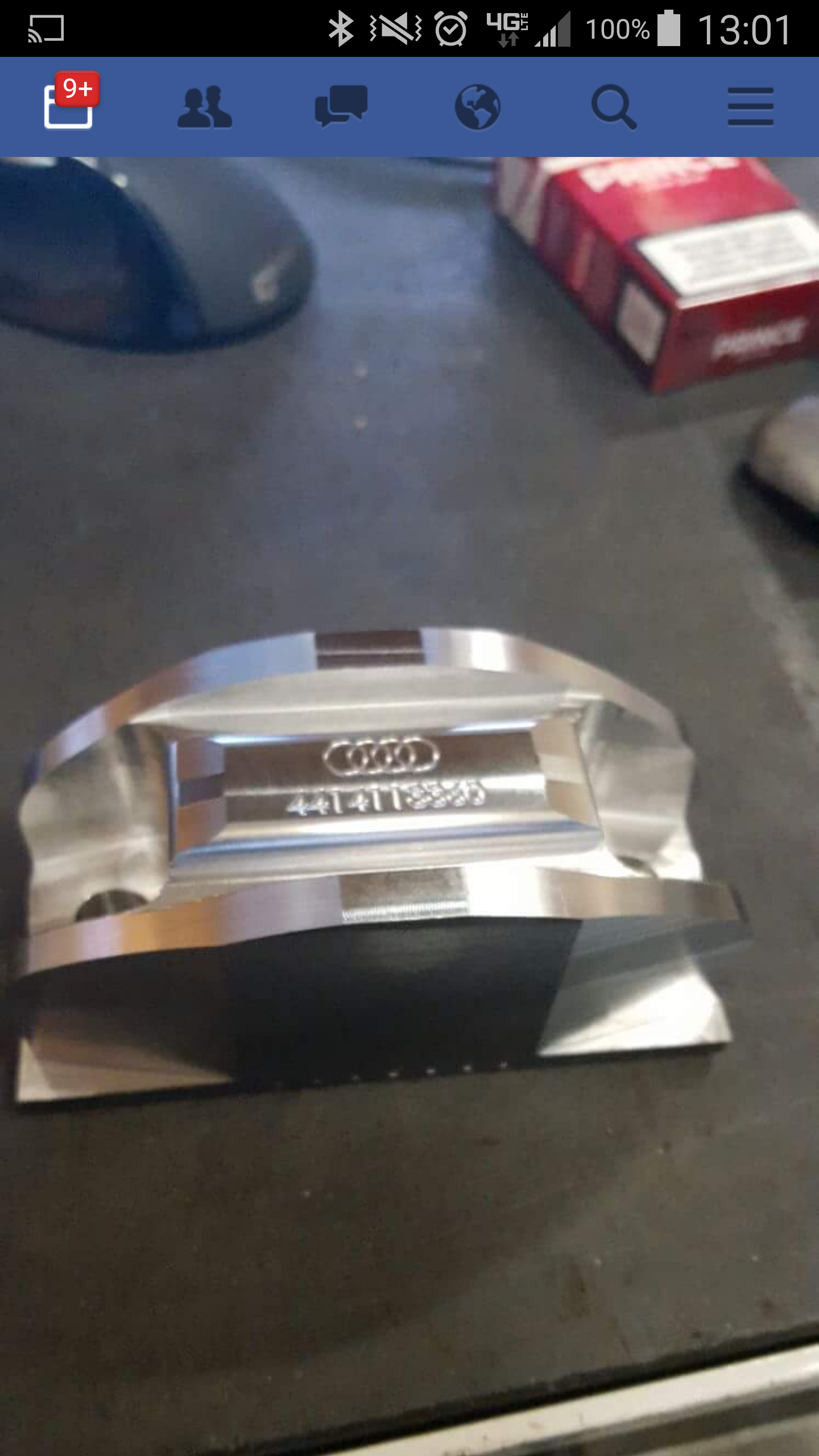

Last chance guys...
- Screenshot_2016-01-26-13-01-07.png (1.18 MiB) Viewed 26544 times

Production is finished by the way, and they are off to be zinc plated. I'm not sure if all or spoken for or not.
