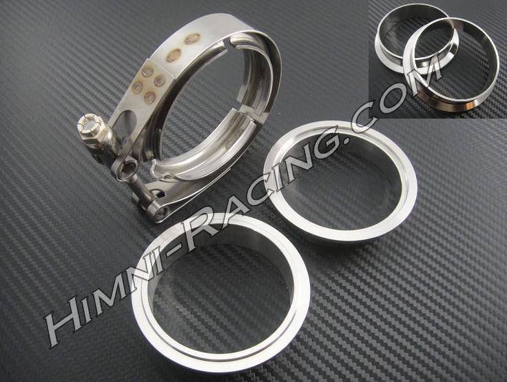

First, parts for making the future EFR downpipe meet up with my current exhaust:
- 304L U-bend to cut up (made in USA)
- 304L V-bands with interlocking "tongue/groove" (made in USA)
An added bonus of this will be that I can take out my exhaust dump if needed for some reason (car is still registered in FL :D ) because now there will be v-bands on both sides of it.

If we recall from a few pages back, I need about 30-32-ish inches worth of arc length in piping to create my 1/4 wave resonator. I ordered:
- 24" 304L straight pipe (USA :) )
- 304L 90 deg bend (USA)
- Interlocking v-bands (USA)
- 304L Sanitary pipe flat end cap (??)
(all stainless pipe, bends, and v-bands from Himni-Racing)
Interlocking vBands.JPG (79.01 KiB) Viewed 31647 times

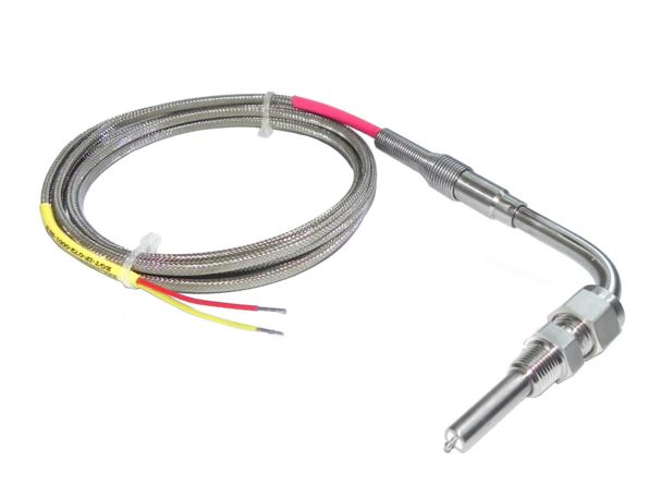

If you recall again, the length of the resonator is crucial to it's effectiveness at attenuating the target frequency, so I need to know the approximate temperature of the gas inside the pipe while under operating conditions. I like to overdo things, so I spec'd an EGT sensor which I would trust for the job in one of the manifold runners for the revver in the future.
- Vibrant 304L EGT bungs (???)
- (I like this one) TheSensorSource.com EGT Sensor
• Exposed junction for fast response time (150 ms)
• 1/4" diameter
• -148°F to 2372°F range (-100°C to 1300°C)
• Special Limits of Error accuracy (+/- 0.4% of reading)
• Inconel 600 protective sheathing for longevity at high temperatures
• Sheath Wall Thickness 0.030" (.76 mm), MgO insulated
• Stainless steel over-braid cable with Teflon™ insulated conductors; 6 foot
• Our probe material is Inconel (Inconel is extremely corrosion resistant, maintains hardness at high temperatures)
• Our lead wires are Teflon insulated (cheaper probes often use Fiberglass insulation that can absorb moisture, wires prone to shorting & corrosion over time)
• We use top quality, high temperature, waterproof potting compound at the probe/wire transition
(cheaper probes often use an inferior potting compound which can allow moisture to enter into the transition causing shorts, these cheap potting compounds also prone to breaking down over time)(Hand-made in USA)
If you want a badass EGT, look no further... the tips can be cleaned too if you're worried about the exposed junction.

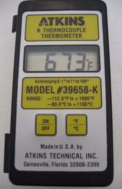

- Atkins type K thermometer for use with the thermocouple (made in Gainesville, FL USA!)
