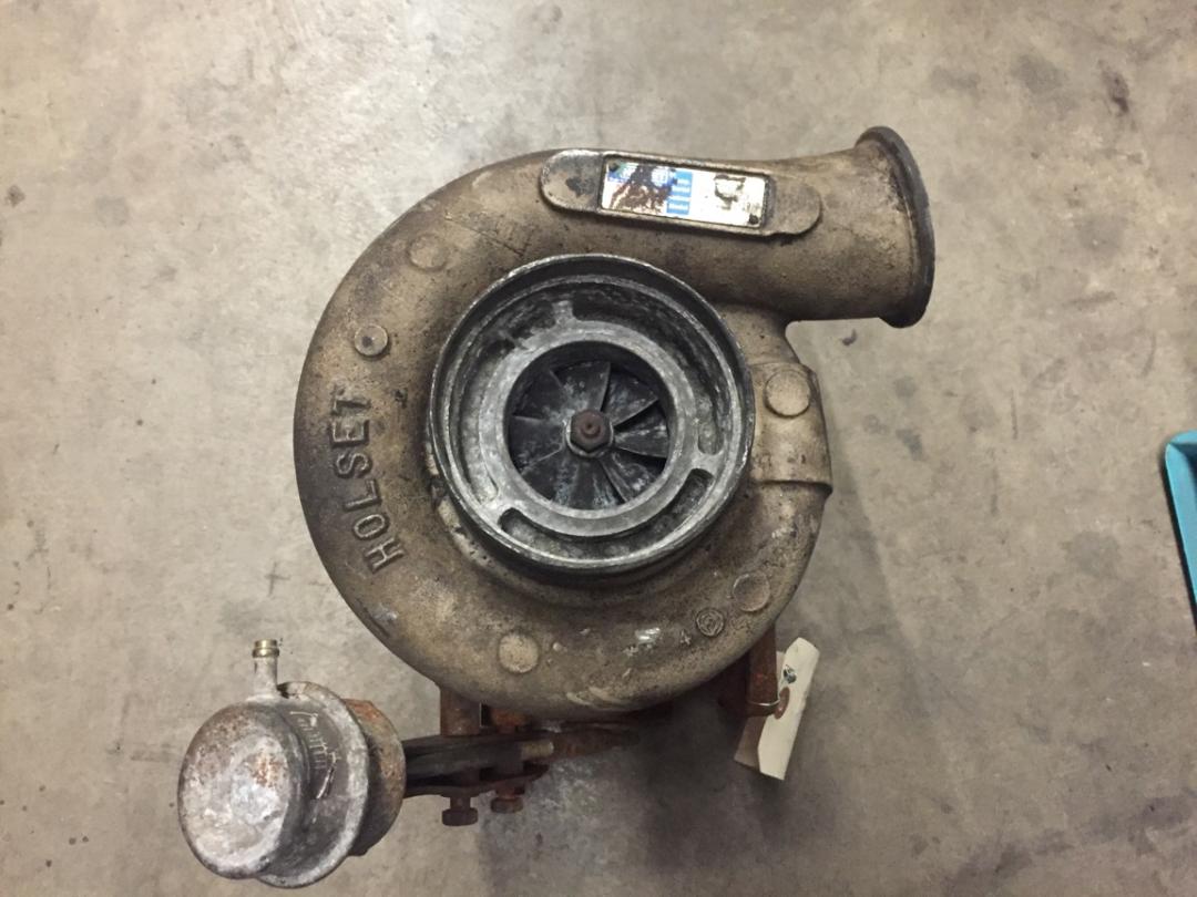

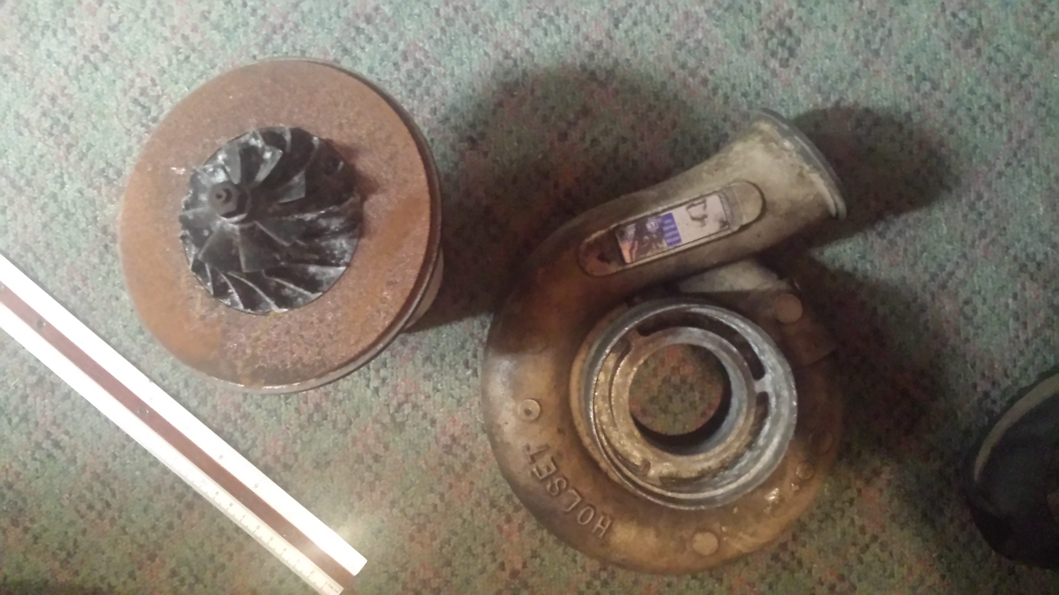

Those guys at G&A don't even measure the inducer of these turbos before shipping them (apparently). I just eyeballed the new one with a ruler to the tune of ~2.1875 with a RULER. Sucker is 55.5mm bahahah! I got the monster hx35 on the 2nd shot. Pretty sweet.
However, this snail needs some serious love :(
I suspected it was much bigger when my 54mm comp housing wouldn't fit it either. You know, the painted one they sent that I was hoping to use on this one. This should clean up good still I think.
