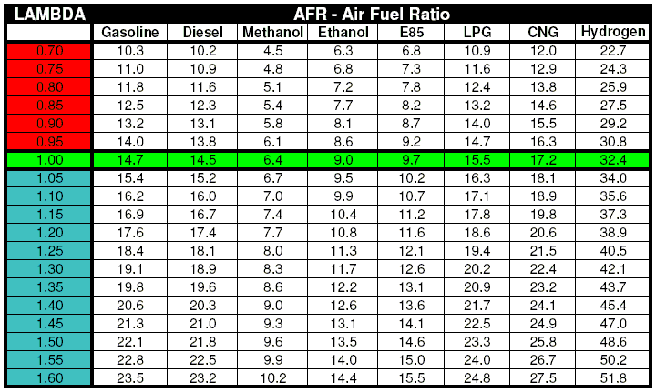

When you say 8.5:1 AF, is that is gas AFR or Ethanol AFR? If you use lambda, it would be easier.

ChrisAudi80 wrote:When you say 8.5:1 AF, is that is gas AFR or Ethanol AFR? If you use lambda, it would be easier.
This is A/F for E85
8.5:1 A/F is about .87-.88 lambda
