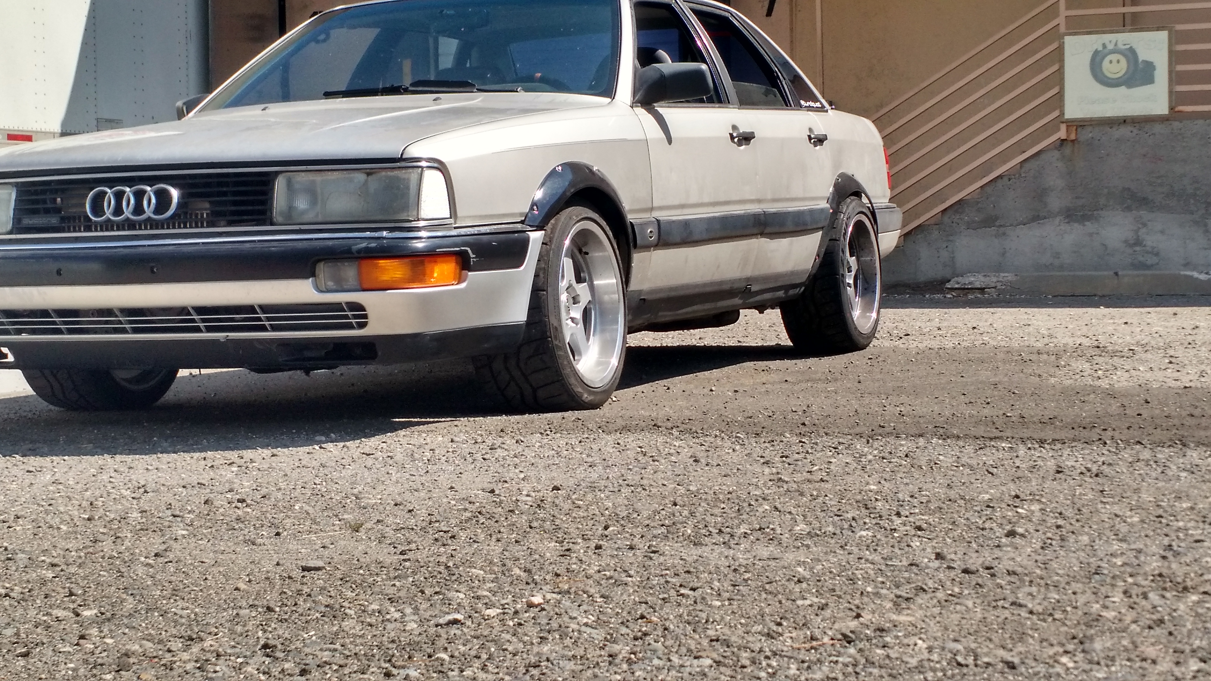

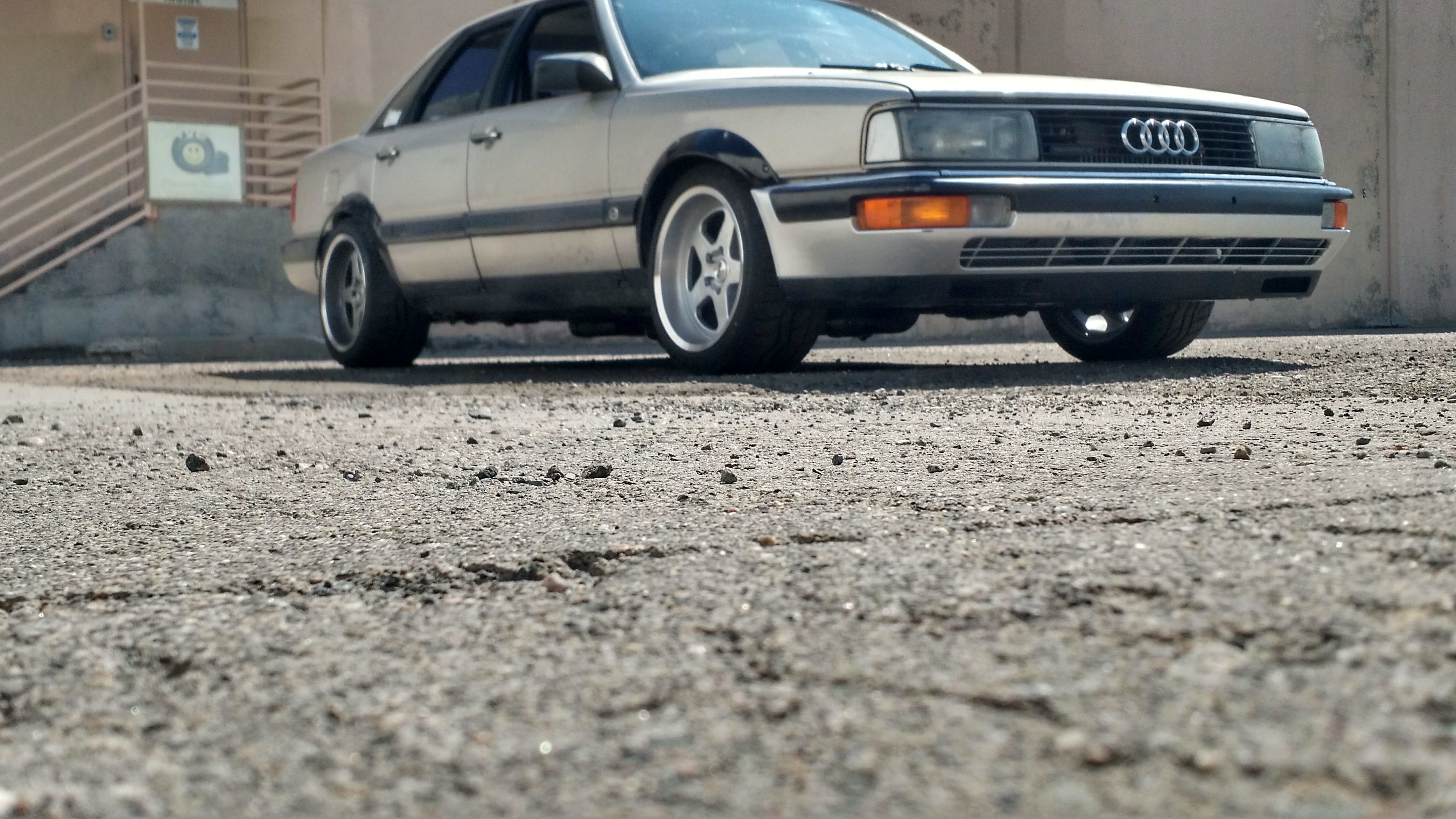

On the plus side, found a silver V8 bumper a while back. On the negative, pick n pull destroyed the rear bumper so I could only get the front.

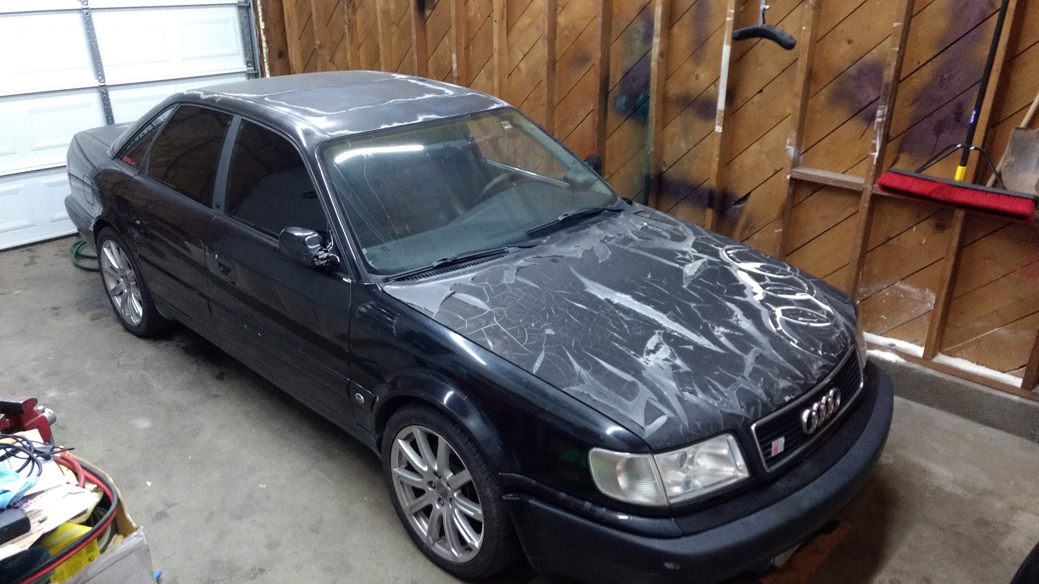

So. Bought my buddies Urs4 that had some piston issues. Hard to explain. will have to show pictures soon.
I helped him mod the car heavily a couple years back and it was a hoot to drive and work on. We lived together at the time so that made it much easier to work on with him.
Now it just needs like a thousand little things to be a good solid car and it's just not worth it to put the time in.
SO. I bought it from him for a good block, and a ton of really good parts like 993 Calipers that I'll be throwing on as well instead of the HP2's i've got lying around.

I like the Acid wash look, and I thought it was just for denim! You got some good parts but you should built the UrS
