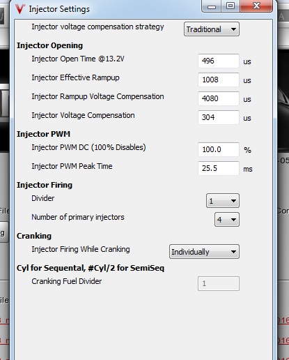

Hi all,
Been searching a lot about this and cannot find the information. I have two spec sheets for the Siemens Deka 630cc injectors, but cannot make out how to use the information. What do I put here as indicated in the picture? Is it correct already?

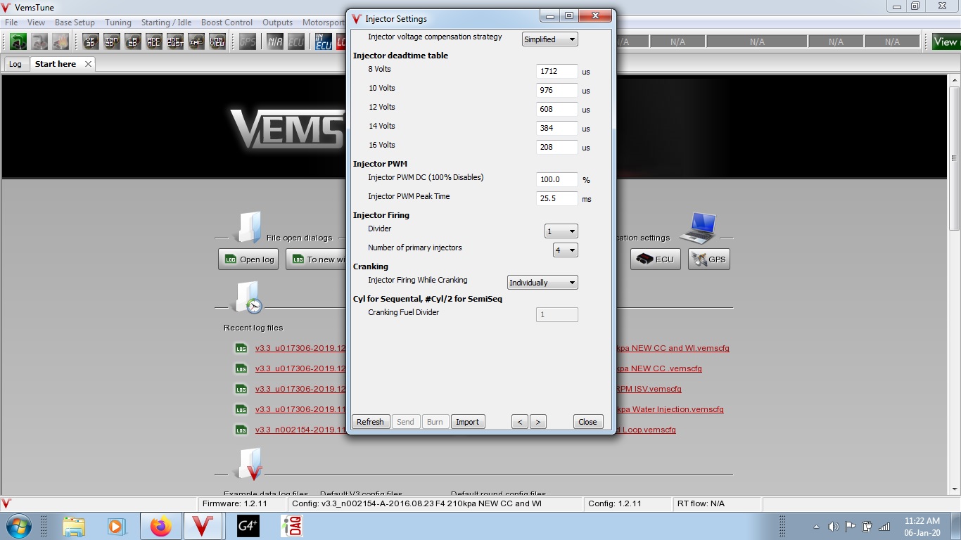

This is what mine are. They are working well, but might need some tweaks on your car. HTH.
Req_fuel is: 4.6ms.

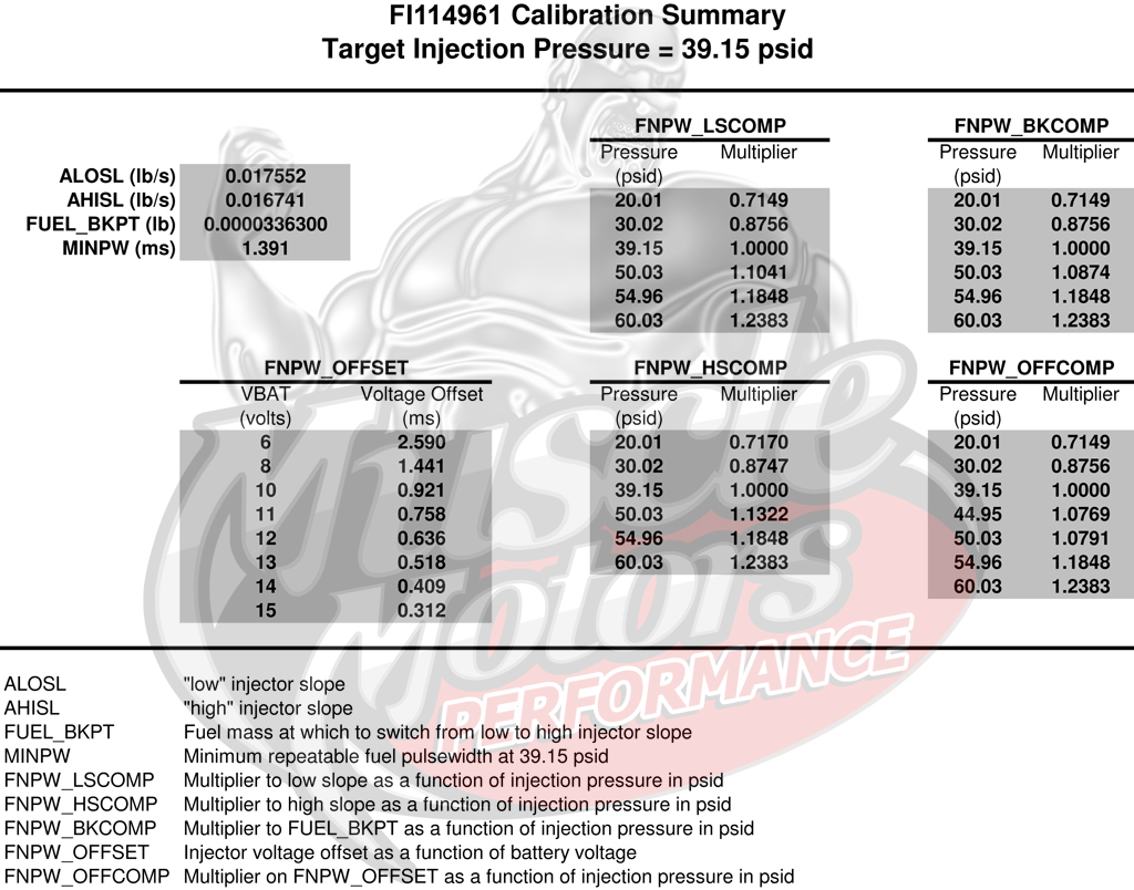

I run req_fuel 5.9 due to E85. How did you get to these numbers? I used the simplified table in VEMS with the numbers sheet from Siemens but the motor ran junk.
I used the attached values for offset, but I guess I needed to multiply by some factor.
- FI114961cs.jpg (349.99 KiB) Viewed 54243 times

I got them from zeet on QW and then tweaked them a bit to my system.

I didn't mess with them too much. Mostly the voltage cells that the car most commonly operates in. Even then, I didn't move the values more than maybe +/- 100us. It's been a long time since I messed with them. The traditional settings work pretty well, but I found I was able to get better results in fuel and idle tuning with the simplified settings.
You can try this method with deadtime calculation also: http://www.vemssupport.com/forum/index.php/topic,2240.msg24790.html#msg24790

Changed my injector effective rampup to 240us, from 1008us. Big difference. Much better injector response that required a complete retune of the VE table had to go 10-20% up almost everywhere.

- Deka 630cc latency data 3bar.jpg (182.28 KiB) Viewed 42475 times
