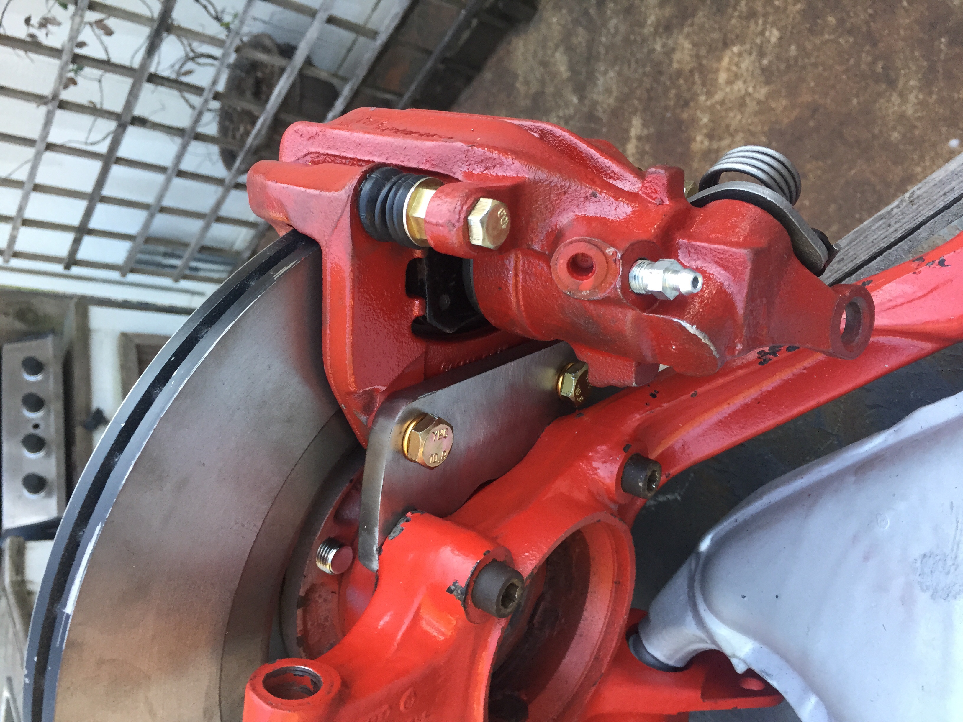

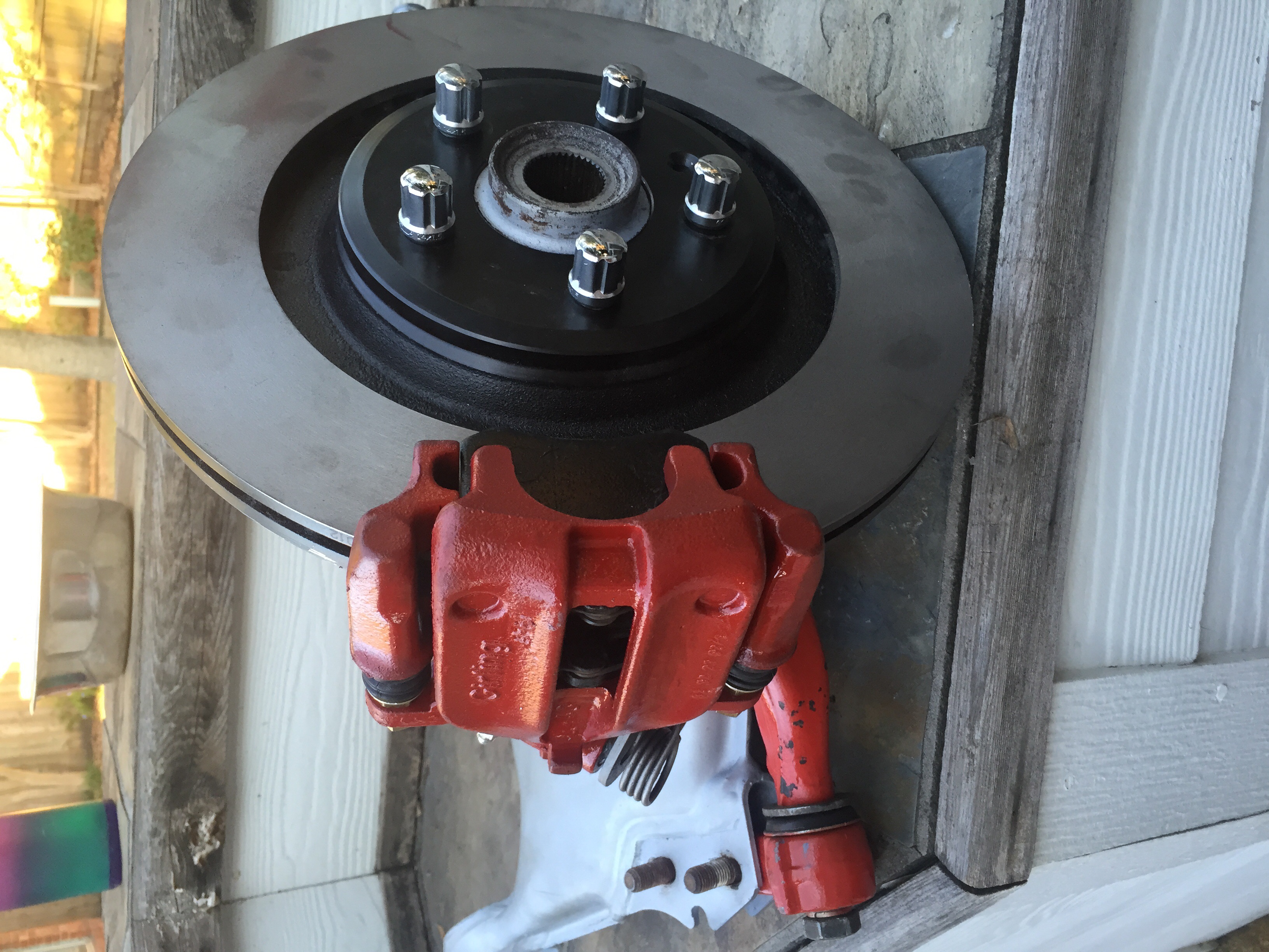

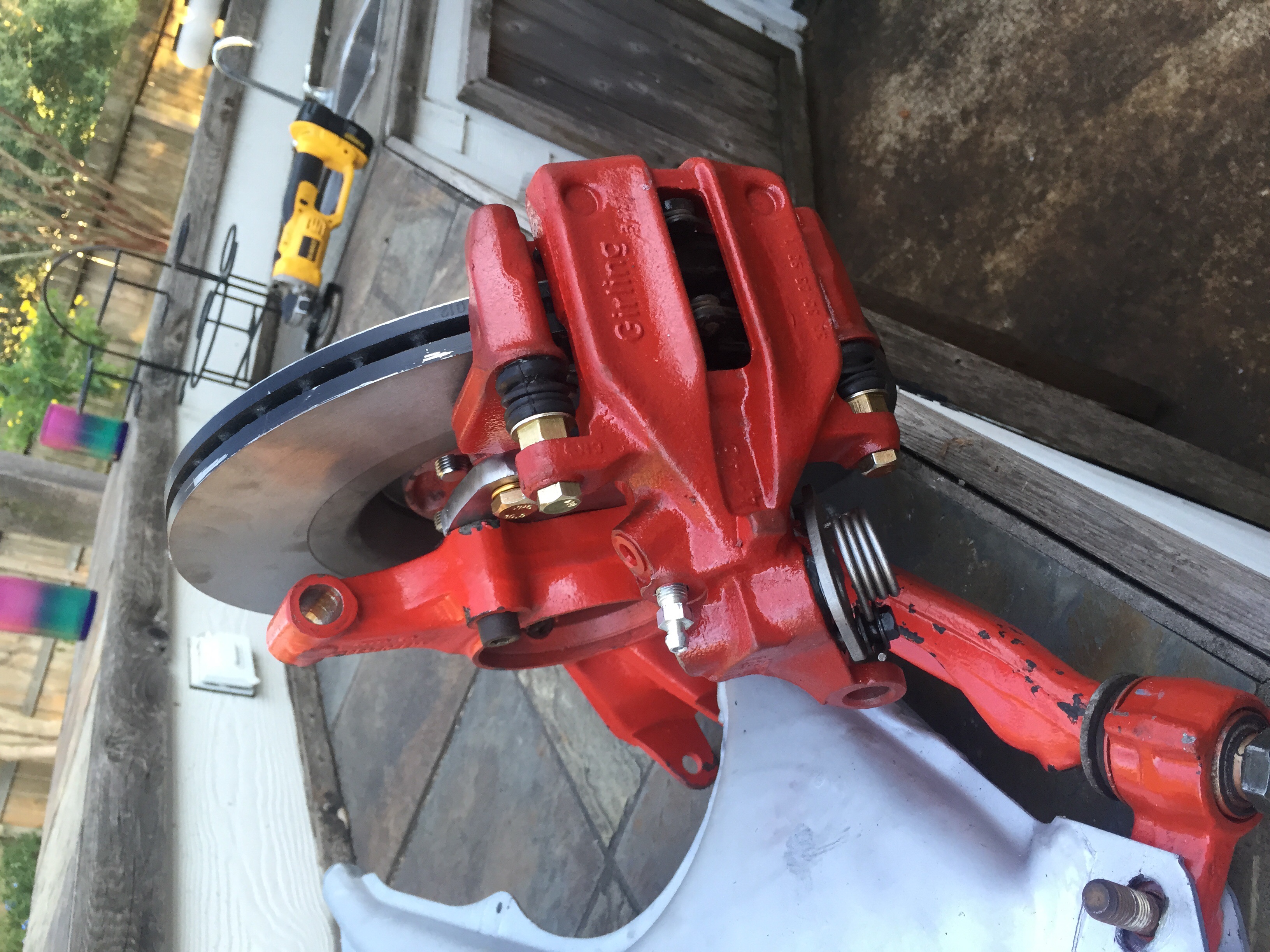

2.5TYPE44 wrote:Here it is... Final product...
C3/C4 caliper, carrier, and pads
2001 S4 330mm x22mm (1mm turned off of each side and now 330x20) I didn't want to buy B5 carriers...
My adapters
2 bolts

Edited it. I don't know why I had the wrong year posted in there. Dumb mistake. I can go back and check my receipt to double check. I wound up using the thicker pads from the V8/200/C4S4. Then I turned the rotors down enough to where they would slide in the throat of the caliper without rubbing which wound up being resulting in turning the rotor 1mm off of each side. And to get into more detail, there are some metal tabs on the subframe that support the e-brake cables for each side... I removed those to give my cables more room to move so they aren't pulling at the calipers at an awkward angle. It might not be necessary for a stock height car but since mine is slammed, I made sure the cables could travel with the movement.

I used the thicker pads for longer wear life and also it keeps the piston closer inside the caliper bore which I believe is easier on the seals and wears less on the piston and bore and may even take less fluid to get the caliper to apply force and maybe affect stopping distance/power/reaction time. Just my opinion.
