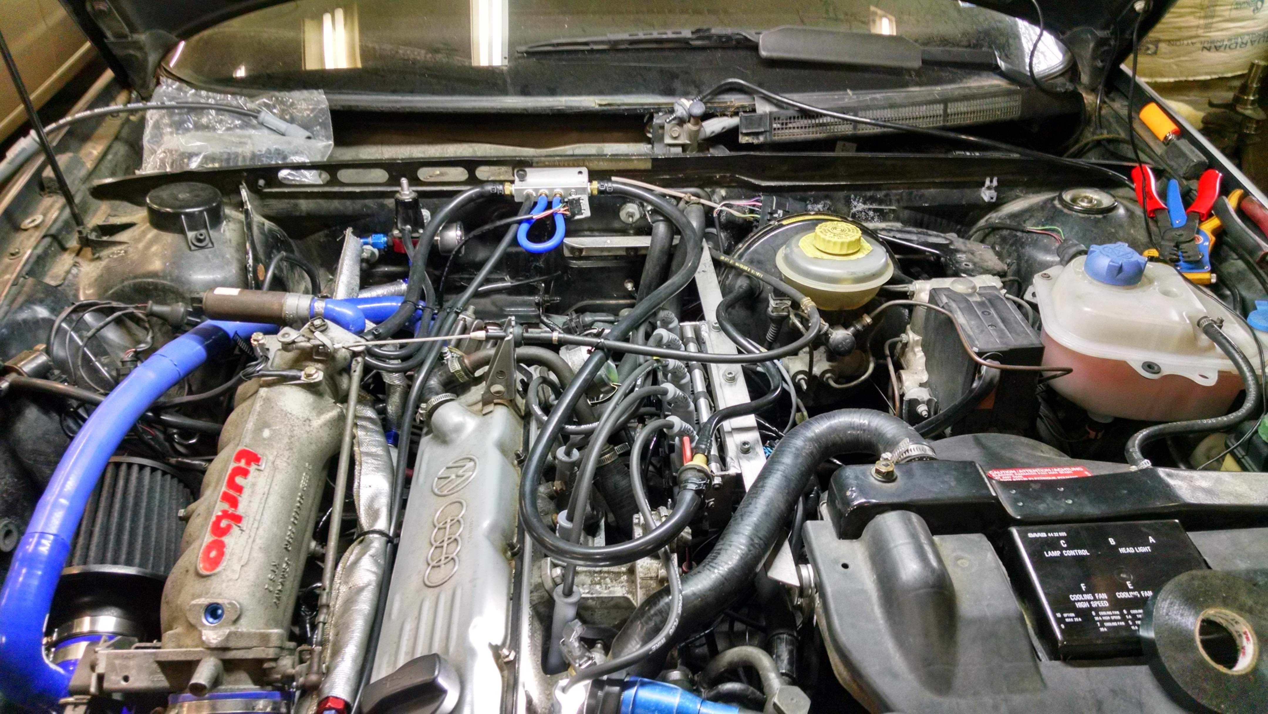

I relayed the headlights on my B3 by using an undergood relay/fuse box from a Saab. I don't remember if it was from a 900 or 9000. The nice part is all the fuse and relay areas were individually wired, so it made it easier to just splice right into them. I then mounted it in front of the radiator with a fiberglass stick to not transfer the heat to it.
- IMG_20160518_102919861_HDR.jpg (1.85 MiB) Viewed 58471 times

-Added fluids! coolant is in, had a leak at the freeze plug turbo fitting, just a loose hose clamp thank god.
-PS fluid is in! I have been waiting to mount the tie rods to the strut towers until I got the engine running and pump turning. Since the rack is rebuilt I did not want to damage any seals by turning the steering wheel with a dry system.
-Brake fluid is in, gravity bled till I got fluid out at all 4 calipers individually. Still need to bleed the clutch and get some more air out of the brake lines.
-Fuel is in! Put about 4 gallons of 91 in. Unfortunately it looks like I am going to have to pull the fuel tank. There is a small amount of gas coming through the floor right above the rear diff. :(
-Put the battery terminals on and then the jump pack on them. I would turn the key on and get dash lights for a couple of seconds and then they would shut off. I am guessing the battery is just completely shot. Took the terminals off the battery and directly to the jump pack. Cranked it a few times and she fired up and then died. Did this a couple times until it stayed running. It does not idle very well, but I was able to run the throttle a little bit and it sounded healthy. I am hoping it just needs ran some to get the idle back. Still need to go though some of the vac lines, but could not really hear any leaks. Must have oil pressure as I went from the full line on the dip stick to the low line. I did dump some oil into the oil cooler lines and into the top of the turbo.
-My jump pack did get a little warm after I ran it a few minutes to the point where the jump pack gave a temp light. A buddy suggested the voltage regulator might be bad. So I will change that out and hopefully can get a meter on the car the next time I go to start it. That is if I can get it to stay idling.
-There is one wire I can not figure out where it goes. It is sitting just under the coolant neck here. It is brown with a green stripe. Here is a pic, this is the newer style MC coolant neck and I am not using any of these sensors on it as of yet. The WX neck has no sensors in it.
I am not too worried about the crappy idle yet. I still need to tune the car up. What spark plugs do you guys suggest? I have new plug wires, just need the plugs, cap and rotor.
That is it for now. Hopefully I will have time to mess with it at the end of the week.
-Removed oil cooler and IC with hoses after test fit to clean up my cuts, also resprayed the front tow hooks and the bottom 1" lip of the front sheet metal as it was chipped to hell. Turned out pretty good, got a color matched rattle can. Wasn't cheap, but the color match seems pretty good. I would't use it on the body anywhere though.
-While the paint was drying I cleaned up the caliper carriers and then installed the brakes. I will be going to the 225hp TT calipers at some point so I did not paint the front brakes.
-Once paint dried I was able to reinstall the oil cooler lines, IC, etc.
-Then hung the a-arms and sway bar. Tried to use new later style center sway bar bushings but they just do not fit right. Had some beat older style ones laying around so I tossed them in for now.
-Tied in some vac lines, does the small vac nipple off the wast gate not go anywhere?
- Also tied in the vac line for the brake booster to the back of the multi port fittings off the back of the intake manifold.
-Still need to tie in the vac lines for cruise. The line going to the cruise module T to the pedal is split at the pedal and hard as a rock at the T.

Only thing i can add is that I believe the nipple off the WG is just left open to atmosphere. I could be wrong but that's what I've seen over the years. If someone has intel on the design function that would be stellar.

Got the fuel tank out, pretty easy actually.
The good news is I found the leak. The bad news is there are 3 pin holes in the bottom of the tank and looking inside is not pretty. Lots of surface rust. Hopefully I can find some one still open locally that can fix and re coat the inside.

At this point I have taken the fuel tank back to the shop a total of 3 times to get fixed. None of the shops I was able to find in my area would cut out and replace the bottom. They hot tank it, patch the bad spots and paint it. The last time they coated the entire outside bottom of the tank. So hopefully no more leaks.
Fuse 7 has a dead short to ground. Its the cig lighter and interior light circuit.... It was so bad my jump pack wouldn't even power up when hooked to the battery cables. Any ideas of common bad spots for the circuit? I already have the complete dash out and insulation gutted.
I started to lay out the complete 4kq harness.... I may just keep the old style fuse box and splice in the interior connectors I need for the dash swap. I am completely missing the turn signal relay that sits behind the gauge cluster. It is a 3 pin relay, the later style harness uses a 5 or 6 pin... Anyone have a relay part #?
My biggest issue for wiring is both of my bentleys only go back to 84, so nothing for my early car. Anyone have an early Bently laying around they want to trade or sell?
For the 500w 200 fan I have narrowed it down to these 2 options to run it.
https://www.intellitronix.com/product-p ... controller
-and-
https://shop.speedunlimited.com/p-12009 ... adjustable
I am leaning towards the Intellitronix, although if my math is correct the 500w fan will pull 41 amps. That is just over the rated 40a of the N4001.
Thats it for now. I will try to get some pics up when I get some better progress.
-and-

Good timing. I found a new hazard/turn relay that I tossed in a week ago. PN is 1H0953227. This is the 3 pin that should work!
