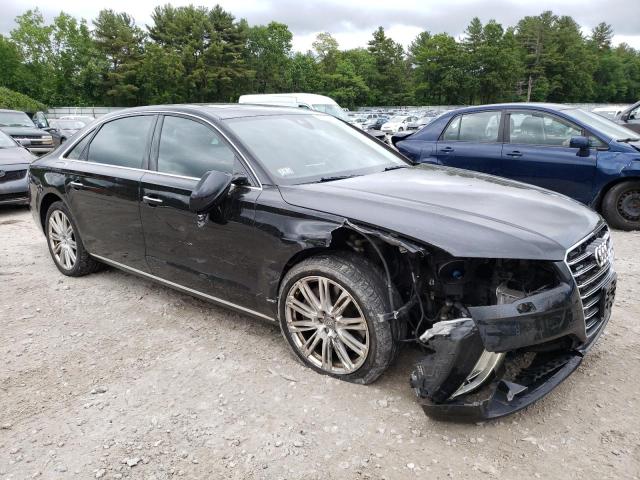

I tripped, fell, and decided a 4.0t was a better plan. Shorter better packaging and more efficient

themagellan wrote:What year 4.0t did you grab it from (does it matter all that much?) curious on the dimensions, that is going to be a wild package in a CQ!! Hope to see some build pics.
2015 A8 from copart. wreck didn't even break the cooling system.
donor 2015 a8
donor 2015 a8
