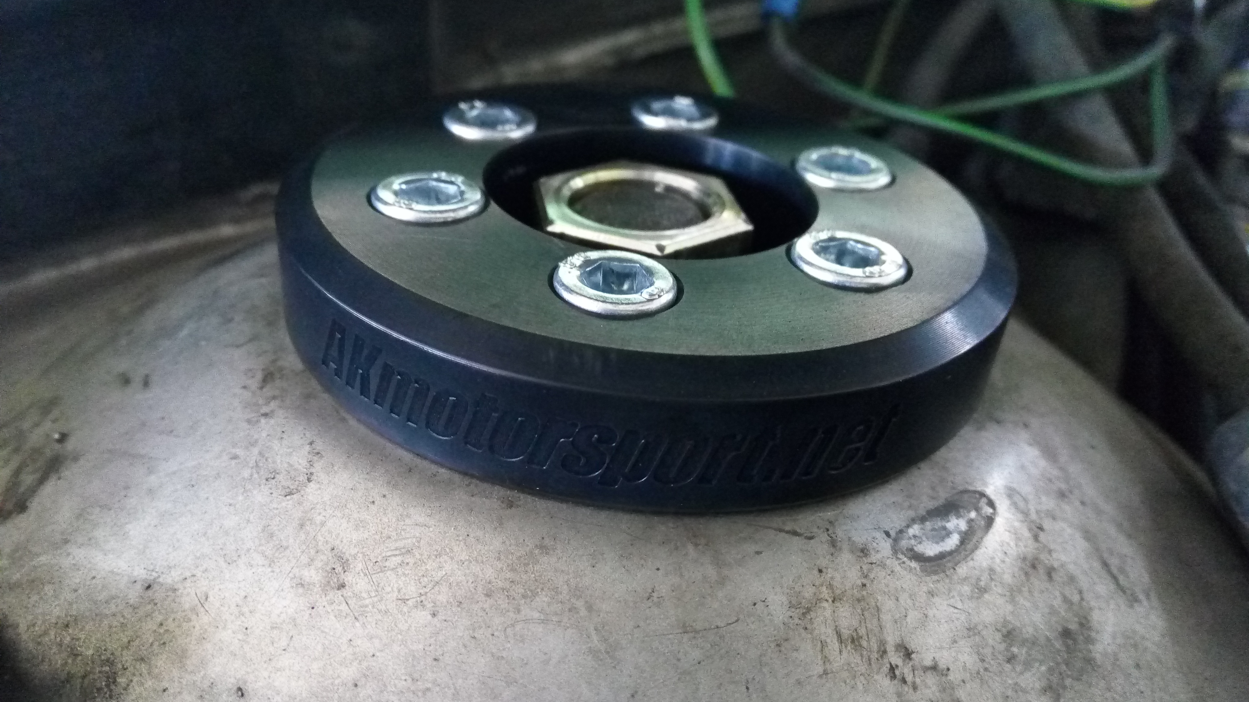

- Posts: 875
- Location: Bangkok, Thailand
Re: B4Q 80-AEB; Forged control arms, PU bushings

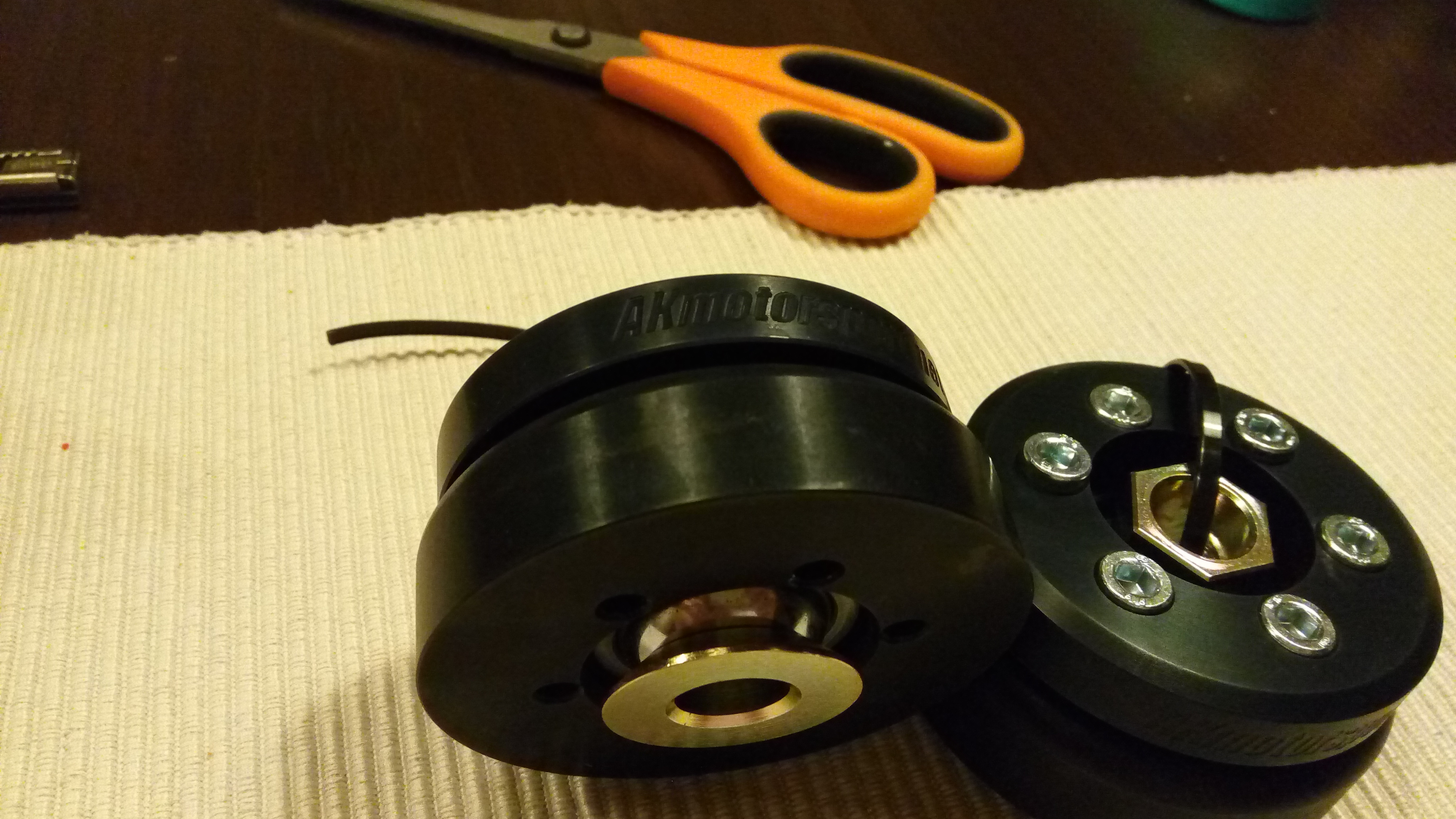

So, finally the solid strut mounts are in! These pieces are real good quality. Easy to install. Noise level is so close to stock that there is little difference, but you do get better road surface feel.
https://www.akmotorsport.net/shop/all-p ... top-mount/
But... I still have shaking in the steering wheel. Not vibration. Next step is to check the front tires balance, alignment (again

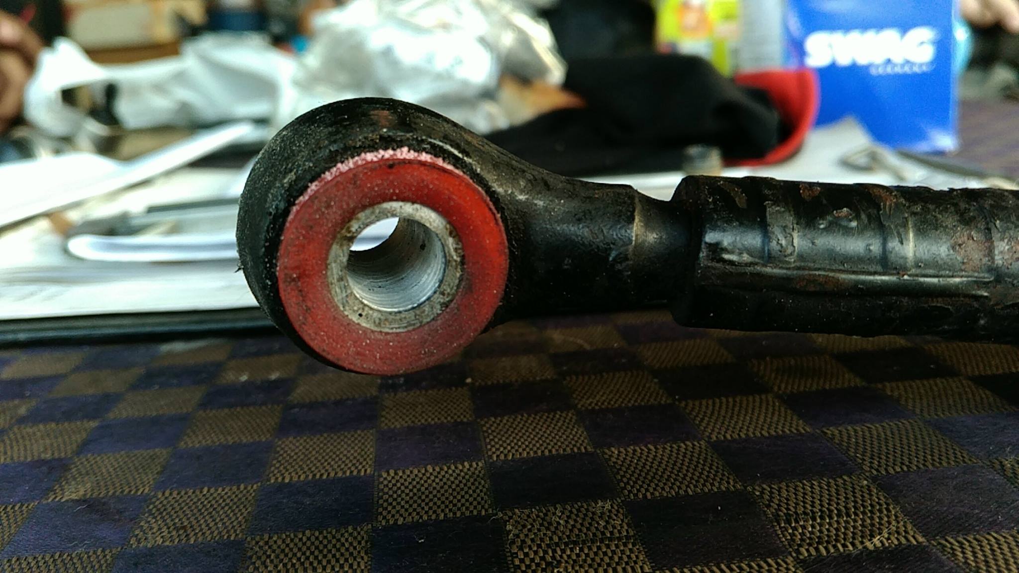

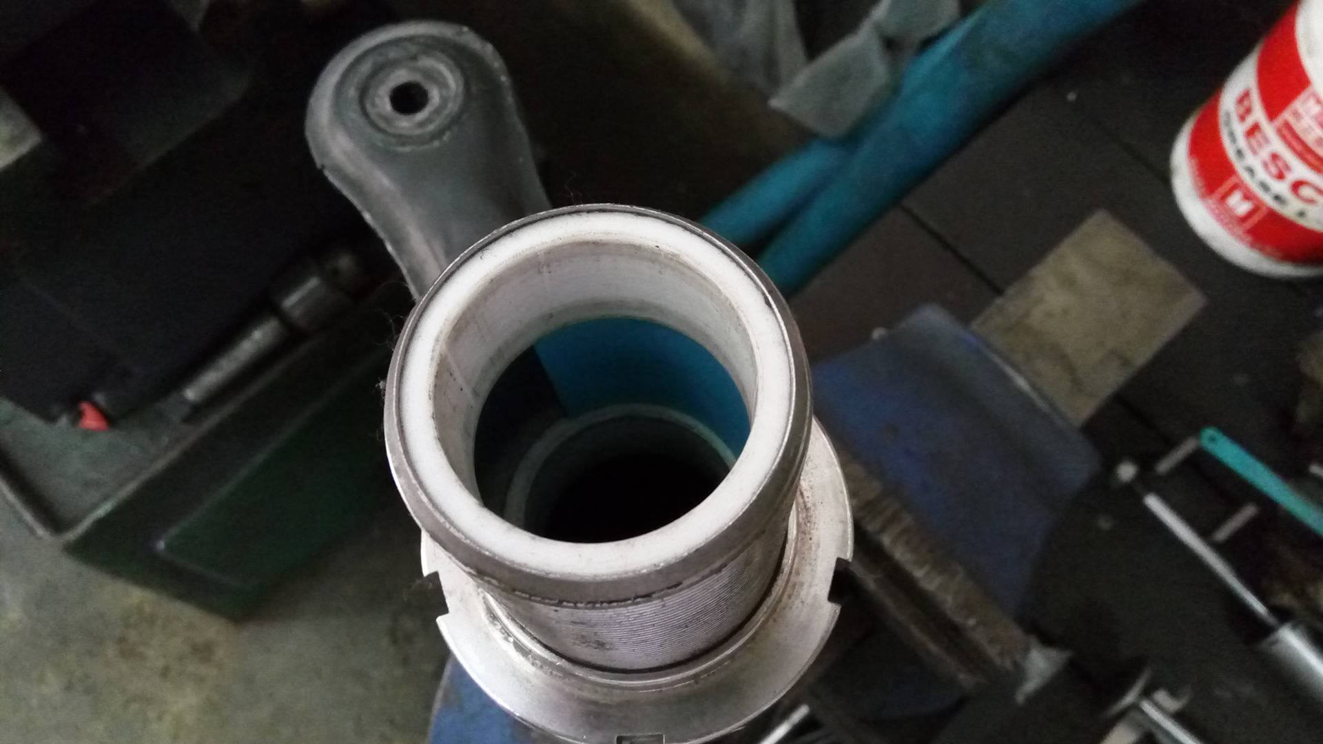

- Posts: 875
Re: B4Q 80-AEB; Solid, ball joint strut mounts in!
Small update:
Found out what was causing the shaking. It was on the list of to solve, but forgot it. It was the inner tie rod arm bushings. The ones that bolt to the rack.
Got the old bushings taken out and replaced with custom made PU ones. No more shaking! Yay.

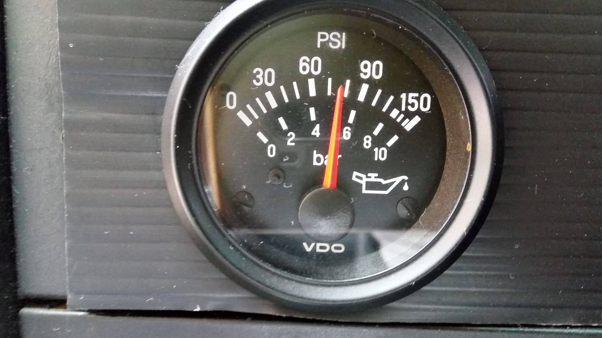

- Posts: 875

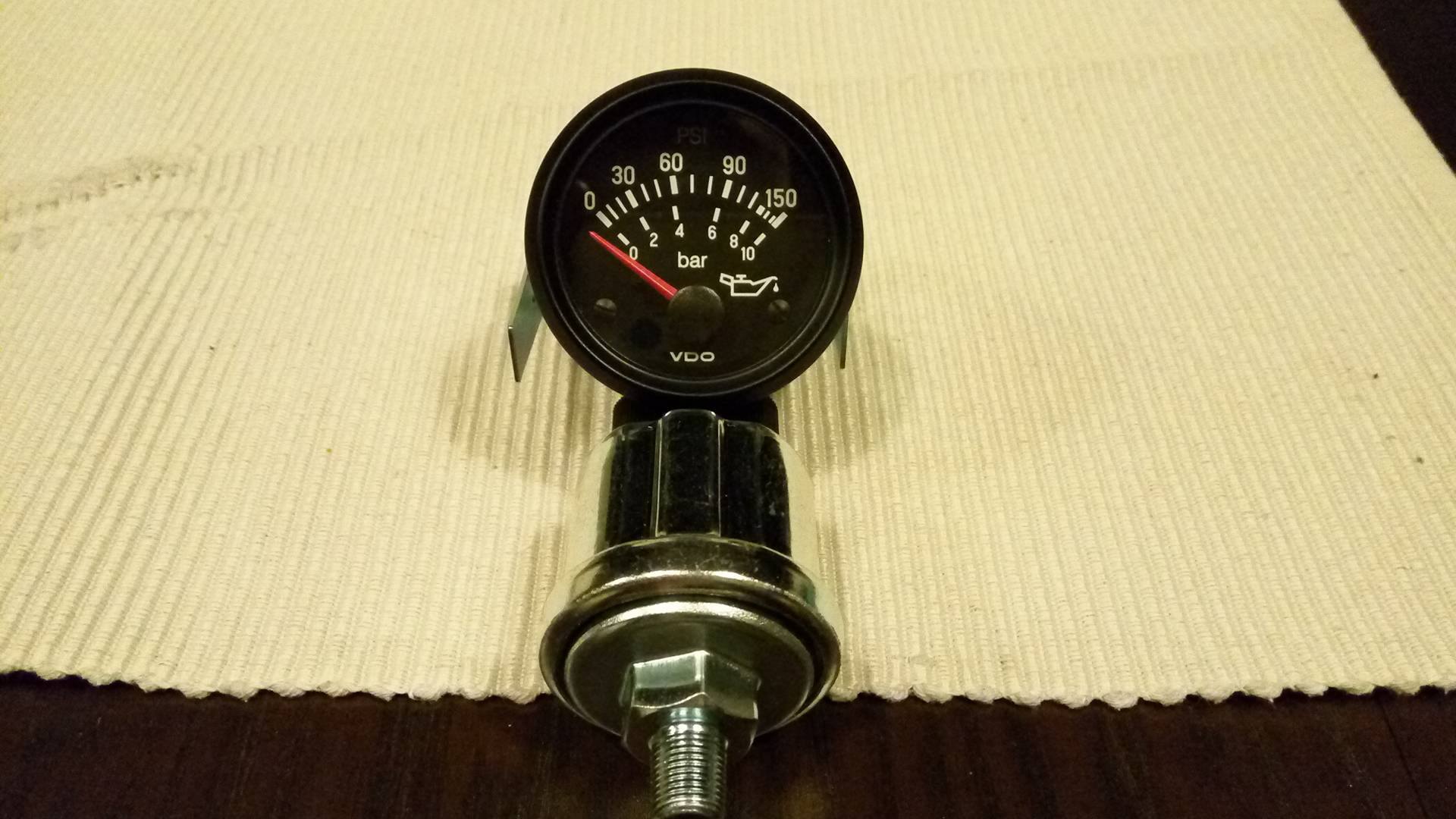

Oil pressure gauge is in and working. This is with cold engine @ 2000 rpm. Seems OK.
- oil pressure gauge working.jpg (155.63 KiB) Viewed 61125 times
Question for you- what do you see for a HOT oil pressure? My 1.8t gets about the same as yours cold, once the coolant is up to temp it's right about 20psi @idle but it gets a lot lower than that after it runs at operating temp for a while. Still doesn't throw the oil pressure light, but curious what you're seeing since you're in a hot climate.ChrisAudi80 wrote:Oil pressure gauge is in and working. This is with cold engine @ 2000 rpm. Seems OK.
- Posts: 875
I see about 15-20psi hot idle and anything above 2000rpm, about 50psi.vt10vt wrote:Question for you- what do you see for a HOT oil pressure? My 1.8t gets about the same as yours cold, once the coolant is up to temp it's right about 20psi @idle but it gets a lot lower than that after it runs at operating temp for a while. Still doesn't throw the oil pressure light, but curious what you're seeing since you're in a hot climate.ChrisAudi80 wrote:Oil pressure gauge is in and working. This is with cold engine @ 2000 rpm. Seems OK.
I use 5w40 diesel oil.

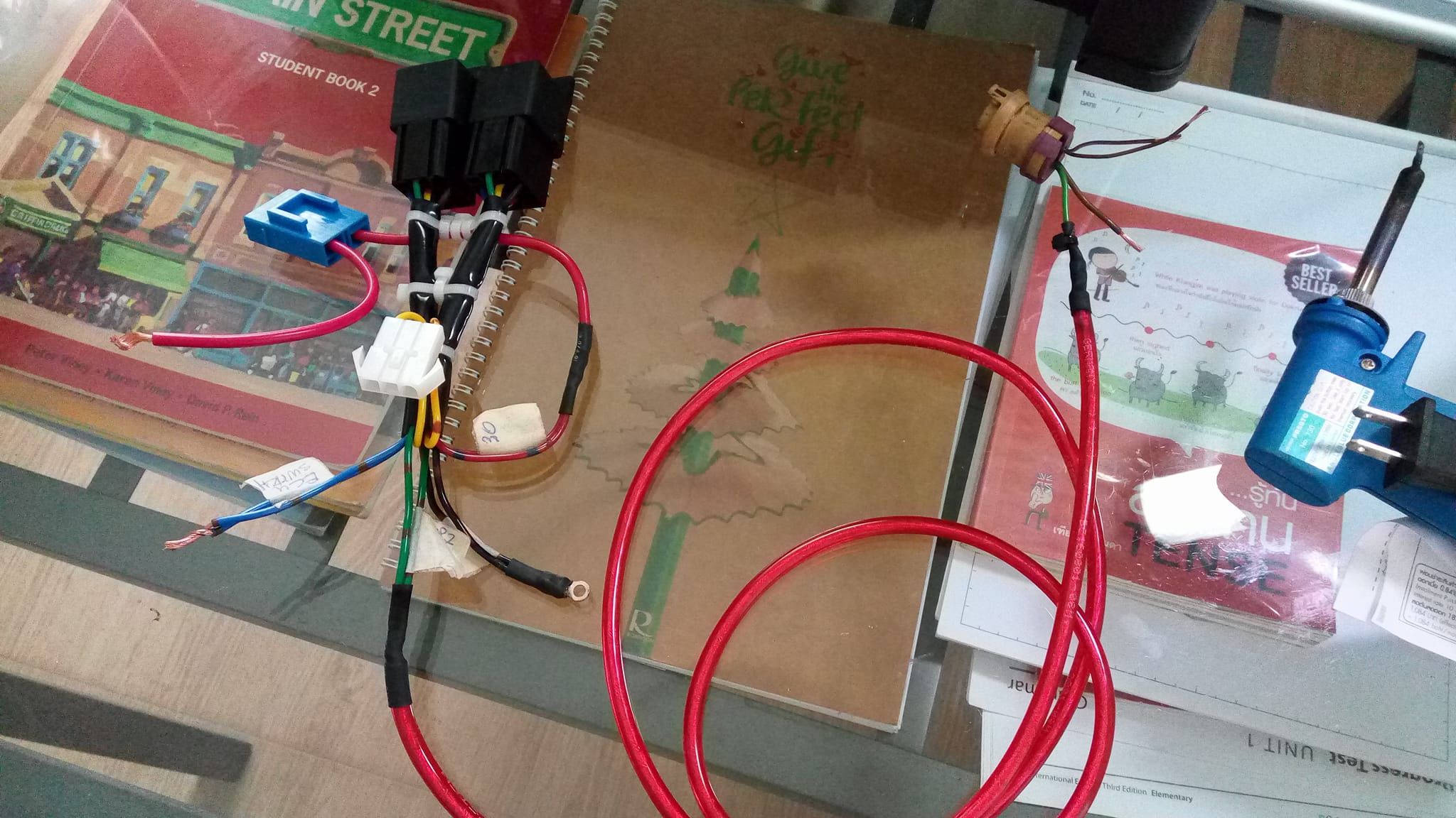

Re: B4Q 80-AEB; Fuel Pump relayed! Finally...

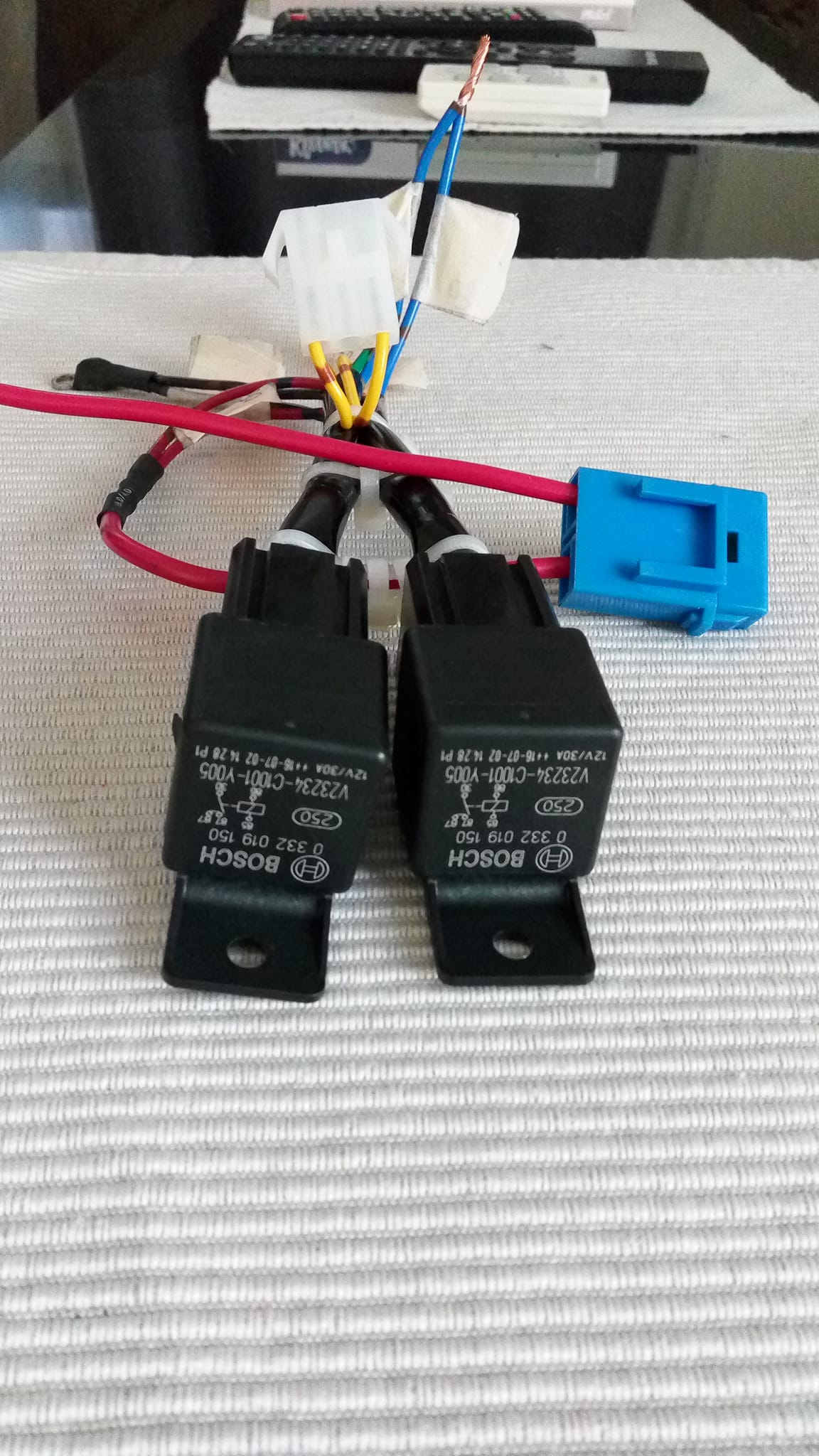

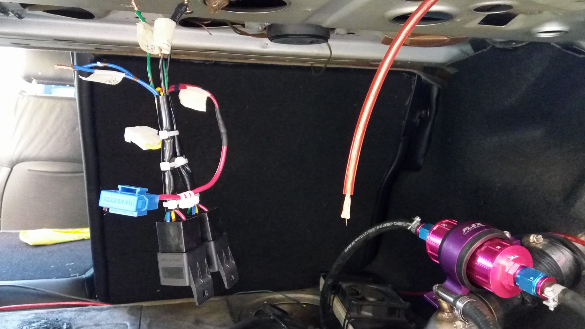

Small update again:
My fuel pump fuse was melting for whatever reason, probably due to corrosion/bad contact, so it was high time to do something about it. Fire waiting to happen.
Finally managed to relay the fuel pump. Because I'm a tard, it took me several days to figure out how to wire it correctly, even after reading loads and asking questions on various FB groups. Marc S. and a guy called Valdas pointed me in the right direction.
I should have looked at the stock wiring diagram again. VAG FPR 208 relay circuit powers injectors and fuel pump.
Long story short: Swapped FPR signal out from VEMS EC36-15 (P259 channel) to EC36-9 (Inj channel) and split the signal to the stock system and relays in trunk.
Anyway, it works now. The pump whine is much higher pitched and I see much less voltage drop in VEMS.
Will do some logging today and will probably have to retune fuel. Again

Now because of disconnecting and reconnecting many times, one of the wires for the RS232 connectors came loose. Fixed that.
So, not really been able to retune yet because of dropped coms.
Some pictures of ghetto ass wiring. The white 3 pin connector is for auxiliary 12v for something else, like fans on a big fuel cooler.
- Relay wiring1.jpg (274.73 KiB) Viewed 59648 times
- Relays wiring 2.jpg (202.9 KiB) Viewed 59648 times
- Relays wiring 3.jpg (290.46 KiB) Viewed 59648 times

What did those poly bushings for the inner tie rod come from? Want to replace mine but it doesn't look like anyone makes any.
