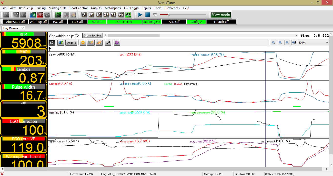

When you're working on these kinds of issues, put boost DC and boost target in your graph so you can see what they are doing. See attached. Also, PID boost control will really help keep the boost up in the higher RPM when you get this sorted out a bit more.

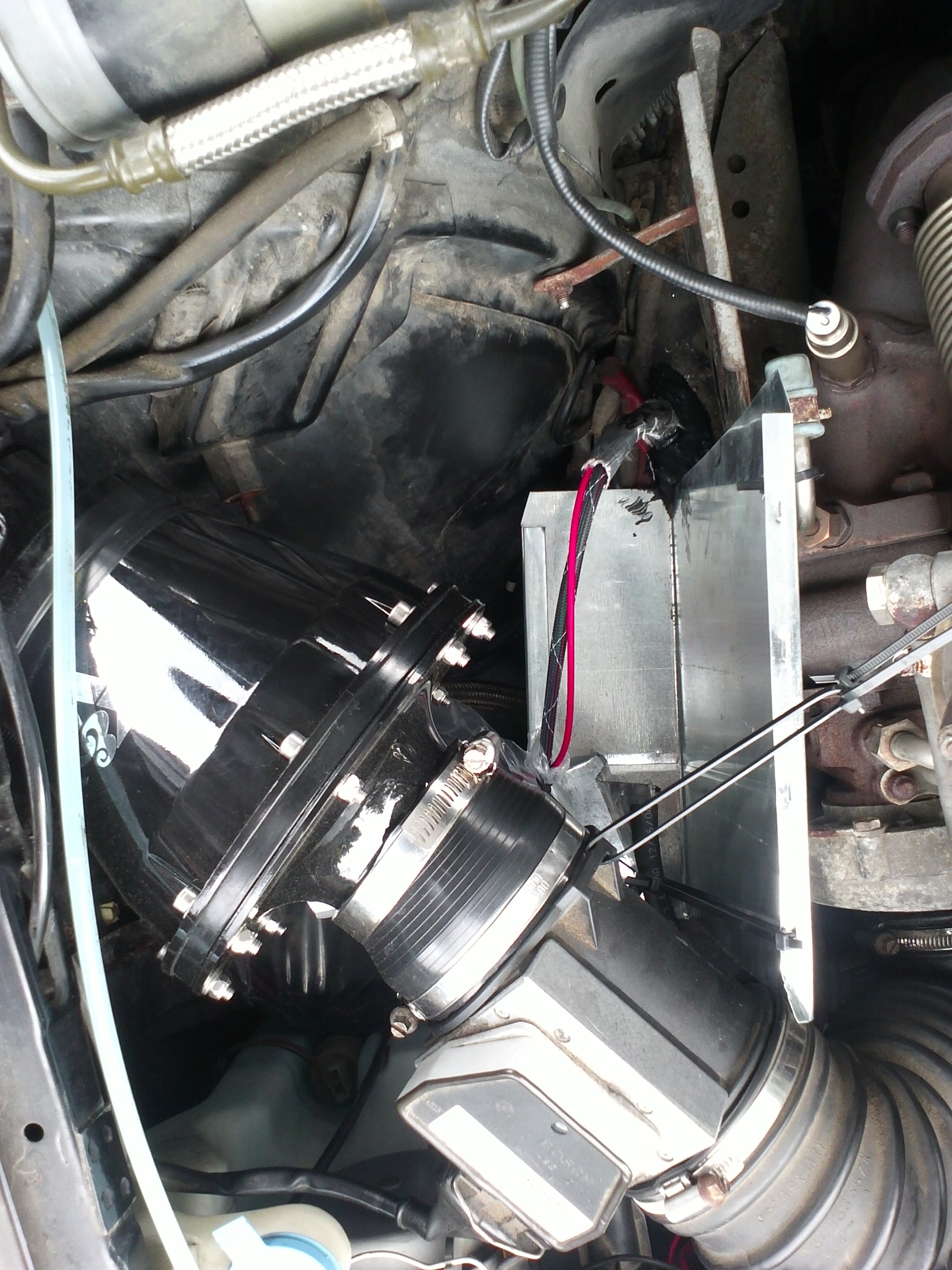

Here's the filter in question, its about 3/4" smaller diameter than stock turbo inlet hose. Its HP restricting on turbo cars somewhere below 400. If anyone else out there has VEMS tuned for the k24 please let me know! I since removed the crappy heat shield I made so that's not rattling. I really need help on my ignition table too. Thanks all
- IMG_20140719_115128.jpg (1.22 MiB) Viewed 45818 times
Easiest way to find out of its being a restriction is to just take it off! You wont hurt anything doing that. As ricer as it looks, I dont really believe it is restricting anything.
