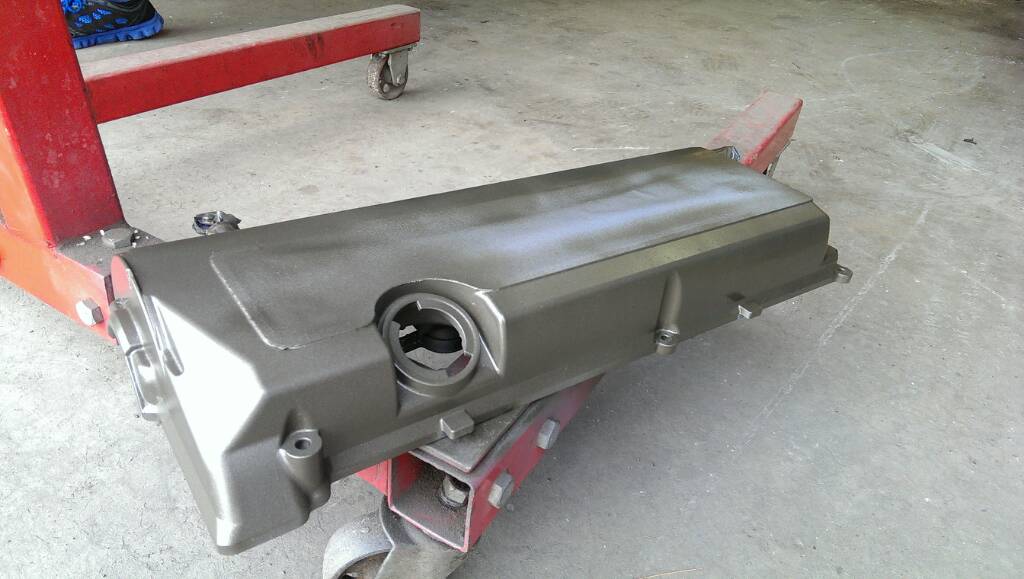

Just shot the 1st layer of paint.... I'm not 100% on the color after it's been sprayed on the block.... It's more bronze than dark metallic gray...
Do my eye's deceive me?
Re: A tale of Rubí...PTE5862 .64 a/r Experiment aka Simple B
Looks good. I don't see any bronze
Thanks.... then it's just my eyes and the florescent lighting playing tricks on me...
I'll shoot 2-3 more coats and save the rest for perhaps some other smaller under-hood items...

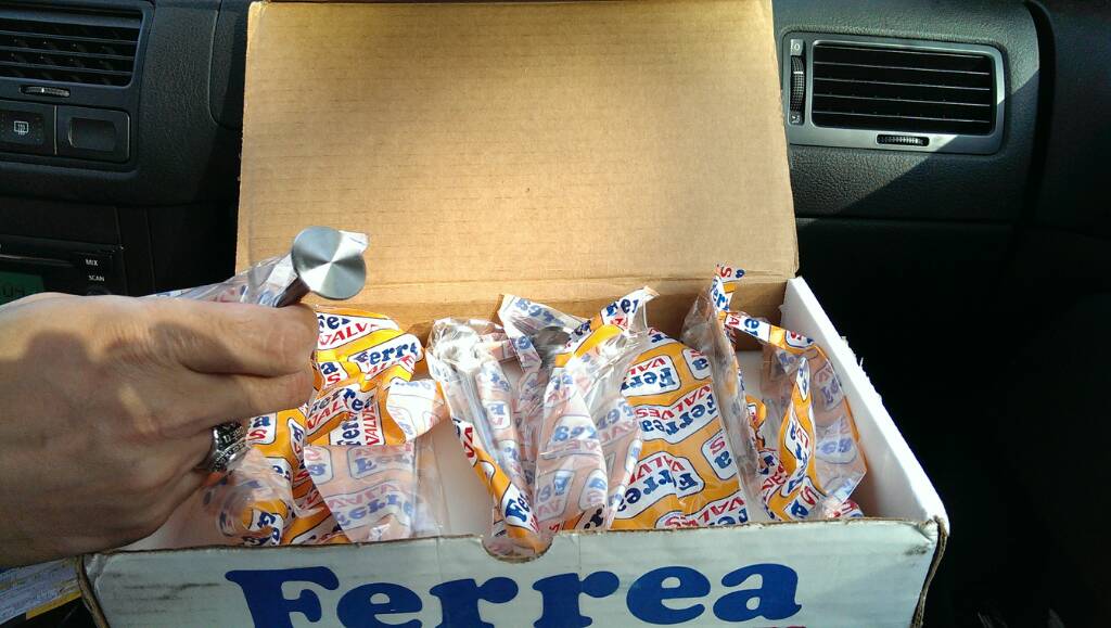

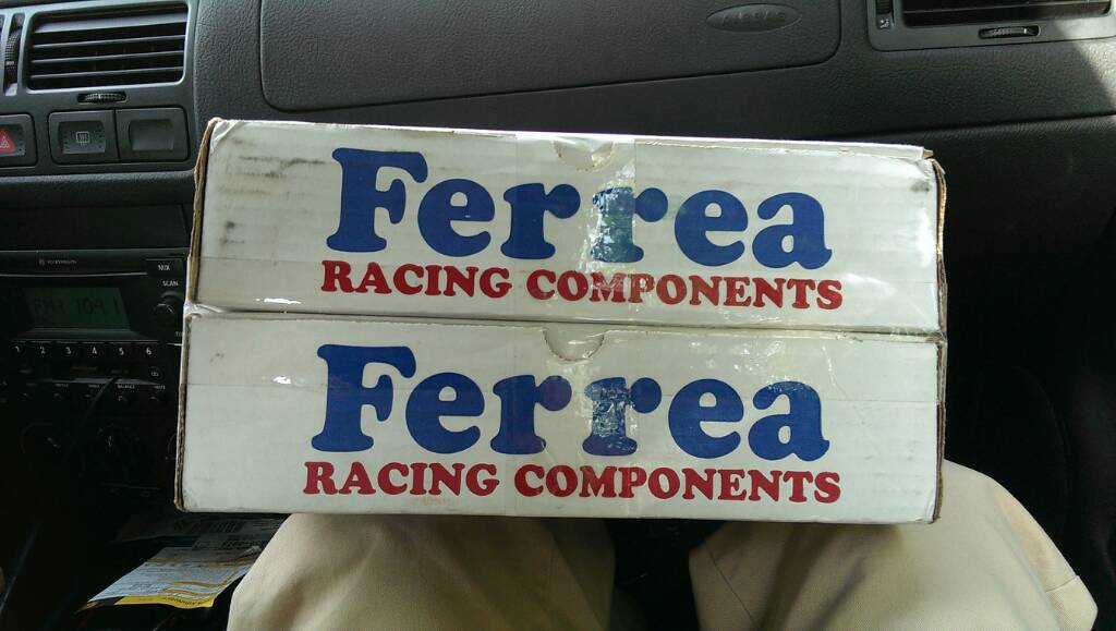

Ok... Let me put this behind us once and for all... I got a full +.5mm oversized intake and exhaust set for $300 shipped...
How ya doing now?

And just a little check up on the upgraded PTE
Shipped as promised... Cool!
Package in hand

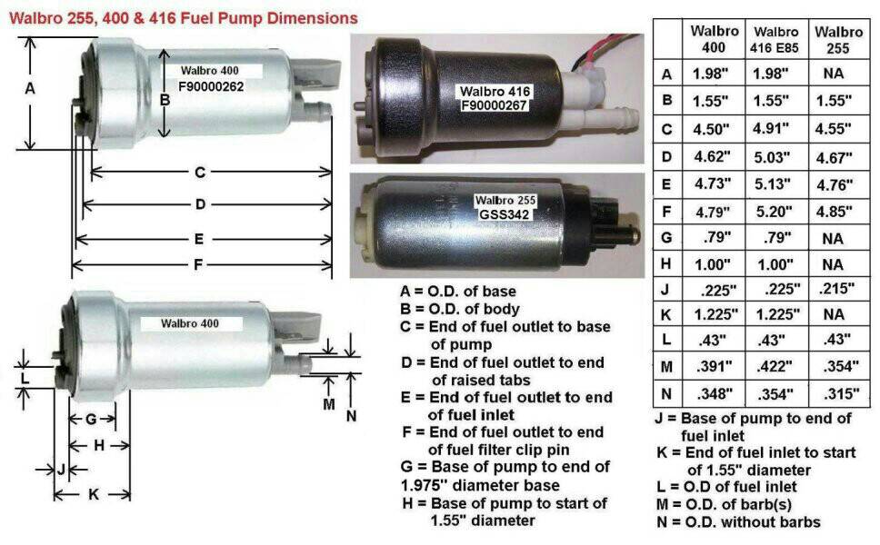

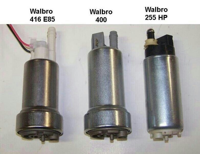

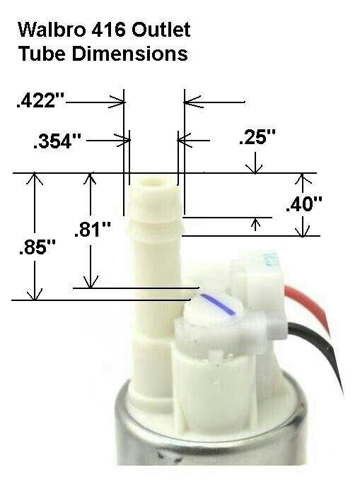

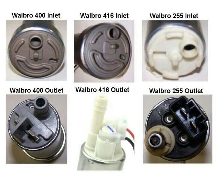

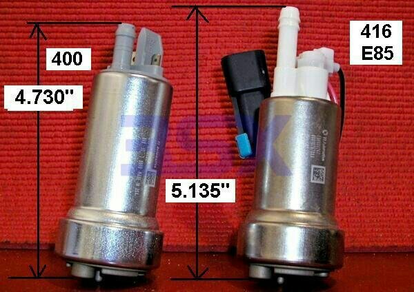

Thinking of running the new line of Walbro (Part #F90000267) as I'm running a stock pump at above rs2 levels...
Seems like there is a packaging constraint I may encounter...
Quoted from Walbro:
"Due to the specifications of this fuel pump, please take note of the following:
The larger diameter at the base of the fuel pump will prevent this from being an OEM drop-in replacement on most applications. Modifications to the mounting bracket, wiring, and connector may be required for proper fitment. We recommend 14 AWG wiring to account for the current draw this pump has.
Technical Pump Specifications:
Overall pump length: 121mm
Main Housing Diameter: 39mm
Lower Housing Diameter: 50mm
Fuel Inlet Diameter: 11mm OD
Fuel Outlet Diameter: 11mm OD
Flow rate: 400LPH @ 40PSI
Test Voltage: 13.5 Volts"
The stock pump is about 43mm, so the top part of this pump should slide right in. The base, however, is where I can't remember if there was enough room down there from when I did an 044 in my previous car.

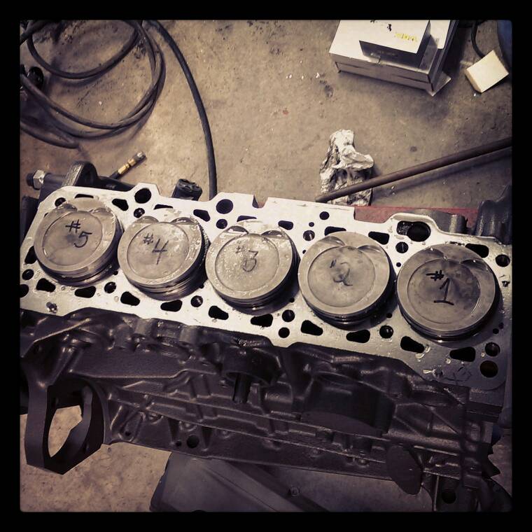

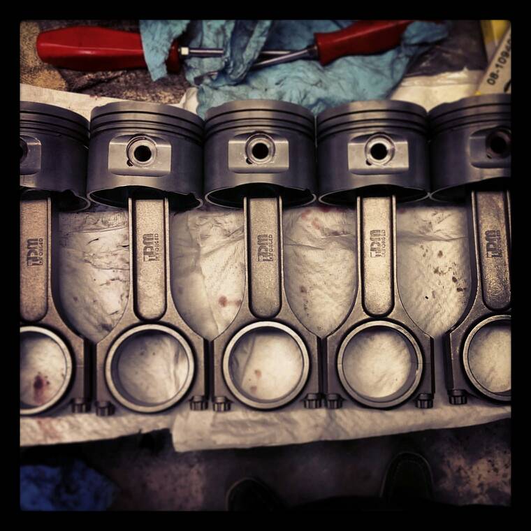

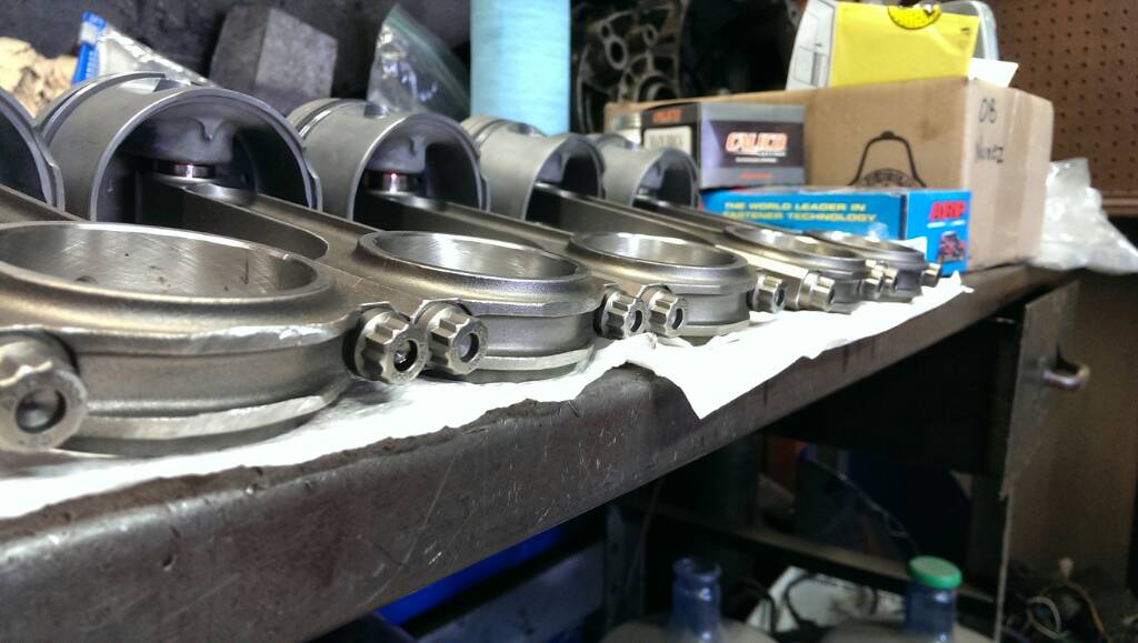

Anyhow, some assembly got done today on the block... I wanna emphasize on "some" because it would've been done had the oil squirters had been picked up with the block... I had sort of rushed in and out when I picked it up...
Oh well here are some pics
DM Forged Assembled
DM Forged Assembled
Pistons Resting on Block

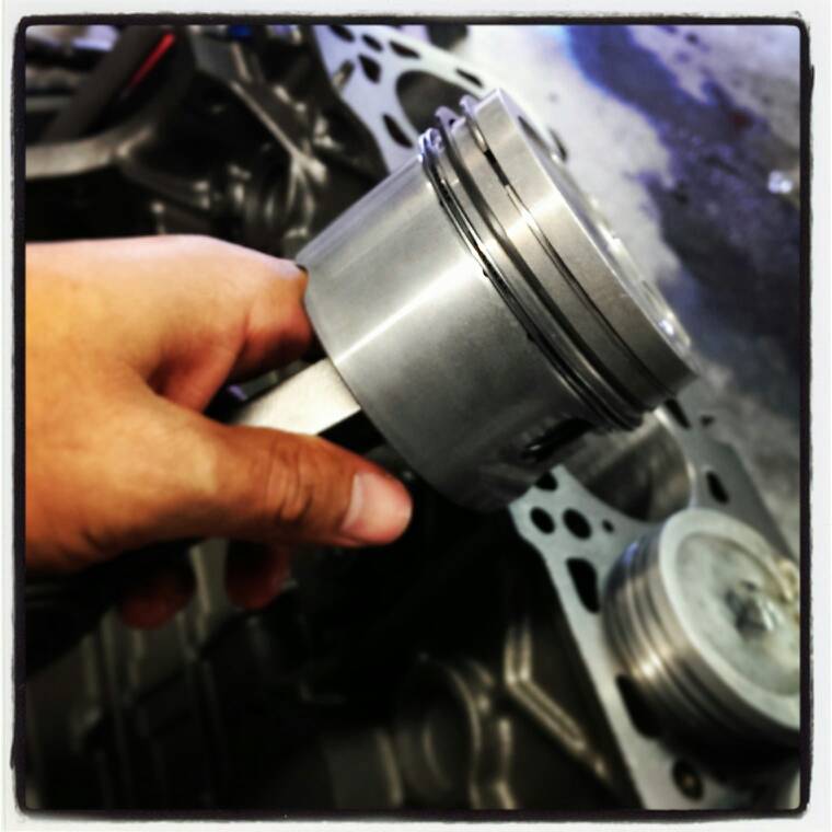

With Rings ON
With Rings ON
Some balance correction marks on the rods...
BigEnd Corrections
BigEnd Corrections
