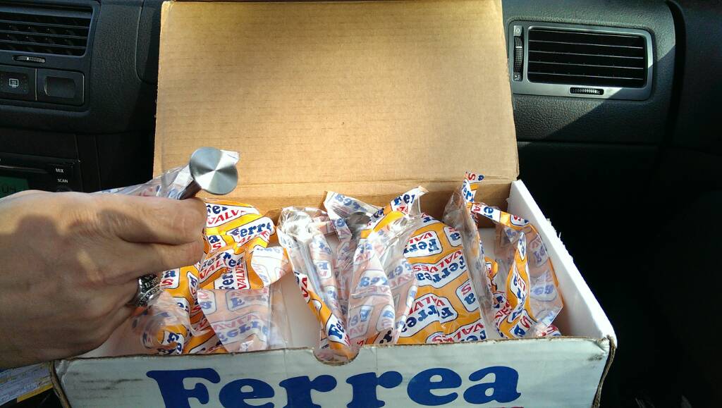

Package in hand
Re: A tale of Rubí...PTE5862 .64 a/r Experiment aka Simple B
Posted: Fri May 10, 2013 4:14 pm
by mushasho
Like a box of chocolates... Mmmmmm

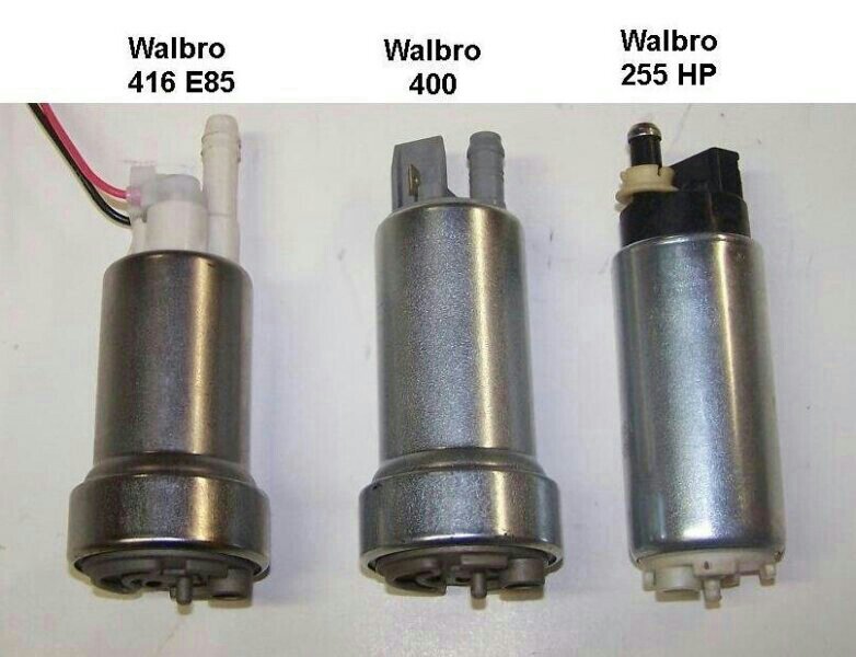

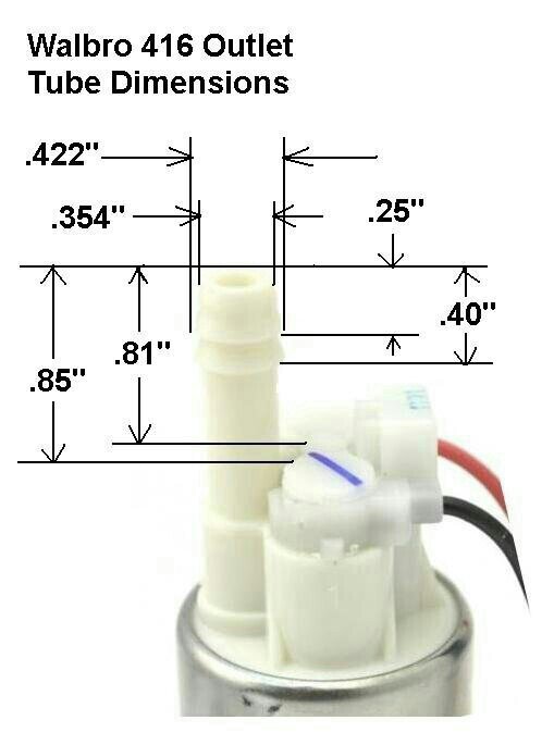

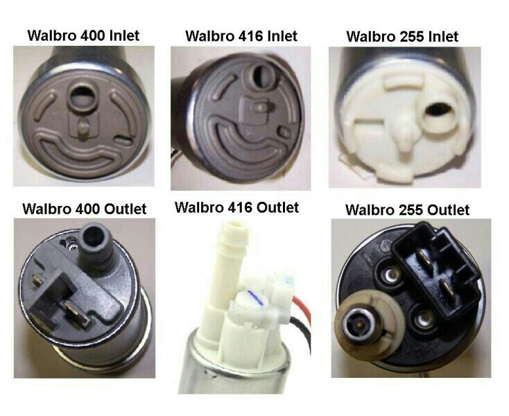

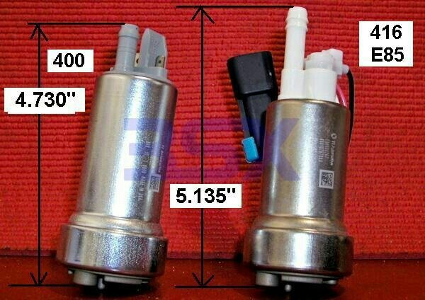

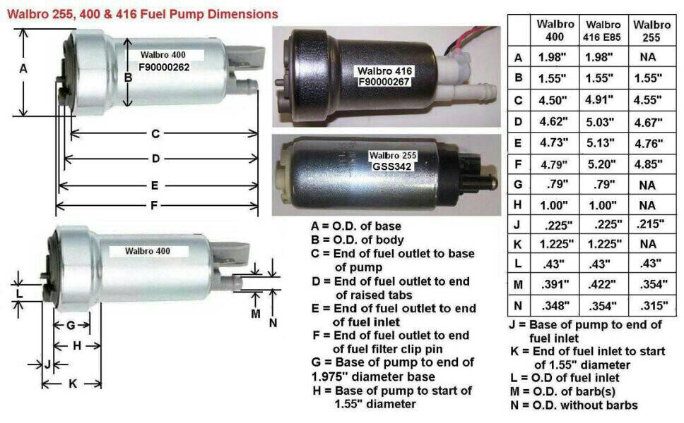

Thinking of running the new line of Walbro (Part #F90000267) as I'm running a stock pump at above rs2 levels...
Seems like there is a packaging constraint I may encounter...
Quoted from Walbro:
"Due to the specifications of this fuel pump, please take note of the following:
The larger diameter at the base of the fuel pump will prevent this from being an OEM drop-in replacement on most applications. Modifications to the mounting bracket, wiring, and connector may be required for proper fitment. We recommend 14 AWG wiring to account for the current draw this pump has.
Technical Pump Specifications:
Overall pump length: 121mm
Main Housing Diameter: 39mm
Lower Housing Diameter: 50mm
Fuel Inlet Diameter: 11mm OD
Fuel Outlet Diameter: 11mm OD
Flow rate: 400LPH @ 40PSI
Test Voltage: 13.5 Volts"
The stock pump is about 43mm, so the top part of this pump should slide right in. The base, however, is where I can't remember if there was enough room down there from when I did an 044 in my previous car.

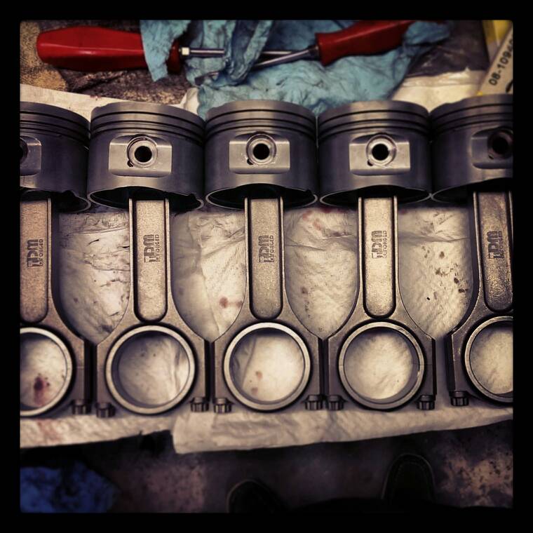

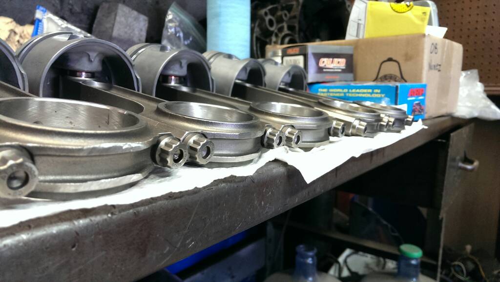

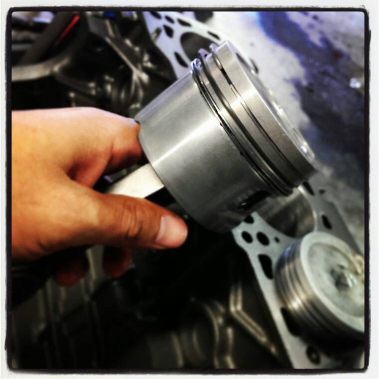

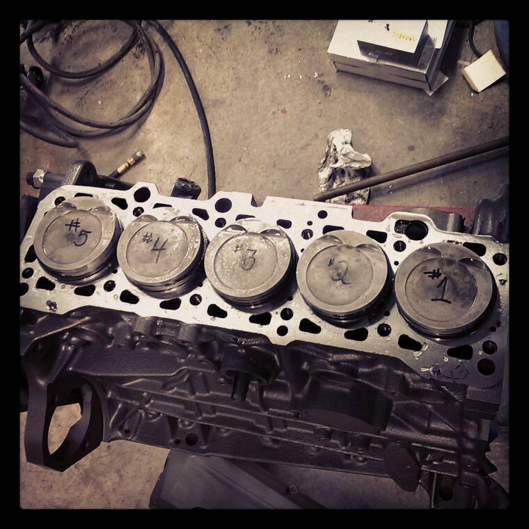

Anyhow, some assembly got done today on the block... I wanna emphasize on "some" because it would've been done had the oil squirters had been picked up with the block... I had sort of rushed in and out when I picked it up...
Oh well here are some pics
DM Forged Assembled
DM Forged Assembled
Pistons Resting on Block
With Rings ON
With Rings ON
Some balance correction marks on the rods...
BigEnd Corrections
BigEnd Corrections
