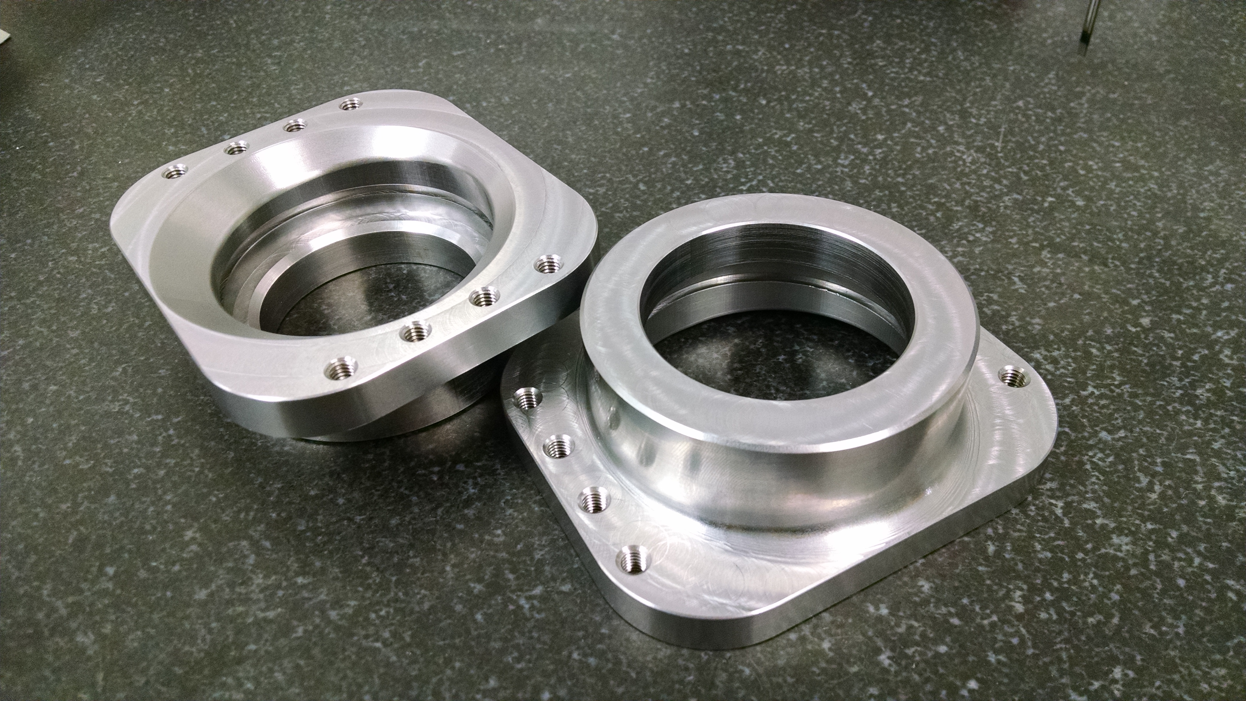

Prototype slider pieces are done.

Thanks Kevin. I just want to make sure the tolerances are right on them, but then it'll be testing time. I'm just a little concerned about having some kind of rattle with the way the snap rings are set up.
Posted: Wed Oct 19, 2016 12:06 pm
The latest update has the parts almost finished. Just a few little details to fix now.

These are beautiful - What is the cost?
Posted: Thu Oct 20, 2016 7:36 pm
That depends on the interest I'm able to stir up. I will give the rundown after testing is complete and Urs fitment verified. Also, I have to be sure the manufacturer is willing to make more.

Posted: Mon Oct 31, 2016 9:32 pm
Two have been made so far (one set). I'm just waiting on them to get zinc chromate coated, then they can be installed and tested.

Yes, the first set is actually done with machining, but they need to be electro-plated and then one small piece needs machined. They need to be tested though, and the cost is pretty high, even if we get 10 sets made.
If you know someone who can zinc plate the first set for testing, it'd really get things moving along! That's really the only hold-up right now. But you wouldn't believe how hard it is to find a plater. The next sets will be made with somethign that doesn't need plating!

Loxx is pretty busy these days. I've taken over the project temporarily and will be field testing the prototypes very soon on the T44 and D11 platforms. I'll be test fitting with Koni Sport (86 2149), Koni Race (8610-1437), and Bilstein Sport (34-003695) struts. The strut mounts are currently out being zinc plated, and I'm awaiting a few small sleeves to be machined by my friend.
Sorry for the wait, but they haven't been forgotten! Will update soon, hopefully
