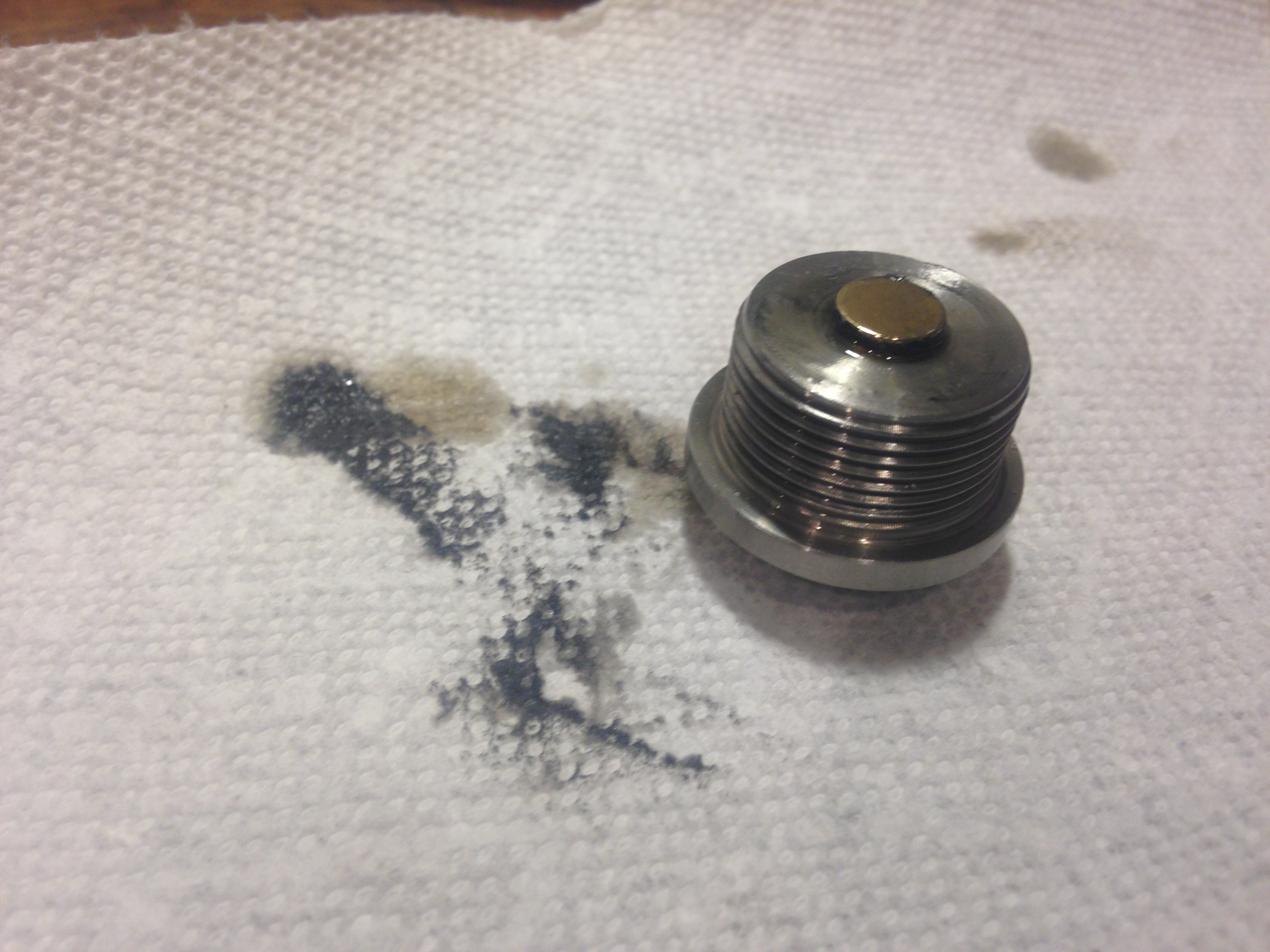

so after multiple coolant leaks to repair the car is finally running good, tuning will be next on that front. I did a oil change, its been probably 20min of run time, here is the magnetic drain plug. im glad i got it...

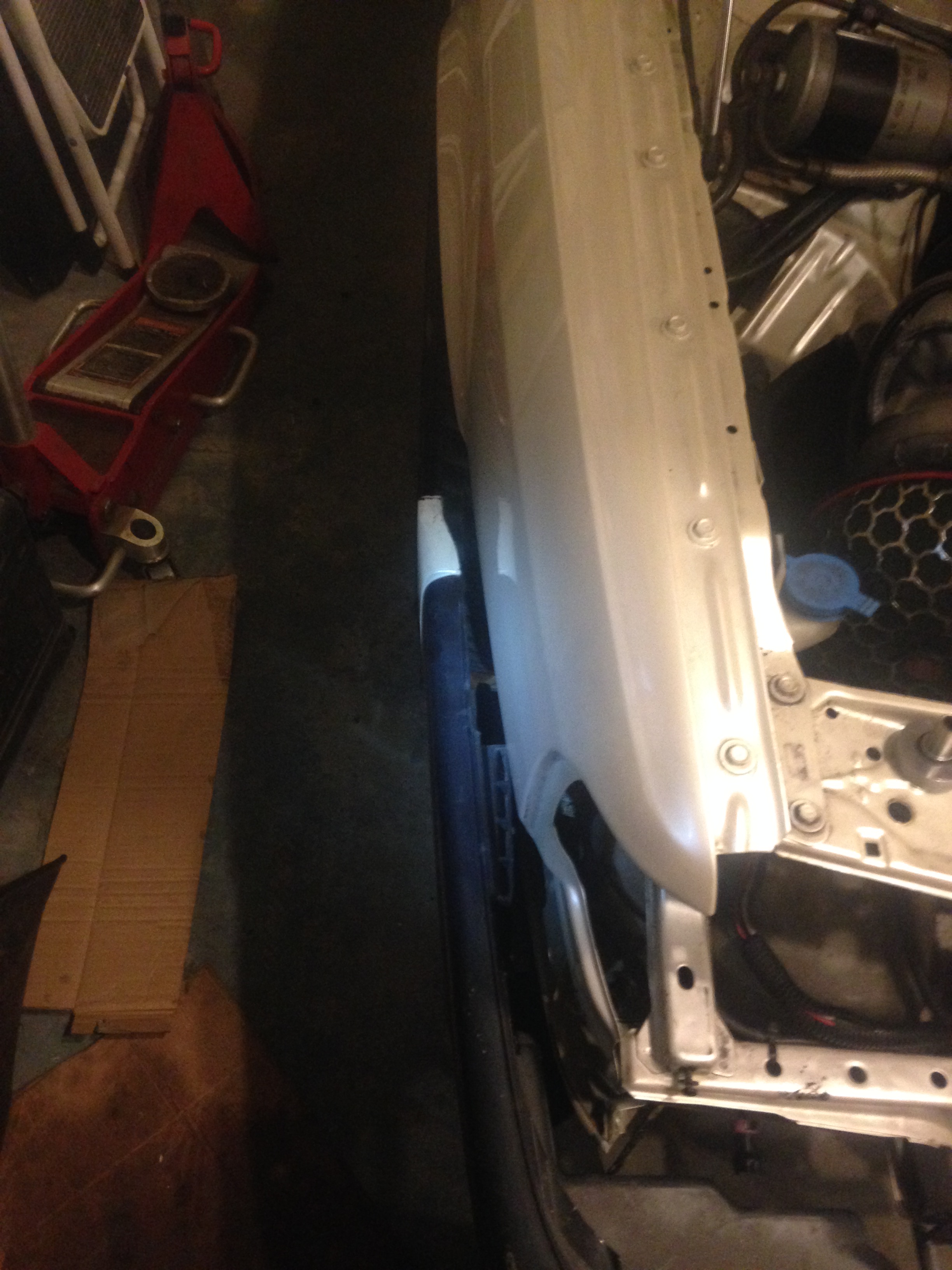

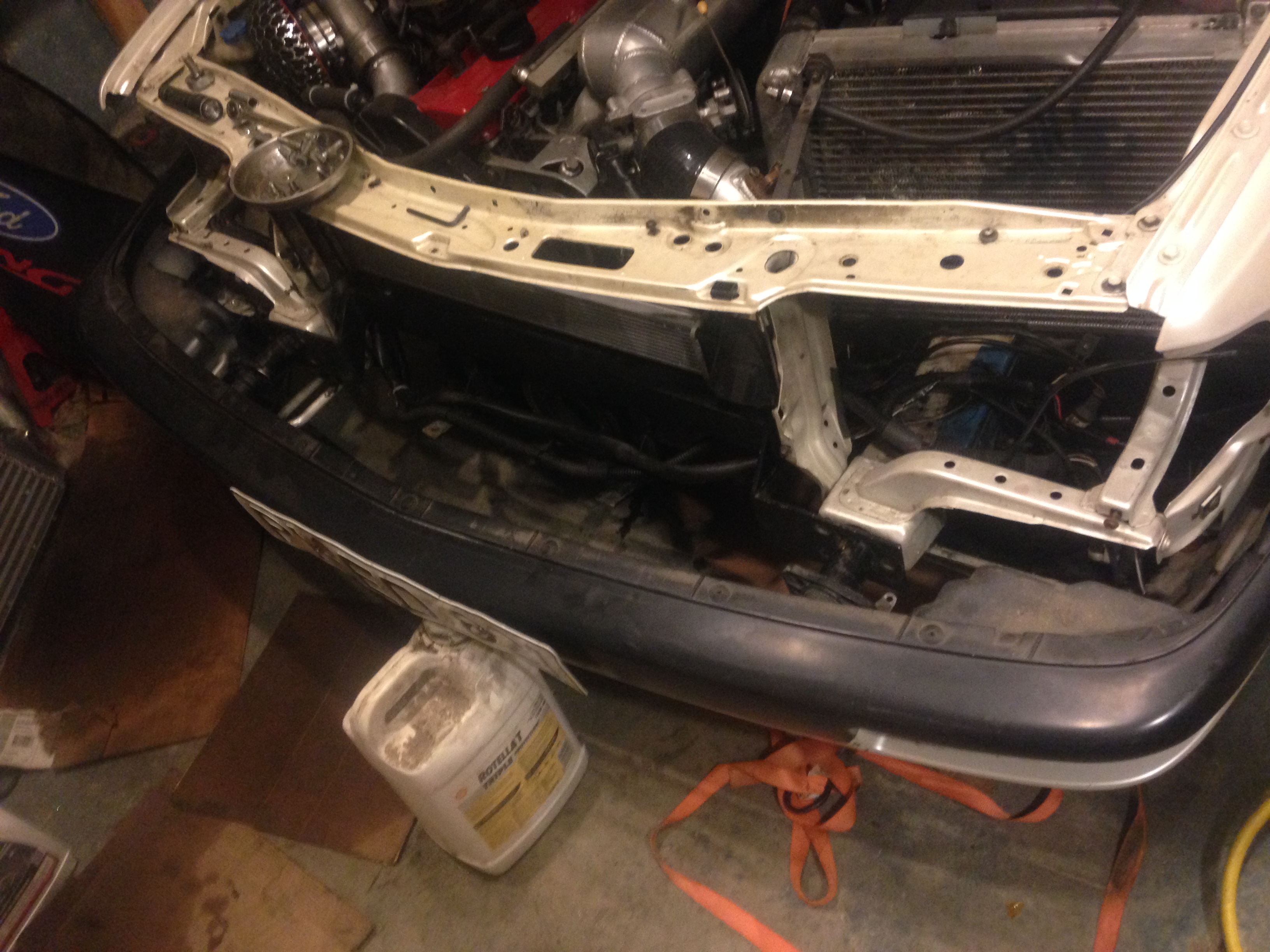

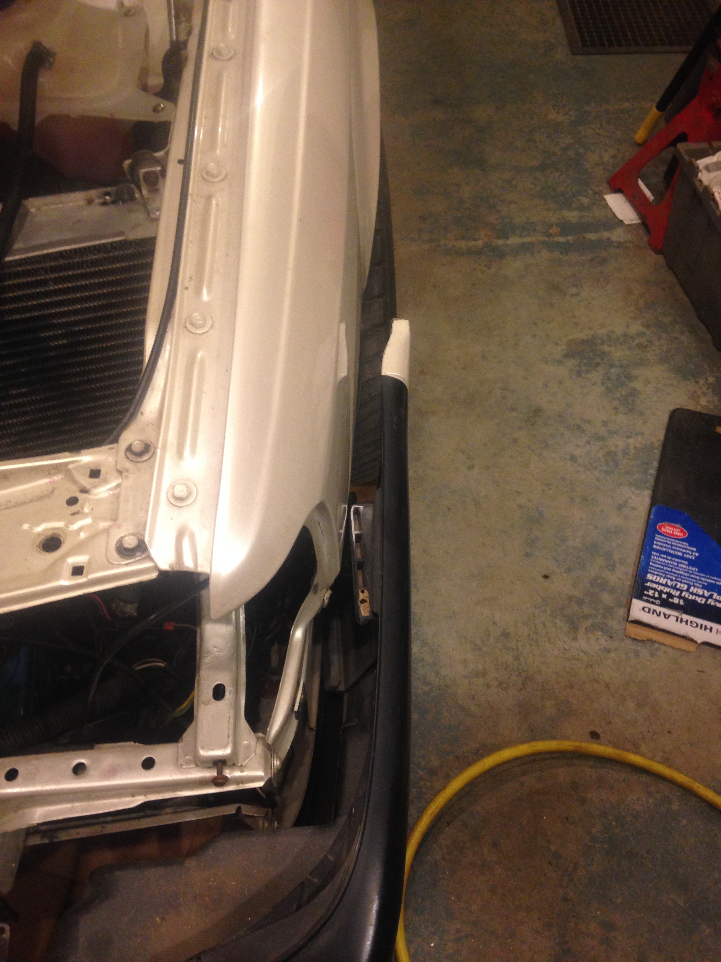

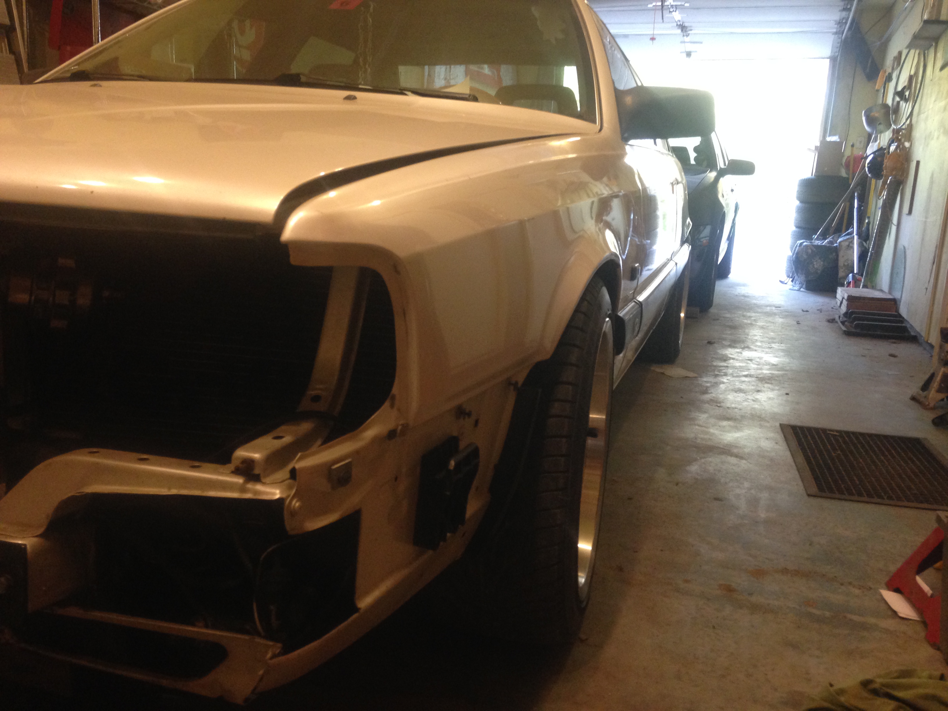

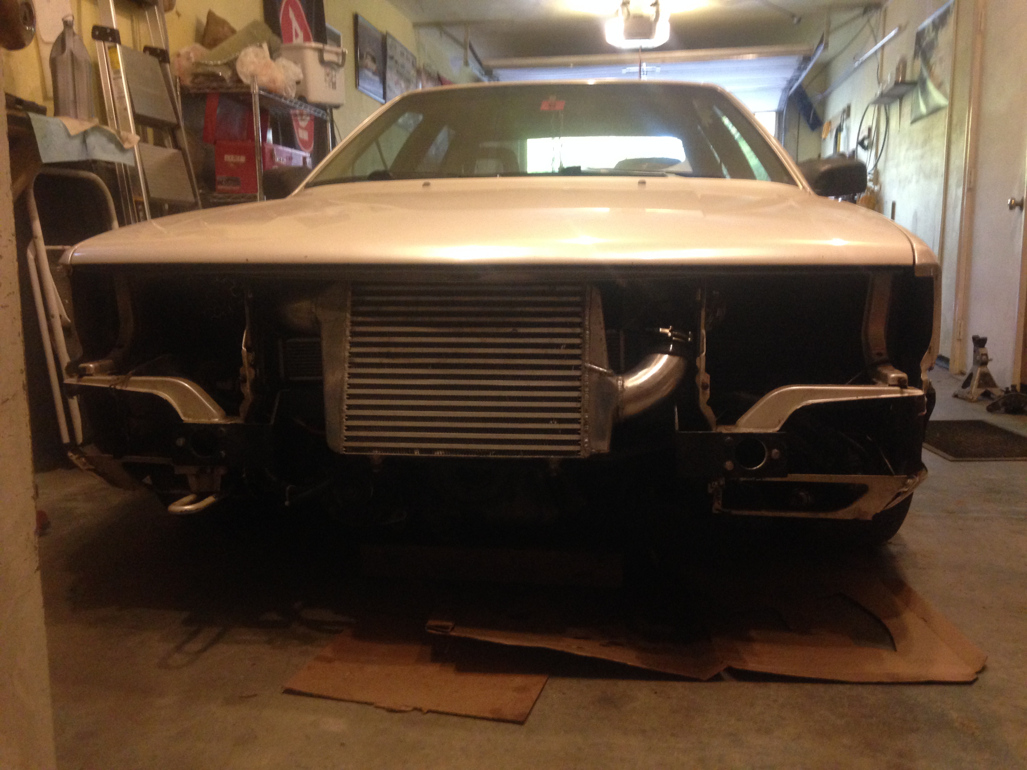

Tonight i tried to get the bumper back on, it is going to be a challenge. the metal brace for the IC didnt lign up that well when i put it back on this winter, it seemed to warp a bit, but it bolted on. Today the bumper shocks wont even fit into the holes, i had to use a ratchet strap to pull them in and then give it a good shove to get it started.
5.19.18 011.JPG (1.82 MiB) Viewed 59474 times
none of the bolts lign up well enough to bolt up and it seems to be shifted pretty far to the drivers side..

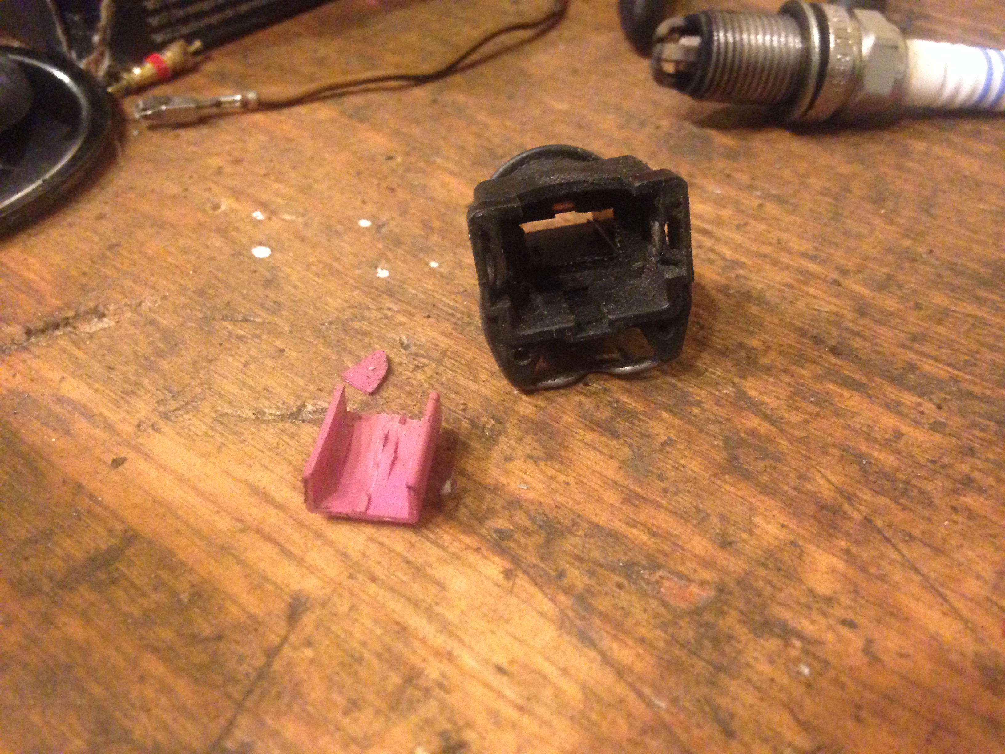

car is running good, although it wasnt at first. as it turns out cyl #3's injector was not firing. when i pulled the plugs in an attempt to read them the #3 still looked brand new while the others looked normal. Tested for spark and it was a go, pulled the injector plug and the inner purpley thing that holds the wire pig tales apart was broken apart. There was another unused plug i noticed when i pulled the motor that i tracked down and removed to harvest the broken part from. it was difficult to remove the wires from the piece but they came out with minimal damage to the part it needed. Here is a photo of the doner plug with the broken piece from the injector plug.
