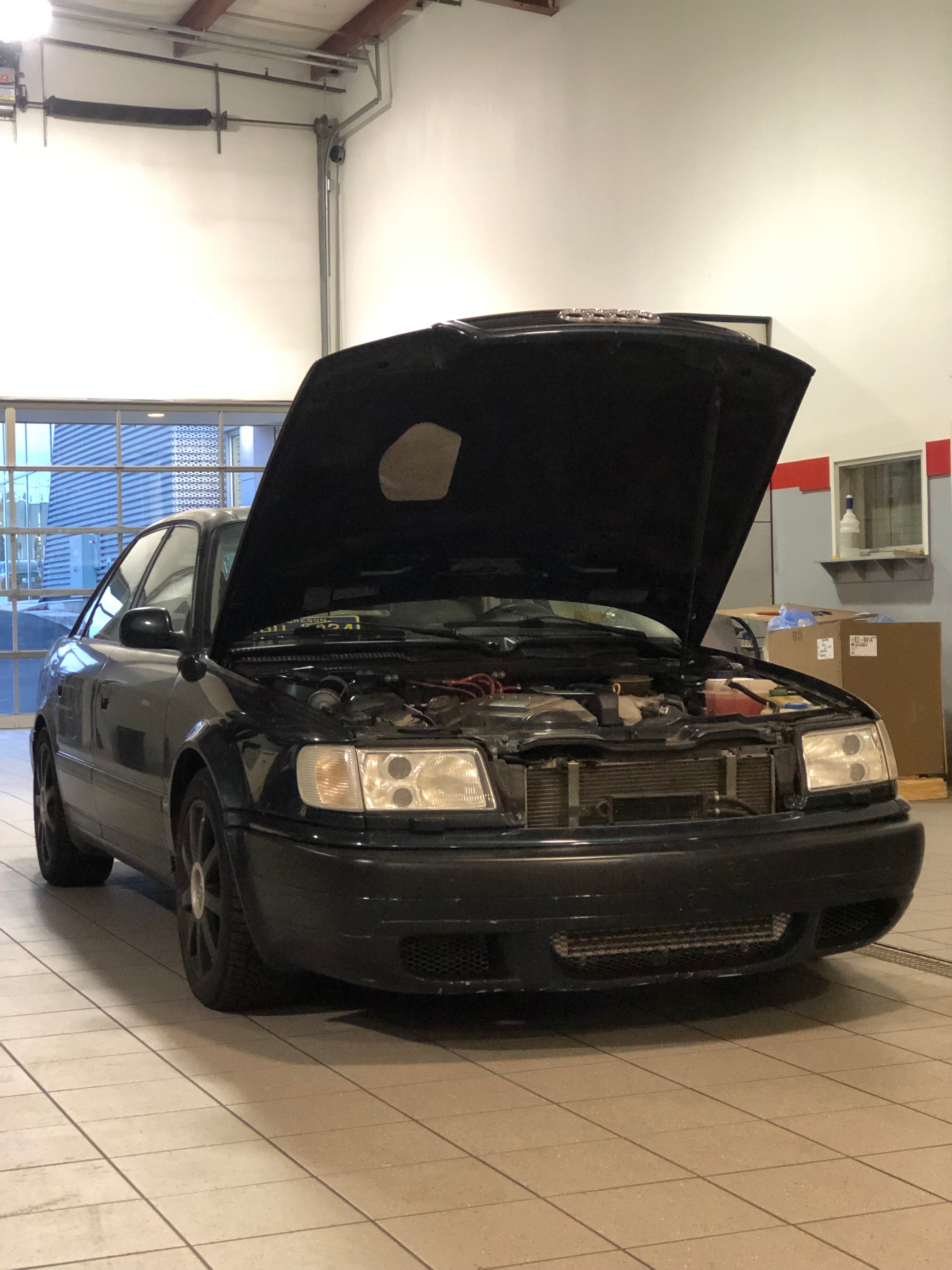

Quick update. Got the new rotor on, stud conversion on all four wheels, and also got the fender off to see the damage. Looks like it’s just the fender which is good. Working on getting one of those here soon. Don’t think I will drive the car until I get a new fender on it though.

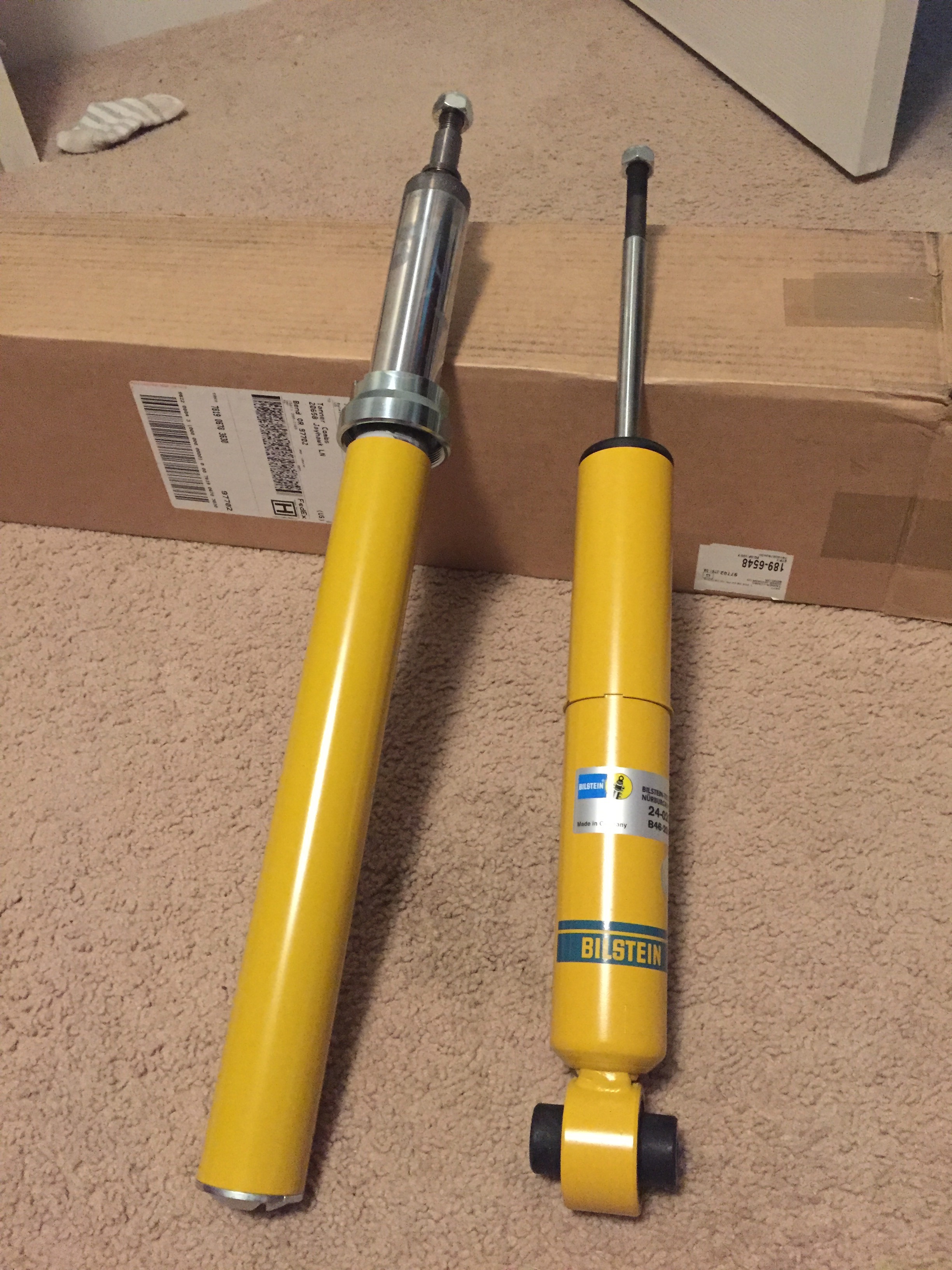

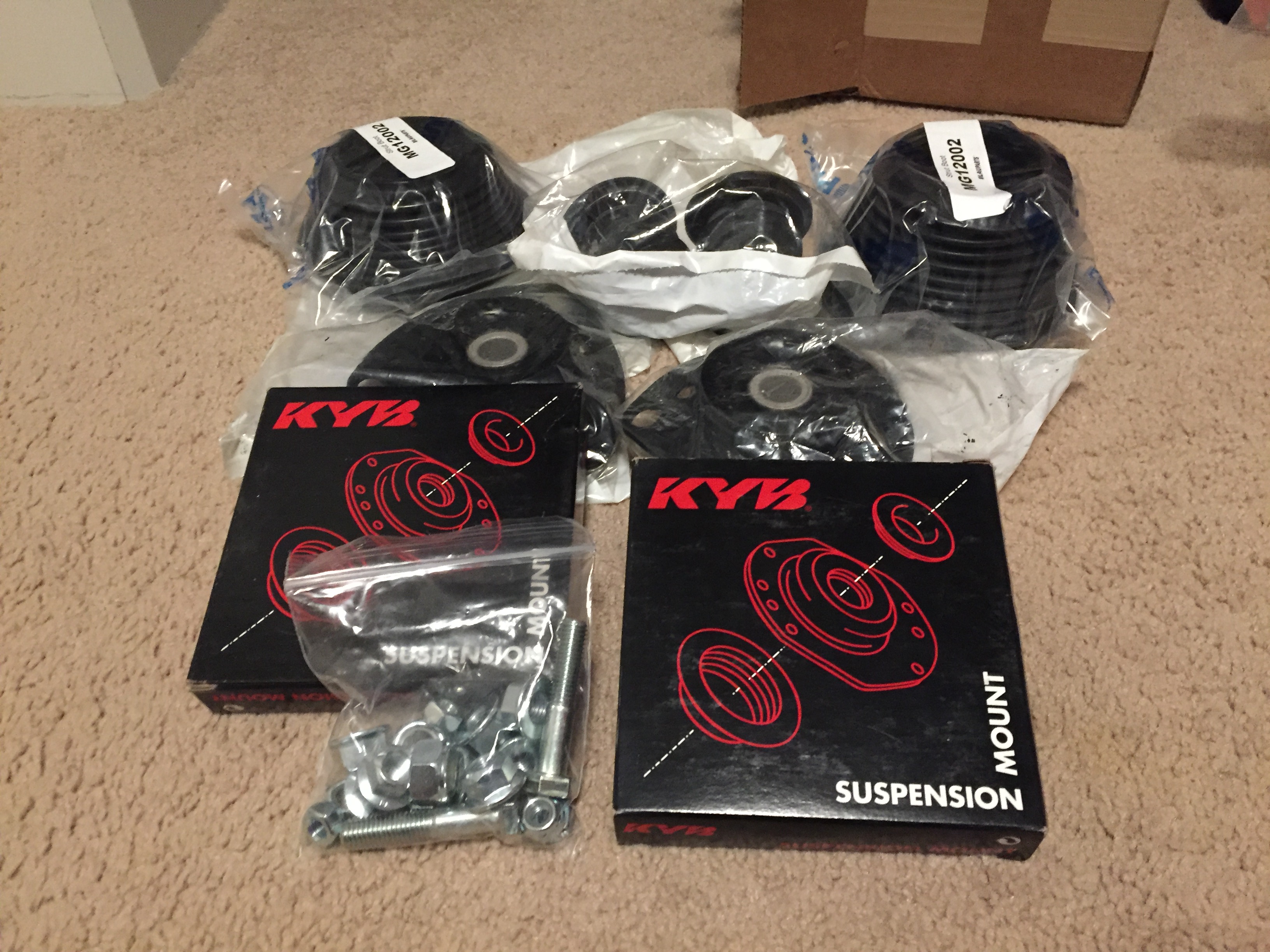

Well, after my order in July, I finally got my struts last week. Apparently they were back ordered from Bilstein and no one had them in stock. The rears werent that bad, I got those within two weeks. I also just got an install kit from Blau that comes with Front Strut Boots, Front Upper Strut Mounts, Front Upper Strut Bearings, Front Strut Bump Stops (Fits OE style struts),Front Suspension Strut Hardware Kit. The bearings are Meyle but I had done some reading before and bought the KYB one just to make sure everything works properly. Speaking of, I have done some research but I cant find out how to replace just the struts without removing the entire spring and everything else, or even if it is possible? Can I just remove the strut mounts and come out the top, or do I need to remove the entire assembly?
I believe the rear is straight forward? Shouldnt have to remove much to get the shock out correct?

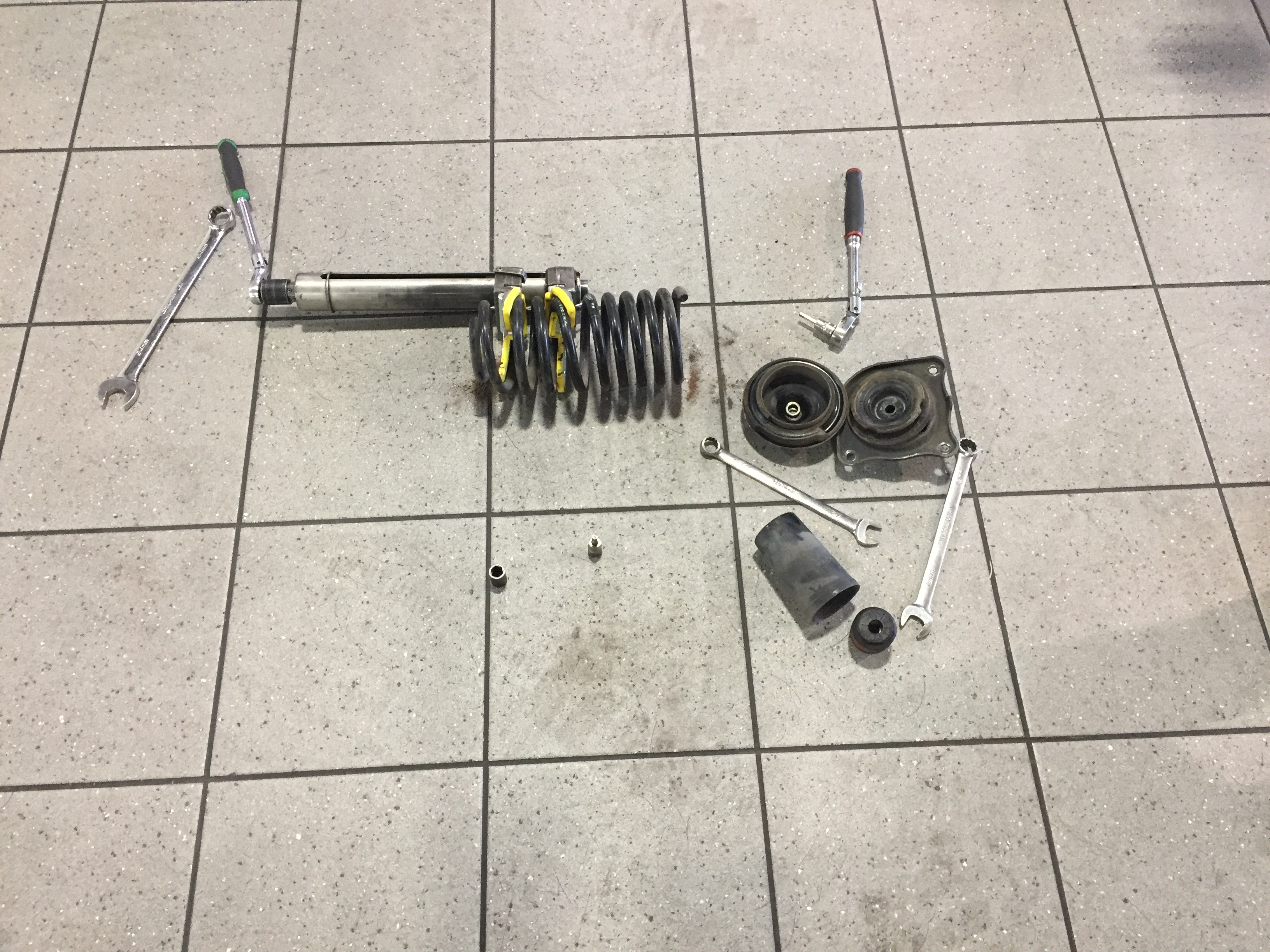

Re: TCombs UrS4, Suspension question, again
Remove the strut nut, then strut mount. The gland nut that holds the strut cartridge in can be tricky but remove it and lift the strut up and out. I do it with wheels on the ground. Make sure inside the strut housing is clean and dry. Drilling a small hole in the bottom to drain any water is also a good idea. Good luck!

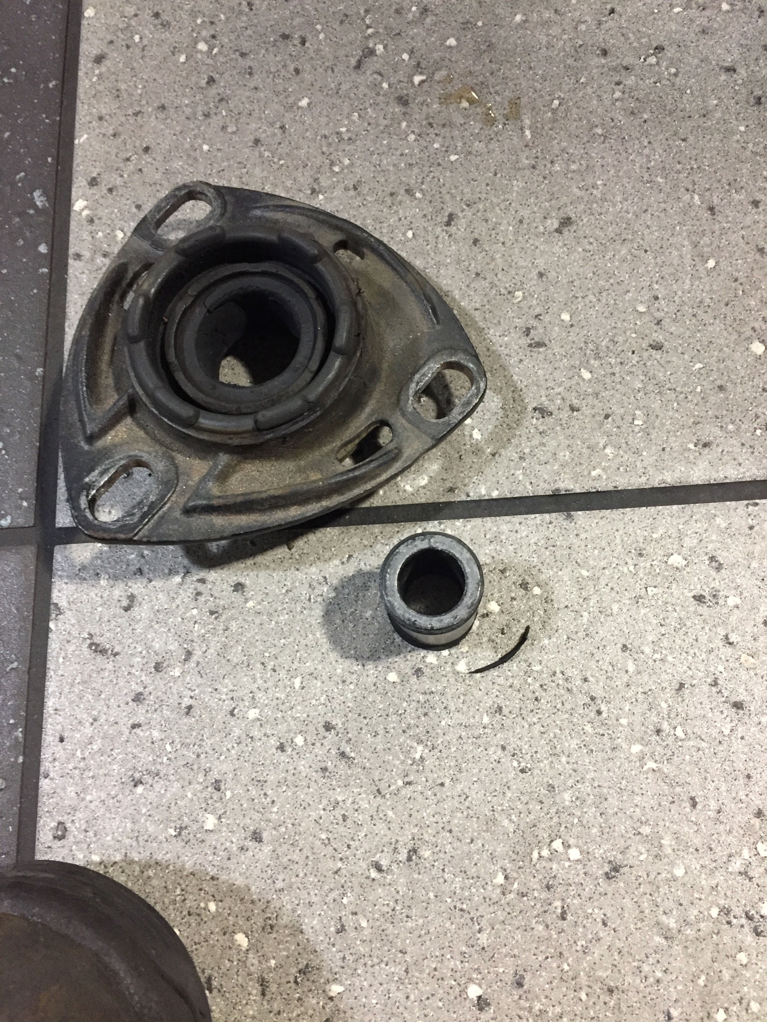

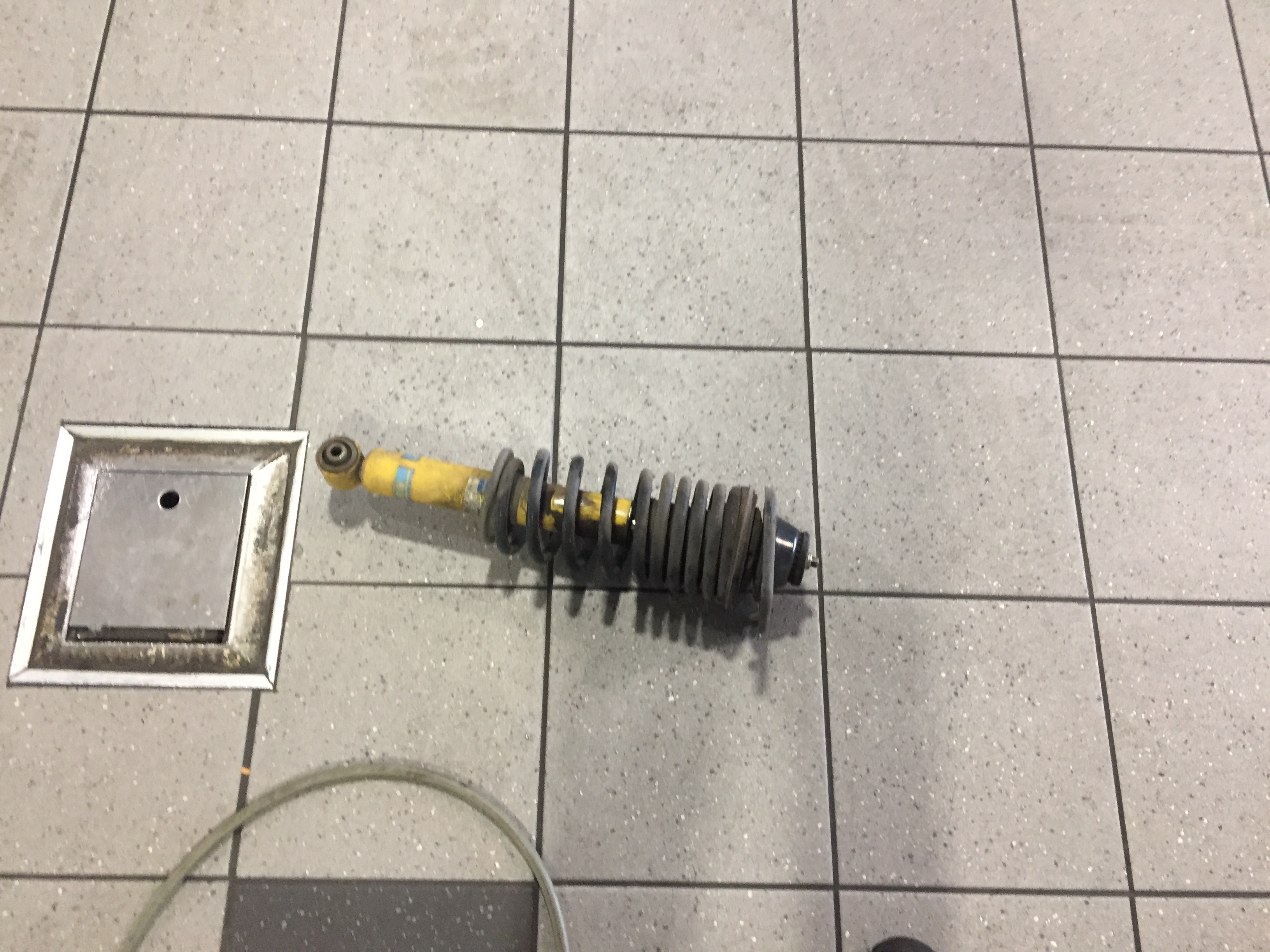

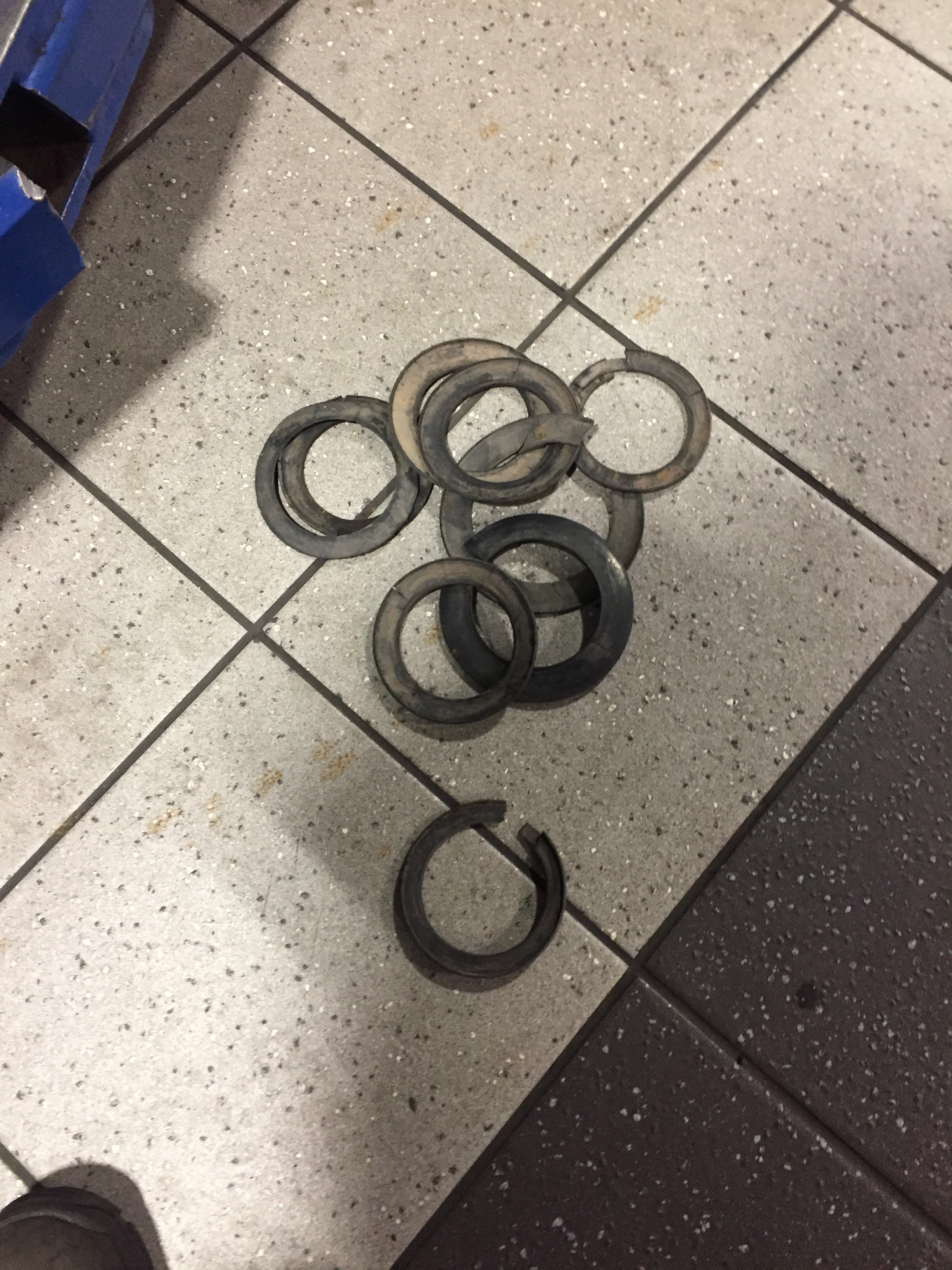

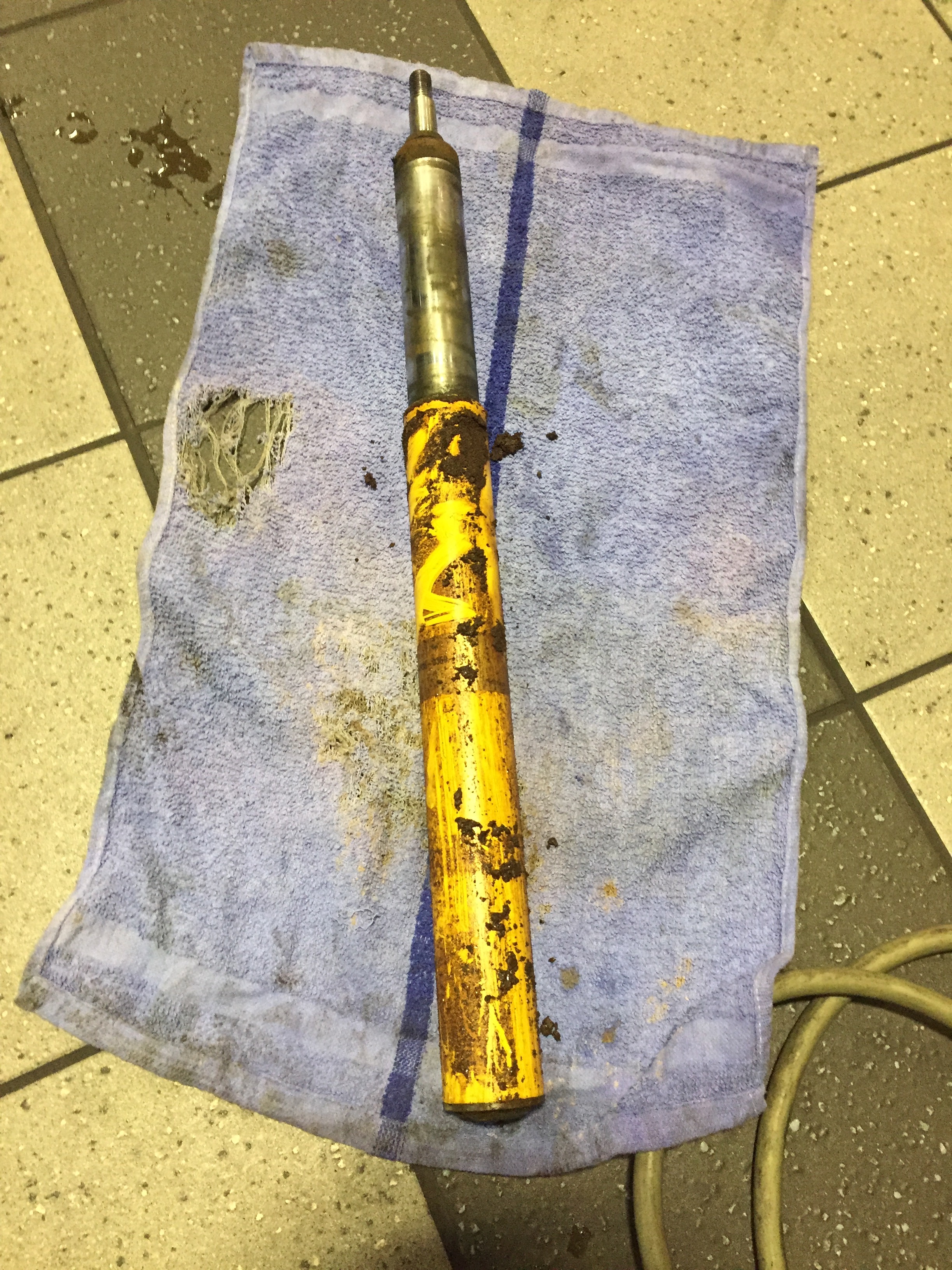

Well, finally got my new struts and shocks in. I will need an alignment which I will probably do this weekend.
It was quite a learning curve to get everything done. I had some help from a veteran tech who used to own his own shop. The front struts were difficult at first but I was able to get them out. The inside of the housing was full of rusty water, Made sure to clean that out. I didn't get a chance to drill a hole in the bottom because I couldn't lift the car up due to the spring possibly popping out and I didn't want to drill a hole with the new strut inside. I used blue loctite on everything and used a paint pen to mark the nuts to make sure they don't move, although I am going to have to loosen them to do the alignment anyway. The struts actually weren't that bad, but the top mount was horrible. It was able to move around freely.
The rears weren't that bad. Pretty straight forward. A little sketched out using a spring compressor but I got them out and the new ones back in.
The car ides awesome now. Much less vibration at idle. No noises over bumps.. for now. More driving will tell. Super happy so far. Although I wish I didn't have to wait six months to get the struts in.

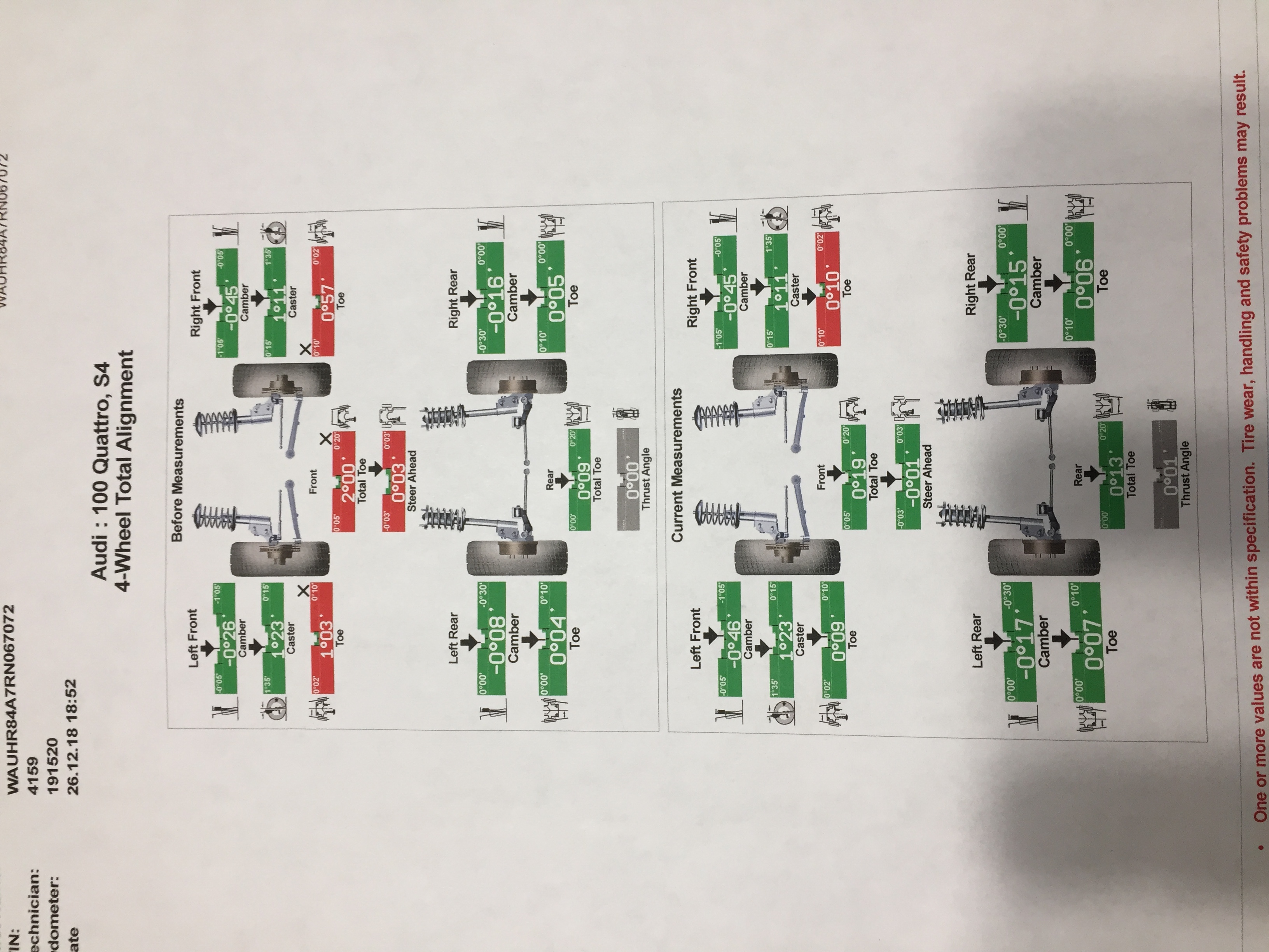

Got the alignment done tonight. I actually wanted to have a weekend and not have to stay late Friday or go in Saturday so I stuck it out and got it done. I have done a few alignments before but nothing on an older car. Rear camber was a bit difficult, trying to get your hands and a wrench up there to loosen and turn everything. Luckily the rear toe was fine. On the front the camber was super easy. Wish the newer Audi’s were that simple. However the front toe was a bit more involved. It wasn’t even on the board before so having it show up pretty close is a win. It kept showing all good until i print the paper out then it went red, even though 10 is still good. These are specs from Hunter for a C4. If you guys have an input of what it should be let me know. Especially you track/AutoX/ Spirited Driver’s our there.
