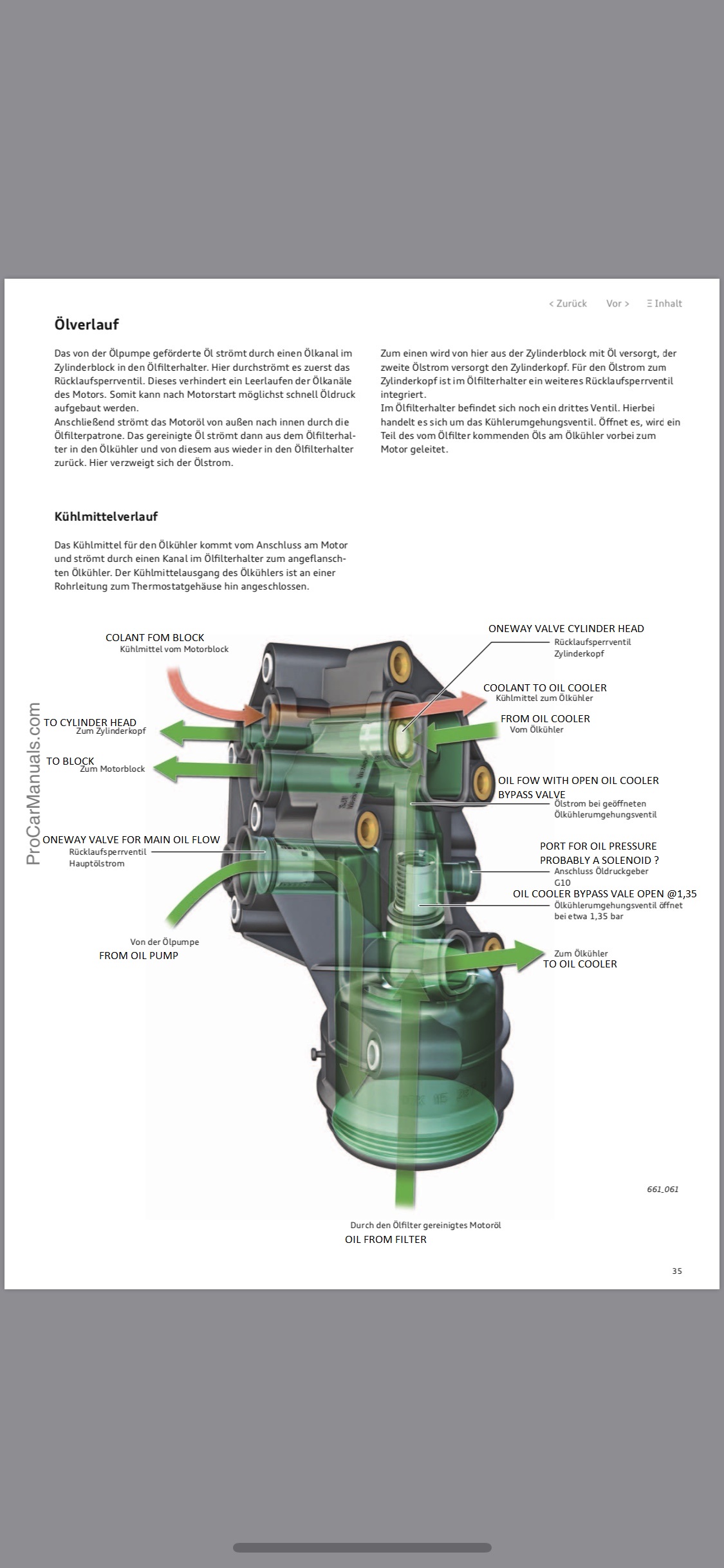

That diagram shows a pump with an electronic controlled solenoid. I've never seen one of those in an early engine.

Yeah you are correct, I have had no luck finding the diagram or any info on the older pump , but I was able to find some info on the later variable pumps and was trying to use that to see if it would provide any insight. I was looking into the pumps to see if I could interchange them at all or if I was stuck with this style. But maybe I dont even need to worry about it. I was curious how it worked though!
You have the older one?
So in my picture, the old style pump on the left is what my block has in it. I *think * that is the only pump that I can run in my old block . I read that there were 3 types, and the one on the right I don't know if that is mid or late. Will have to do some research.
After some looking I think I see "some" of how it works on the old pump. It looks similar to the later solenoid controlled version except the gears are fixed, not axially displaced like in that picture.
So how does it regulate pressure?
This is my guess
Post-filter oil, as it is coming back into the engine, goes from the mount block into main passage that goes back into the engine, this has a small port off of the bottom that goes back down to the oil pump and pushes against a plunger type thing.
On the other end of the plunger thing is a spring which is held in place by a "tamper resistant" cap.
The plunger sits in a passage that connects the oil inlet to the outlet. So when the plunger is in a certain position due to the shape of it the wide portion of the plunger blocks the passage. This would give you max outlet pressure.
When the plunger moves the narrow part of the plunger opens the higher pressure discharge side is going to push back into the lower pressure side , path of least resistance.
Im trying to figure out what that all means. It looks like the higher the filtered oil pressure pushes against the plunger and against the spring.
It looks like If the spring is partially compressed this passage would be open between the low and high pressure side .
.Image
Or am I completely wrong and the flow goes the other way? From the pump to the post filter housing passageway ?

Sonofbitch I finally found it . I wasn’t totally wrong . So this is how the older version pump works I think it’s 05-07?
The mid pump really doesn’t look any different than the early but maybe I’ll take a look at one. and the late pump definitely won’t fit .

Hope this helps.

It does help , yeah . Thanks!
I was trying to use google translate .
So I don’t have any sort of check valve on the main oil supply like is shown there . I wonder if the filter due to its location way above the pan would drain down then ? Or maybe most filters already have internal check valve I guess
