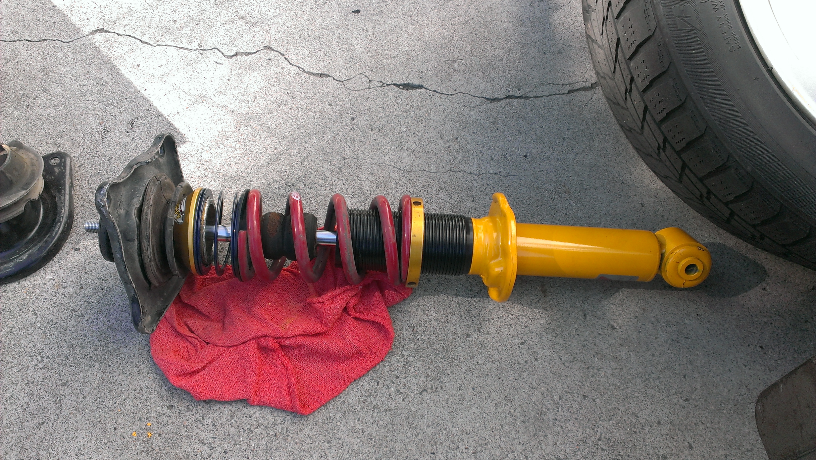

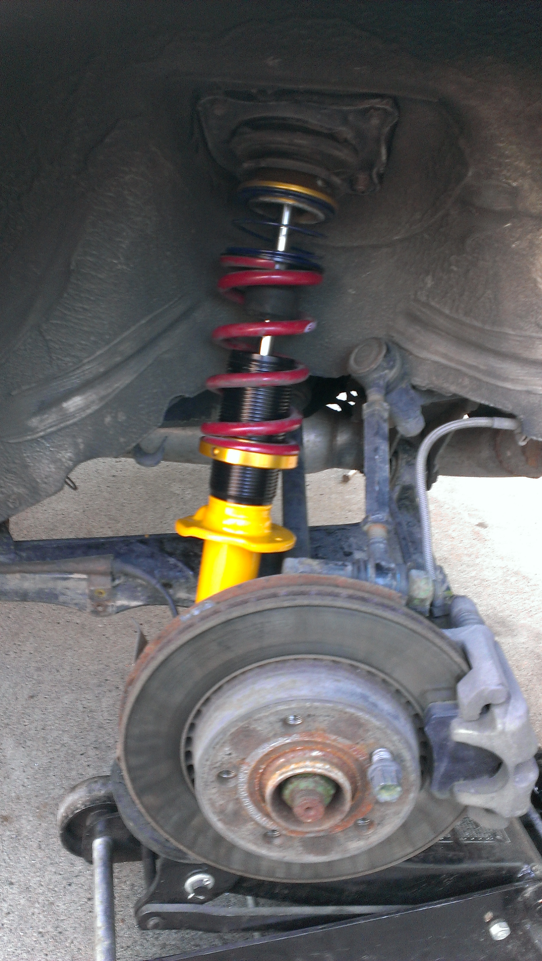

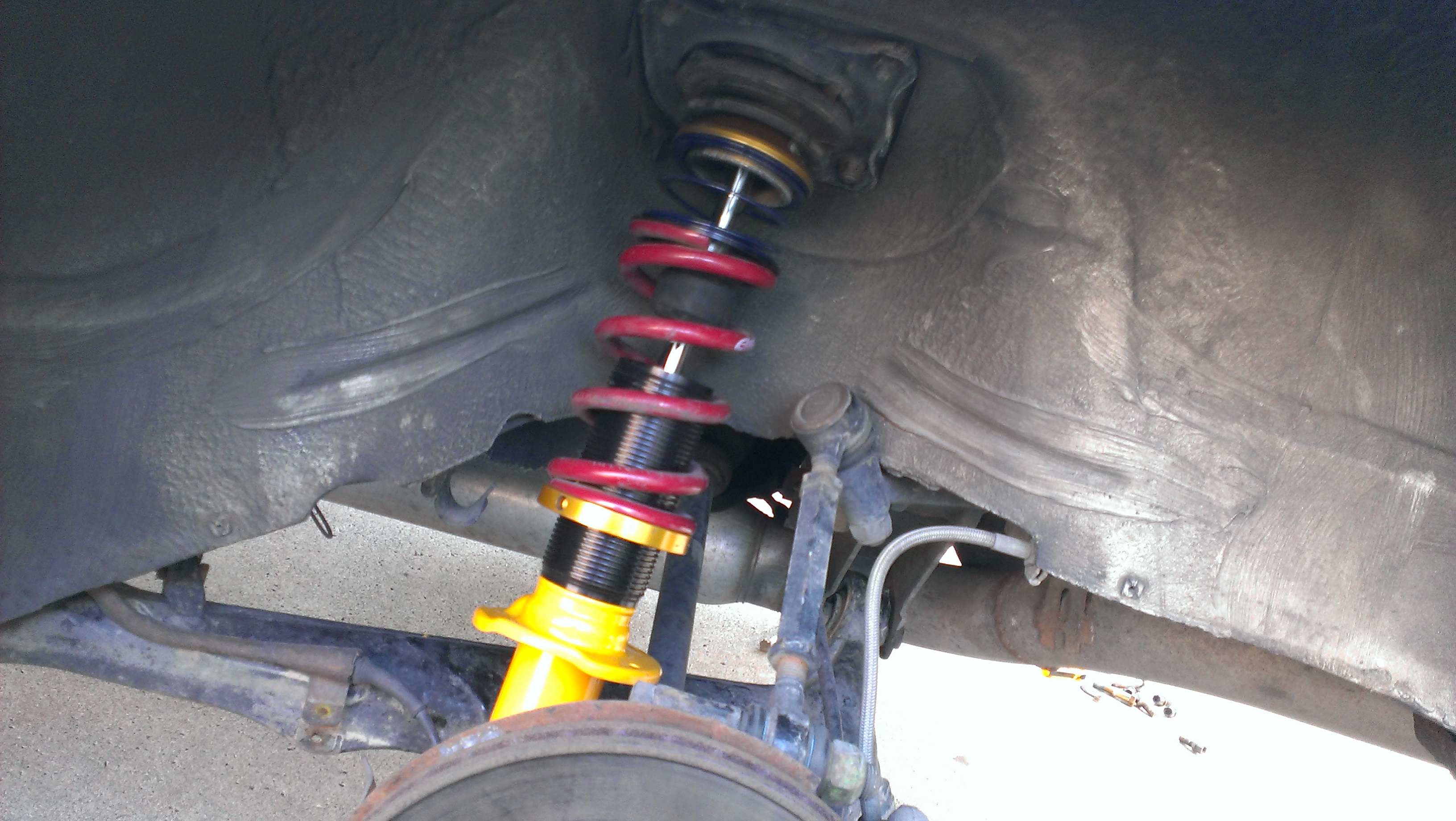

So, managed to get the rears done this weekend. The coil sleeves I had previously for my bilstiens were way too small to fit without possibly damaging the shock. I went to summit real quick and picked up some 2inch I.D. coil sleeves because the koni Body is 51mm, which equals 2 inches.
Well they're closer to 2inches and a milimeter. The I.D of these sleeves I bought were about 52mm which is just enough to cause some play. Also causing the coil sleeve to flare out a bit at the bottom after running them for a day or two which is a big no no. Because it will soon then crack the coil sleeve. Which is baaaad news.
Currently considering calling 2bennett and seeing if they'll sell me 2 of their coil sleeves, I'm worried what they're going to charge me for them.
Also got the rear control arms swapped out and installed the energy suspension bushings on the new rear arms we put in. It handles insanely better and smoother just from doing the rears. Can't wait to do the fronts.
Jared also has some strut housings on the way to me that have the steering arm lowered which I'm stoked about.
So yeah. It's getting there. Gotta lower the coils a bit cause it's got about 5 fingers or more of fender gap. But whatever.
