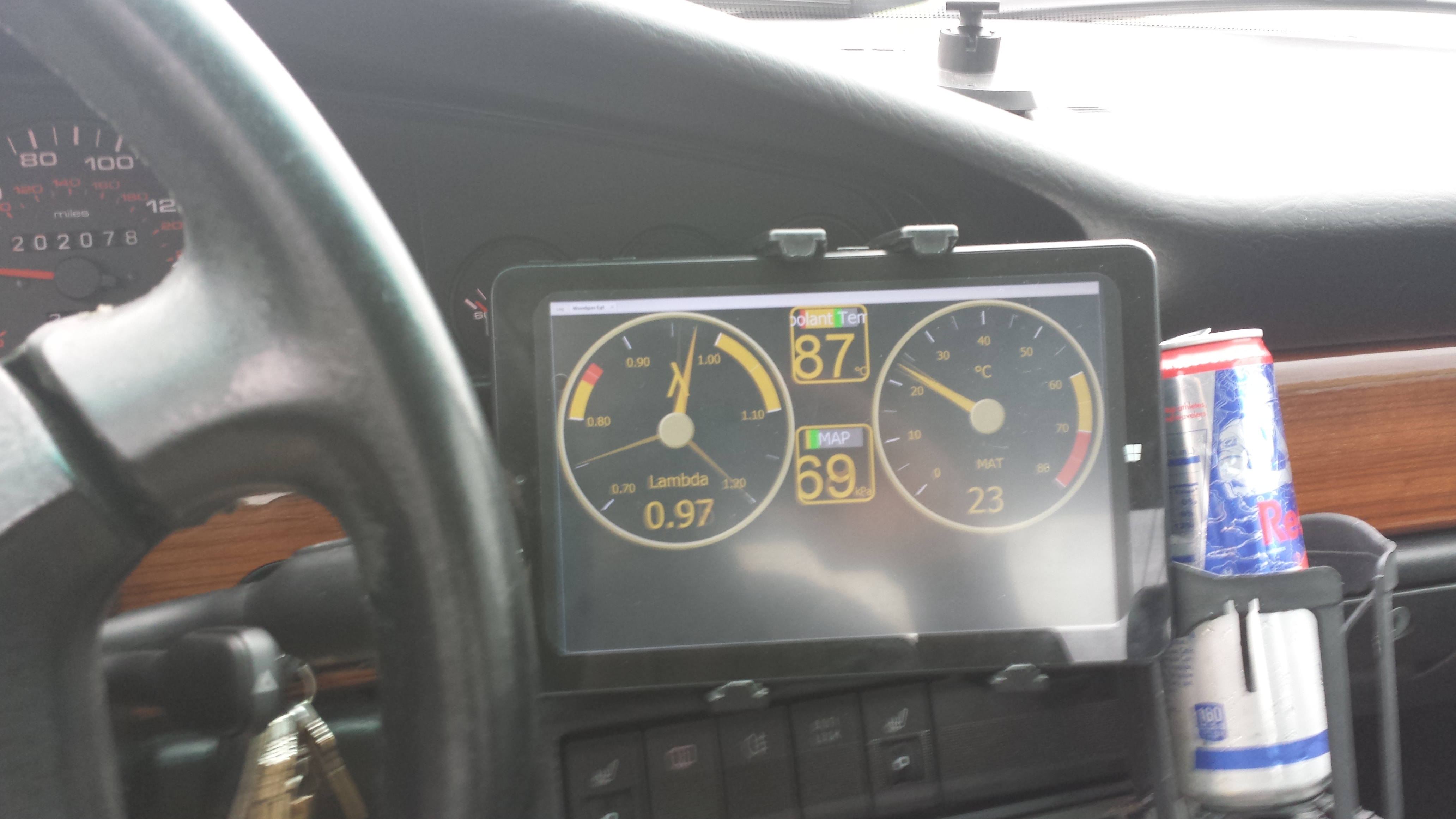

In comes the insignia (bestbuy I'm told?) Windows 8.1 tablet with bluetooth I got new locally without the box for $40 off the retail price. So awesome, this thing! It connects to the BT dongle really well so I can log/tune all on the same interface. I made a gauge face that resembles my 4 most important gauges from VEMSdisplay. I even tried bluetacks android emulator to get back that app I miss already :( It took some coaxing to even get bluetacks to work on a 1 gb ram OS but I only knew what to google so I didn't hack any of it myself lol.
Well I got VEMSdisplay to start and all but it sticks at the point of asking my "phone" to turn on bluetooth. It was all a bust. I hears interesting things about apps interfacing perfectly using the emulator but this sucked.
