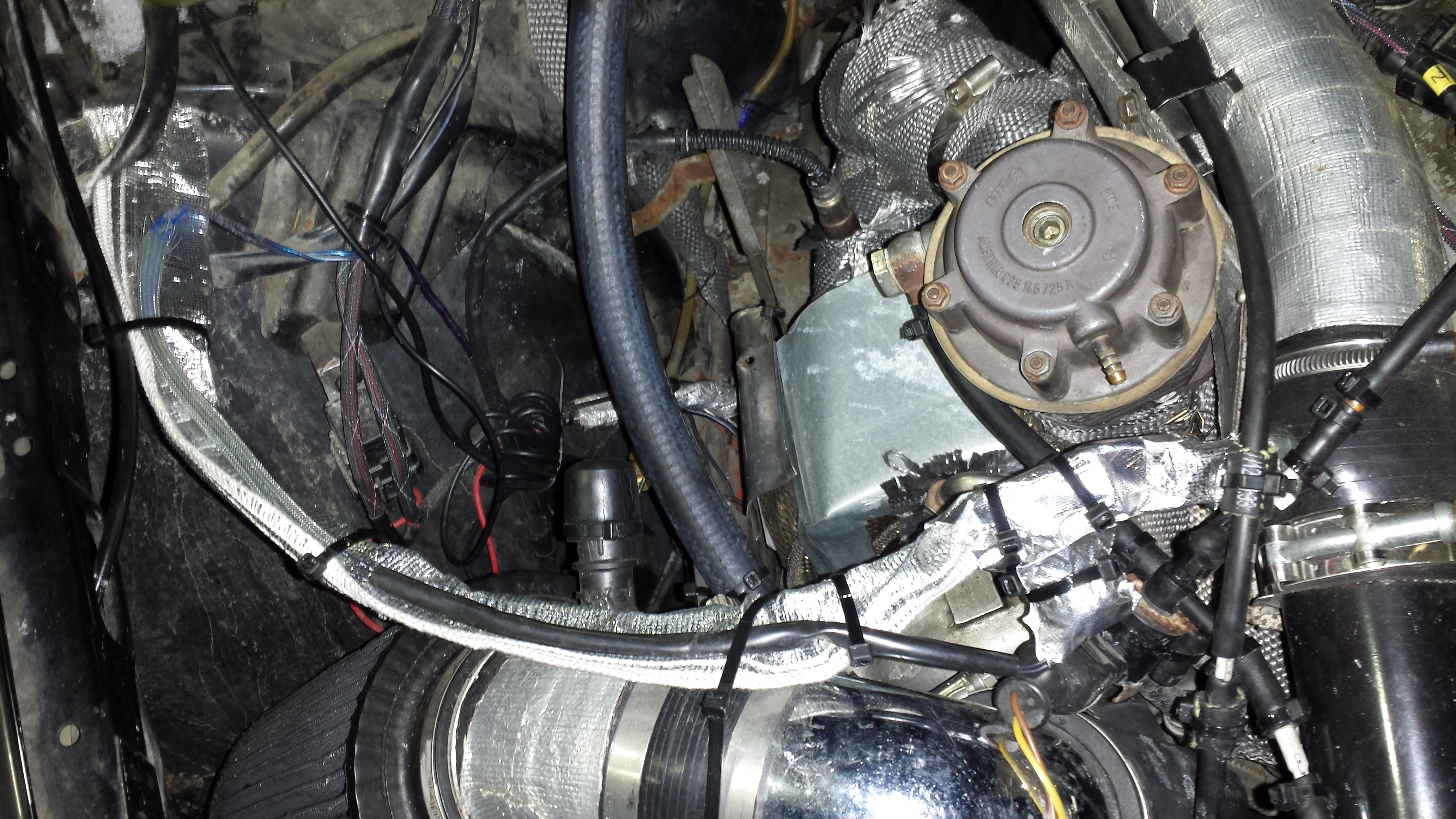

Small update. With w/m injection, the ability of each compound to absorb intake charge heat and dissipate it is based on how much of each is present in the mixture. I figure it stands to reason that the cooler I keep the mixture prior to injection will give a beneficial increase in that property. I did this with my supply line since it runs from the fender area over the exhaust manifold and turbo/WG area:
W/m line running through pic with reflective sleave
Wasn't costly bot difficult and I may even modify my ignition table with the cooler weather arriving.
Besides, my solenoid valve is a big block of aluminum right next to the WG :D
There is theoretically a small benefit, but we are taking unmeasurable. The benefit of having a colder injection is orders of magnitude smaller than the true reasons why water meth injection us effective. That is, the high specific heat capacity of water and the energy absorbed when changing phases. Do not modify your ignition table based on a marginally cooler mixture of watee/meth.
