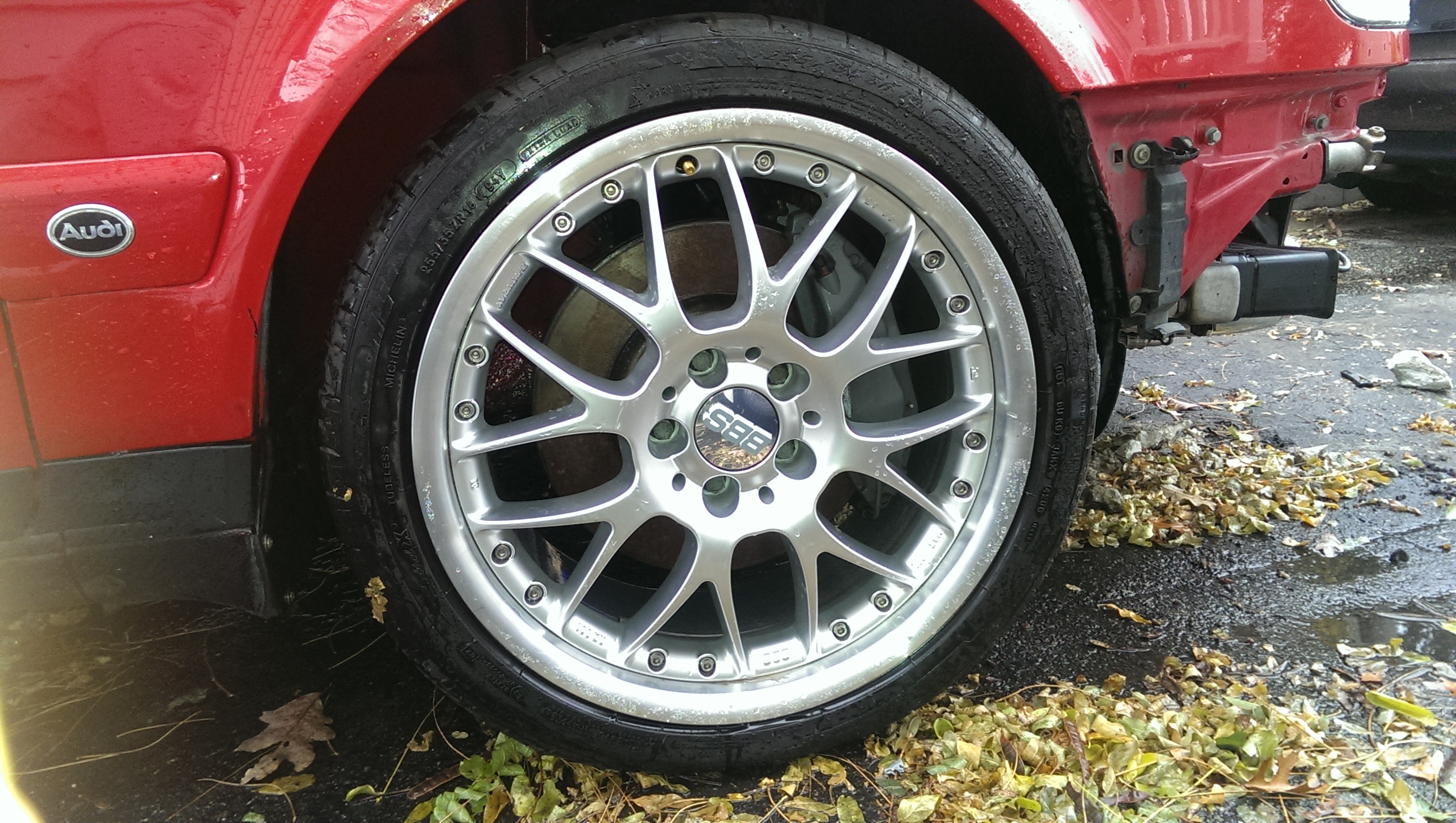

Re: Rubi Beta v3.0 - The Assemble Phase...
Posted: Sun Nov 01, 2015 9:14 pm
Hmm, interested in the full side view with those wheels... and of course VIDS
Posted: Mon Nov 02, 2015 3:11 pm
by mushasho
loxxrider wrote:Hmm, interested in the full side view with those wheels... and of course VIDS
I'd love to get the coilovers on to get the full effect of the "stance"...
but in the meantime...
Something like this?
