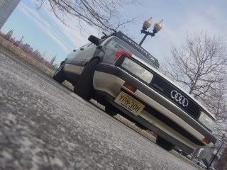

Went to the track today to watch my uncle get some instructional driving time...I took a pic or two of mine when I was there and I think the front has already settled a bit. Looks nicer now

looks great.
