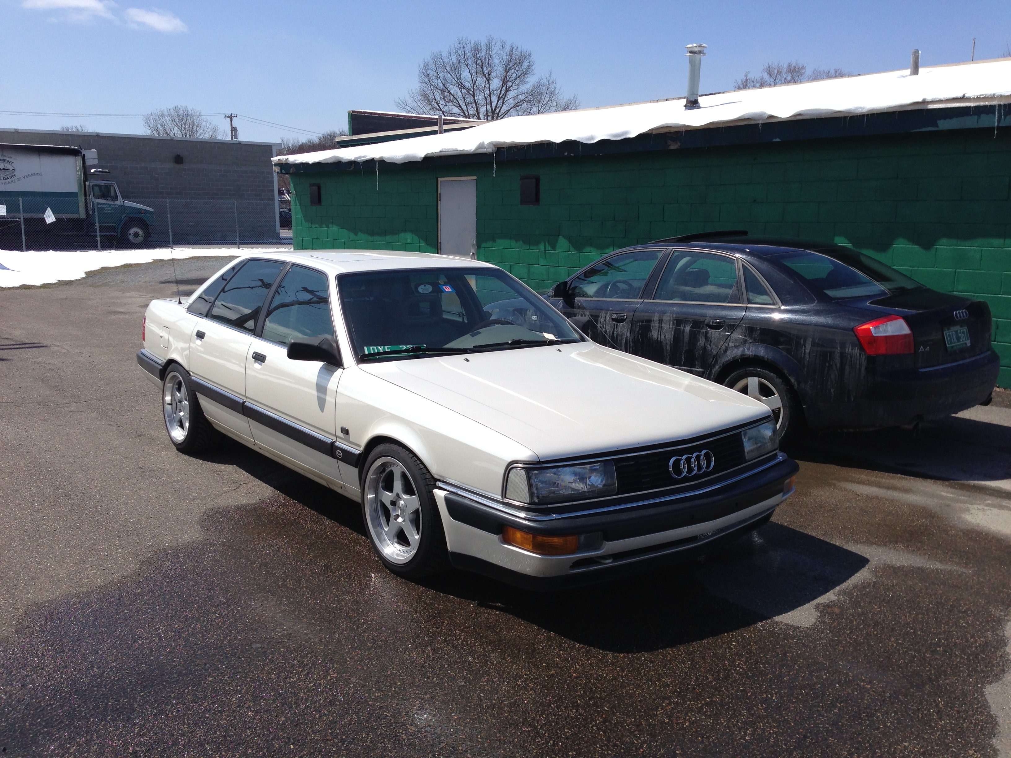

Guess who's back? Started right up 8) I sure did miss this thing and BOOOOOOST

loxxrider wrote:Right in time for Carlisle
I hope so! Just need to figure out what it needs before the trip.
Quattro20v wrote:What wheels are those? Nice car BTW.
I'm somewhat ashamed to say they are Saleen Motorsport Replica wheels. They are 5x114.3, 17x9 et 24 wearing 225/45 tires.
