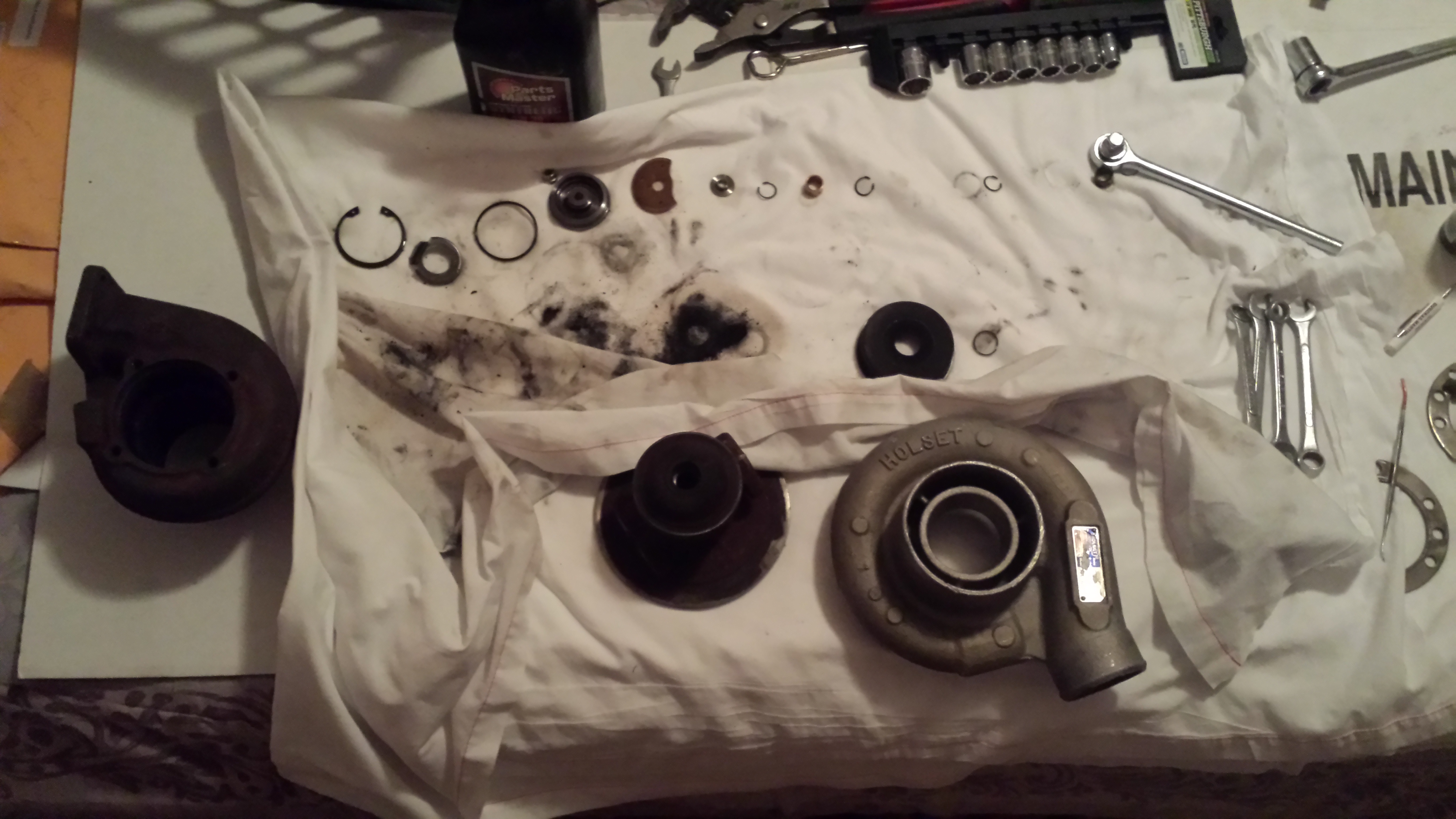

Jesus Christ it took 2 or 3 hrs with the heat gun and torch to free this bastard. Oh and a week of trying

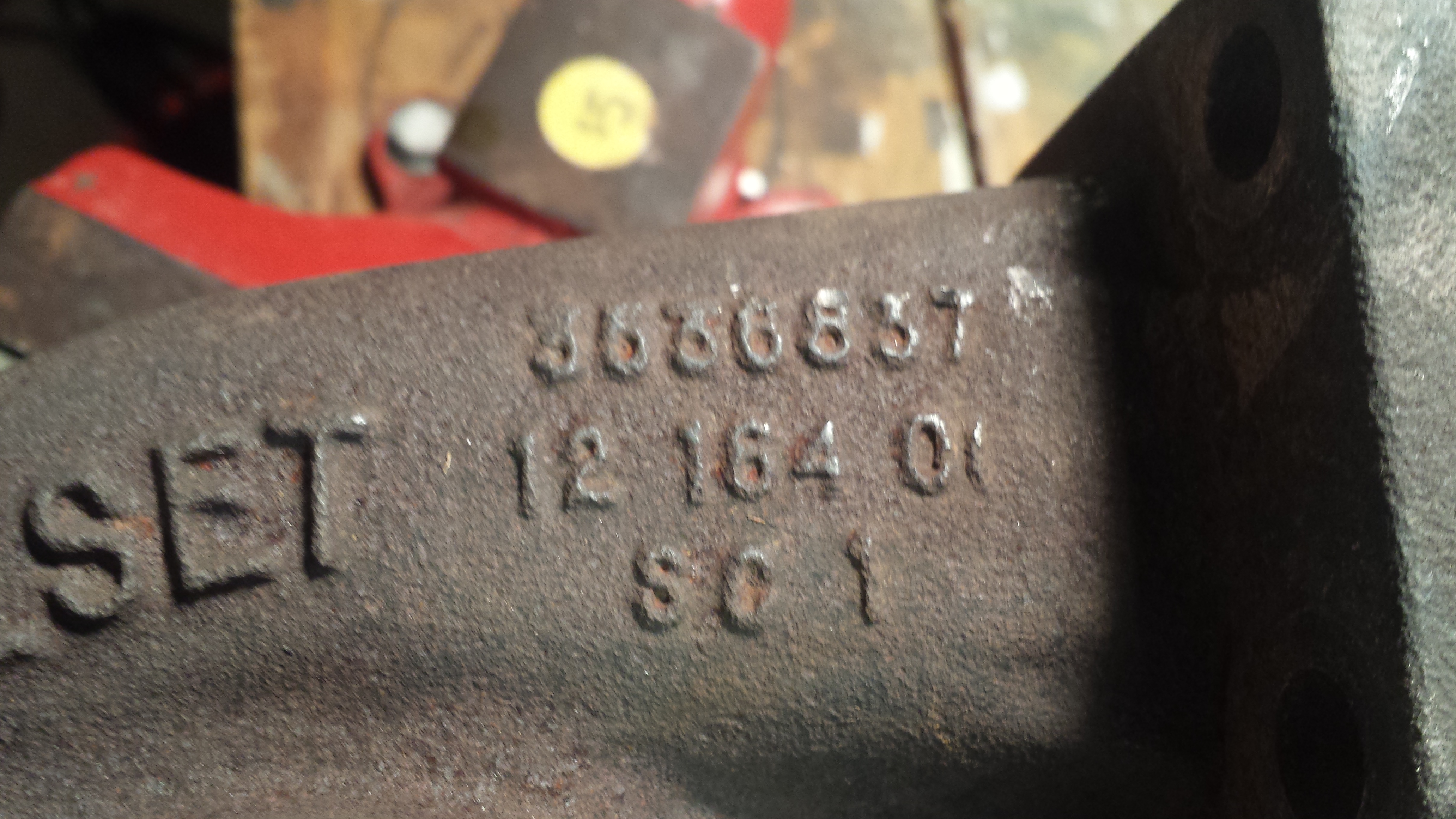

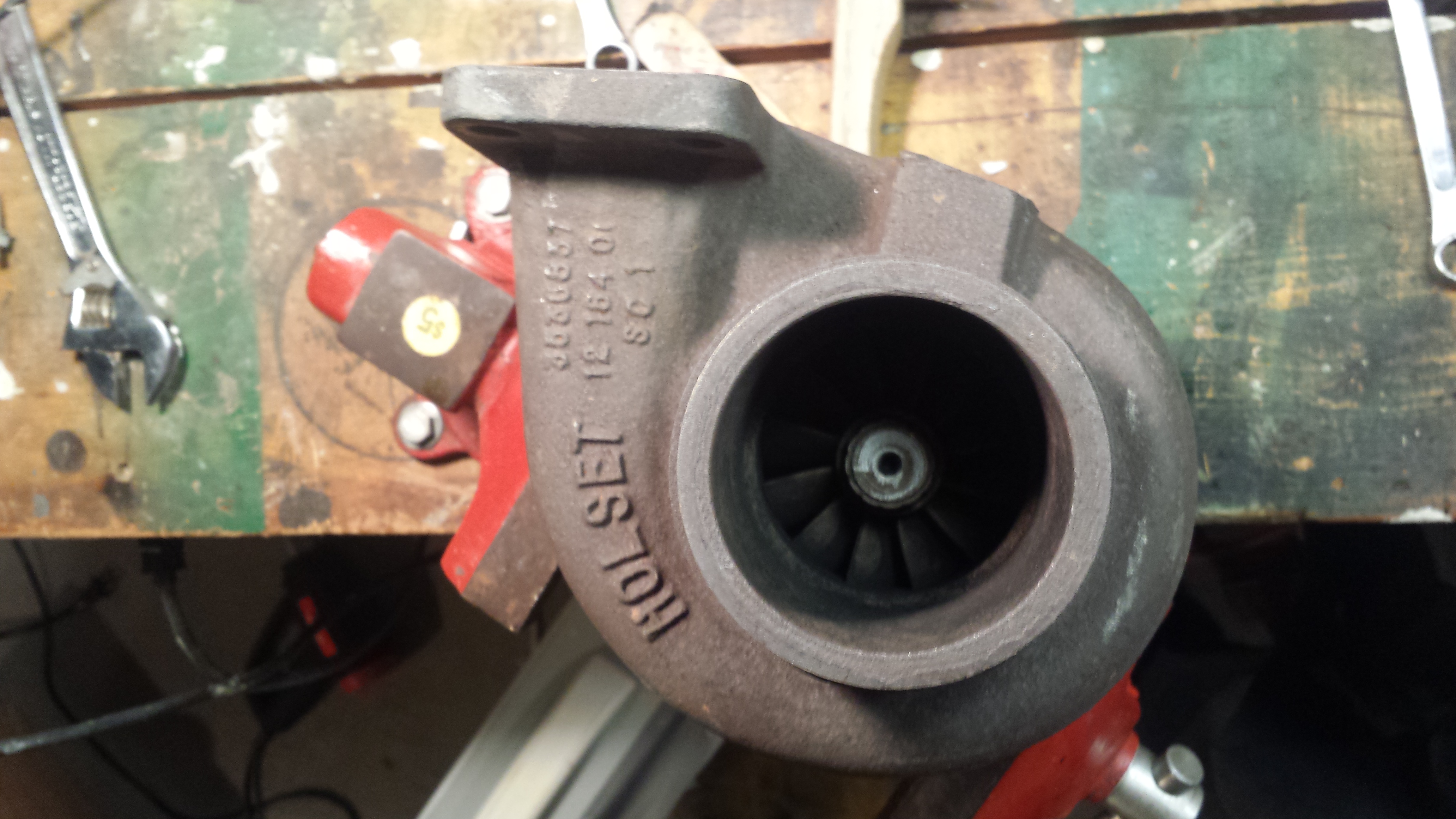

For the curious few:
Hotside reads... dam I can't even read it lol
Look inside the volutes to verify the hotside size.
:thumbsup: Found early on that it reads a 12

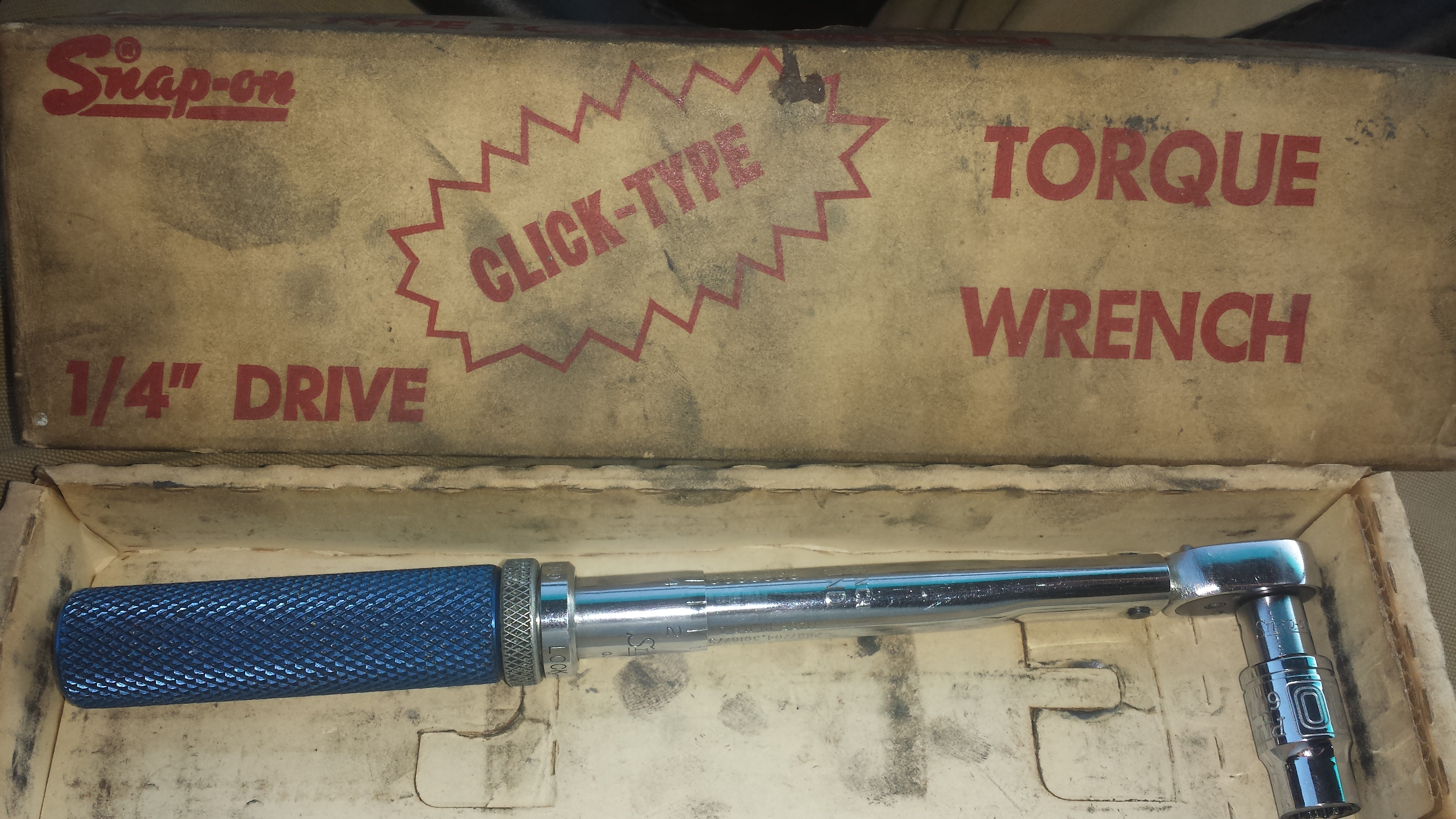

Doesn't look like my inch pound torque wrench will click on the left direction. What now. Call machine shops to use theirs?
Calculate it.
What like use a digital scale and a 1 ft socket wrench and, while standing on a digital scale, crank until my body weight increases by 10 lbs (actualy 10.33 lbs)? If there's a better way I'm down with it
I also have a bar type TW I could use but that seems like a patient 2 person jobber. I bet the neighboring mechanic shop has a proper TW and they usually let me borrow tools
You would use a regular wrench and apply a known weight to it at a known length (and multiply the two). Of course, the weight of the wrench becomes significant in this too for small torque values like this. It can be done fairly accurately that way though.
This thing is tight like a tiger now. The other shop down the street says they might have a wrench that clicks left I can use. The guys that put my clutch in twice lol.
Ok I got ya. So I'd attempt 10 lbs of force at 1 ft on a wrench. Or at least some combination that multiplies out to ~10 ft#s
Thanks. If the TW falls though I'll grab a 10 lb barbell and start there
Borrowed this really dope snap-on from waaaaaay back. Really good friend coworker at the funeral home lol. Ooooh, blue anodized! This will do the trick :)
Its only fitting that I used this TW. Guy said he "set many a rack on the Cummins trucks with it."
Worked great for the job but I had to try like 6 times of torqueing the nut to get my initial marks aligned. I know they're all separately balanced pieces but I hate taking chances on things like this that take up many hours of my life from start to finish. Longevity was the starting goal and I could control that by doing the rebuild myself, if at all.
