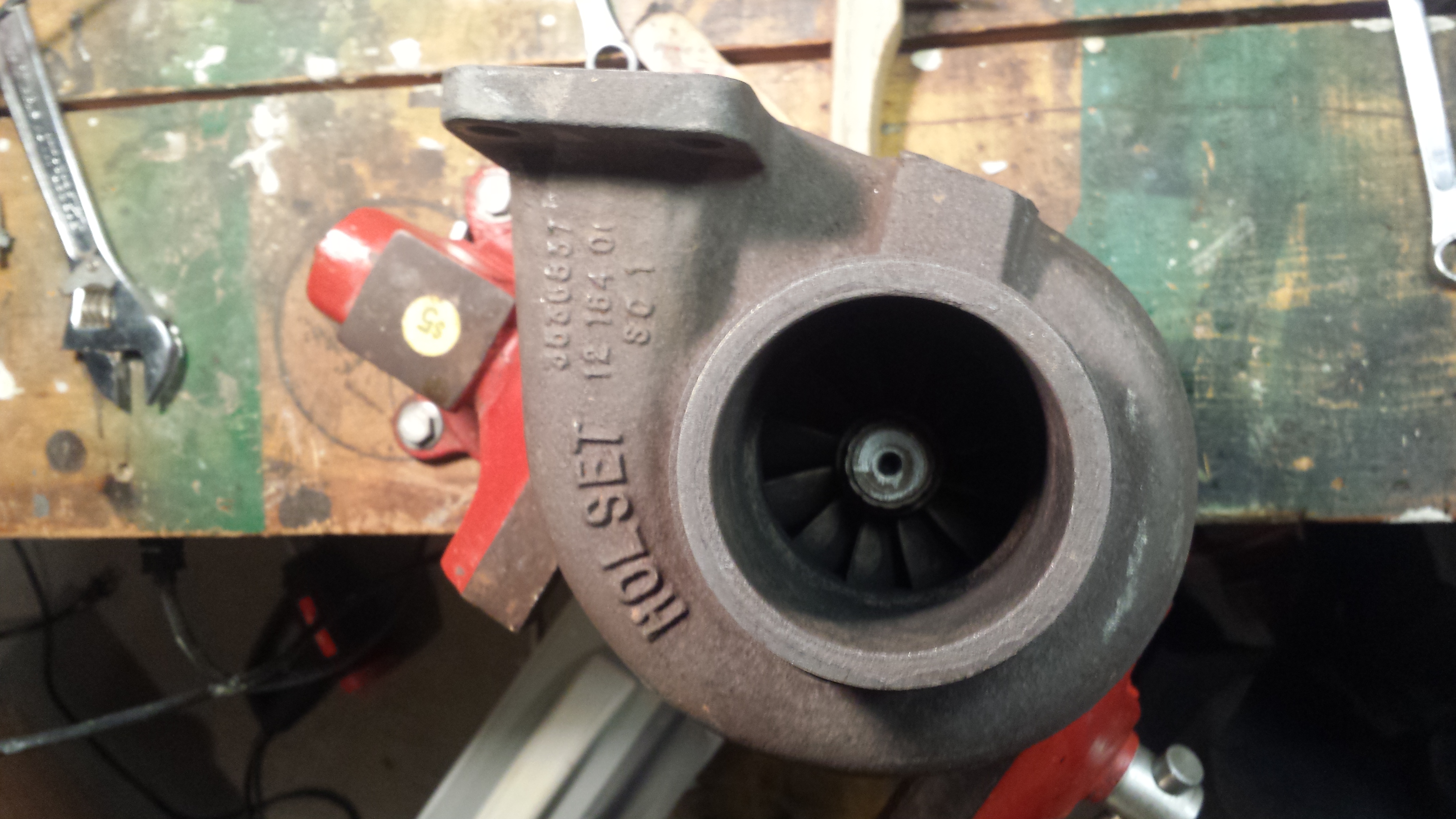

Jesus Christ it took 2 or 3 hrs with the heat gun and torch to free this bastard. Oh and a week of trying
For the curious few:

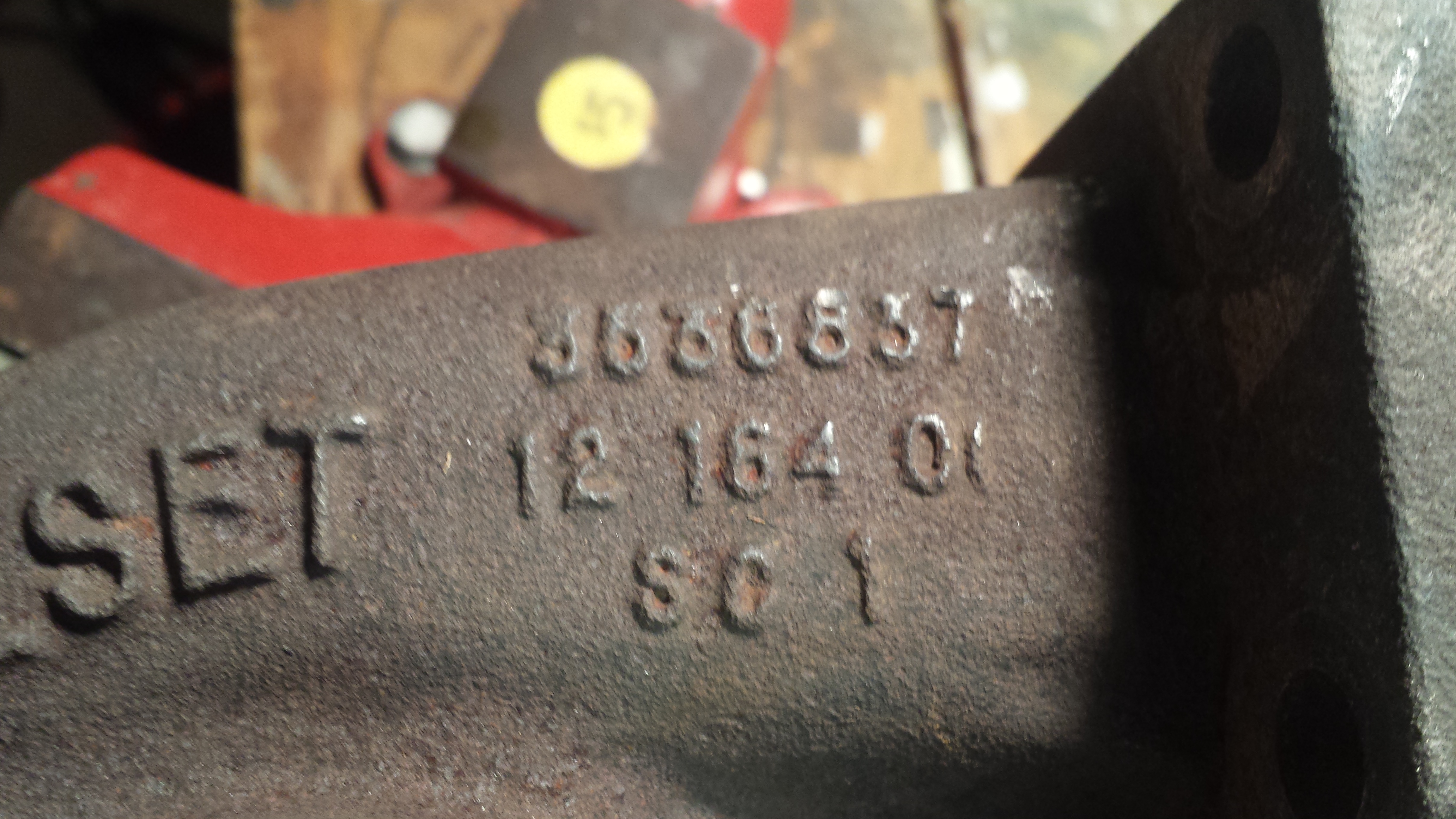

Hotside reads... dam I can't even read it lol
Posted: Sun Feb 21, 2016 9:35 am
Look inside the volutes to verify the hotside size.
Posted: Sun Feb 21, 2016 12:08 pm
by 88a5tq
:thumbsup: Found early on that it reads a 12

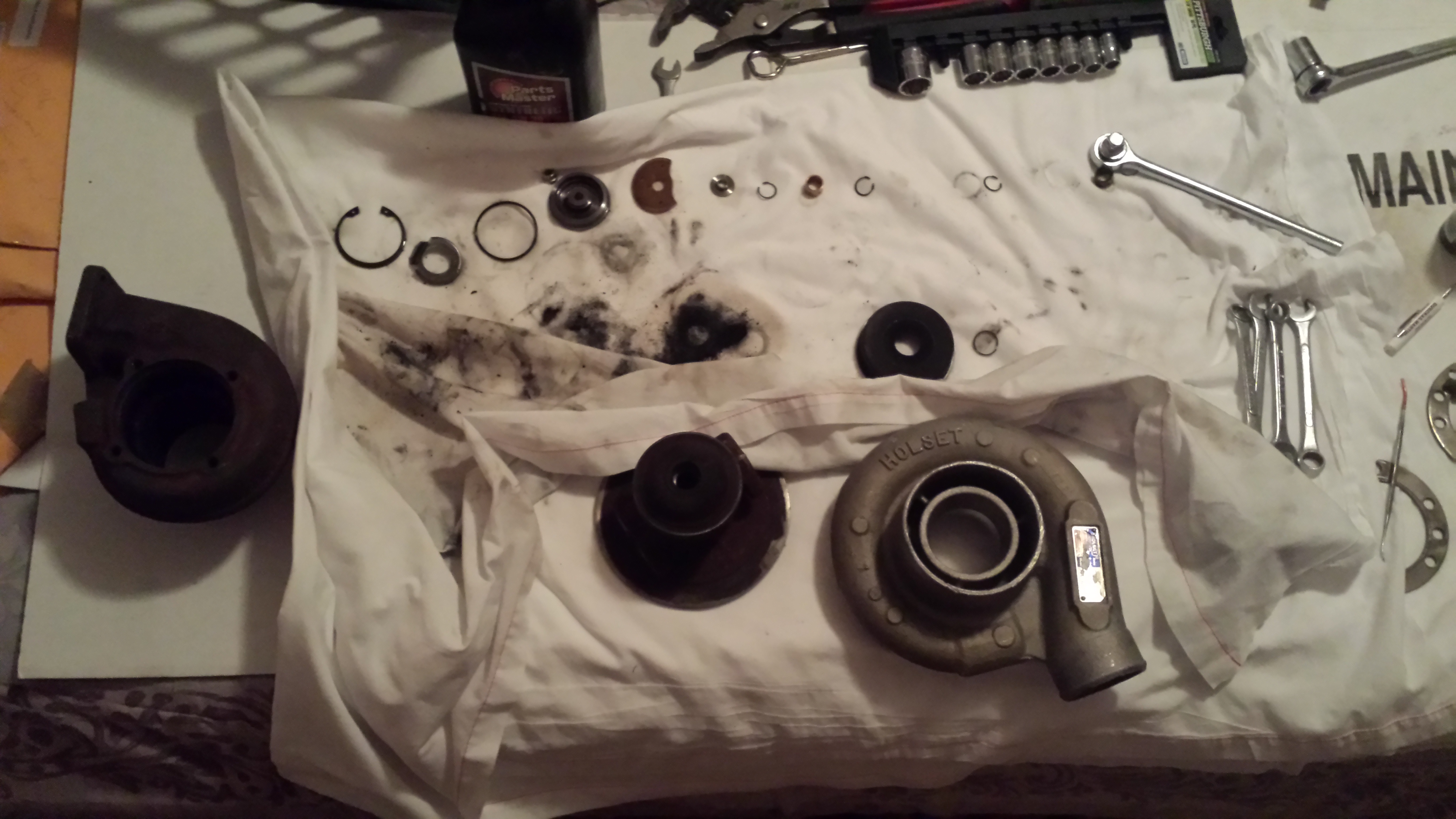

Best thing to soak chra and rest of stuff in before rebuilding? Don't want to use diesel because of the residue it leaves after
Posted: Sun Feb 21, 2016 5:27 pm
Is it coked up in there?
Posted: Sun Feb 21, 2016 8:56 pm
by 88a5tq
The look of it all didn't look extra-ordinary. I just cleaned everything up gently with carb and foaming cleaner. Everything looked in good shape overall. I'll begin the rebuild tomorrow using engine assembly lube
Posted: Sun Feb 21, 2016 10:08 pm
by 88a5tq
:geek:

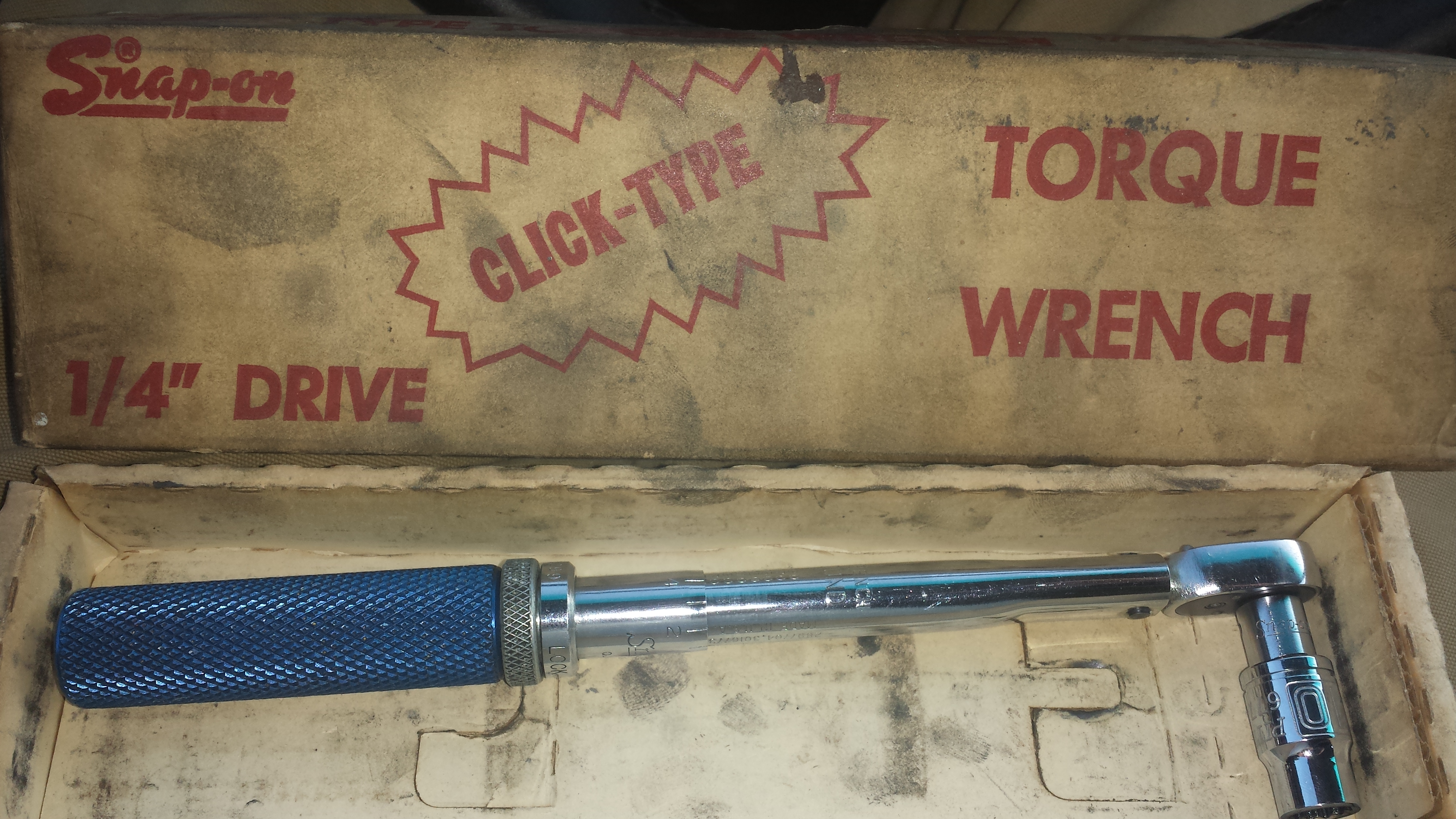

Borrowed this really dope snap-on from waaaaaay back. Really good friend coworker at the funeral home lol. Ooooh, blue anodized! This will do the trick :)
Its only fitting that I used this TW. Guy said he "set many a rack on the Cummins trucks with it."
Worked great for the job but I had to try like 6 times of torqueing the nut to get my initial marks aligned. I know they're all separately balanced pieces but I hate taking chances on things like this that take up many hours of my life from start to finish. Longevity was the starting goal and I could control that by doing the rebuild myself, if at all.
