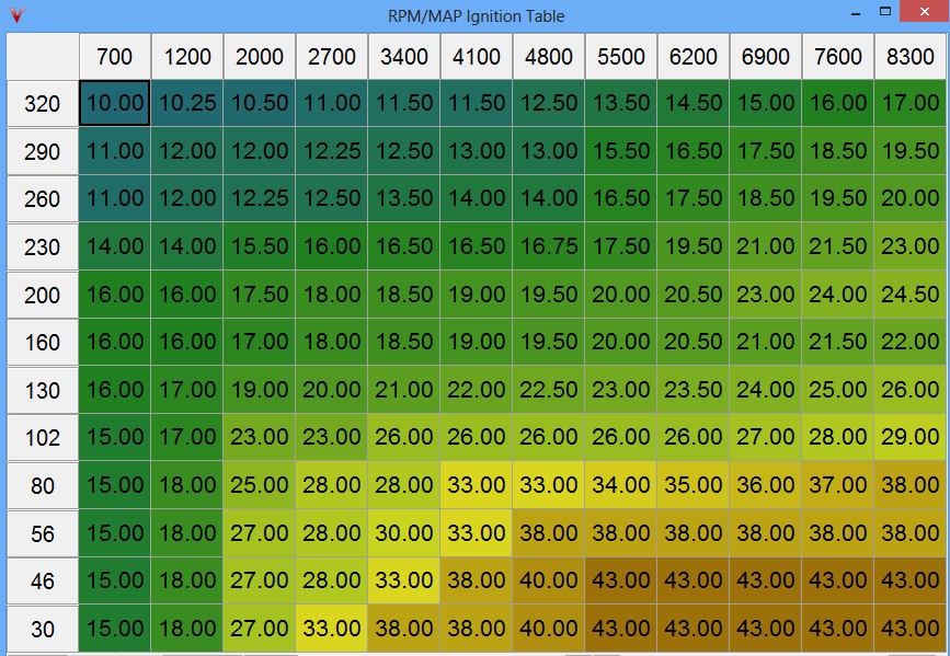

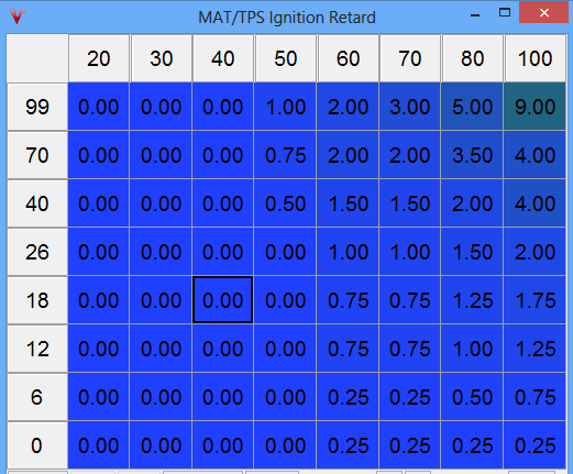

I'll post a screen of my timing map. It's NOT aggressive. Here's the thing.. my MAT IGN timing retard table was pulling 6+ degrees out. AND I had removed two degrees from Marc's base. So we upped the timing table four degrees and fixed the timing pull. This yielded an approximate 6-10* (depending where) increase in timing, which made the dyno go WOO WOOOO

Okay, timing map and mat ign retard tables:
new mat timing pull.PNG (25.99 KiB) Viewed 26063 times
new timing table.PNG (74.29 KiB) Viewed 26063 times
I need to email Marc about the MAT sensor discrepancy. I might try the 1.8t one that dad had in his car and see if it's any better. Also, from looking at the logs, MAT was 73 on the dyno, and 53 on the street. Need more fans Brady! :D

You can fill in the 160kpa timing at high RPM if you wish...
Re: more fans :D , if the intercooler and intake were always cool or not hot to the touch, then WTF? 73C should be pretty warm.
I think we were on the right track that there is a sensor calibration curve issue (or maybe sensor ground).
