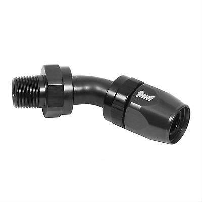

I'm eying the -12 AN option but I think I'd have to use the summit 1/2" npt to -12 AN 45° fitting at each flange. I don't think I'll fit a straight fitting anywhere for that as you said Chris. Of course I forgot about the -3 AN restrictor idea when I got the feed line stuff lol. Now I'm trying to make good on it. Can I pull off the 45° angles at both ends of the drain line if it's a -12 AN line?
Connector in question:
$_1 (1).JPG (8.07 KiB) Viewed 30254 times
I pulled the trigger on the parts to try it out

Before I respond in detail, I need to slap you if you bought summit fittings.
loxxrider wrote:Before I respond in detail, I need to slap you if you bought summit fittings.
Ive learned the hard way to use good fittings.
Exactly :thumbsup:

summit fittings=LOL. They snap very easily.
I just used a bunch of vibrant fittings to build the oil lines for my TDI holset car and found them to be good quality. The price was only marginally more than summit fittings.
Not only that, they don't seal well because the taper is wrong or out of spec.

I literally messaged Summit Racing on eBay and told them I heard terrible things about their fittings and wanted to know if they would penalize me for cancelling the order :rofl:
No answer yet but I did buy the Vibrant fittings and they do look beefier at a glance

one thing about summit is their customer service is very very good. I ordered a shitload of vibrant fittings, opened all the boxes, test fitted a bunch, picked the ones I liked best and sent the rest back. All orders come with a return sheet and pre-paid label IN THE BOX. You just check next to the part numbers you want to send back, put them back in the box, and drop it at the post office. No questions asked. Awesome.
Wow that's not something other places can say they do. At least they hassle over this (hopefully). I paid $29.** shipped for each one frim Vibrant. I do think I got boned on shipping for buying 2 of course. Dark forces at work when there's free shipping

I ran a number of summit fittings and lines and never had an issue, the hose ends actually assembled better than the Earls I have on my B6 now. I think it's a step above ebay fittings. Having said that I did go for Earls this time around...
For the oil feed, look at pre assembled brake line, I have 2 sections with a male/male coupler, I think you can get them in -3 in addition to -4 and they're cheaper than buying fittings and hose, although length is a bit less custom.
Thanks Shawn, glad to hear someone had success using them. I'll just return to sender when they arrive after the wallet bomb that the vibrant ones have become.

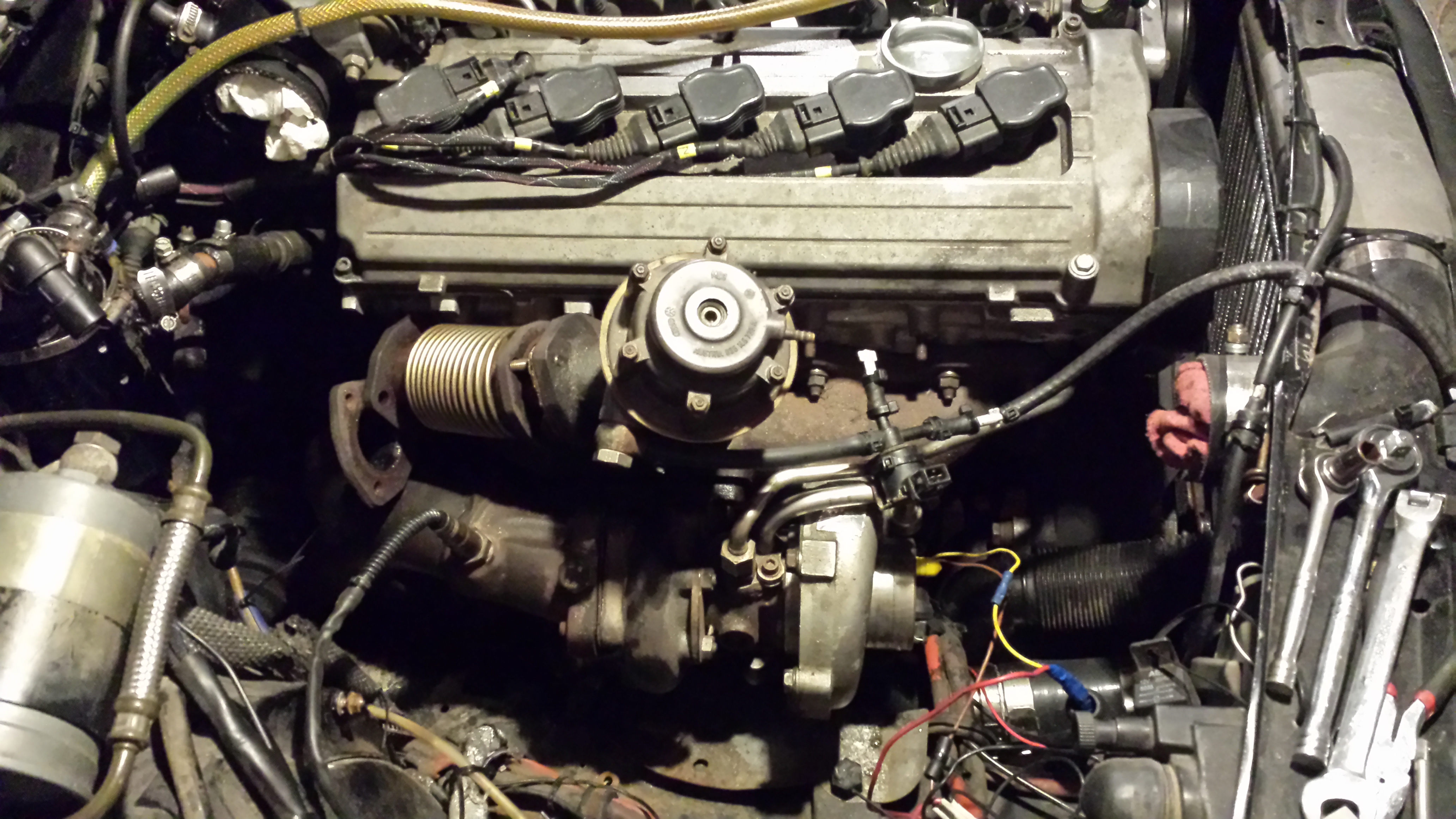

Got a good start tonight kinda
Also a nod to Dave as the hybrid has absolutely zero play still. Even after the 100% DC beating it gets daily

As I'm waiting on parts I'm starting to break free the bolts for the turbo drain line flanges ar the block. Got the coolant one fine but the oil one us killing me. I had to drill a small hole in the flange leading to the bolt thread to spray PB into and that's where I've stopped. Nothing has rounded out yet but I'm feeling confident about the he head holding. I'd rather have a bolt on there. I have vise grips on it right now. It better come out one way or another!
Uber progress made. Everything is ready for installation. Coolant system has been sealed and filled and my female 1/2" npt oil flanged are going on tomorrow for when the oil drain line pieces arrive. Getting happy pants here
