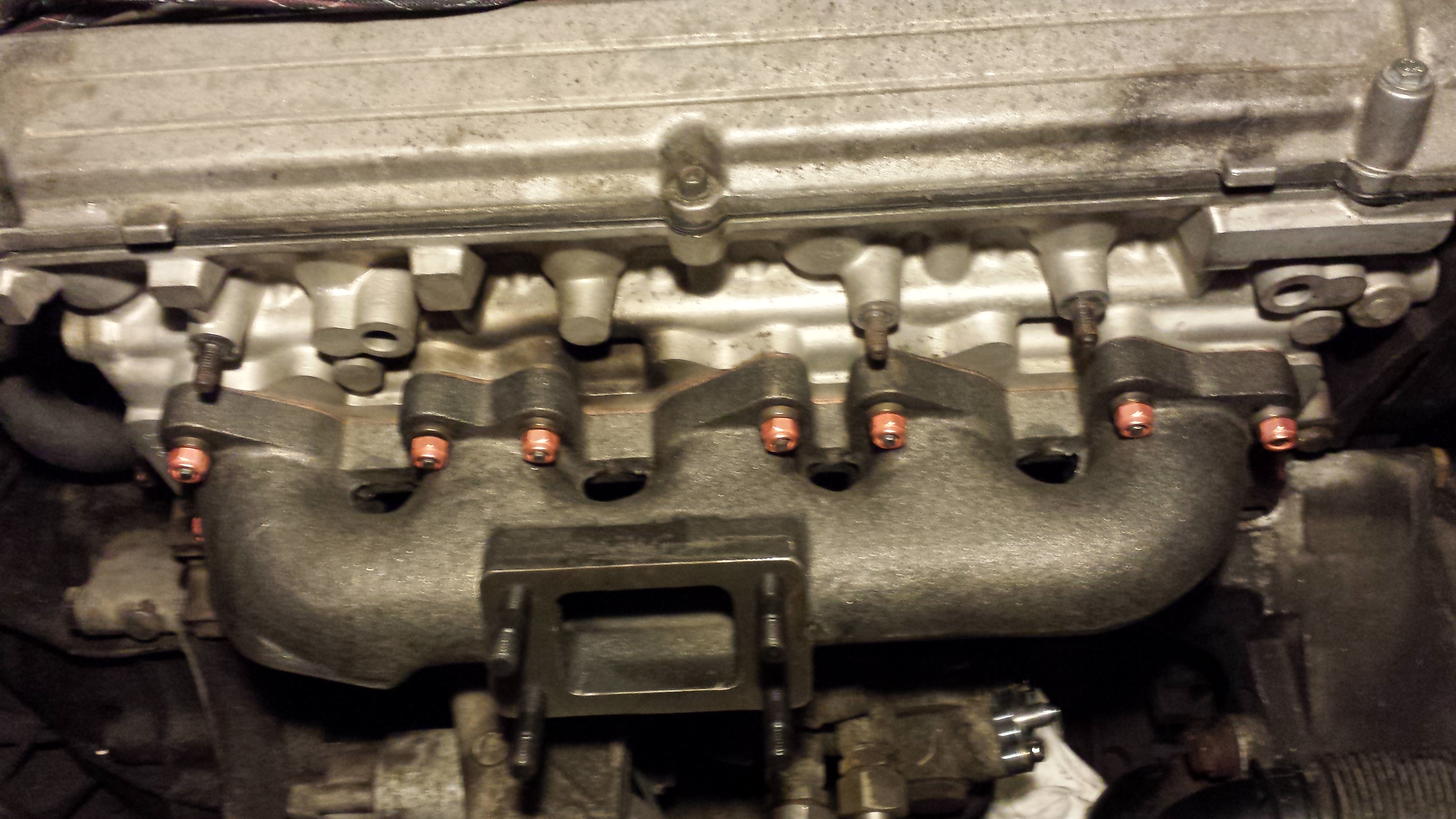

Love showing off my nuts
Being held up by the vibrant fittings and a 90° oil feed line elbow for the 034 flange. Pretty much all the F*ingUSPS's fault. Can't stand them. They never fail to disappoint out here in PA. Hope none of you work for them.

Haha alright man. How's the access to your nuts been? I just bought a snap on special wrench to see if it'll make mine easier to get to on the avant.
Posted: Sat Mar 05, 2016 6:15 pm
by 88a5tq
I must say it's been much easier on this manifold. Removal of the stock and ebay ones made me thing the studs were a cruel german joke on enthusiasts ;) they're going on well this time tho. Still slow but less shame involved hah

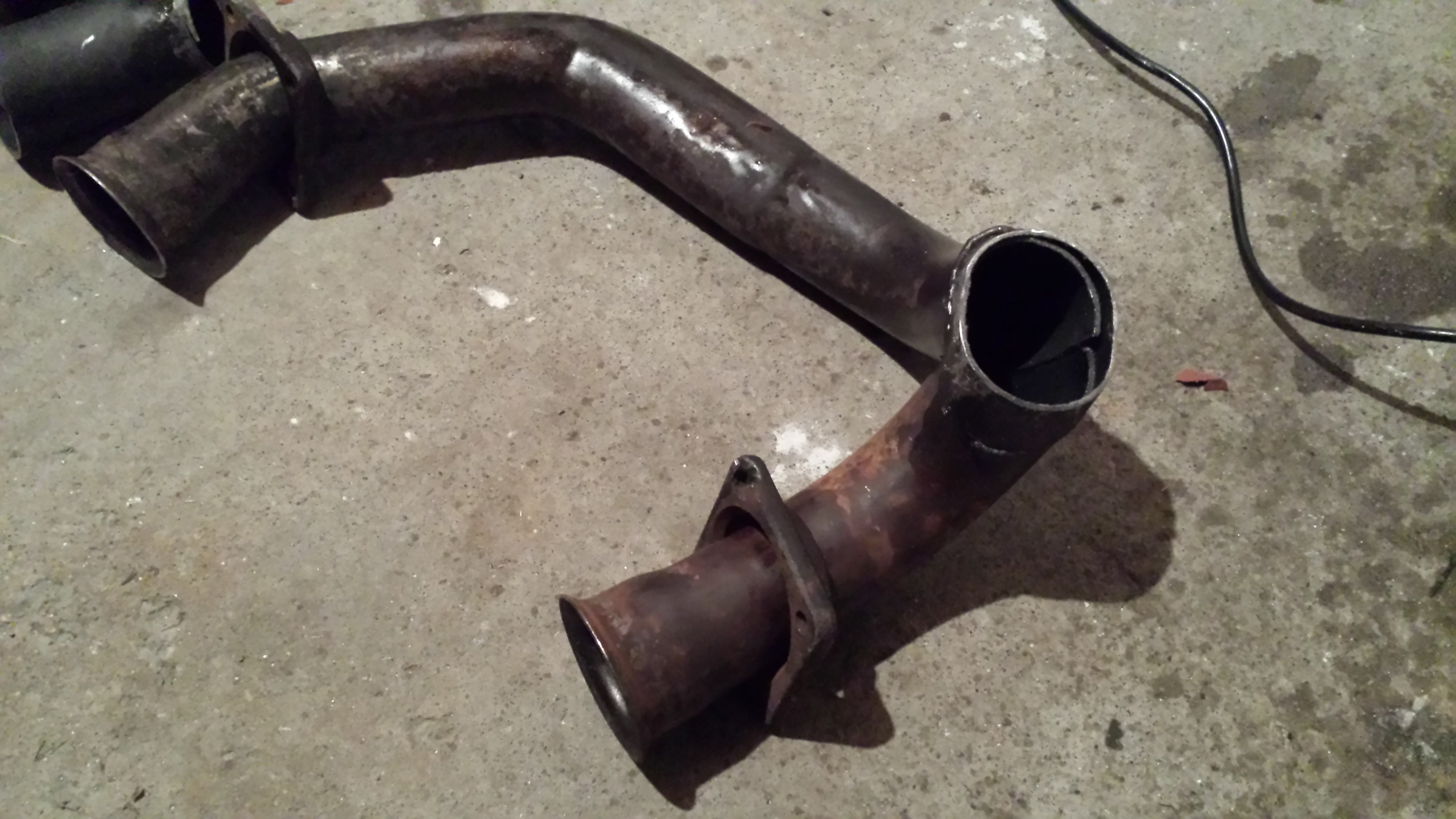

Some bitching scored me a free elbow via priority mail. Still getting boned by the welder tho. This OD is about 3.1" by taking C/Pi. Measure 9.75" around right above the weld so I'm going to take a shot at welding a 3" pipe to this for the DP. 3" v banded DP to stock dual 2.5" should be fiine.. Besides I love my exhaust from that point back lol. No more bottle-necked upper DP :wtf:
My "plan" is to crimp the 3" pipe around that area at the welds or butt weld it I guess.

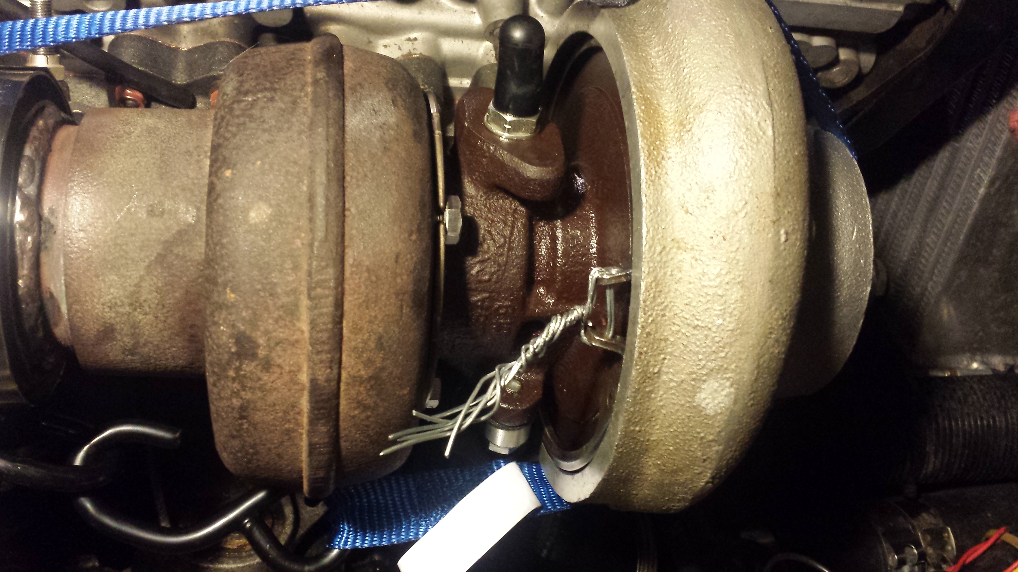

Got my AN12 drain run in one shot. It was the worst trying to thread that npt fitting with the turbo in place tho. Don't wish to do ever again hah. Just have to put intake together and prime the turbo feed line and BOOM

WhaAAAAAAAAAAAT THA FECKK!
