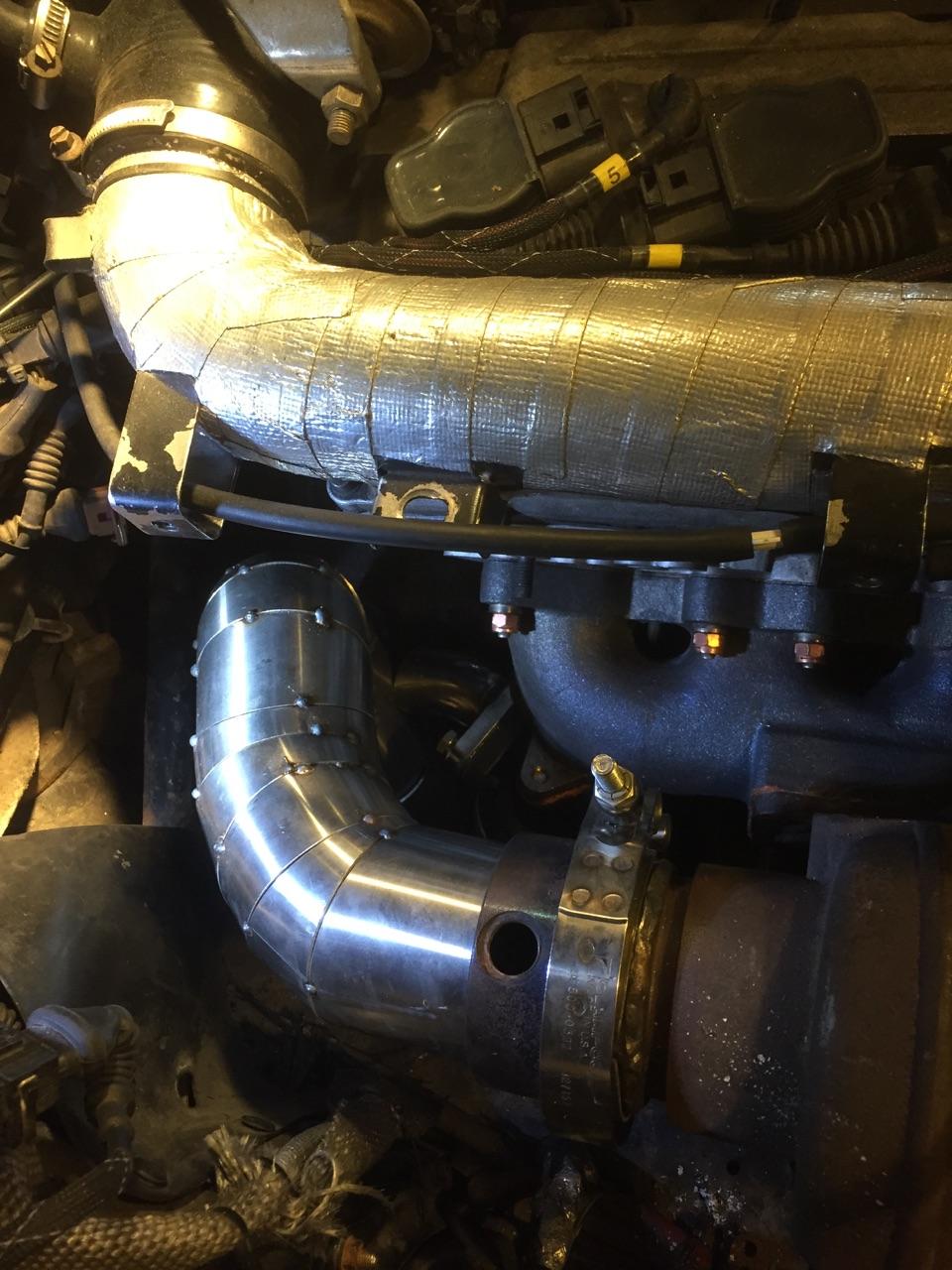

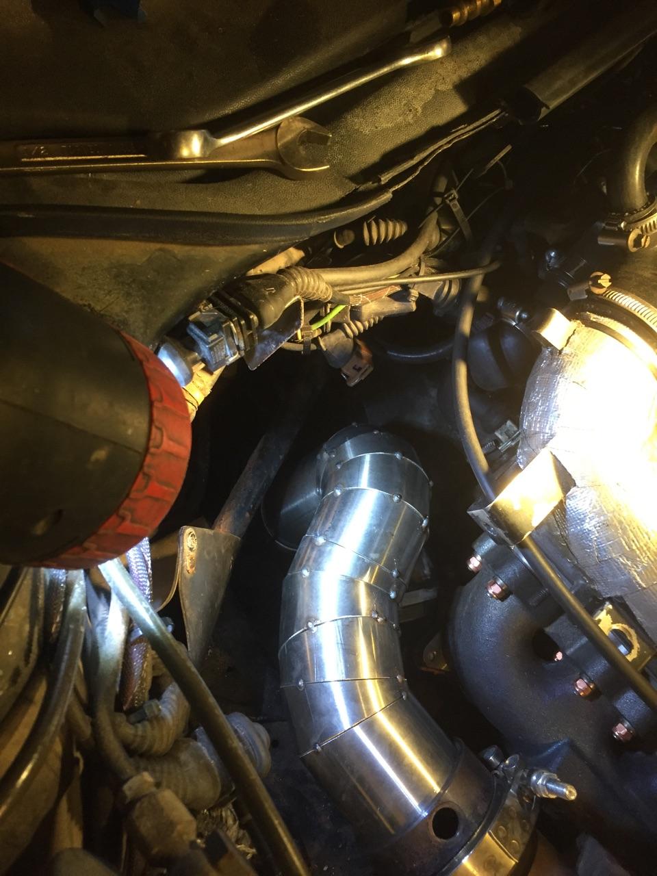

Goes in to welder on wednesday. I wish I was welding the whole thing but I'm leaving the y pipe, and sleave I bought, unwelded in the event that it helps them fit everything together in the end.

I grabbed the car away from the slow welder since he omitted info that he'd be down 2 mechanics over the next week so my DP would take forever to even get to. I took it to a pro being laid off from GE out here who will have it done by the weekend. No mandrel bending either. All angular cutting/splicing :) He will tie the WG exit back in as well.

Here's a preview. Might be done tonight even :)
Who's this guy think he is, ashing on my turbo?!
lol that's a lot of damned welding!
Well... I'd say this is a lot of welding:
Courtesy of the shop I want to do my exhaust when I get the Coupé going, Unobtanium Welding.
(Not to say I'm going to go full retard and get titanium. Yet.)
Yes I know, and will pay dearly for this :( It was my request though. I said "no mandrel bends"
Now I won't want to wrap it!
Lol holy sh!t that's much "worse" than mine!
