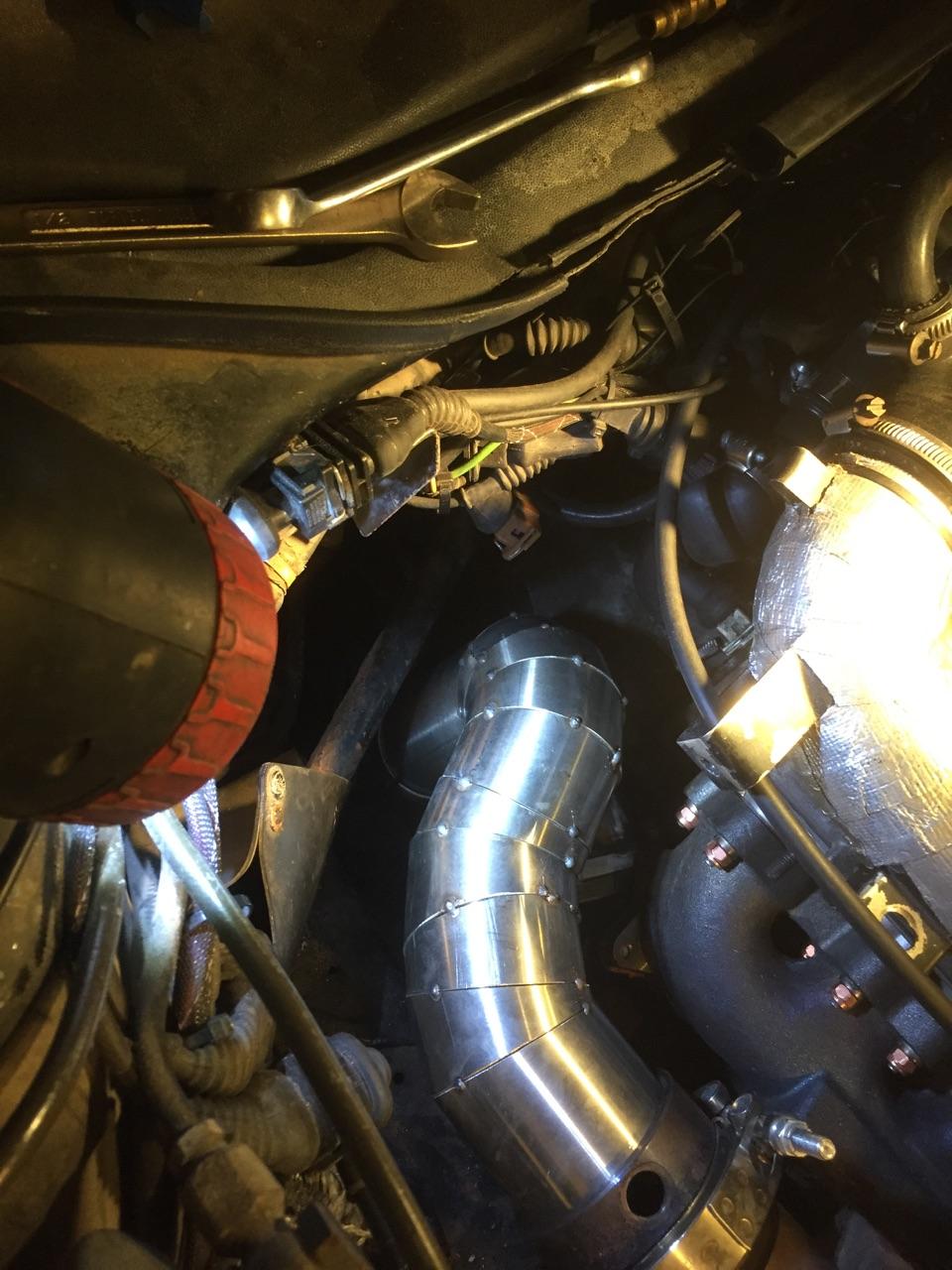

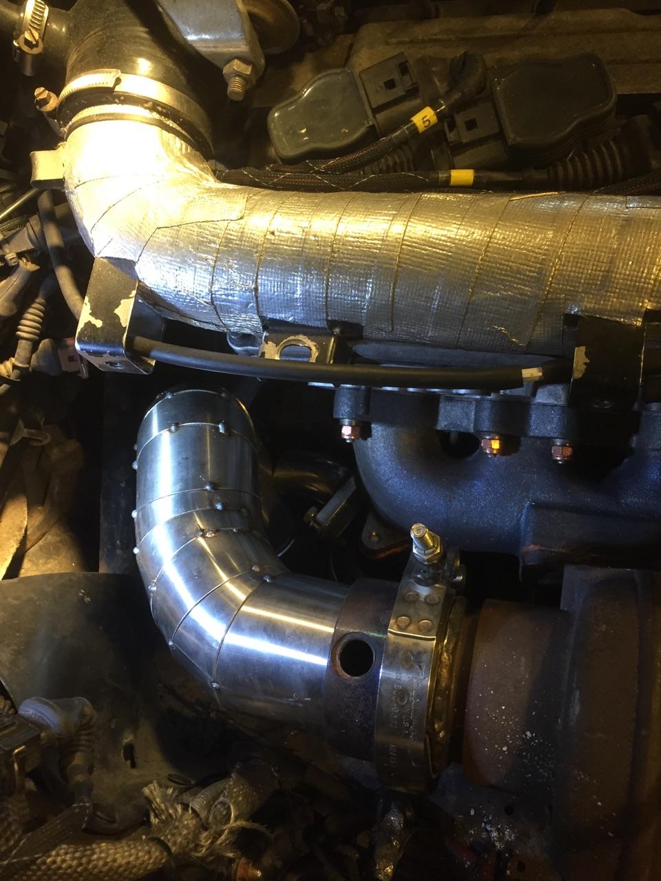

Posted: Fri Mar 18, 2016 3:44 pm
by 88a5tq
Who's this guy think he is, ashing on my turbo?!
Posted: Fri Mar 18, 2016 3:46 pm
lol that's a lot of damned welding!
Posted: Fri Mar 18, 2016 3:53 pm
Well... I'd say this is a lot of welding:
Courtesy of the shop I want to do my exhaust when I get the Coupé going, Unobtanium Welding.
(Not to say I'm going to go full retard and get titanium. Yet.)
Posted: Fri Mar 18, 2016 3:55 pm
by 88a5tq
Yes I know, and will pay dearly for this :( It was my request though. I said "no mandrel bends"
Now I won't want to wrap it!
Lol holy sh!t that's much "worse" than mine!
