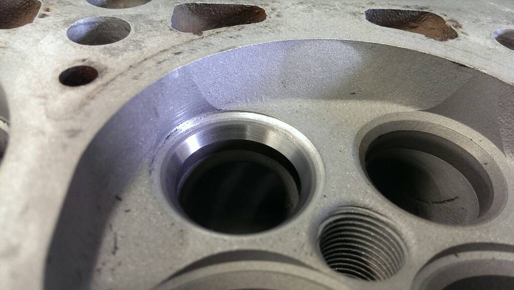

Well, as usual with any build, a hurdle has risen... The machine shop cutting the seats calls me in to have a visual inspection of what he's encountered with the head.
I prescribed cutting the OE valve seats to accommodate larger valves. They go ahead with one exhaust seat and finds that our seats are the same size as the valves and when cut the valve itself doesn't rest on the seat but protrudes into the aluminum portion around the seat as well.
Is this normal? Usually seats are larger than valves and allow for cutting but it doesn't seem like the case on our AAN heads... If I need to reseat the head, I'll just slap my old head on it and run a stock port as I'm not about to spend another grand on that...
Left has aluminum blurring the seat line, Right shows where that line should be

.5mm oversized? My valves went in with no issues like that, but they were only .5mm oversized.

Re: A tale of Rubí...PTE5862 .64 a/r Received, Head Rebuild
Yeah +.5mm
Yours went in without a recut?
Post by DuBistS4 »
No they were recut but everything fit correctly.

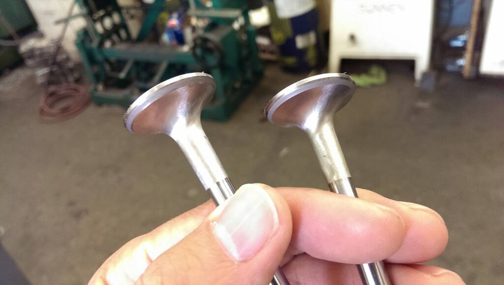

Popped these in...

Odd..I'll be using the same brand/size valves as yours..my head is also at the machine shop this week. I'll let you how it comes out.
