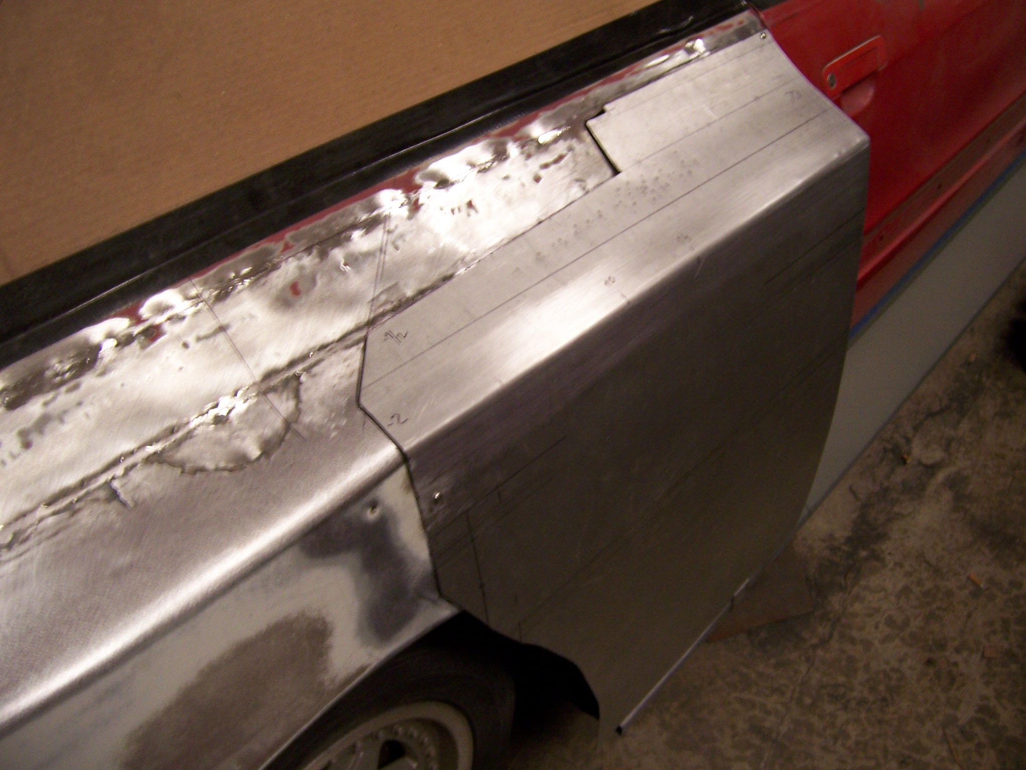

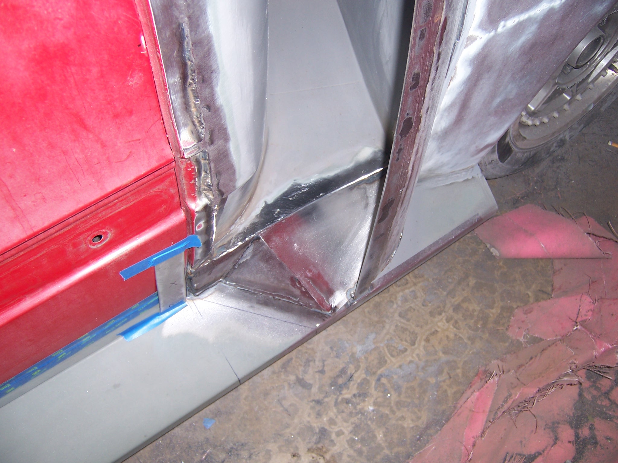

So the front of the Rad air intake needed a transition (see pic. above). Made one of these for each side. (Still needs to get cut flush with the rocker)

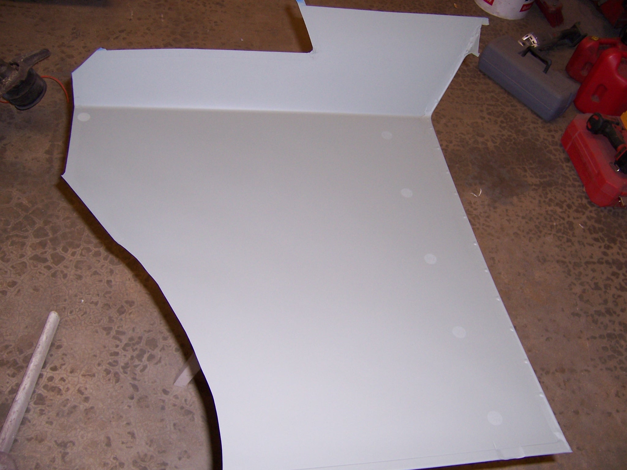

Side panel on pass. side cut and fit. Have to do the other side yet and then prime/paint and then weld the panels permanently.
Getting there......

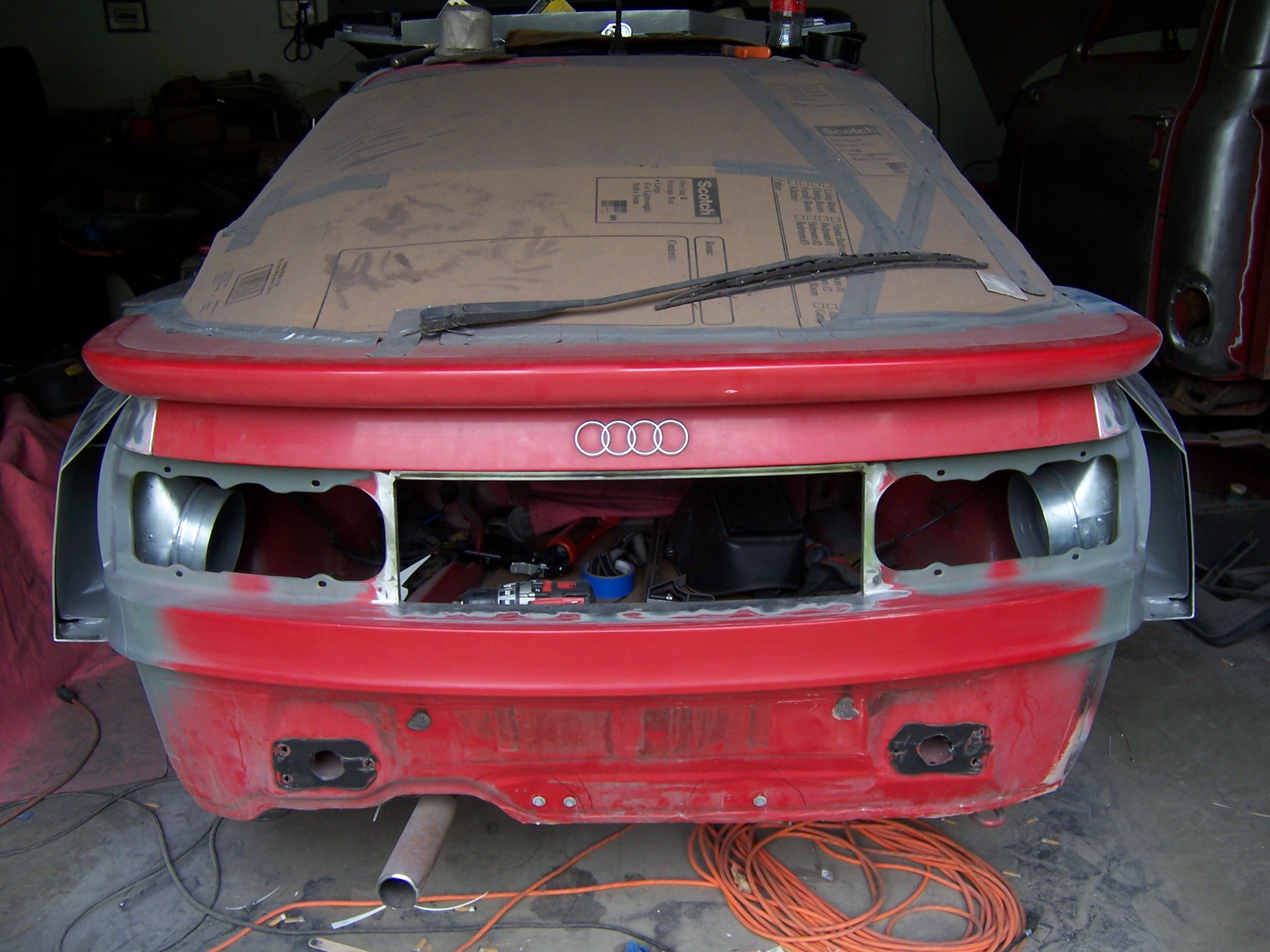

Thought you guys might like the new view.

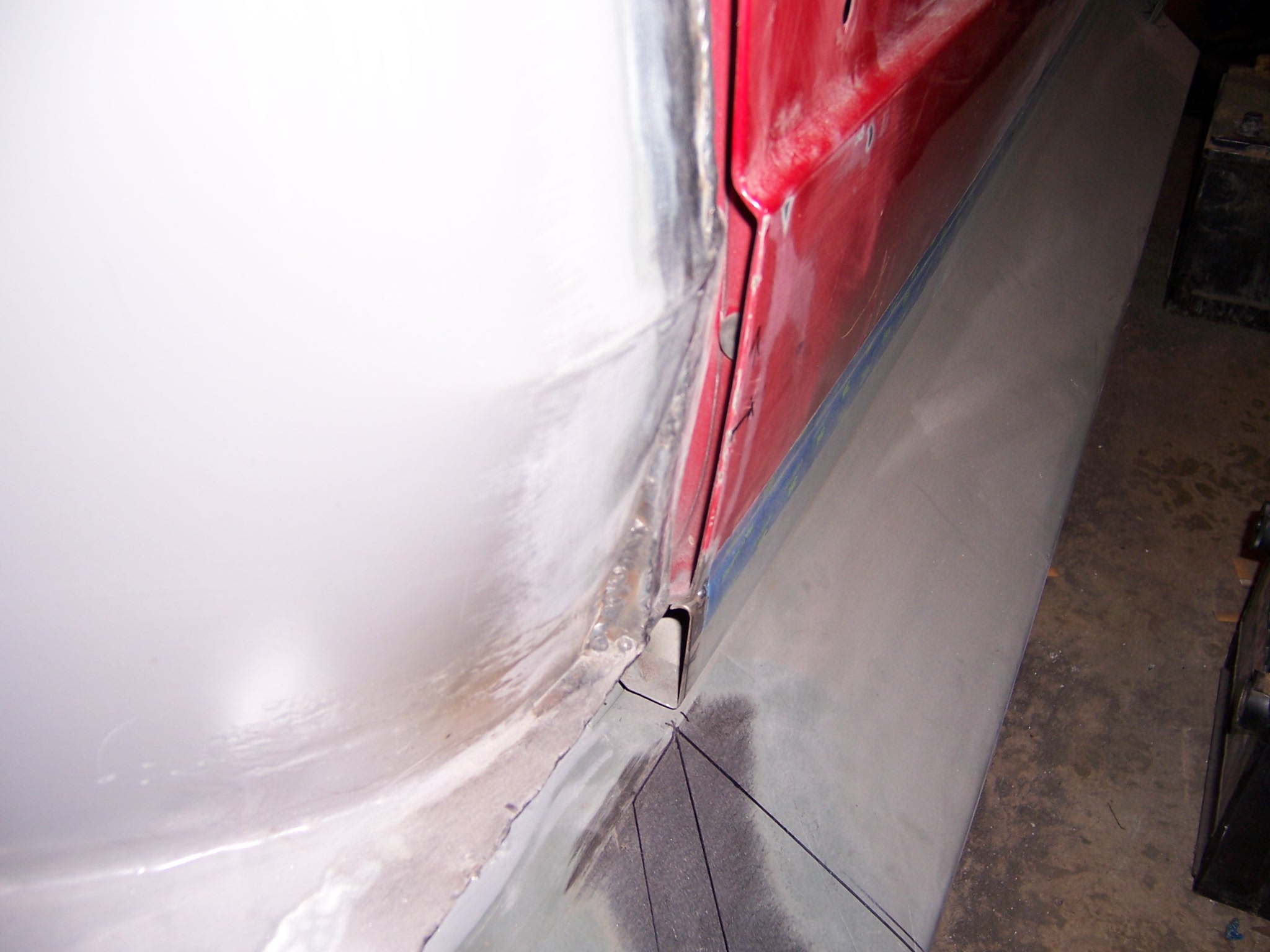

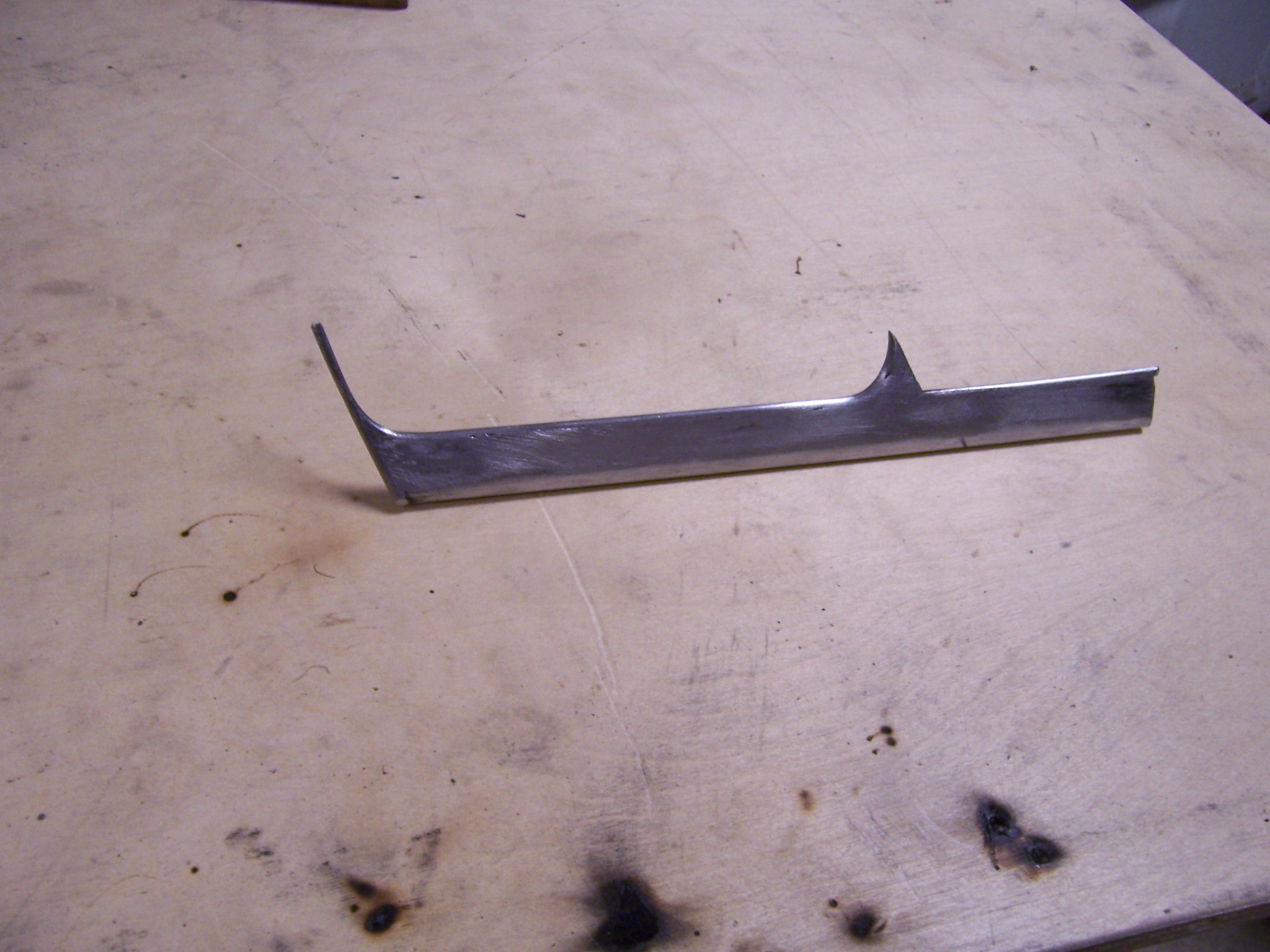

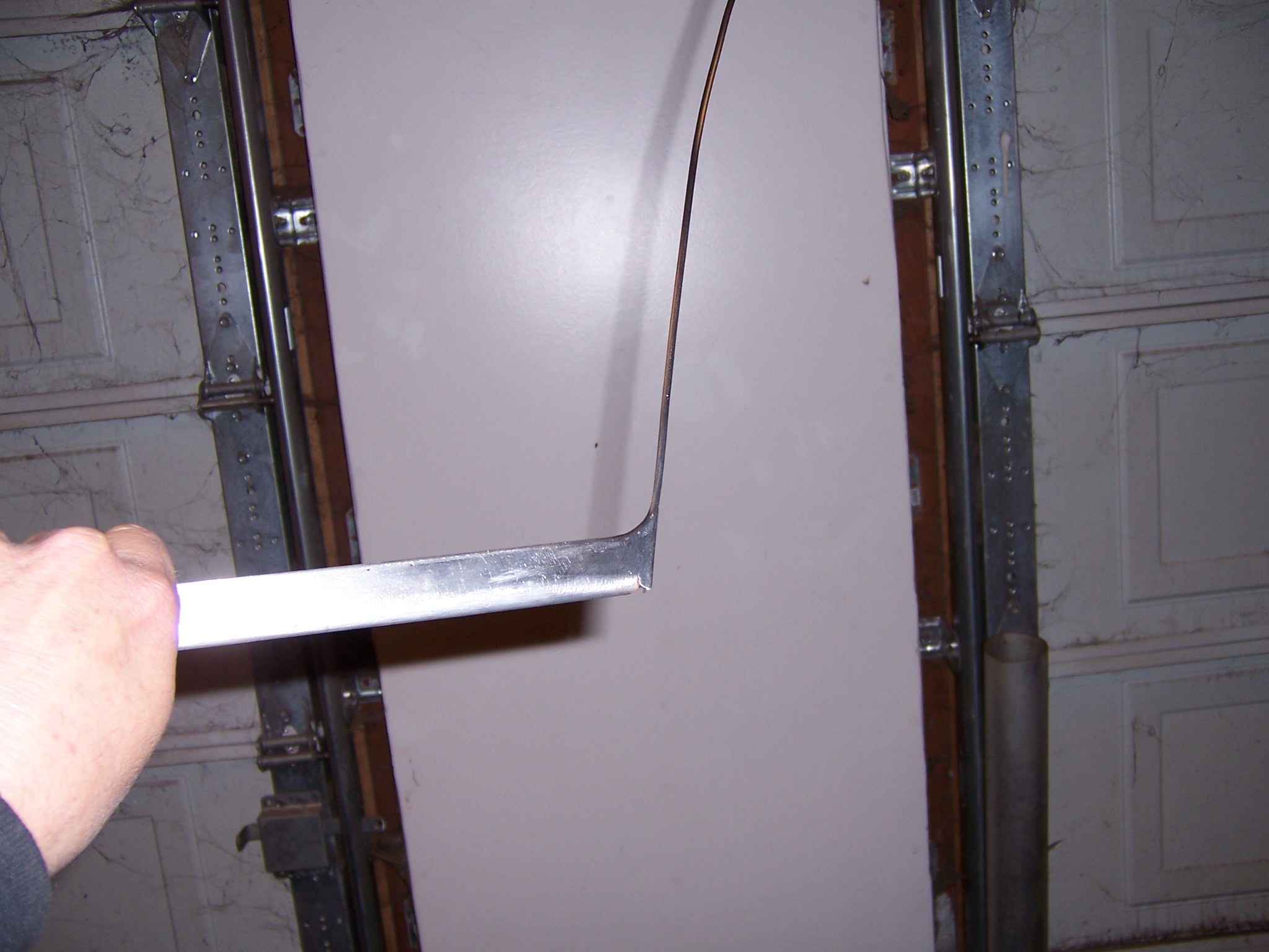

Bottom of Rad intake closure pieces are made and have radius on uphill side. Still need radius on downhill side. This piece is for the passenger side and the wire is longer than the other, as the pass. side was hit in that area and the wire reestablishes the body line.
Area that was hit. So one part was pushed in and the door edge was pushed out, that required some brutal hammer blows to straighten. You can see the area that needs a new bodyline.

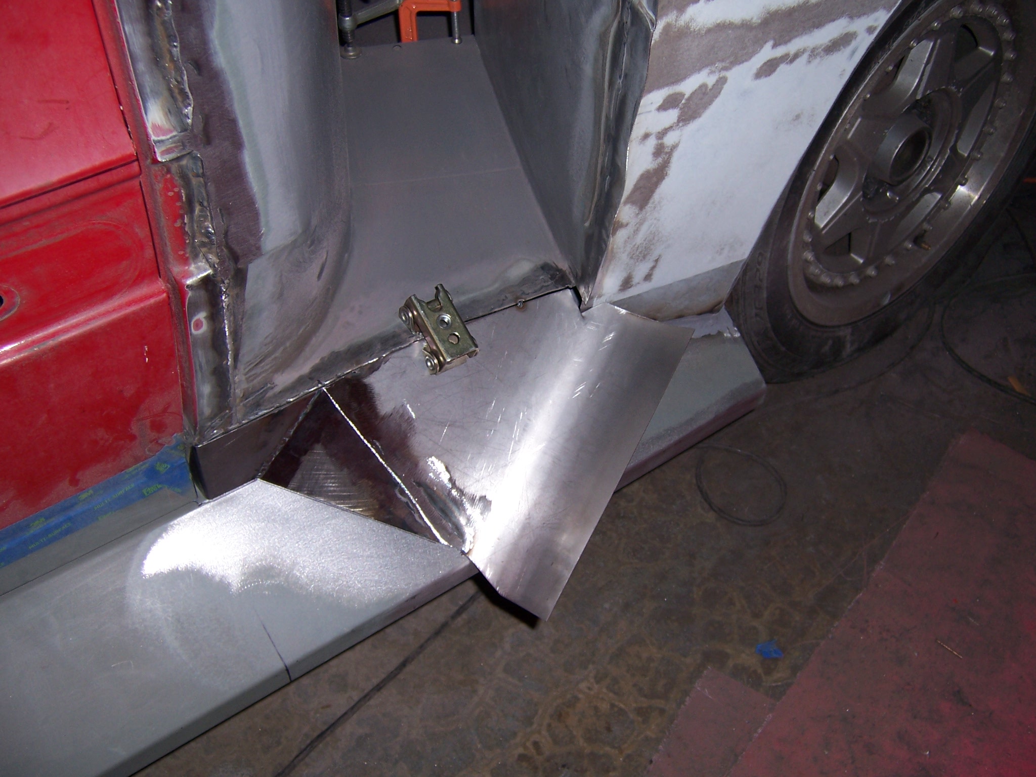

Other side mocked up. On this side the wire is quite a bit shorter as all the sheet metal meets nicely.
Still have two more transition pieces to make for the side of the Rad intake. Need to get those done before paint and final welding.

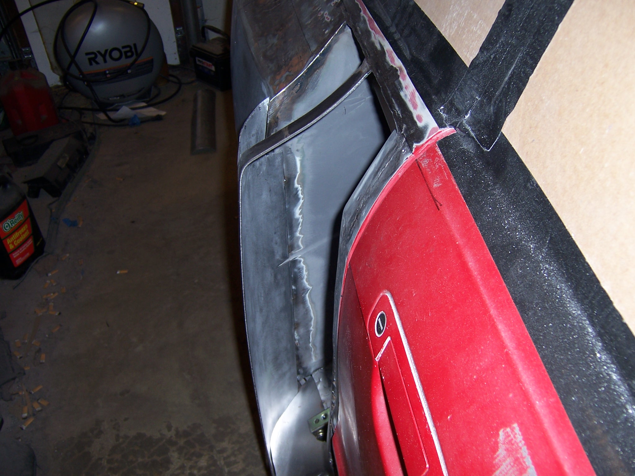

Both bottoms done, radius on each side
More detail work. Only got one side done so other side is next.

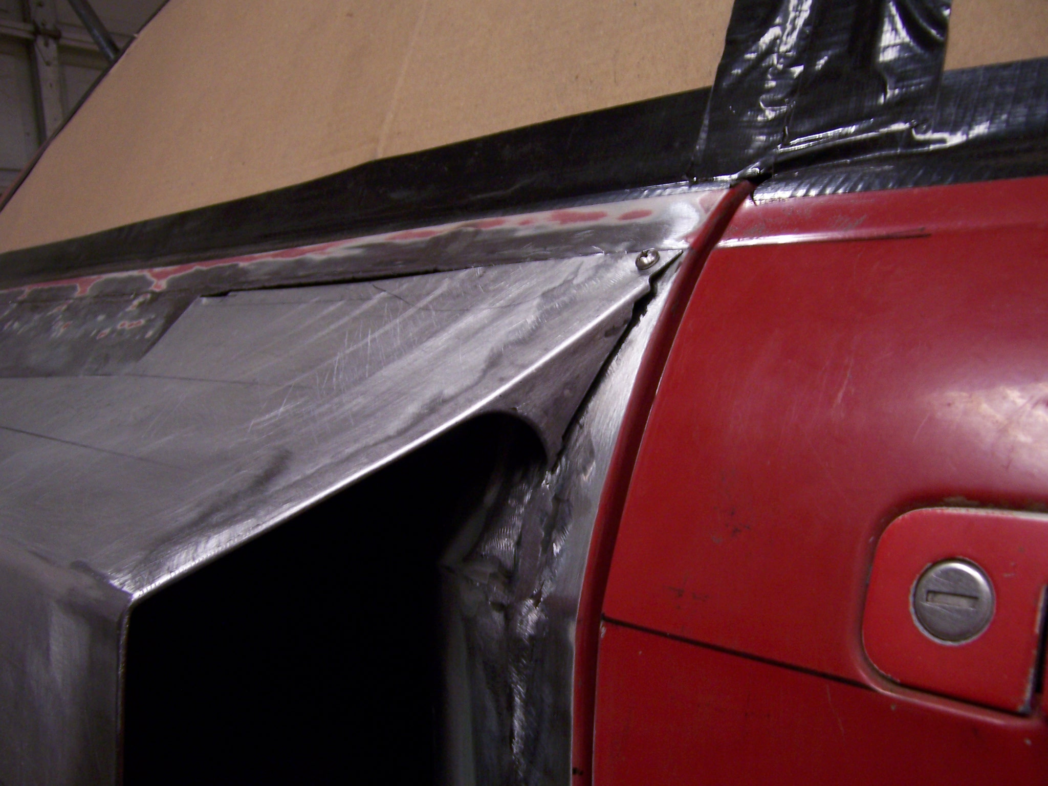

Incredible detail work, really draws everything together nicely.

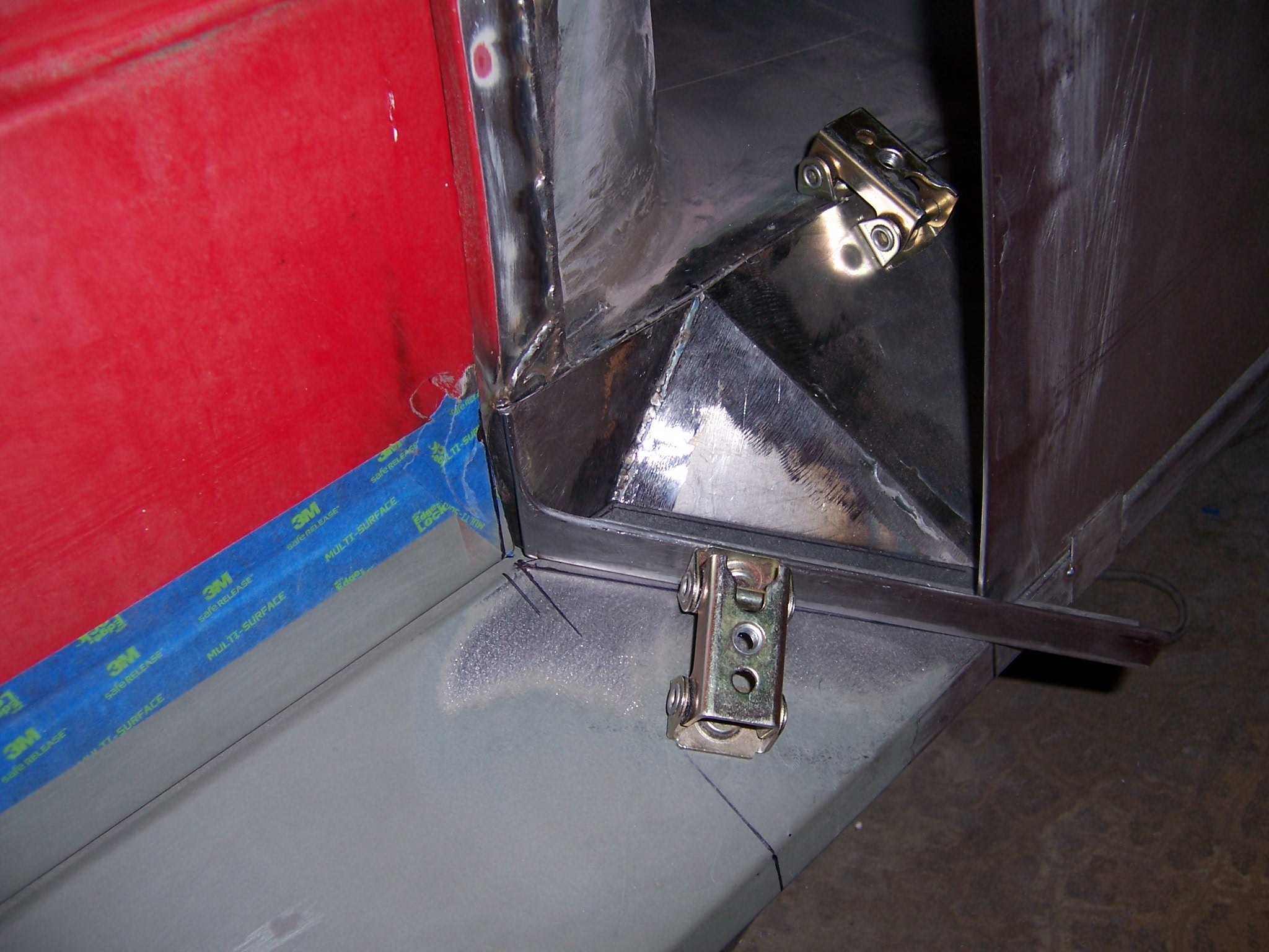

Curious about the screw in the last pic, the one that holds the panel onto the body. Is it just there to hold the seam in place while it gets welded?

@PRY4SNO: Yes screw just holds panel in place for alignment and welding and will go away once welding is done.

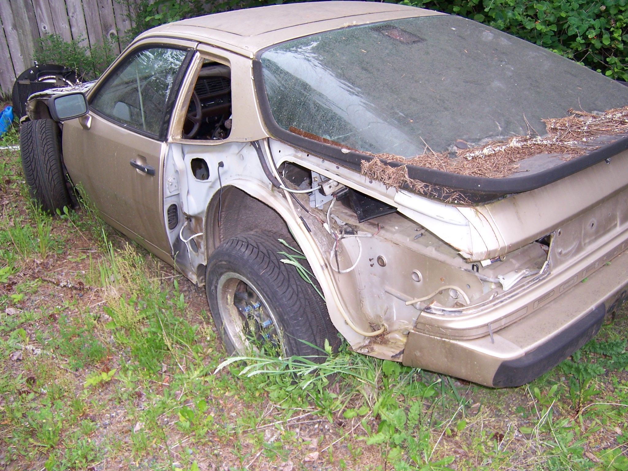

Car locks like this.
P.M. me if you want to take this on.

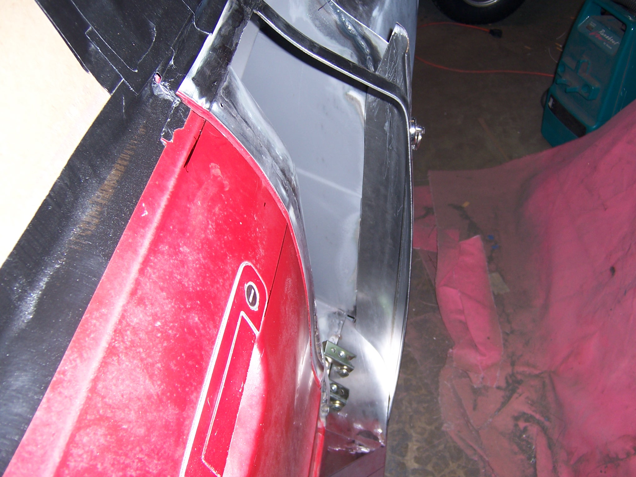

Driver side transition almost done
Almost painting time again. :guns:

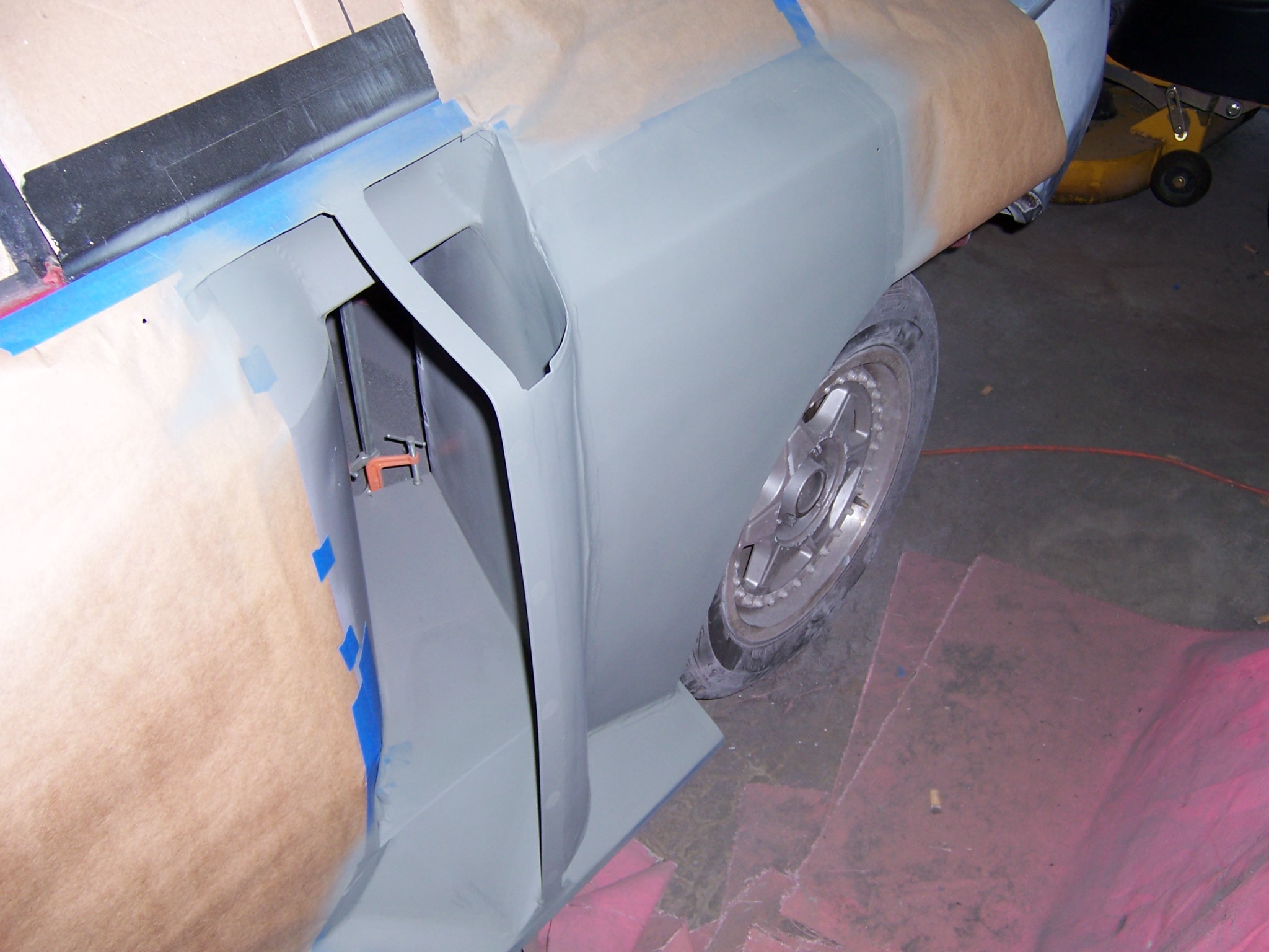

Got some painting done on areas that get covered with some of the parts I made and welded the side and bottom transitions to the car.
Driver side
Now all of that needs seam sealed, primed and painted.

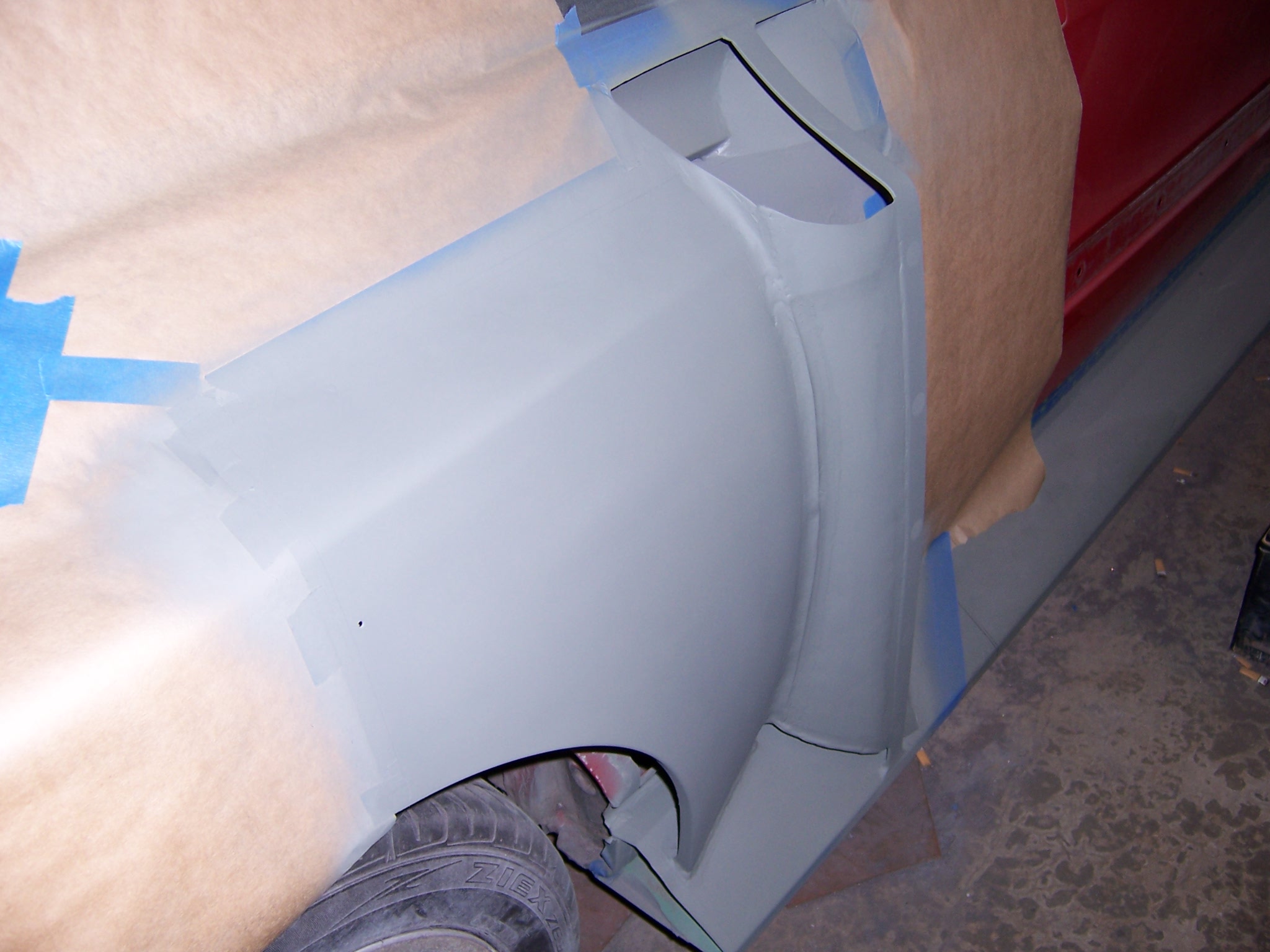

Here you go !
Car and side panels after 2 coat of primer and seam seal. 2 coats of paint to go.
Almost ready for welding to the car
