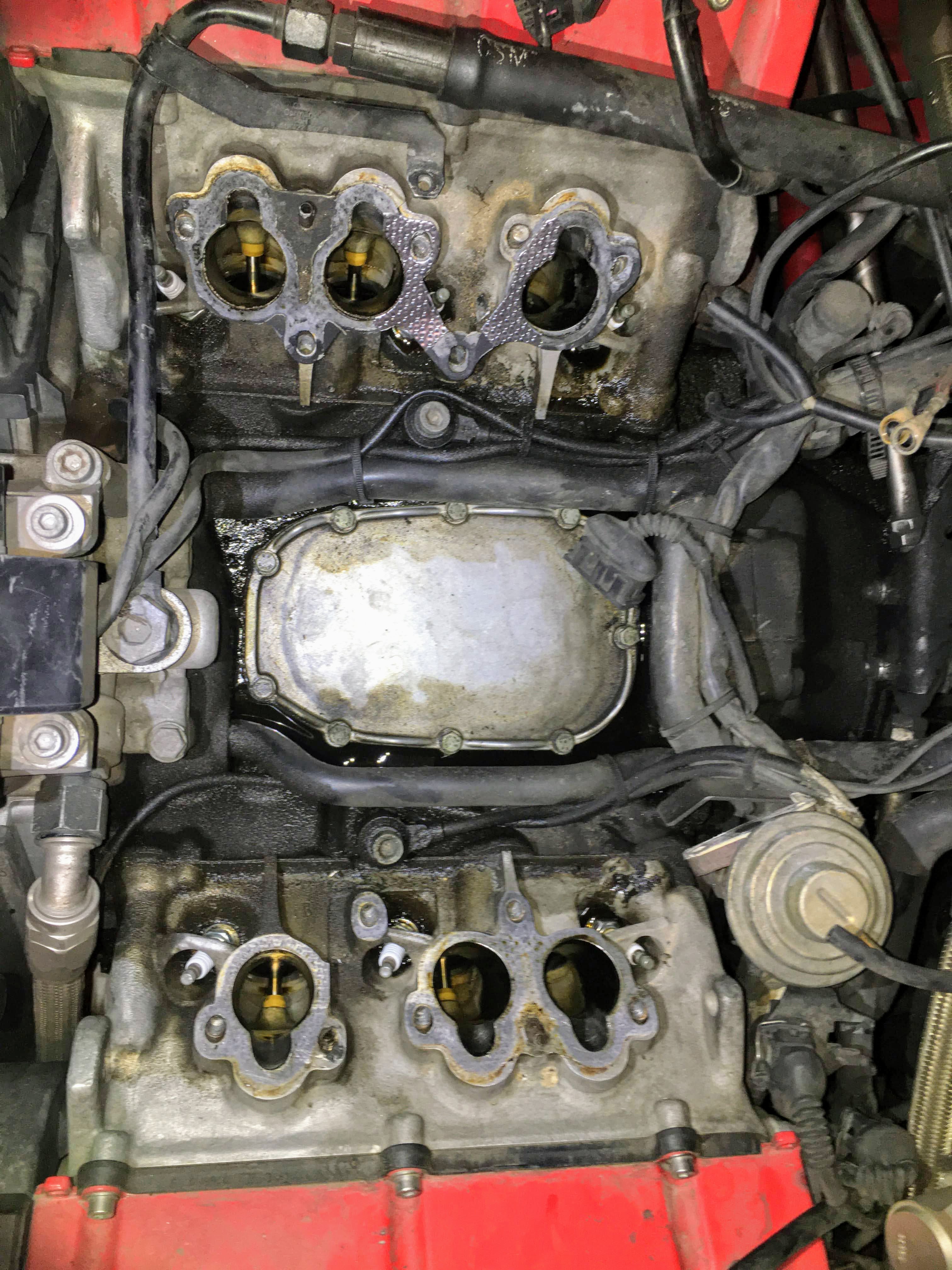

When I finally had to get ready I decided to pull the IM to inspect a persistent oil drip, ended up being a larger leak so I re-did the valley pan as it had been a few years.
Getting new gaskets took a bit so it was somewhat a push to get ready for the track and I didn't have much time to generally go over things (which I regret now). So, loaded up and leave for High Plains Raceway (HPR). After about a block, I realize something is off and pull over to find a very hot cat.

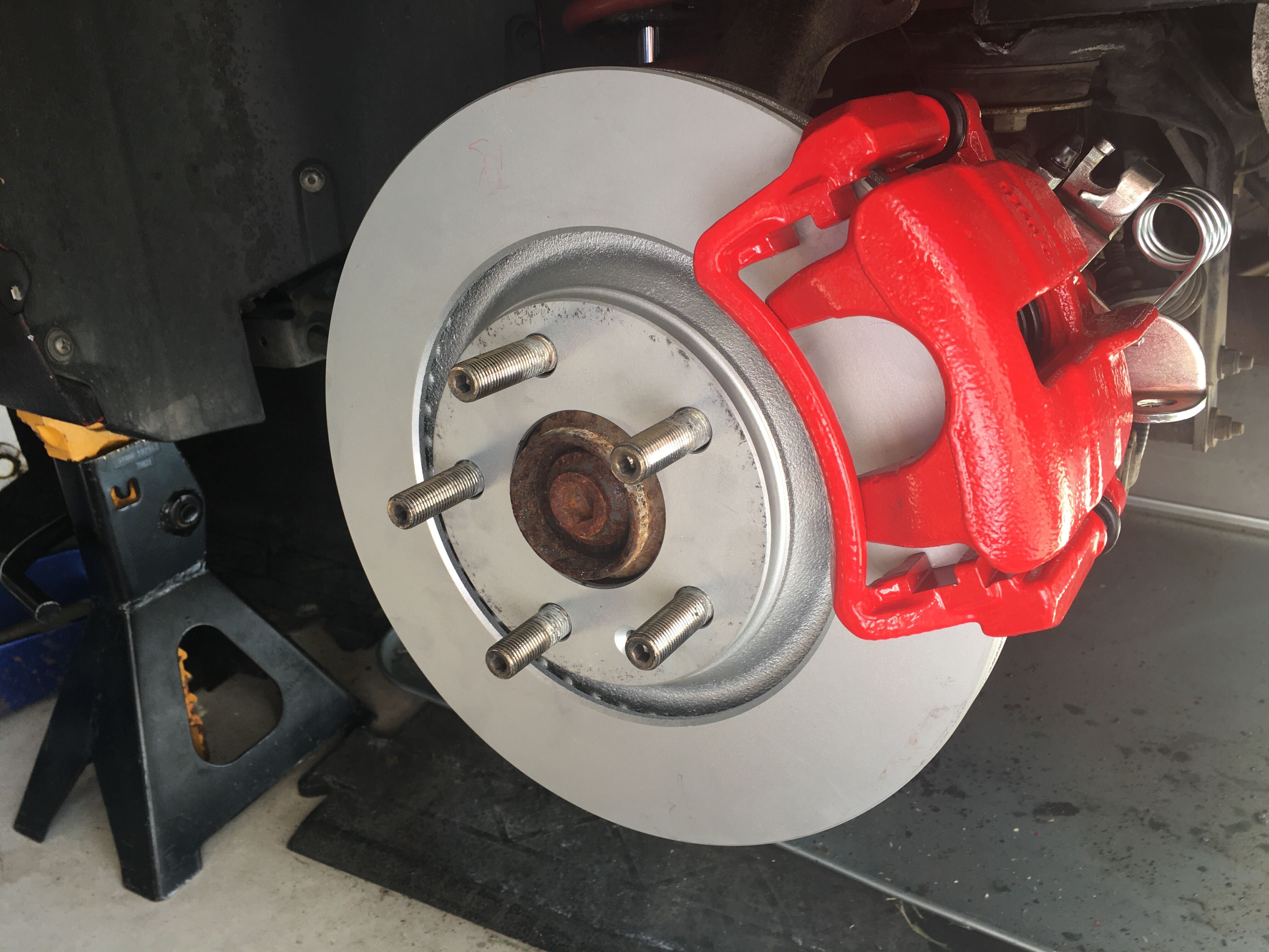

Here is a shot of the B5 rear, the issue is my S2 Sedan hub rotor mounting surface is closer to the caliper carrier than the B5. Given my experience with custom brackets, I'm leaning toward a no adapter solution and reselling the apikol kit. I already have the B6/7 rotors and the ECS rotors I have are close to end of life.
I did think about bolting the carrier to the inside of the adapter but I'd need to tap the adapter and that is the rough side of the the carrier. Might be too much offset anyway. KISS.

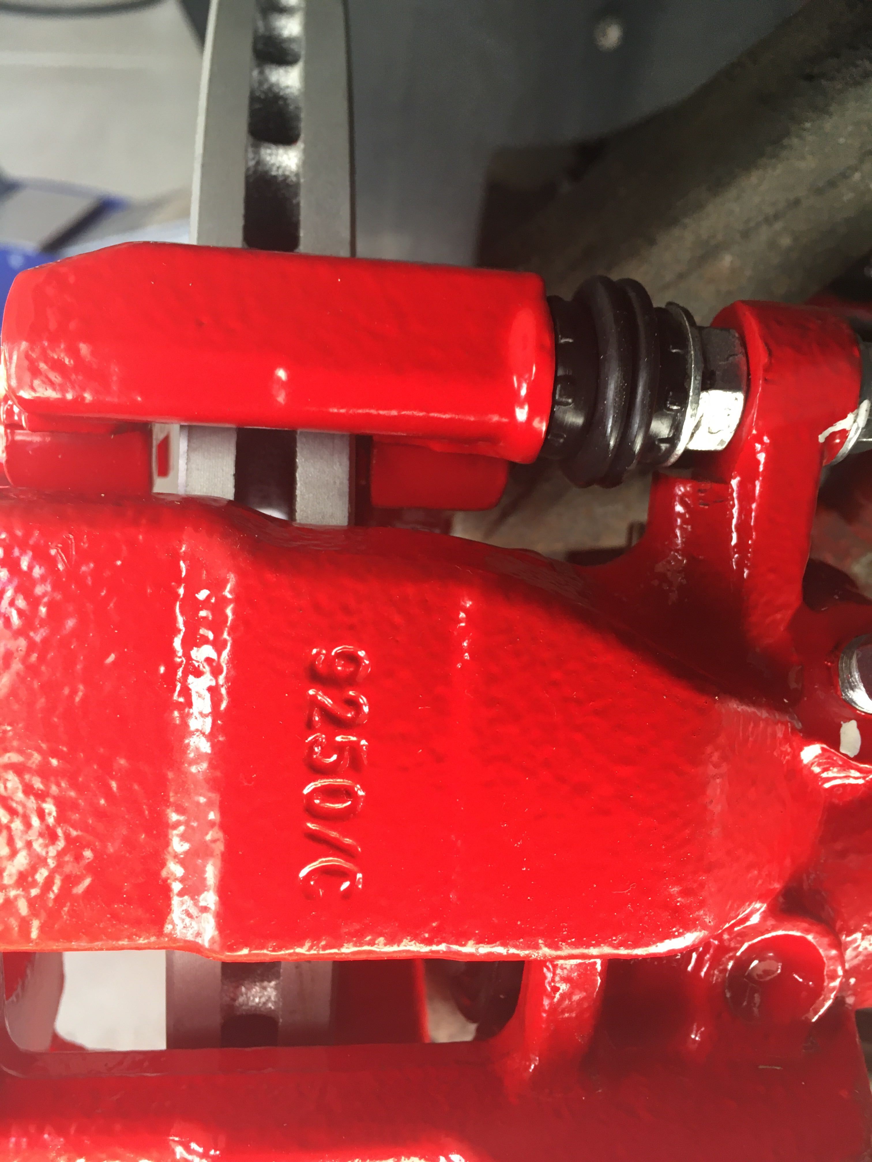

Finally ended up buying Powerstop B6 calipers, looks very good to me (we'll see how the finish holds up). Just need lines (the B6 is a larger banjo) and pads.
