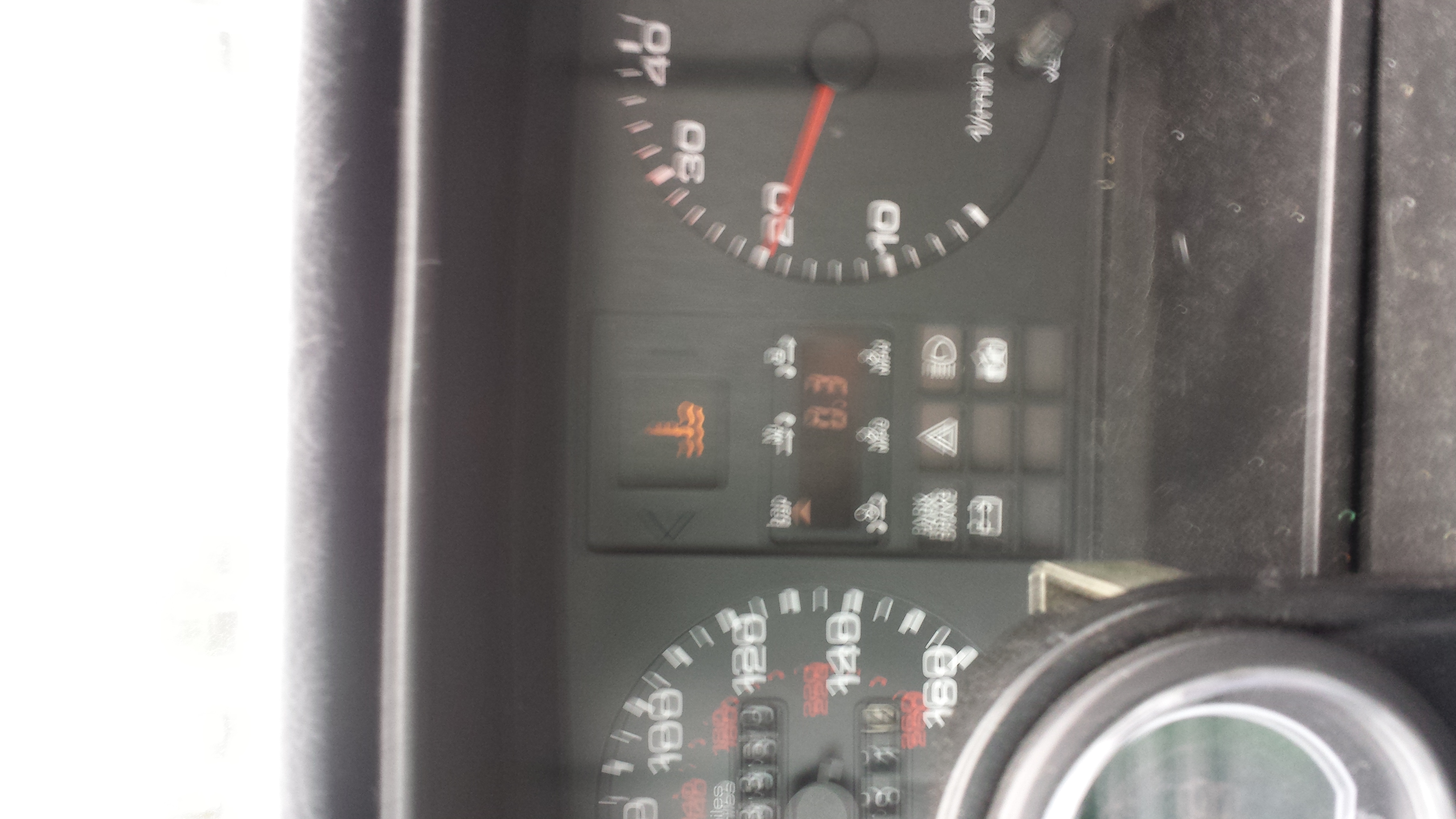

It's been too long. This warning for coolant temp has been squawking at me I'm the 5000 from the moment it starts running. Isn't this triggered by the sensor in the bottom of the coolant reservoir?
Sorry about quality. Tough taking a pic through the steering wheel while navigating busy city streets lol
