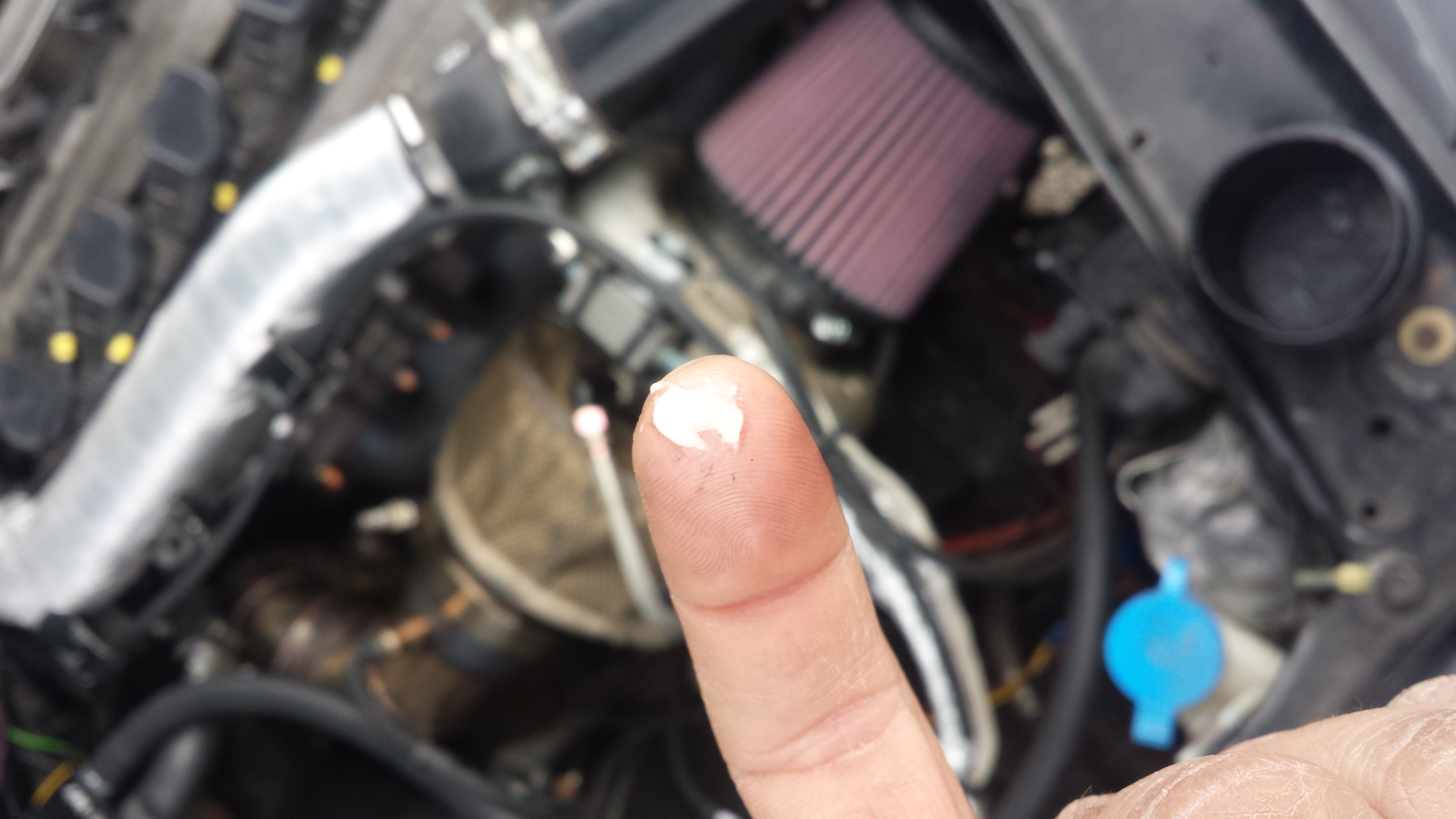

Also I found chicken fat in my CC :lol:
Need more pictars
It's just moisture. Not worried about it. I added SS wool to the CC to keep it down in the can and out of the air stream. It's really more of a mayonnaise and there's not a ton of it. Good lookin out tho!

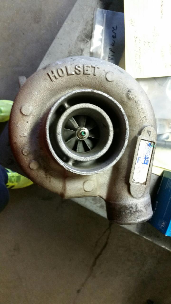

Sucks that it isn't loud. I imagine it has the anti surge groove cut out (some have the ports but not the groove).
Ok so I have the ports but they don't go through the front of the compressor housing. It's like a ricer attempt at an anti surge housing. "Functionless"
I did hear something sounding like surge earlier when the bpv was operating. Sounded badass but idk if it was surge or not. Maybe I wasn't listening hard enough while focusing on the gauges
I'd also move your breather away from the heat and on the other side. Looks like fun.
You sure the groove isn't there? Is like a snap ring groove in the bore of the comp housing.
I will check after work but all I have is this shot of the front of the housing. When I had it off to clean I noticed there were no machined opening on the inside that would lead to the anti surge area on the front.
