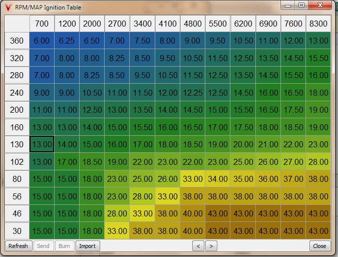

thanks nick. This is what I had before:
before
before
timing map before.jpg (170.54 KiB) Viewed 27315 times

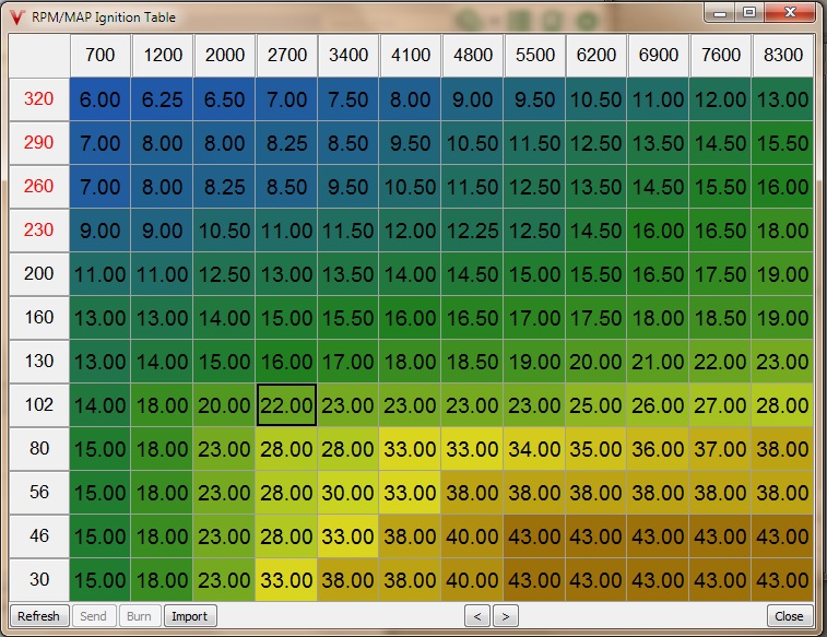

and after:
after
after
timing map after.jpg (221.38 KiB) Viewed 27315 times
You had a ton more timing down low. So I added some. And you also had a few more degrees once in boost, but I left mine the way it is for da safety. I wonder how much the added timing will help around town cruising. Probably a lot.

Your MPG's will probably be the most noticable ;)
